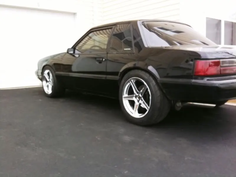

This is novi357 car it's a 275/45/18.
Not sure he Is on here his car runs 8s I believe. But wanted to show fitment.he later switched then out for a wider and shorter tire.

I'm a little more of a looks guy so i'm biased, I like the car to look balanced. That's a nice car, but those tires just don't look right to me. Maybe why he went shorter.

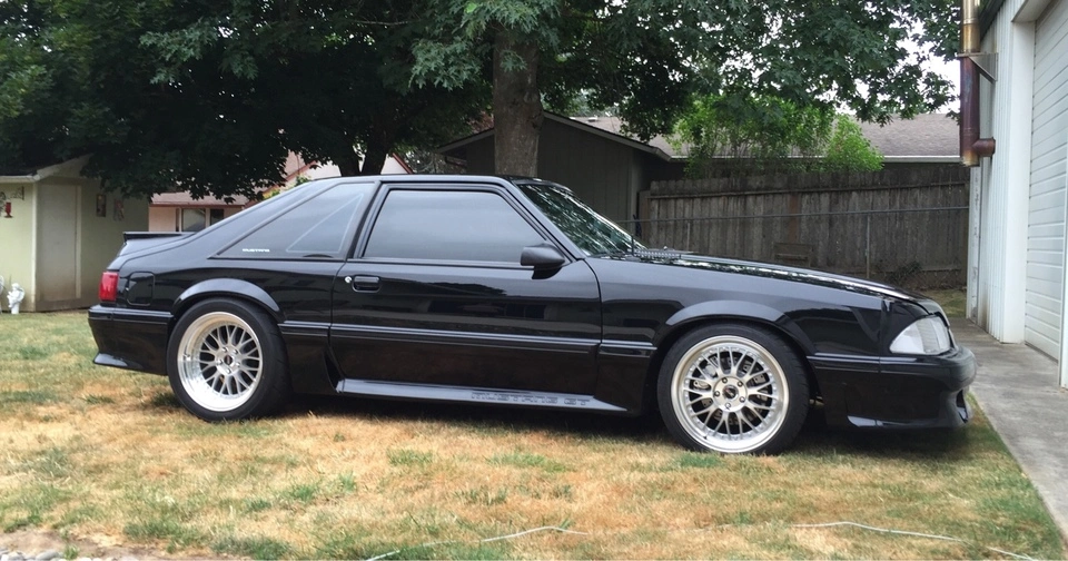

Fwiw, I have a 275/40r18 toyo on the back of mine. 18x10 +25 wheel with a 7mm spacer, no quad shocks, eibach sportline springs, tubular upper/lower lca's and bilstein hd shocks (it's pretty stiff), and rolled fenders. It's snug, and it does graze the inner wheel well when cornering hard.
