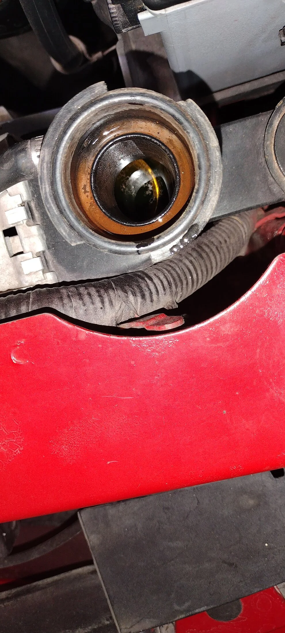

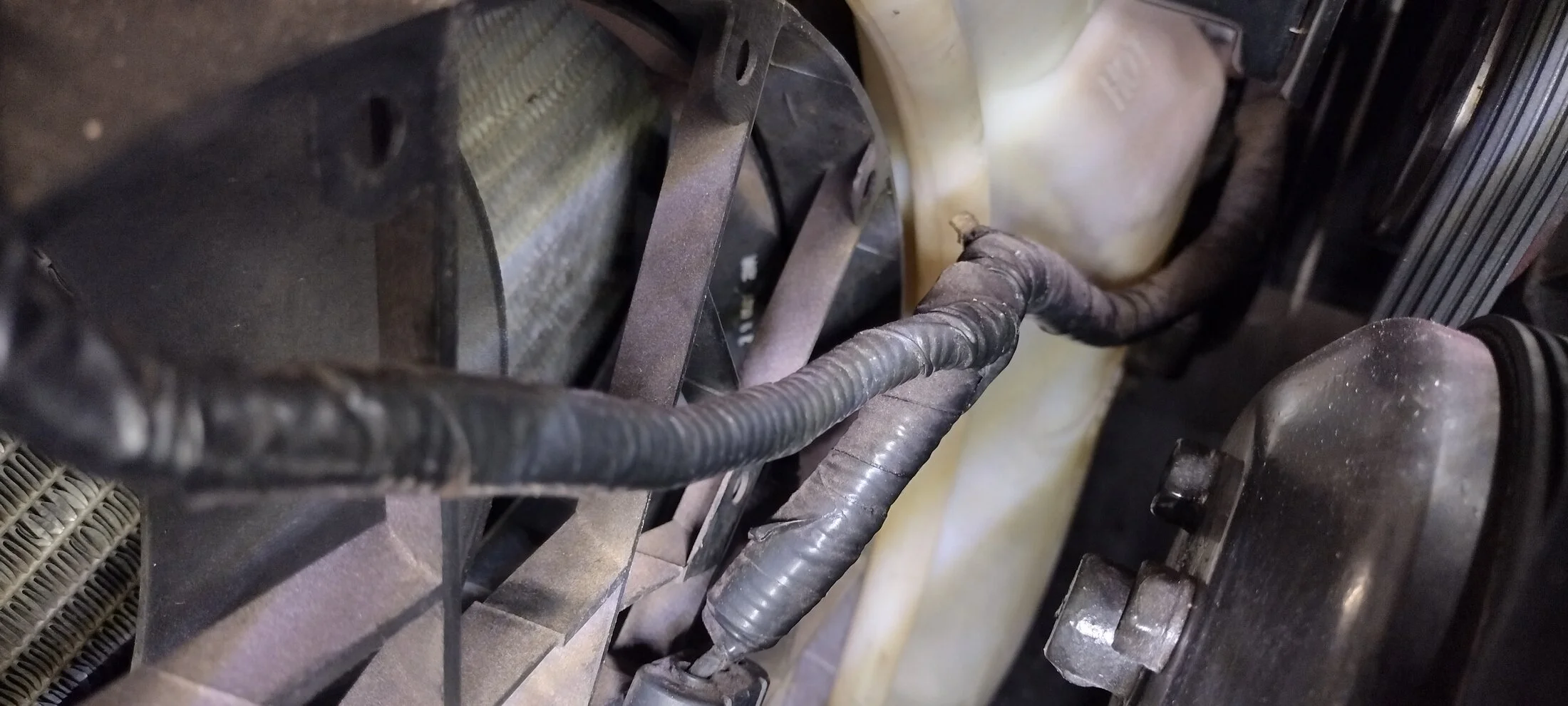

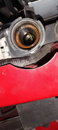

So just got home and checked the levels from filling up yesterday and it's still at the sa same levels. When I left it I figured after it cooled down it would pull some out of the overflow job too finish filling the radiator. Well and so I may actually take it on a drive or maybe not today but tomorrow or Sunday and see if it does that. I don't want to add any more to the radiator and then some ends up overflowing out of The jug if that's how that works lol.
The overflow drug is about 3 in above the cold fill line and the radiator I would say from the very top maybe about 3-4 inches as well from being full.

Ok, fill that dude (radiator) up to the top, don't worry if a little runs down the little hose (overflow), cold of course, the puke tank should be at or just above the cold mark, not critical but not below the cold mark, drive it, I mean drive it, I fix my stuff so I have driven this junk hard, so drive it around town, get it out on the big road (highway) and run that dog at 65-70, you'll prolly need to do more like 80 if you want to keep up with traffic but you don't need to, I start by shake down runs, short trips around town, don't do it all in one day, monitor the fluids cold and hot, don't need to open the radiator cap hot, remember skin does not like liquid that's 190-200*. Look under the engine compartment for leaks, cold and hot. Overflow tank not losing fluid, nothing on the ground, temp range good while driving. You're good, move on to the next thing, BLOWER TIME!! If you can't afford that, have a beer :nice:
