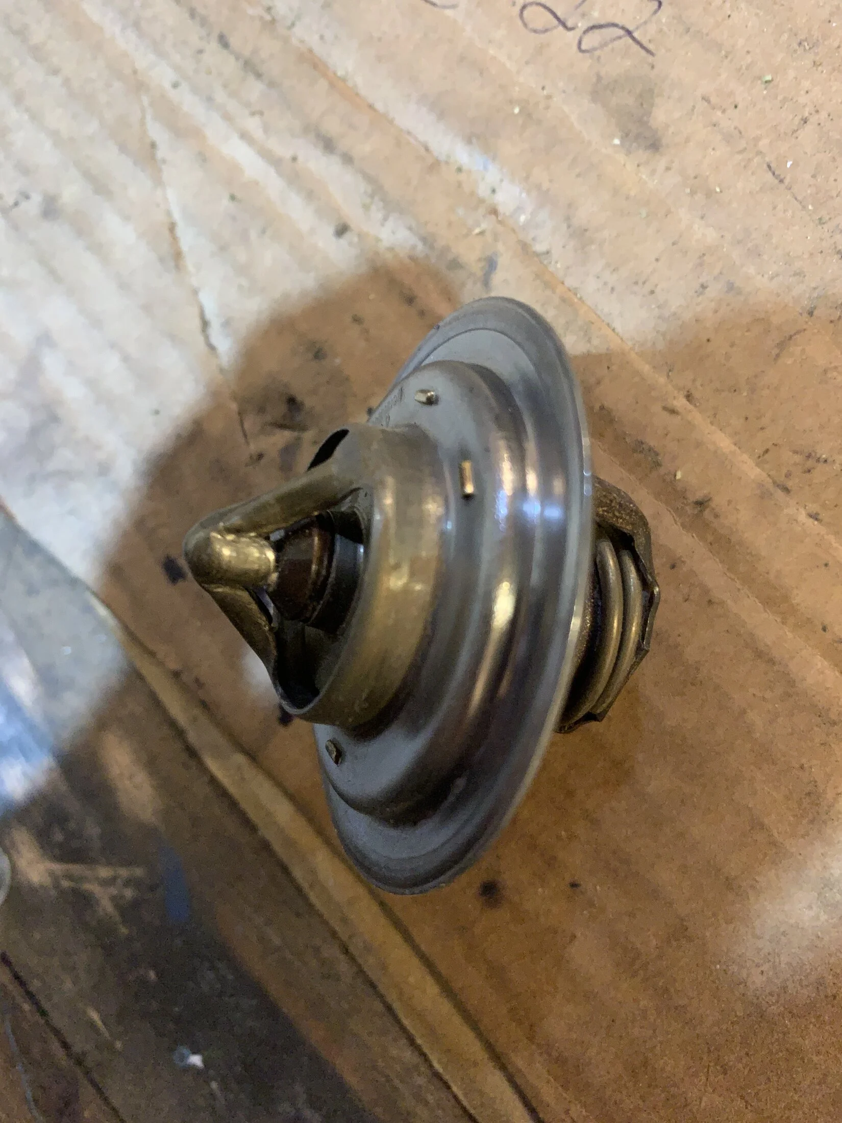

I failed to check new thermostat before installing. Could it be stuck closed, then causing excessive coolant pressure and inevitably the leak? How long would the car need to idle with this setup before the thermostat would open?
Small pointy side towards rad.

A few things come to mind:
1. Your water pump casing may have a crack in it. Hose "imperfections" are generally irrelevant.
2. I agree you should change the T-stat again if for no other reason than to verify that it is correct. I would also recommend the OEM 190* T-stat and not another 180 unless your EEC is specifically tuned for 180.
3. The T-stat in the image above is fine, however, (and I know it's just an example pic) I would try to get the style that has the bypass holes drilled into it.
Appreciate the feedback. Really confident I installed it properly, but I’ve made dumber mistakes in life. I have considered the crack in the water pump, however it was dry when I removed the prior owner hardware. Figured thermostat check is easier next step.
