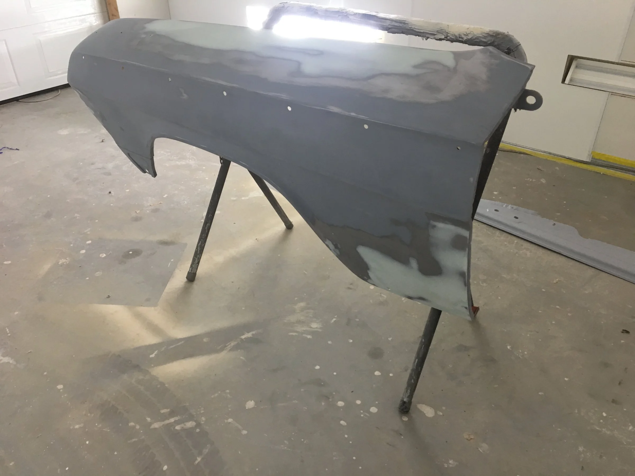

Remember how i mudded the fender?
The mud could have been almost eliminated by taking out the inner bracing and repairing the skin, then tack welding the braces back on. He doesn't want anything to do with that.
So what he really wants is a really nice paint job, not what I consider a real restoration.
So, if I get to work on the Impala again soon, what you'll see is me making due with the limitations I'm given. More can be done, but I probably won't be doing the full psycho on it.
It'll look good if I get to finish it, but I'll know it could have been better. Oh well, as long as he keeps paying me.

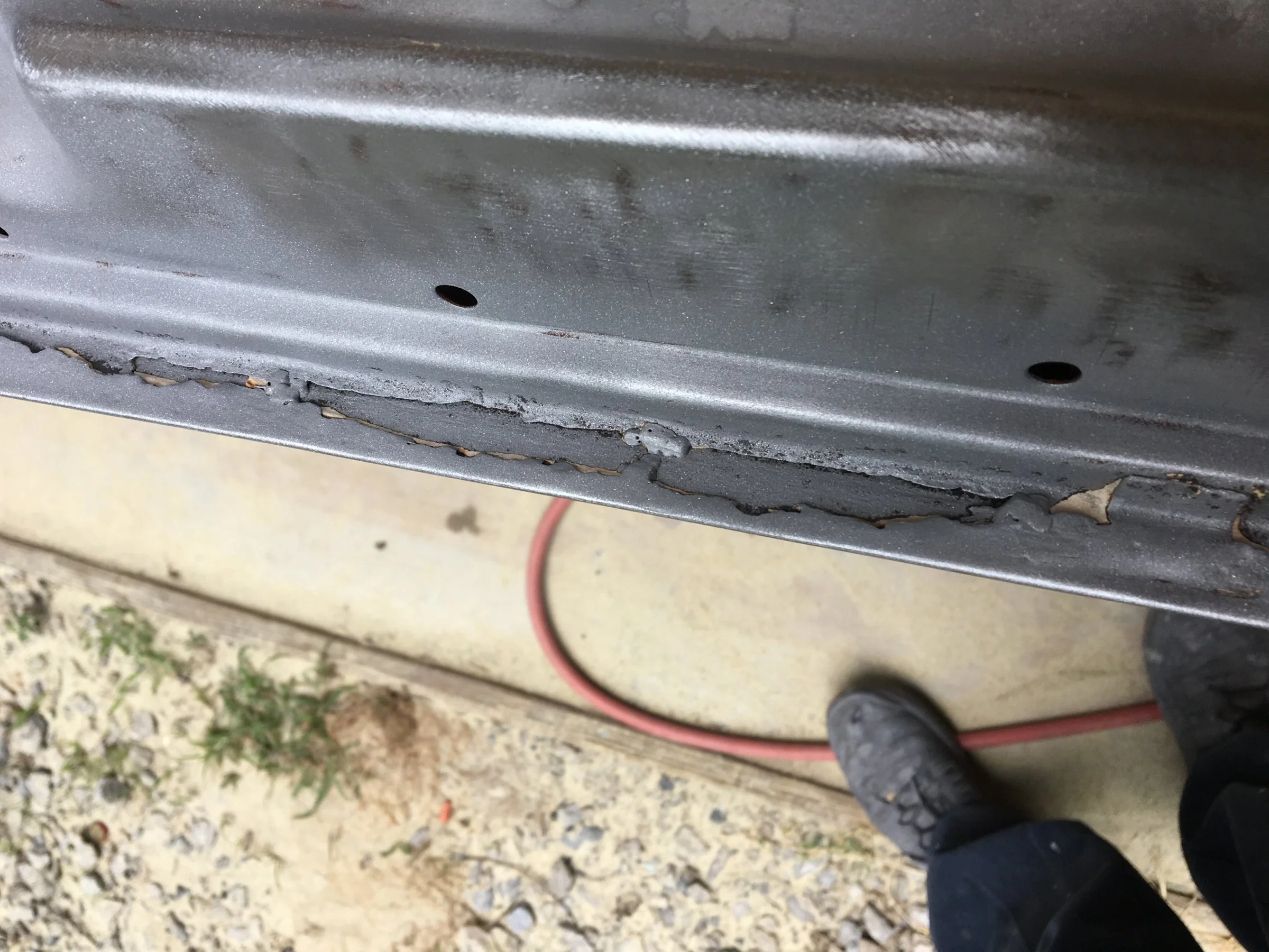

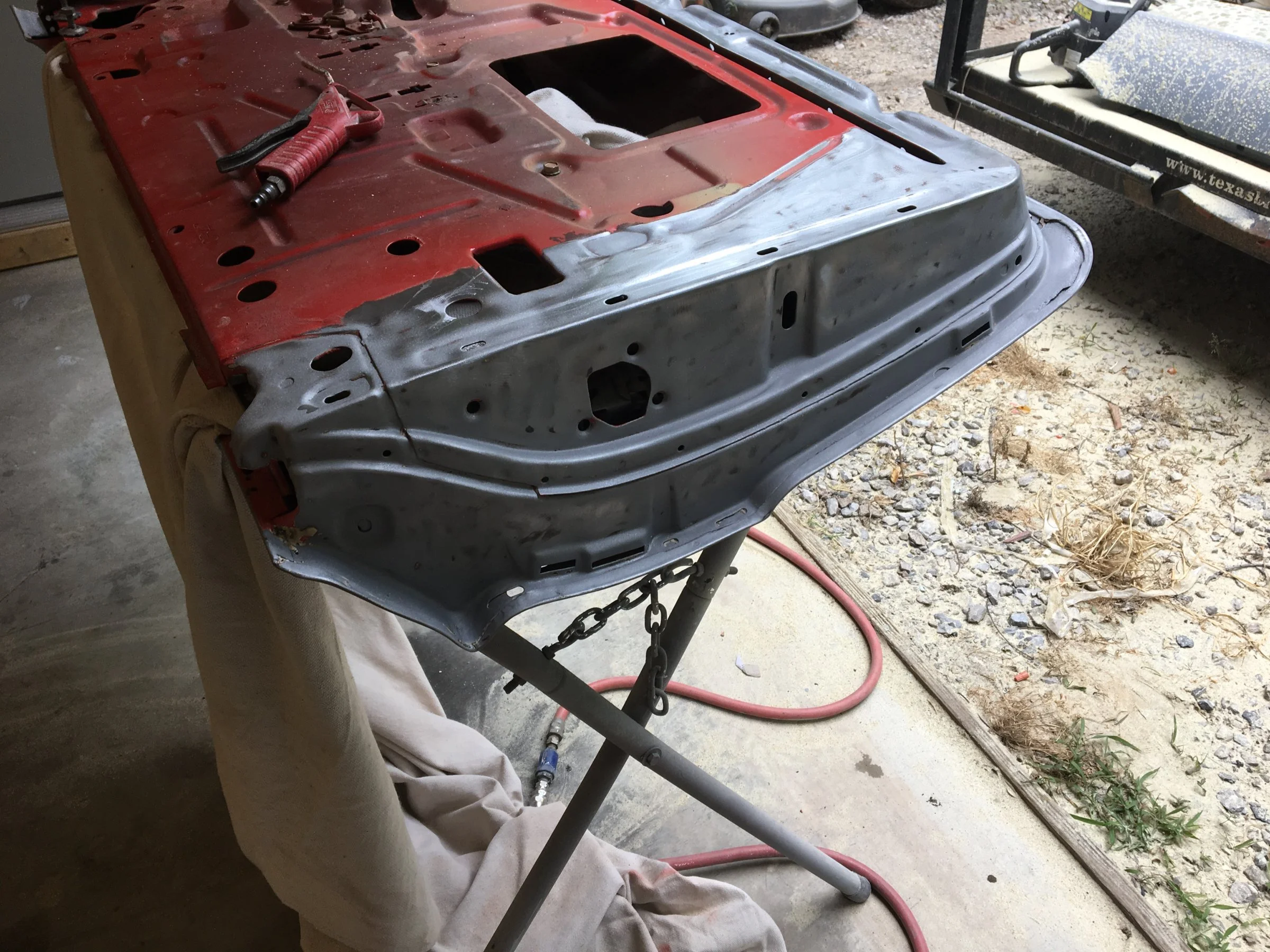

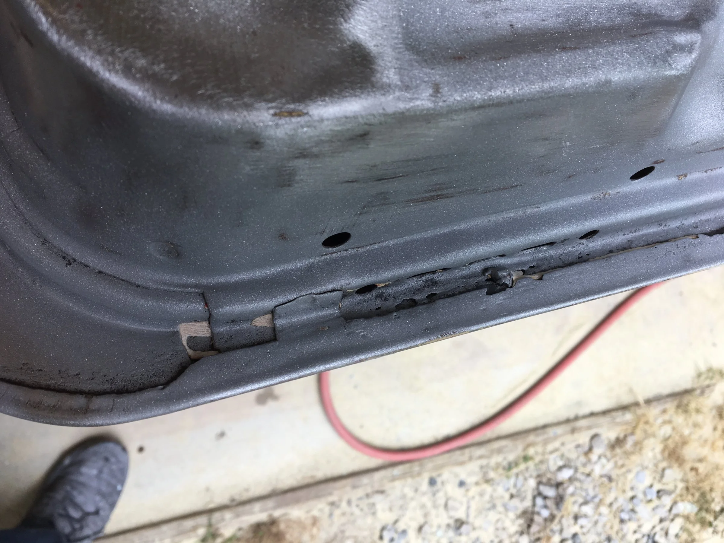

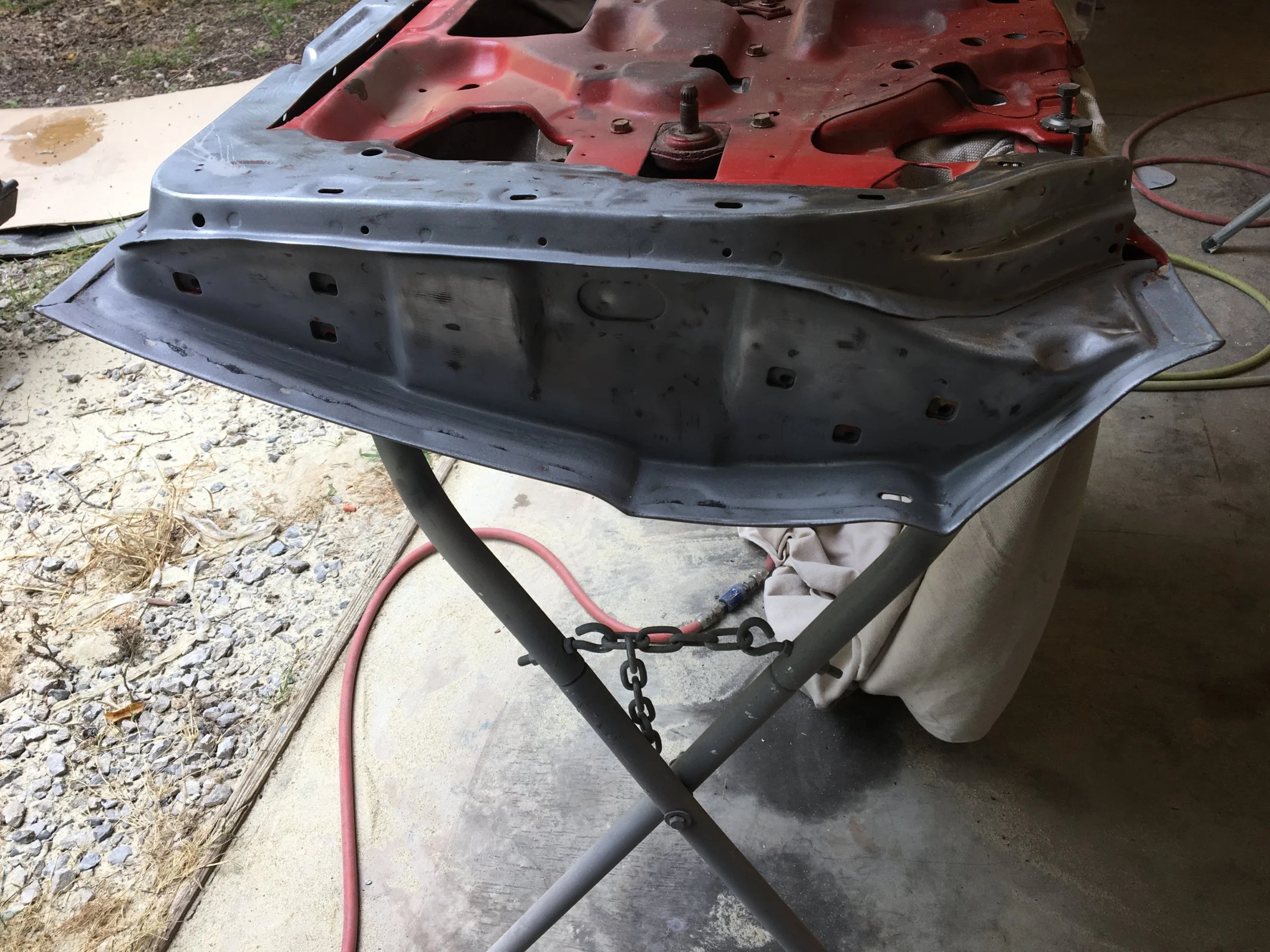

Why not a little bit of Impala stuff now. After shooting the X5 and buffing the Acadia it was about noon. I finally get to work on my birth vehicle (it and I were both born in '62).

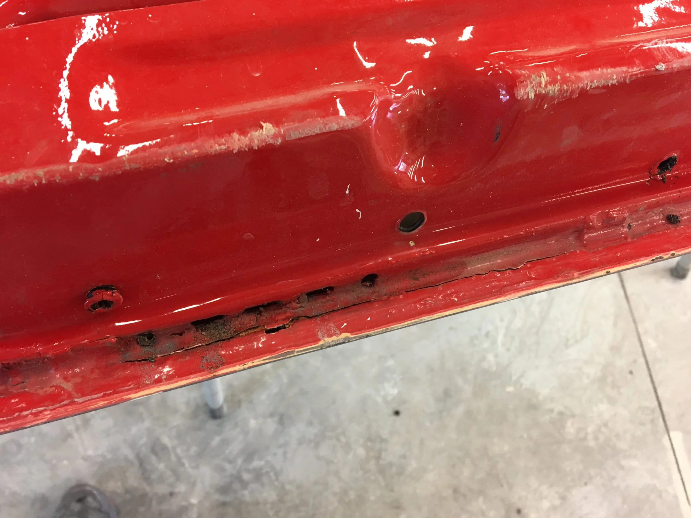

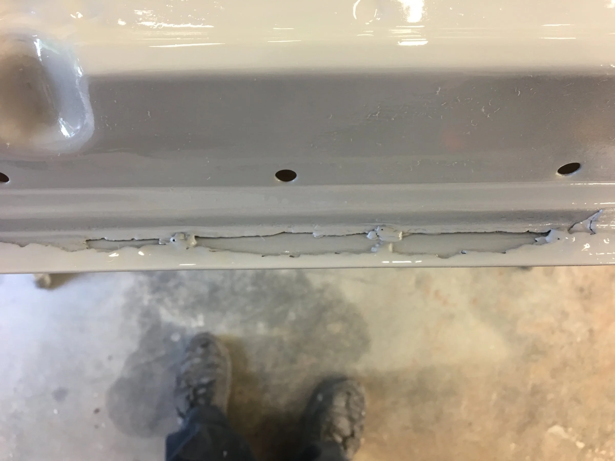

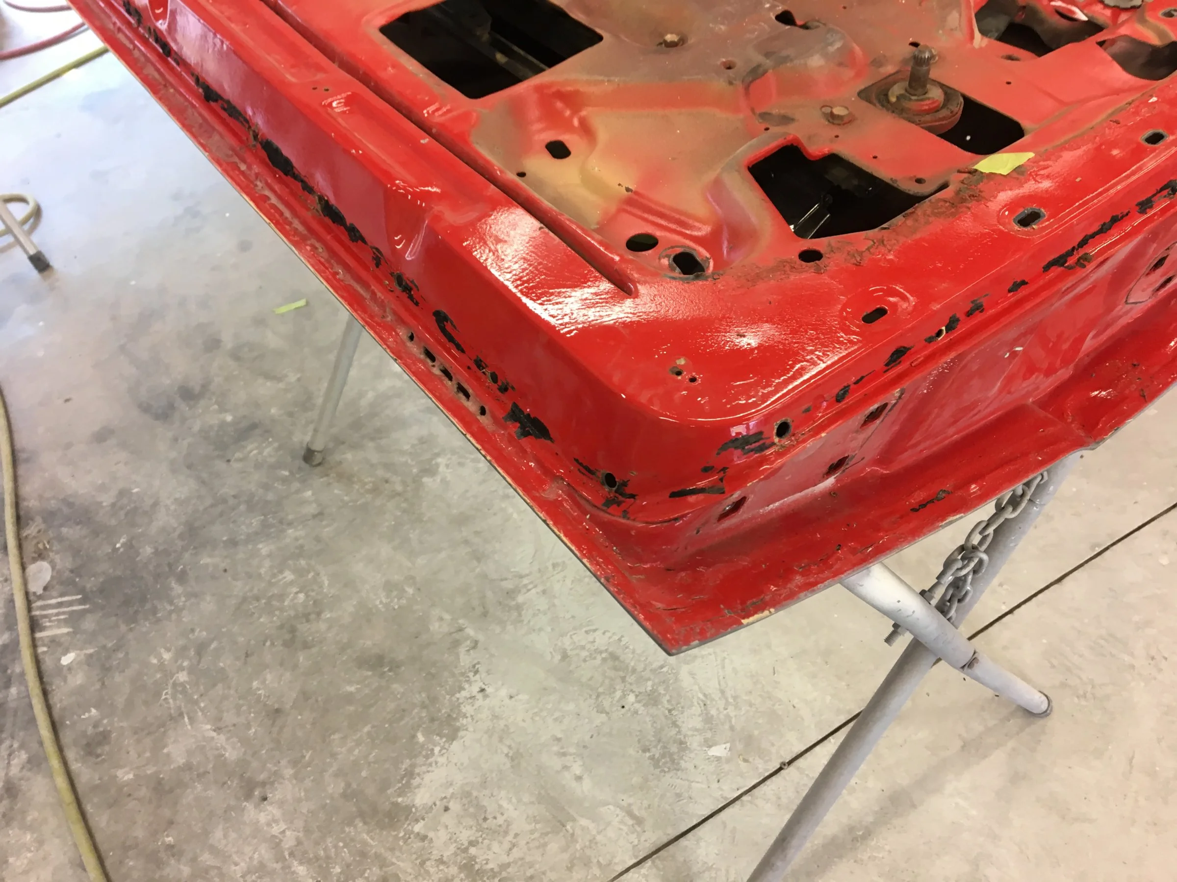

I wanted to get the driver's door jamb stripped and in epoxy by the end of the day. Hi ho, hi ho, it's time to strip (there you go Noobz).
The PR had goobered up a crap load of seam sealer around the edges of the jamb. I was curious why.
I know why now, they had blasted the rot previously and not replaced the metal!:nonono: They had actually tack welded the remnants to the outer skin!:nonono:
Look back at those pictures again. Look closely and I bet your head starts shaking like mine did.:nonono::nonono::nonono:
Oh well. What should have been done is to cutout those rotted sections and form a new piece and weld it in like a grownup would do. Damn!:nonono::nonono::nonono:
My time was getting limited at this stage and I was getting tired so I finished stripping the rest of the jamb.
You might notice the center of the jamb wasn't stripped. That's because TG didn't want to take the freaking glass out.:nonono::nonono::nonono: AAAAHHHHHH! Oh well, mine is not to question why, mine is to block, primer and paint.
In the end, I just sprayed a coat of epoxy primer on it just to protect the bare metal.
