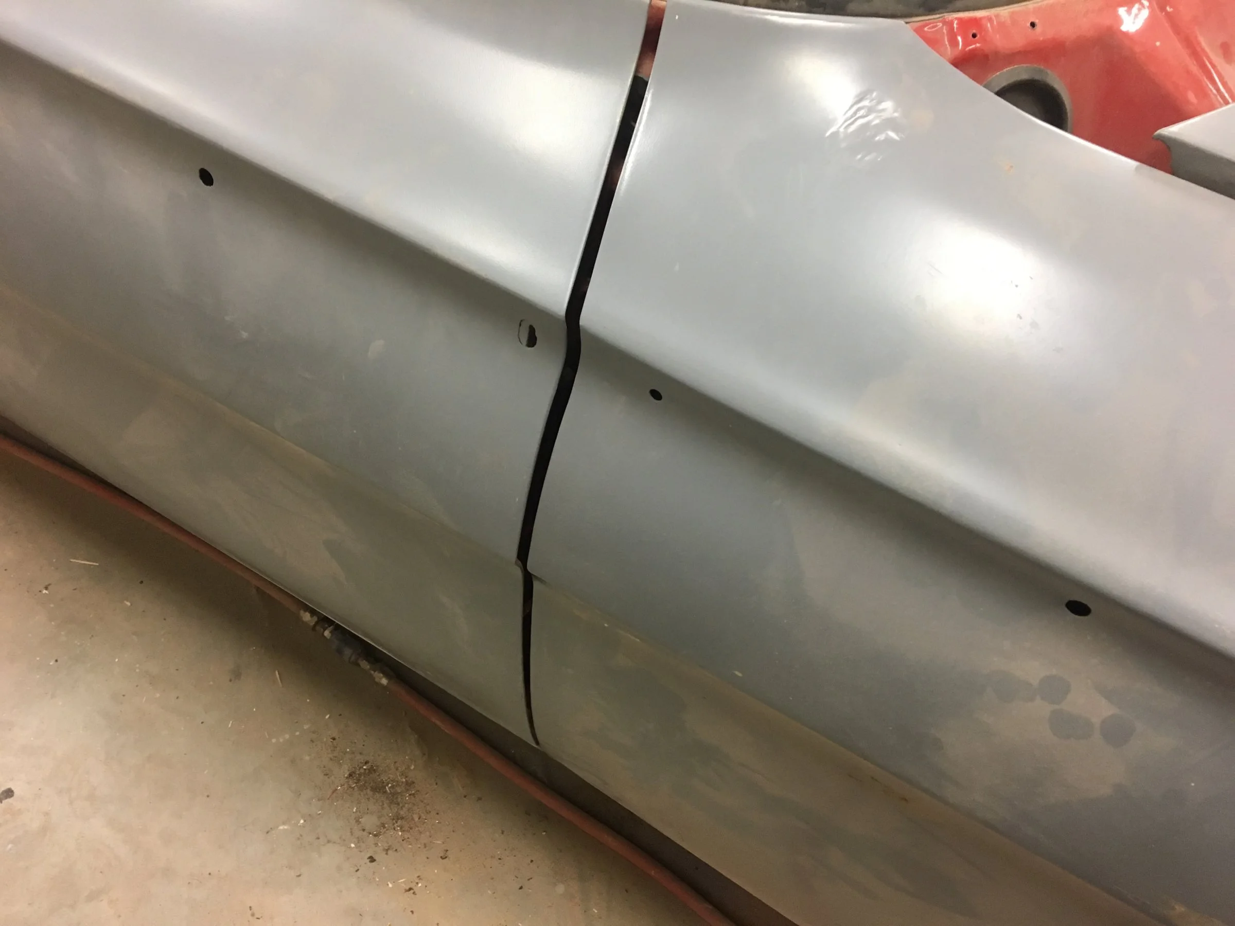

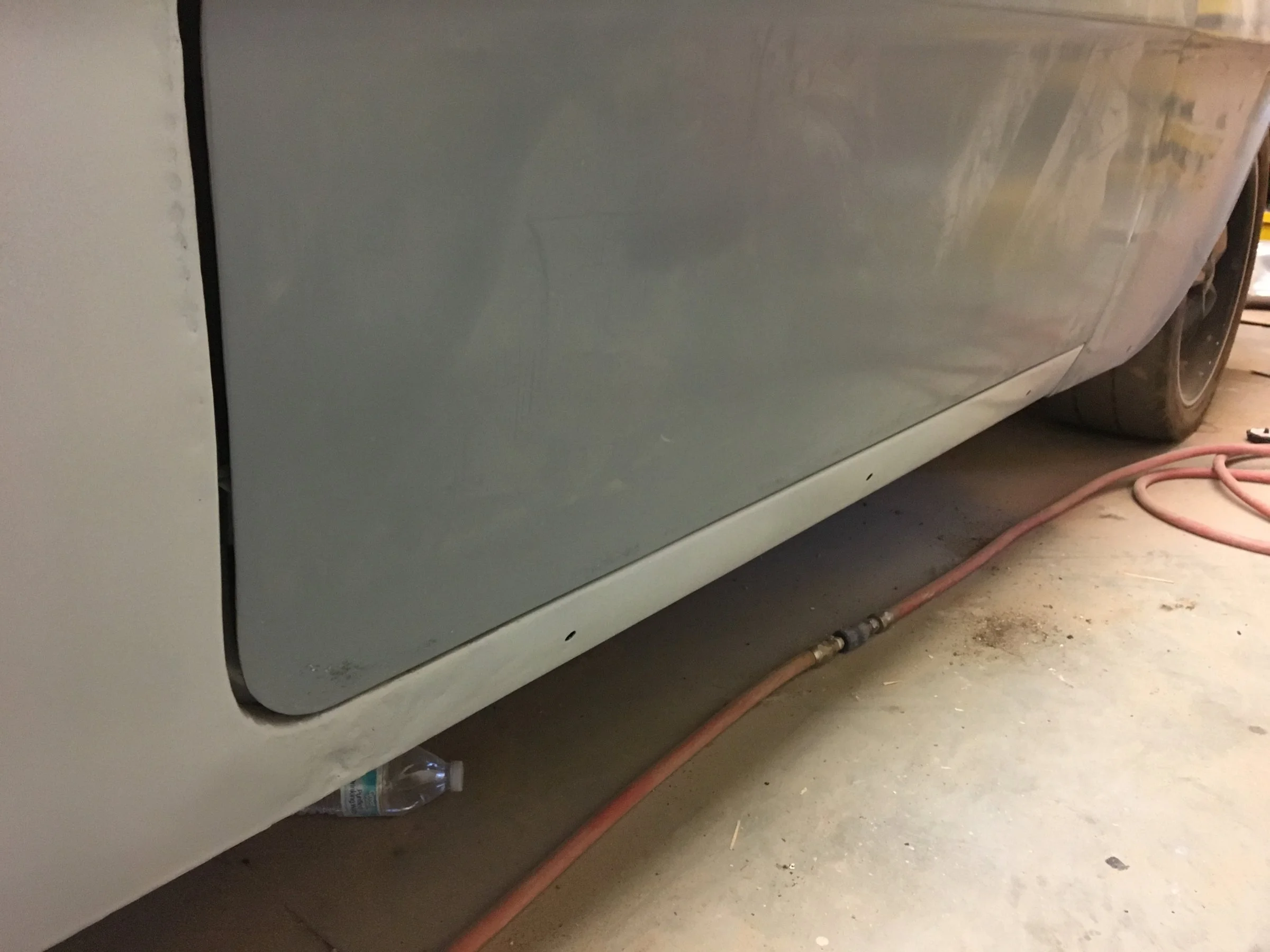

First issue to work on was that the bodyline along the bottom of the door and rocker didn't match,
it is now. The picture doesn't relay how far out it was from the rocker, probably at least an eighth of an inch through most of it. So I had to beat the hell out of the lower door with a bfh and a chunk of wood. It took LOTS of hits to convince it to be in the right place. It's not just beating it to death, you have to beat it STRAIGHT! Do this with a chunk of 2x4 and a sledge hammer sometime, it makes typing an update challenging!:eek:
Now the bottom of the door matches the rocker...the bottom of the fender matches the rocker. Win, right?
Not exactly, the top of the fender is taller than the door. Yet the fender is lower in the middle than the door and the bodylines are a bit smaller in distance on the fender.
This is good though. the fender curve in the center of the fender needs to be brought outboard. Not overly difficult to fix, but that would take too much time tonight. That'll be worked on Thursday night.

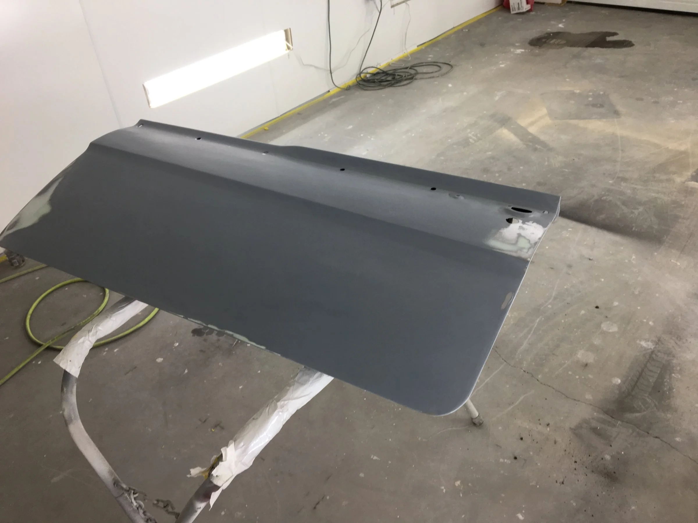

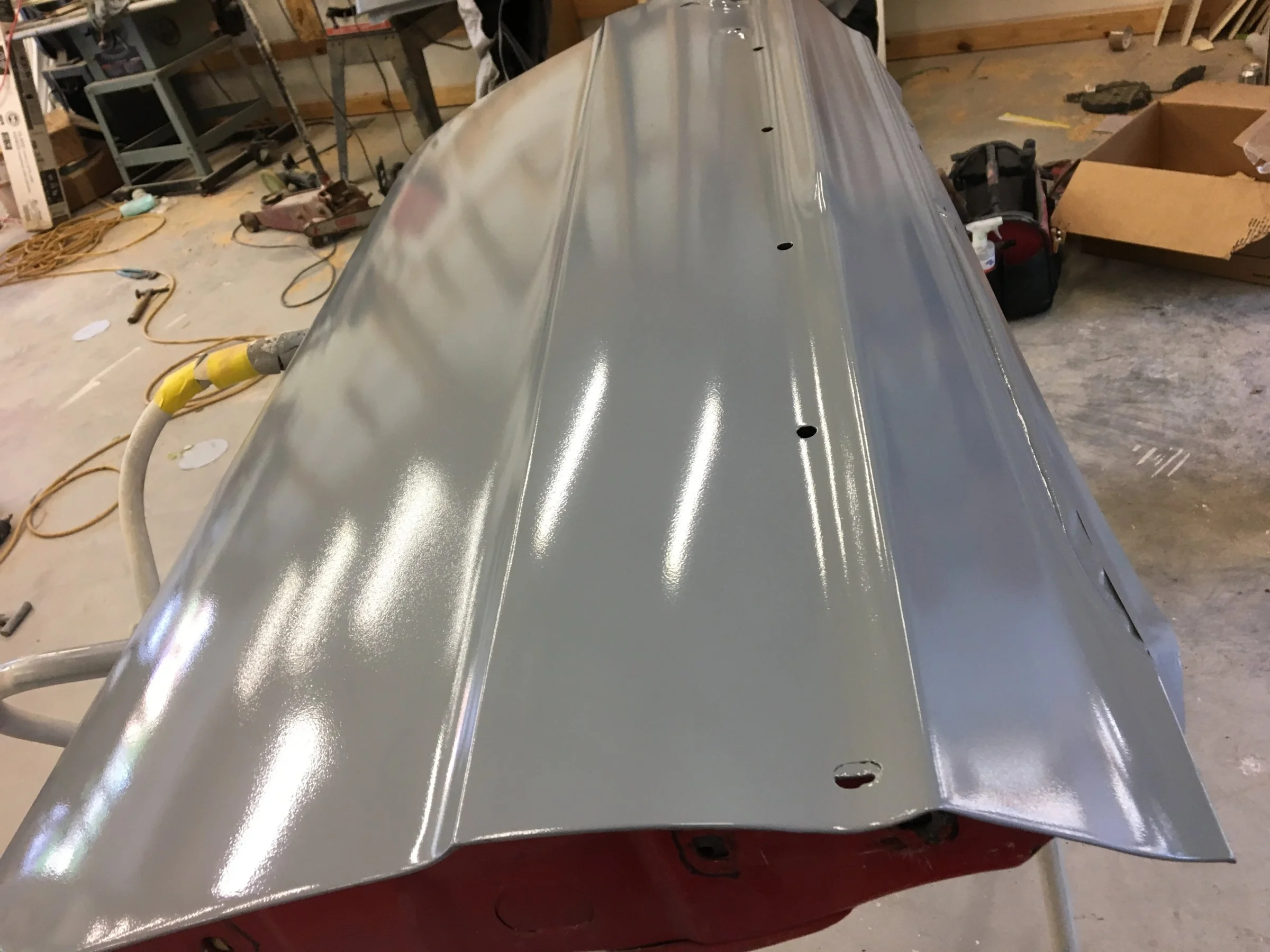

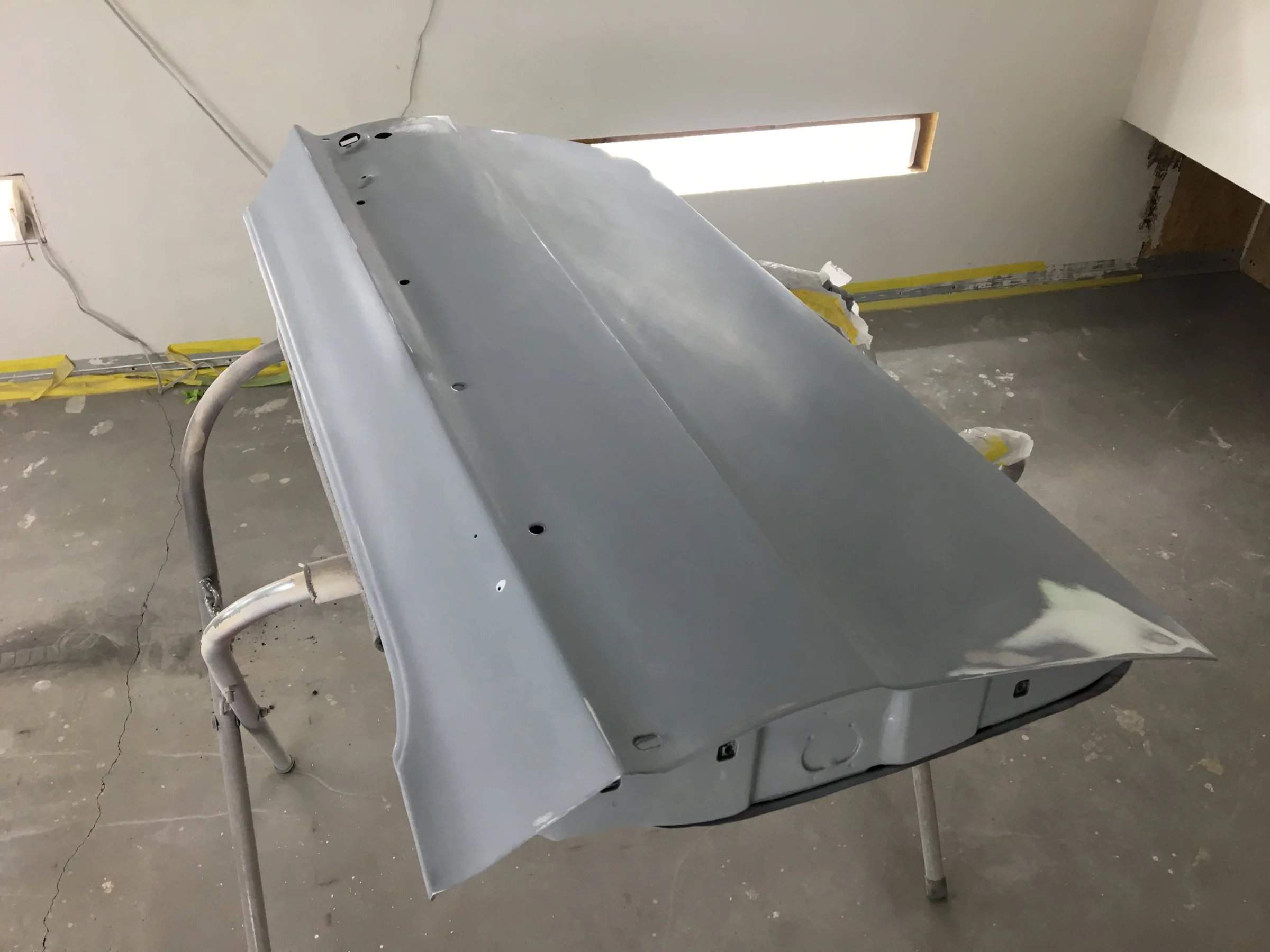

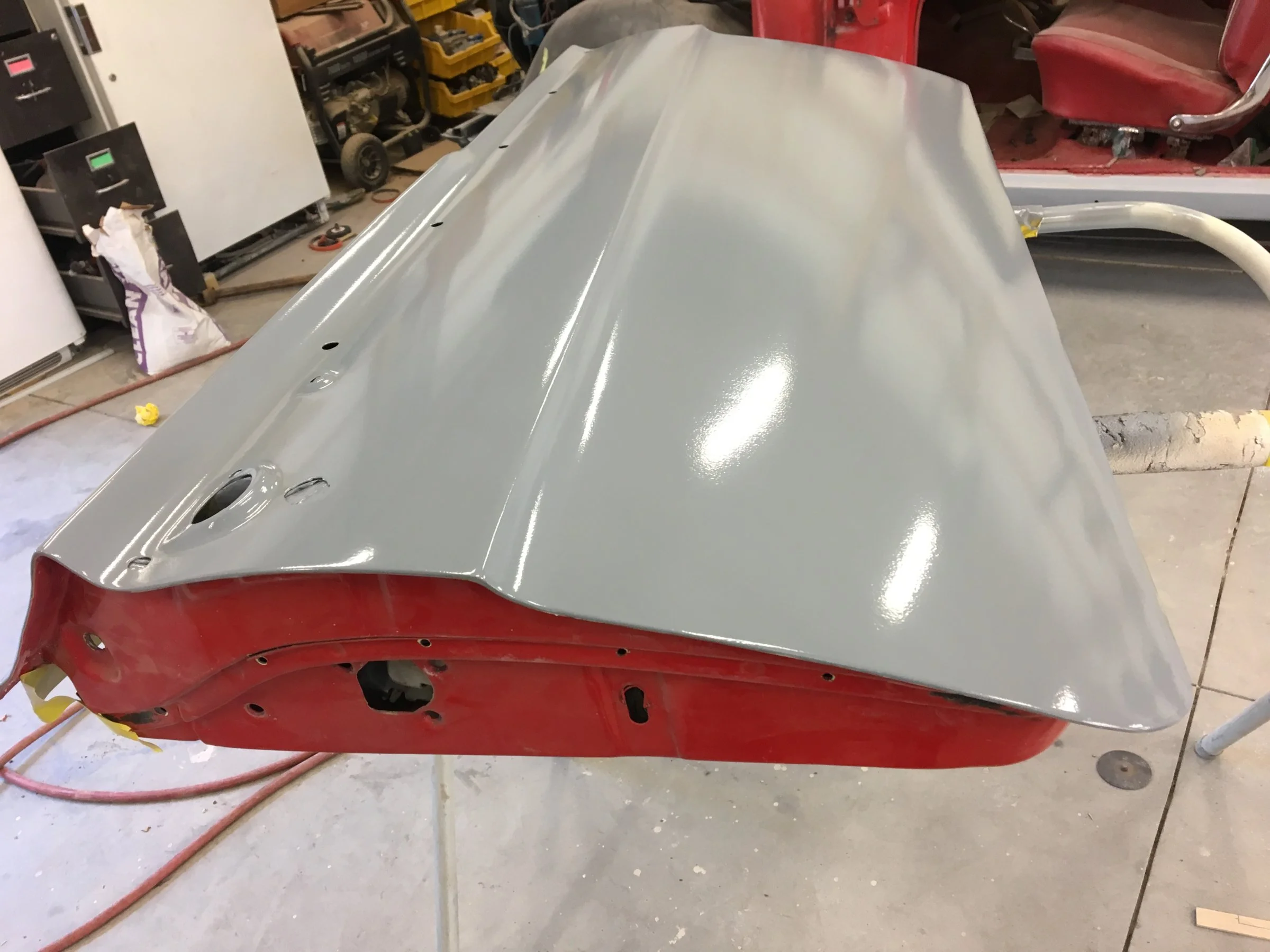

Tonight I also did the initial blocking of the driver's door and re primered it. It blocked out really nicely. My bodywork wasn't bad at all. I got it back in a high build primer tonight. There were a couple spots that I cut through on. I can live with that. The front edge wasn't quite flat enough on the lower portion
and below the lock cylinder needed some adjustment, truthfully I forgot to fix the dents there because TG was talking to me during bodywork. He knows not to do this anymore.
The point is that the driver's door is now straight. Yay! I forgot to take a picture in primer, sorry. It looks grey and straight now.:jester:

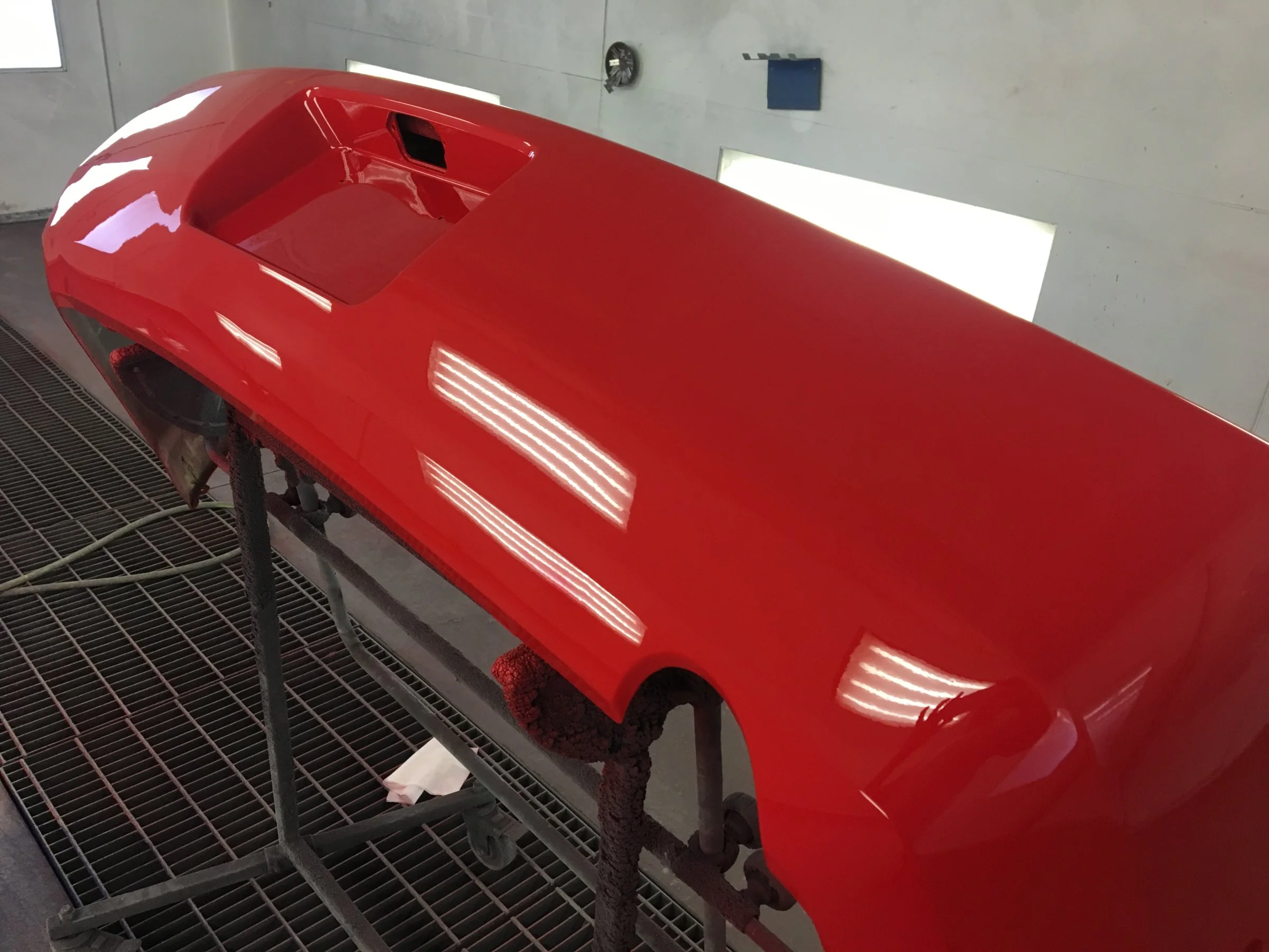

I did paint the rear bumper of my son's '09 mustang, and it's red. The clear coat was delaminating so i stripped it, repaired the various gouges, primered it and painted it. He seems pleased.

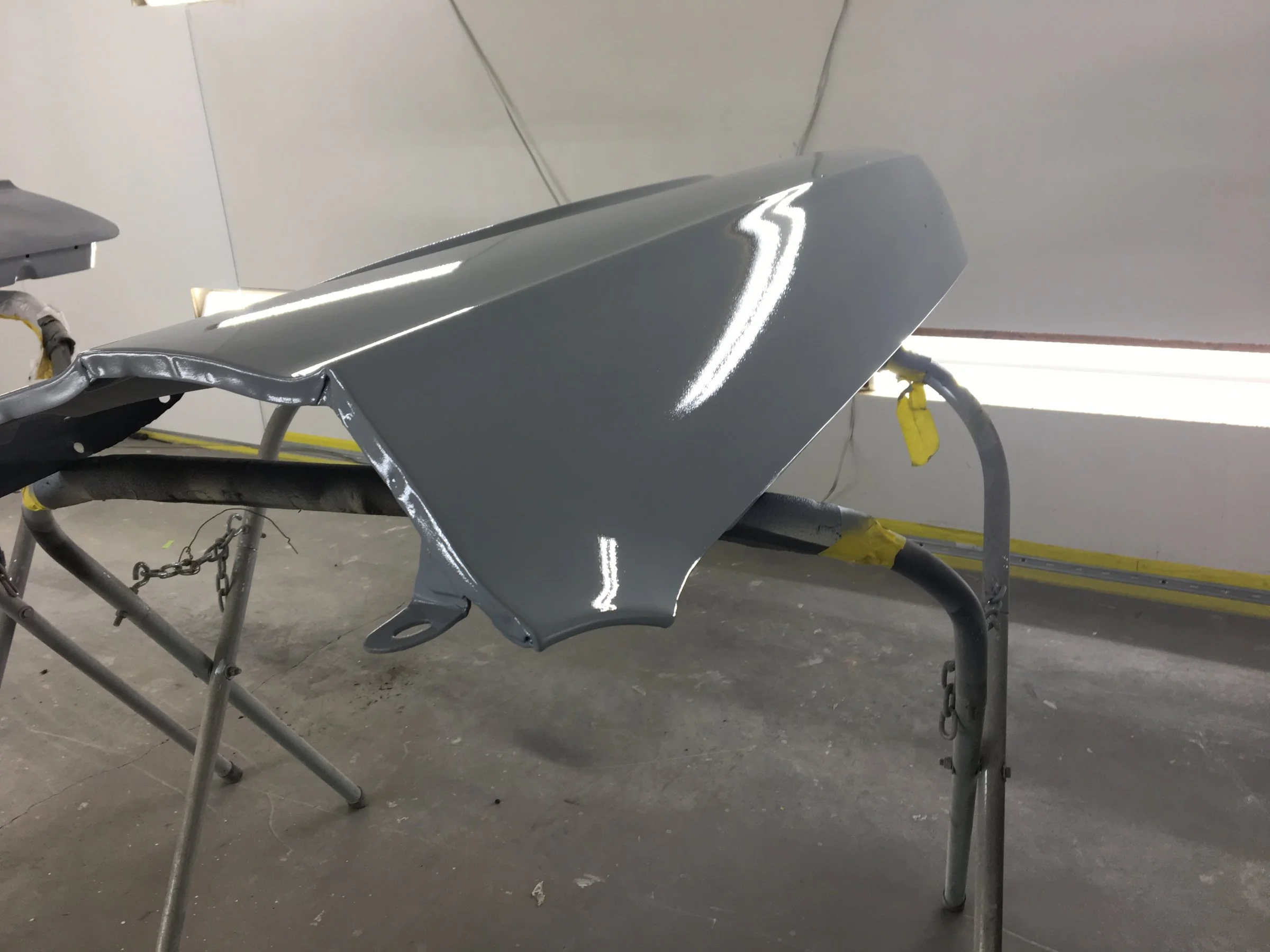

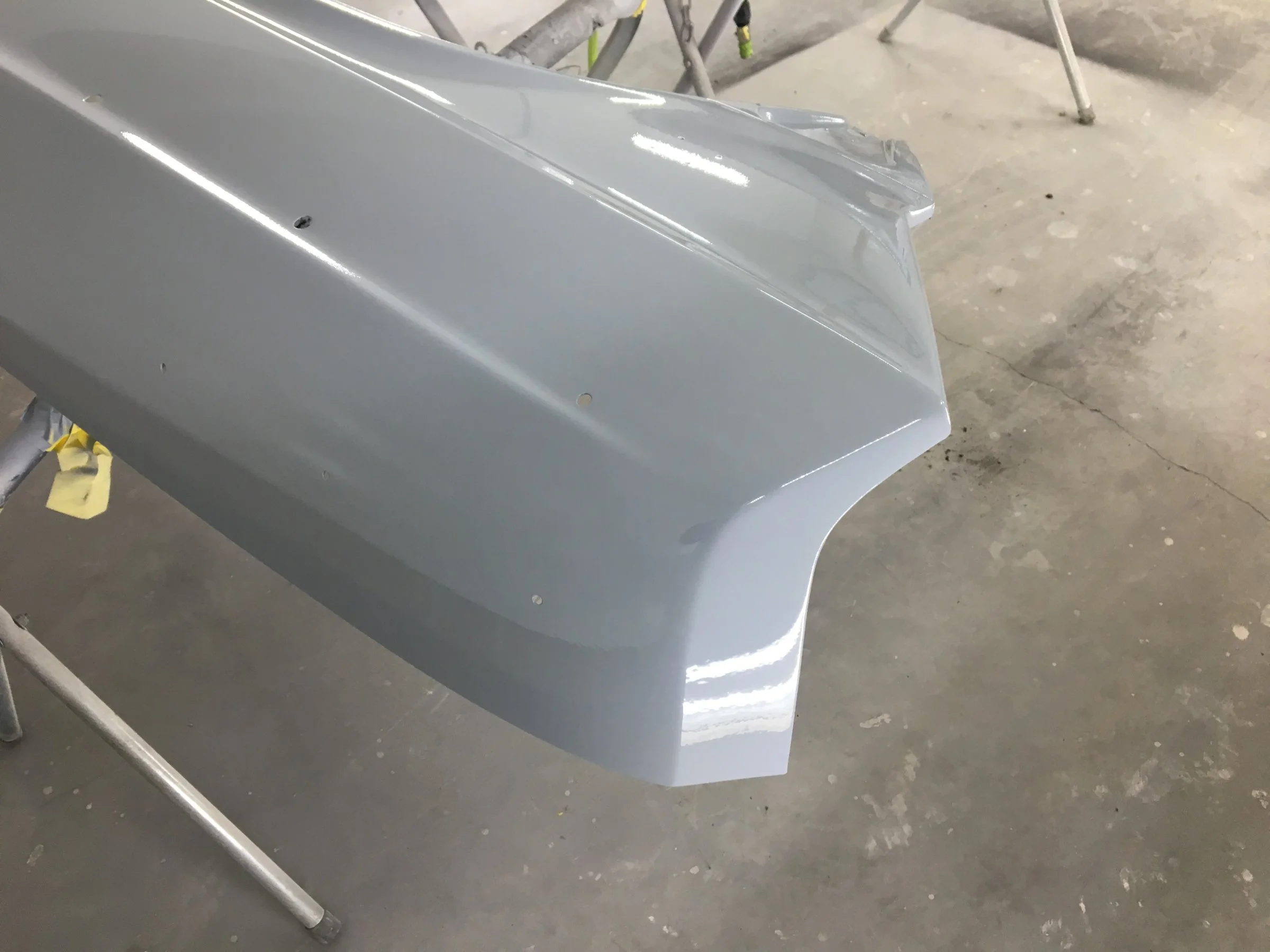

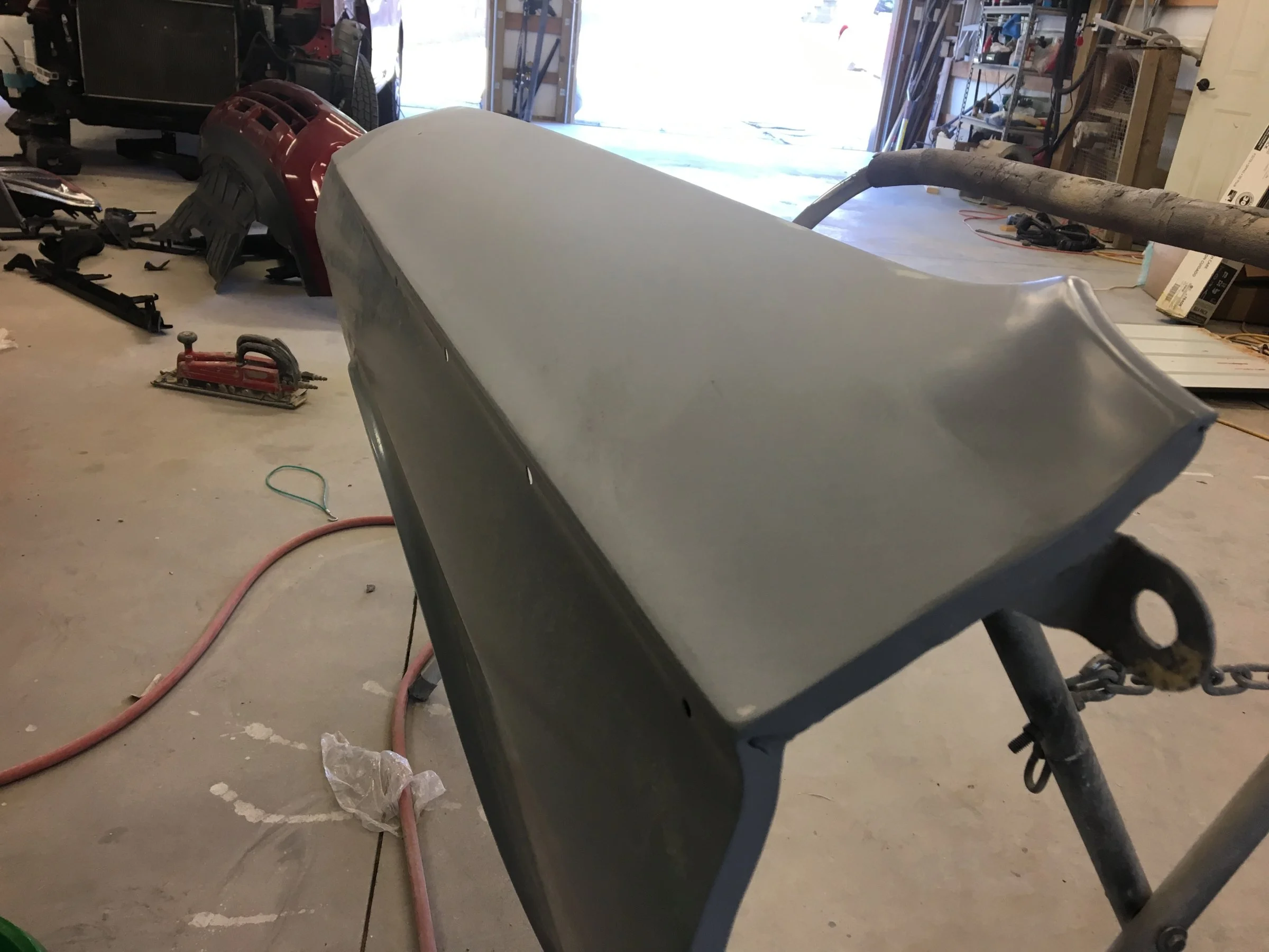

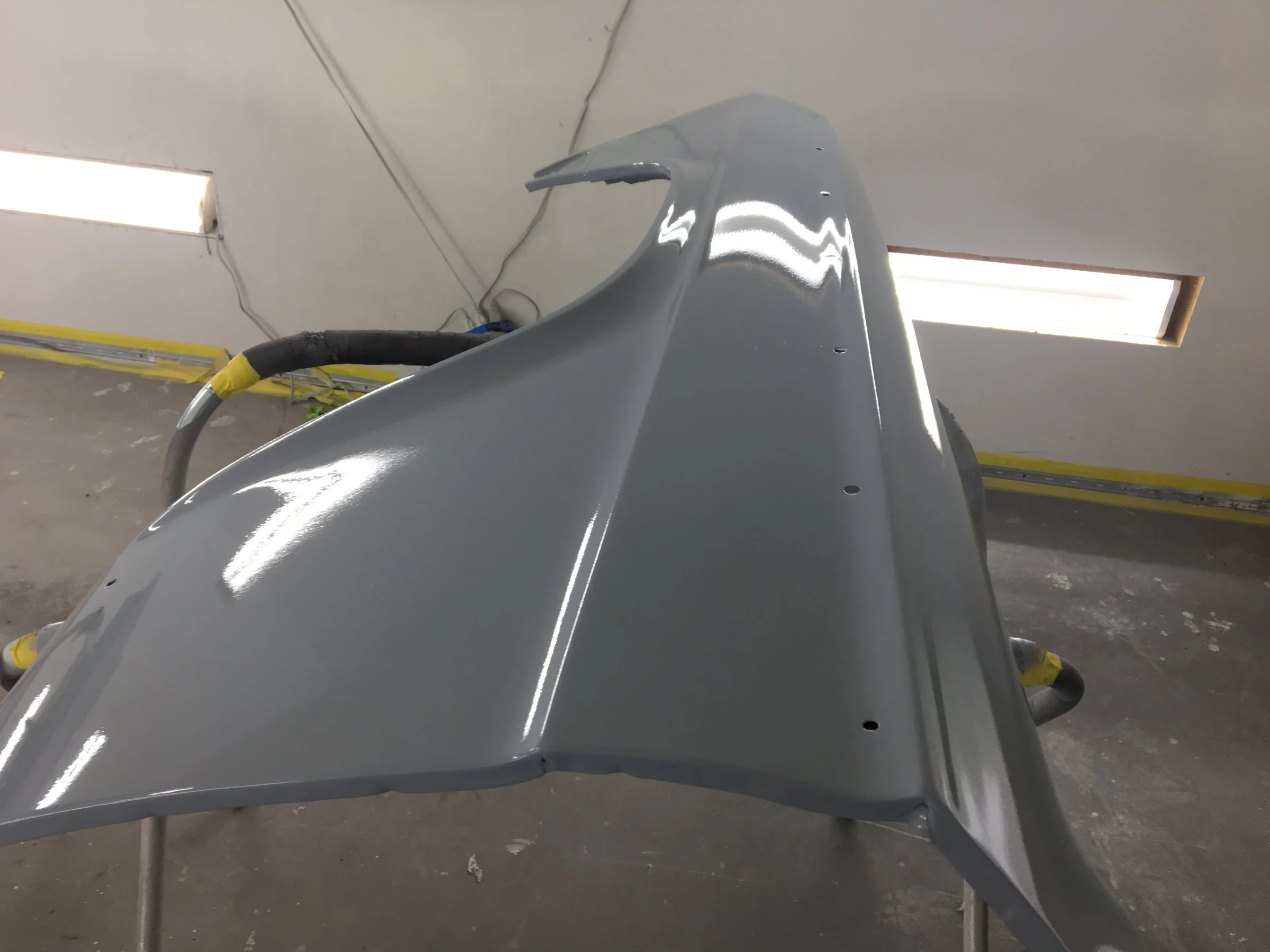

I did the first blocking of the fender. It blocked out wonderfully.
I blocked it with 180 since TG wants me to use up the rest of a direct to metal primer he has. It tends to block like a rock.
I did the final primering with a high build primer though. Came out pretty good.

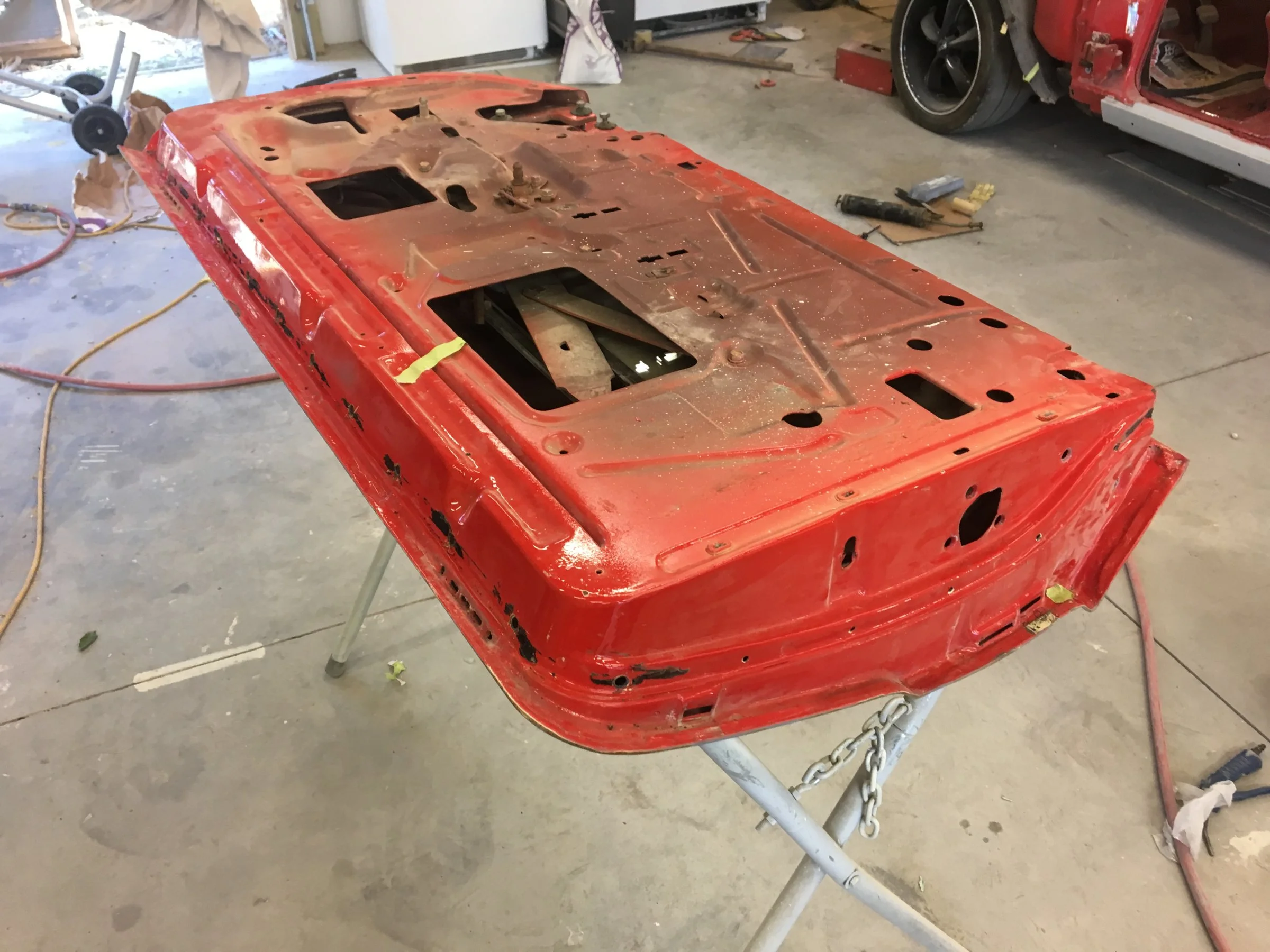

Anywho, got the passenger door pulled off and I will get the bodywork done on it. It is now the "standard" part for the sides of the vehicle. We will make the fenders and quarters match them.

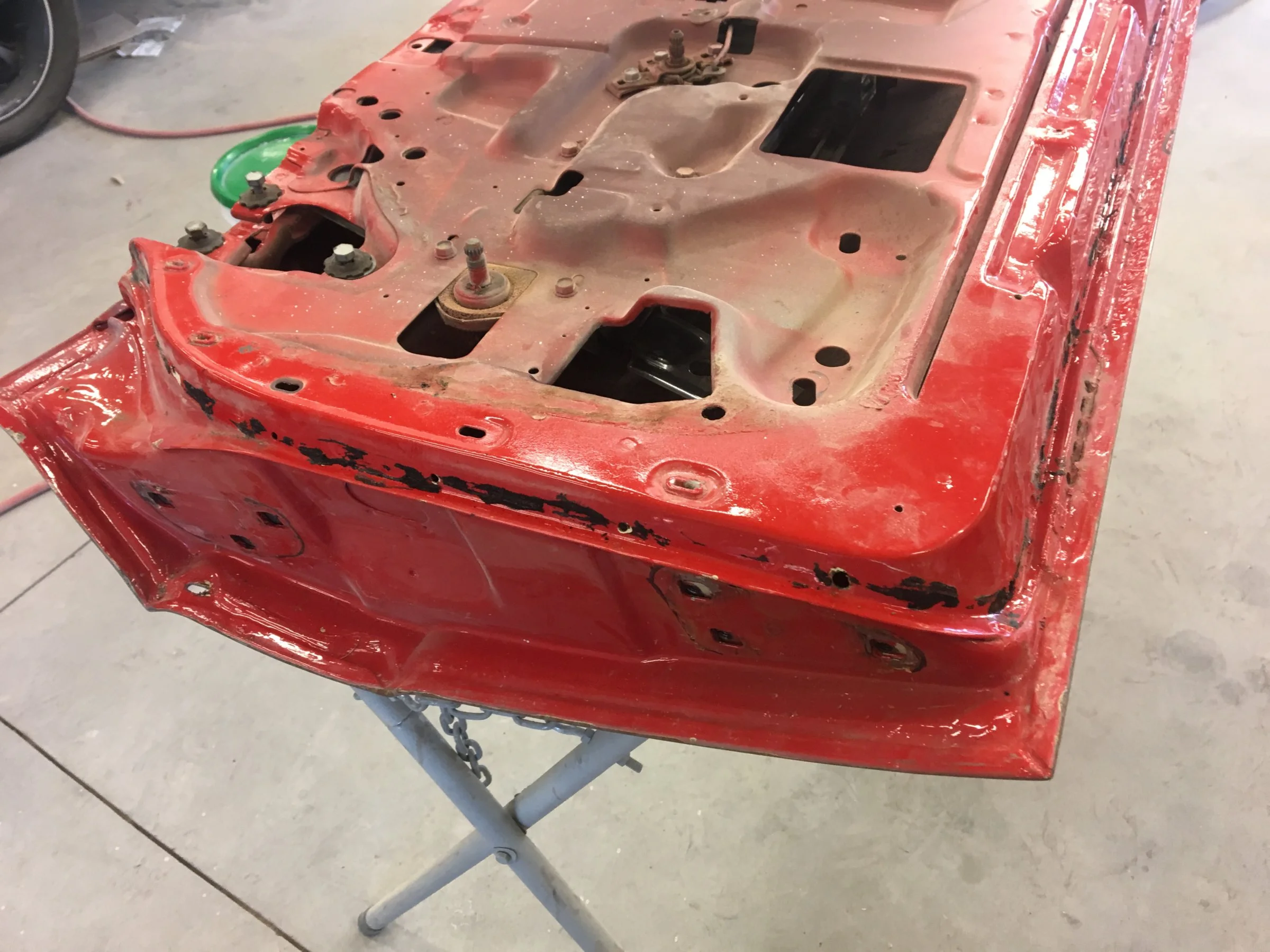

The jamb of the passenger's door needs to be stripped, so I took off all of the attaching seals, bolts, etc... It appears the PR had done the exact same thing to this jamb as the other side.
I figured I would get it stripped and in epoxy last night, but TG didn't have anymore sand for my blaster. I shared with him that they still sell fifty pound bags at the same store he bought it from before. He said, "Ok, tomorrow".....:crazy: I swear to God I'm going to go insane.

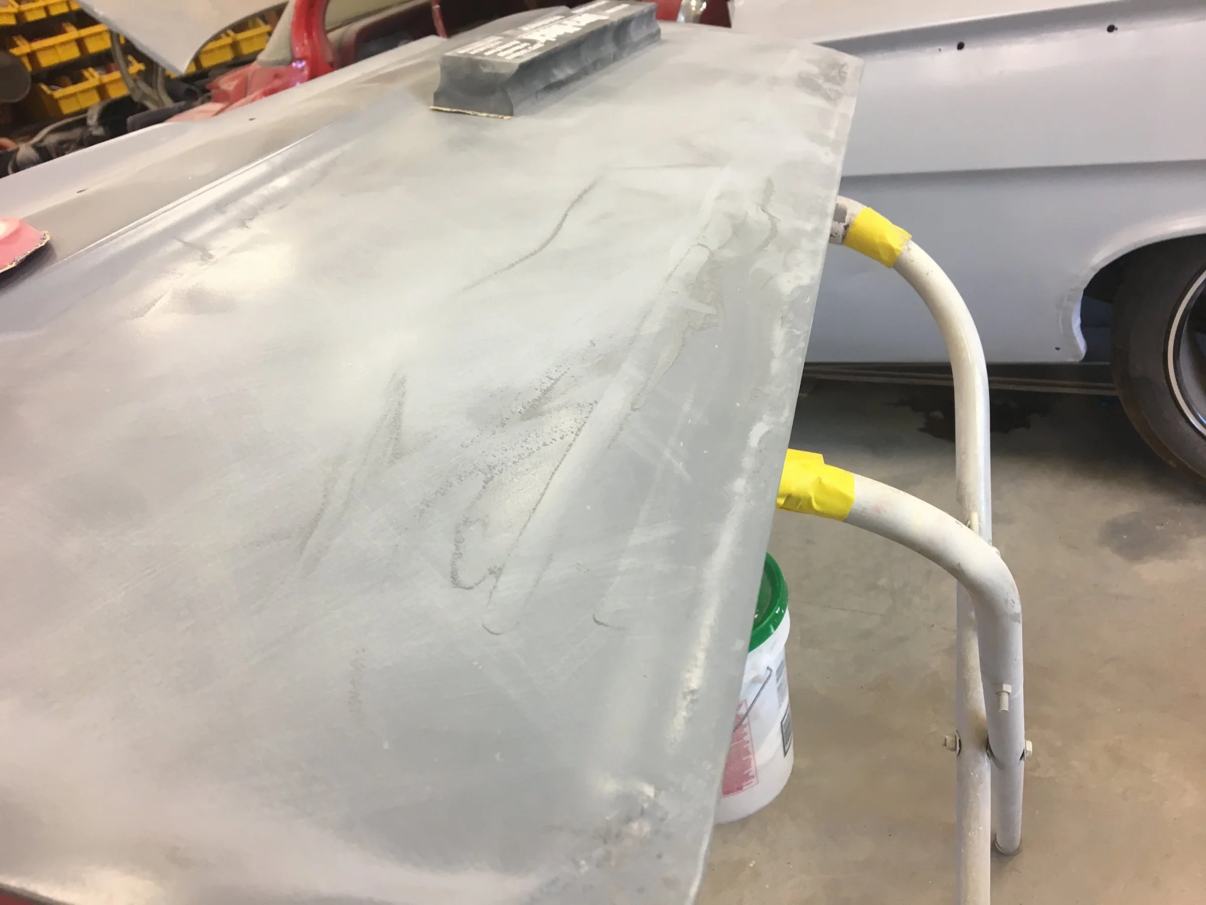

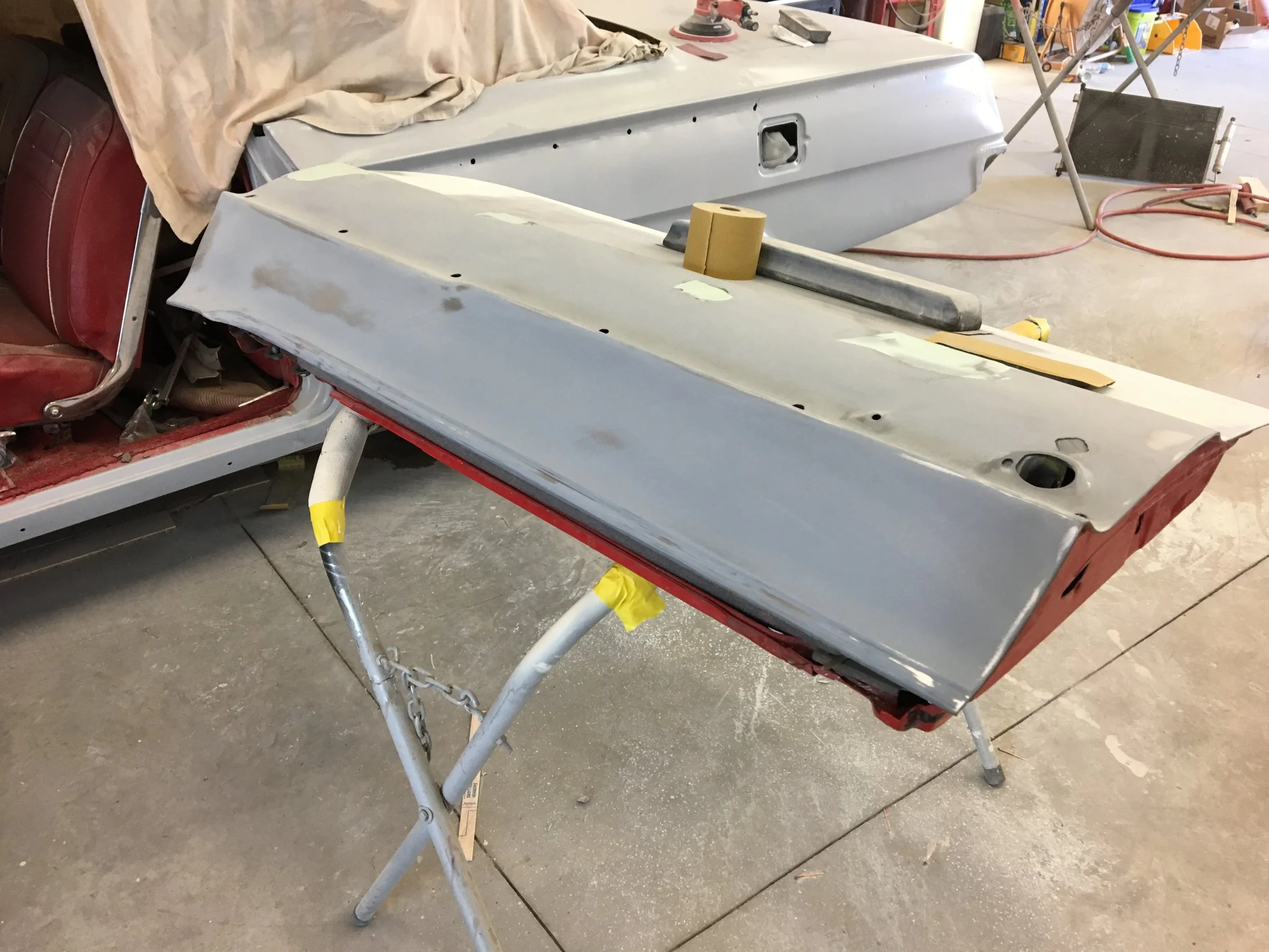

So, trying to do something constructive, I turned the door over and figured i'd get after the outside. It's very ugly along the bottom. I'm not too shocked there, I beat the living hell out of it to get the bodyline to match up to the rocker panel.
I hammered down the few outies and started to strip off the primer so I could pull the low areas out.:nonono:
This is when I found out TG had not ordered any new studs for his spitznagel gun.....Ok......He shows me his new to him dent puller similar to the one I used on my blue car's hood. Similar, just fourty years older. He got it at an auction for cheap, cheap, cheap.
What the hell, I'm willing to give it a go. We get it all hooked up and TG tries to zap it to the door. No joy. I look at it. The electrode is completely shot, to be expected with a well used part. I ask TG if he has a new electrode for it......:nonono:

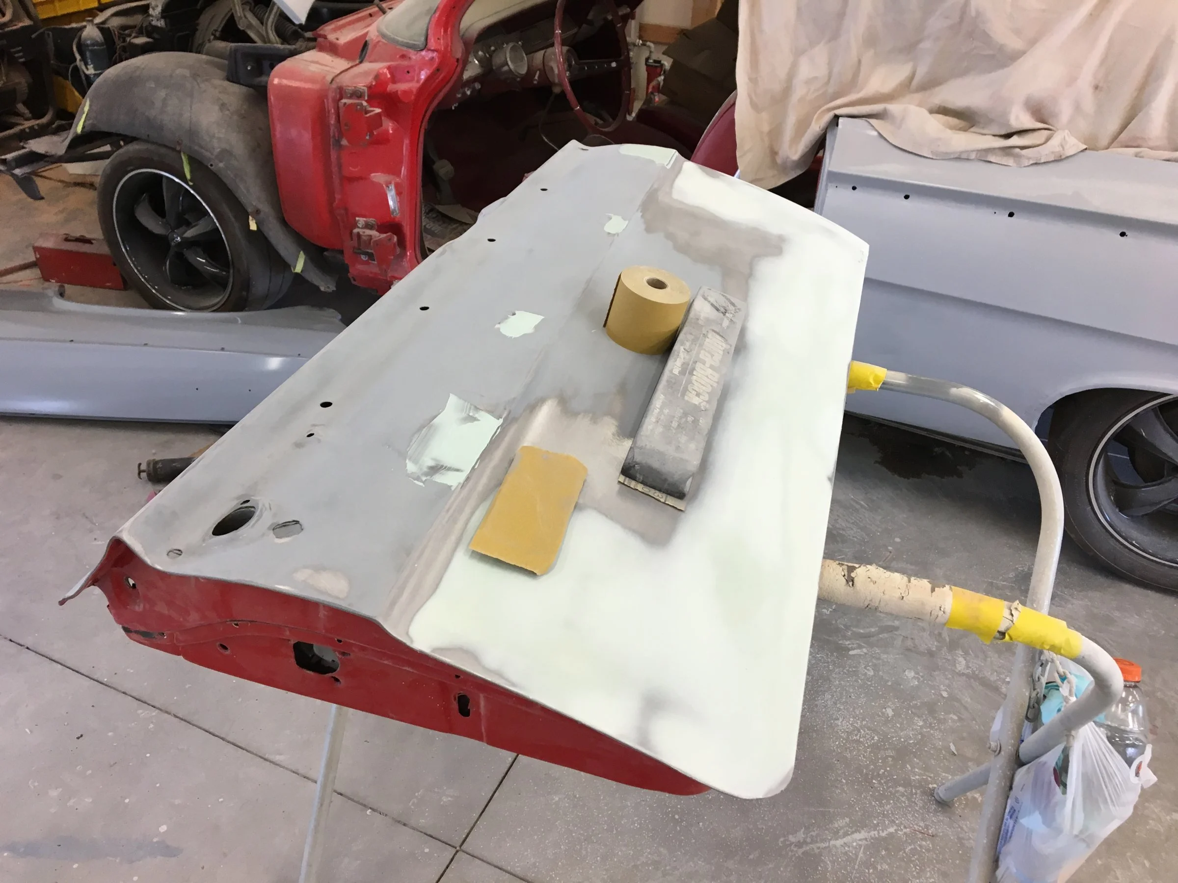

I ended up working on it mostly today. Though I did just finish the metalwork and most of the bodywork on the door. I'll finish blocking the mud and primer it before I go home tonight.
