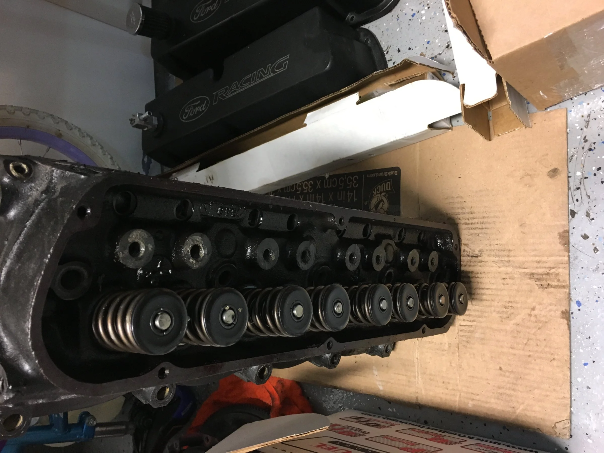

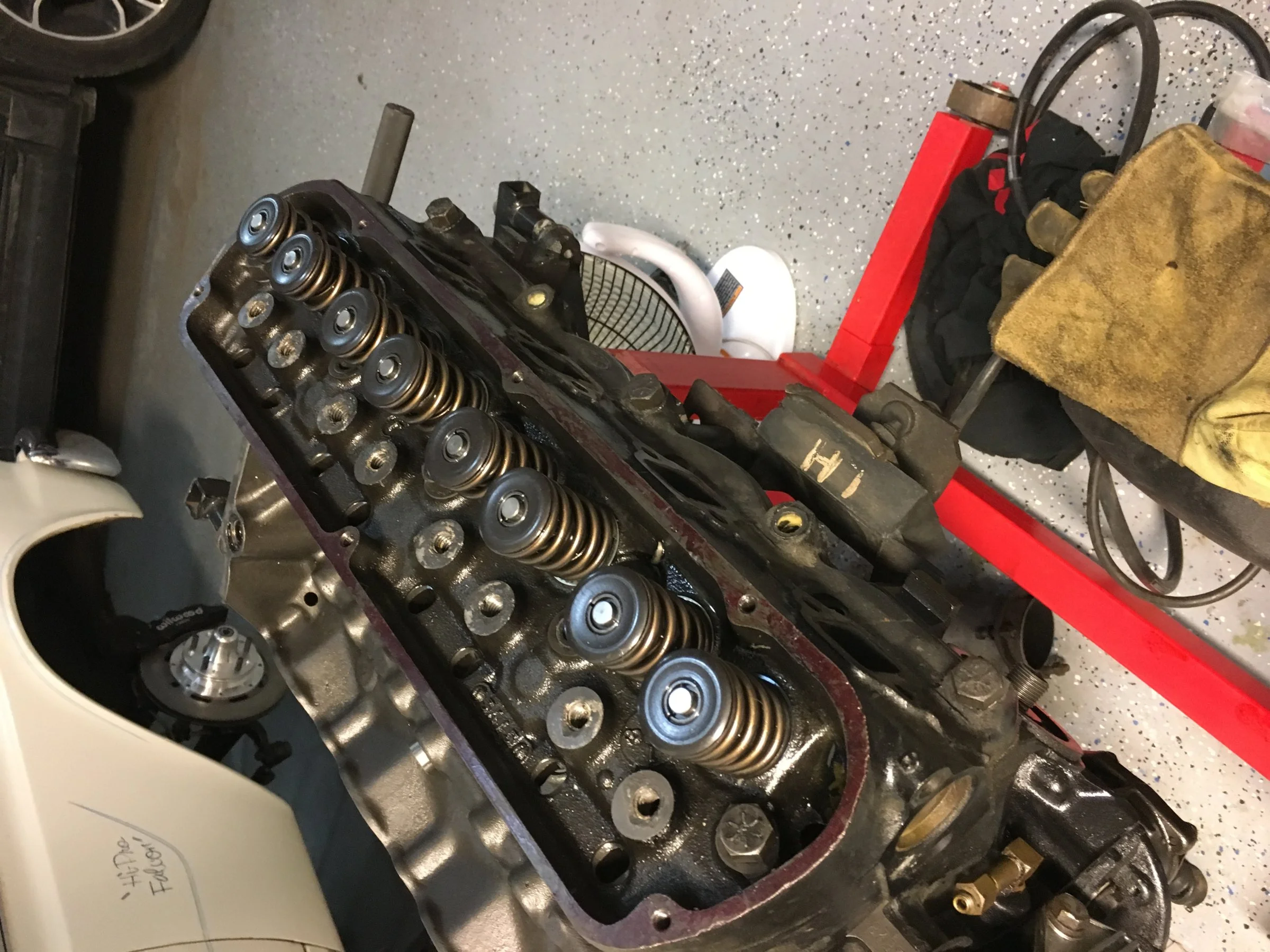

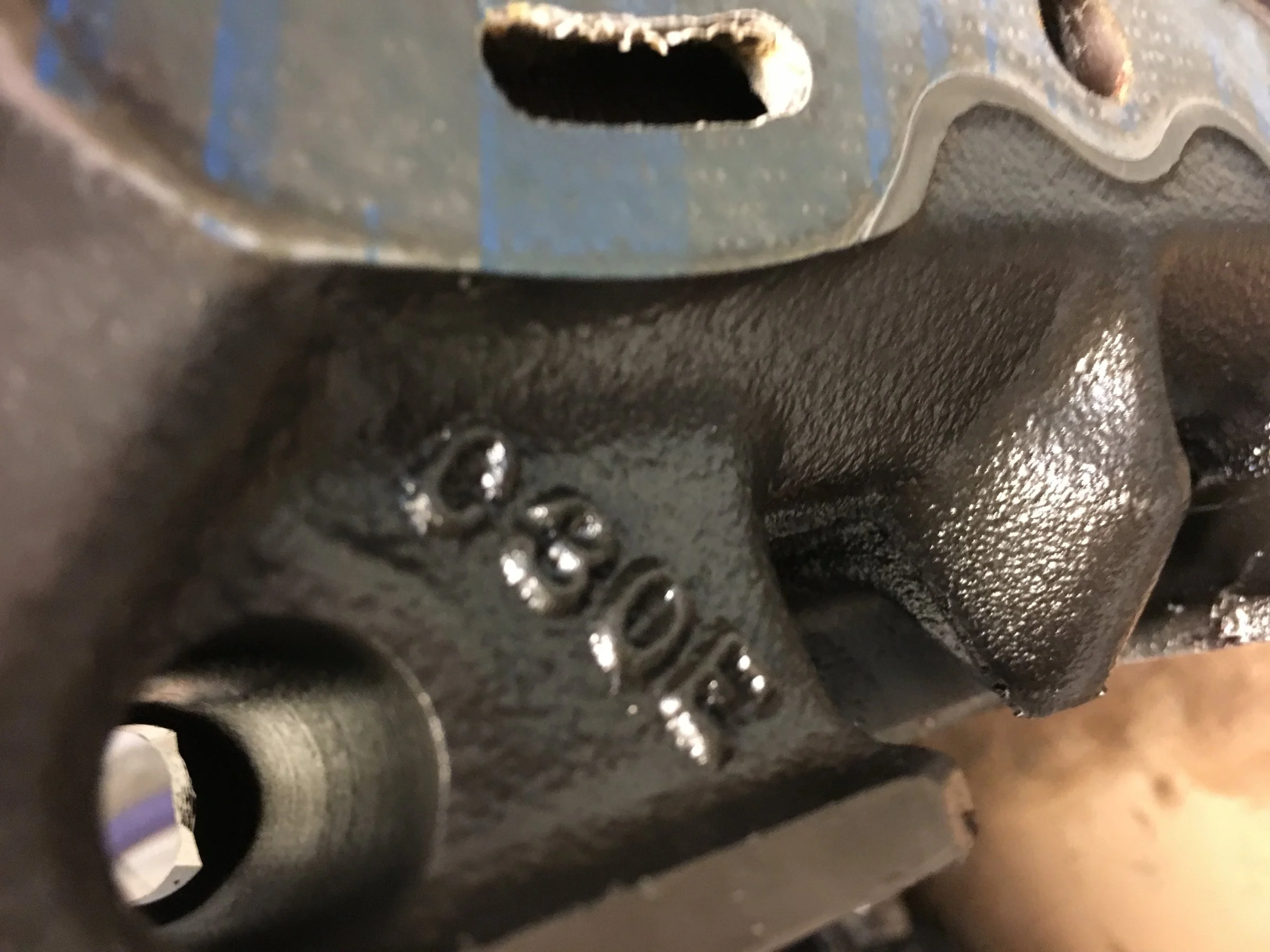

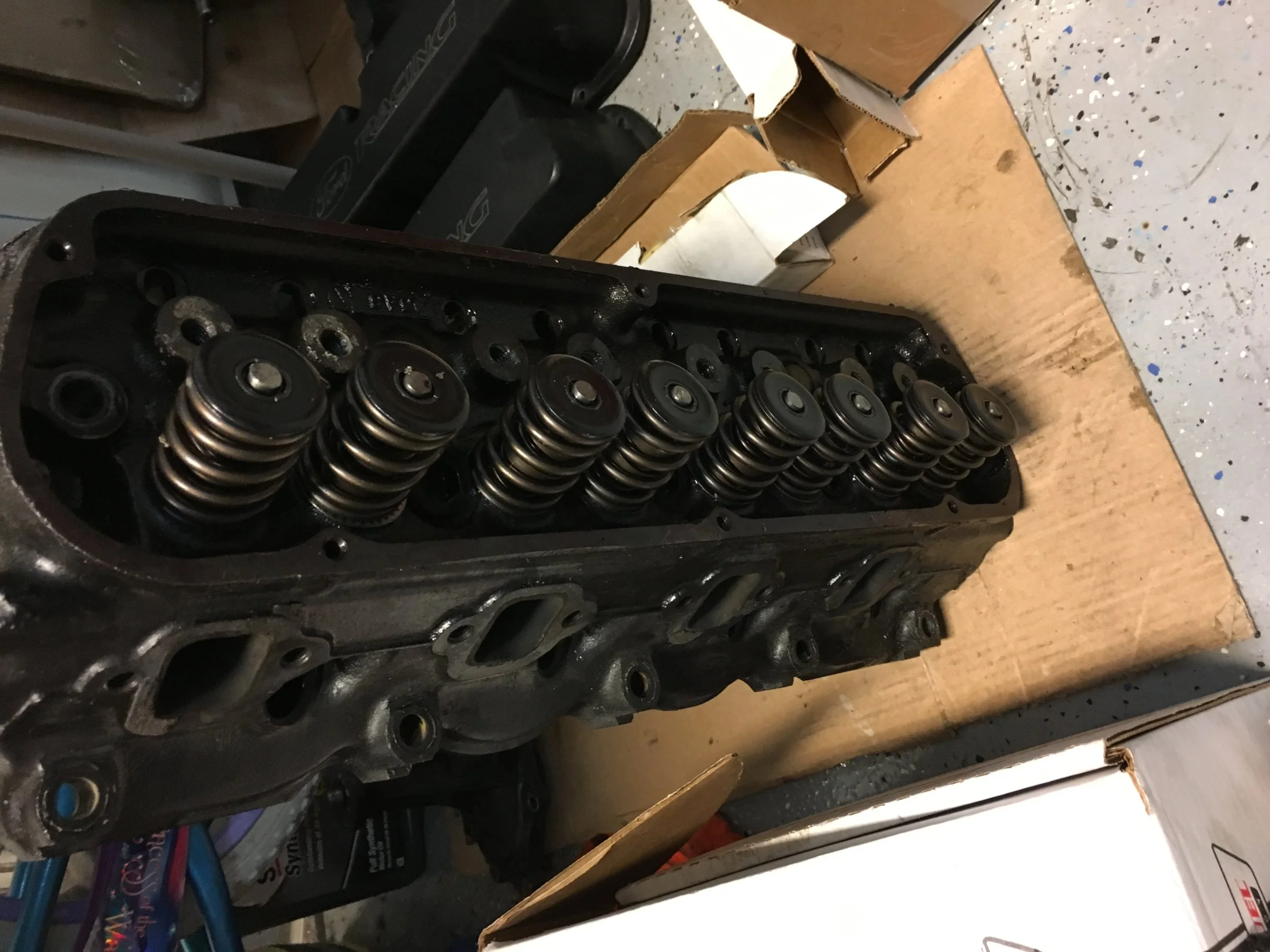

Hi I am considering purchasing a set of 289 C30E heads. The casting number refers to a 63 289 hip with 49.2cc however they don't look to have the spring perches. Anyone know what they may be? Anyone ever seen these before or have any ideas/opinions on them?

Those heads do not appear to have the machined spring pockets ,studs can be threaded so i wouldnt trust that alone .
Are there any other places on the heads with numbers ? There are actually several castings withe the prefix C30E , if there is any other letter past that they are not Hipo
