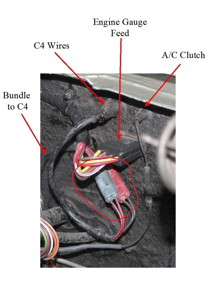

being that the 64 1/2 is the first of the mustangs then the wiring might be slightly different than later years but it should be connected to the larger harness that comes thru the firewall. It is basically wired into the wiring that goes to your starting circuit. Should be a two wire plug or a 4 wire plug.
It should look similar to these

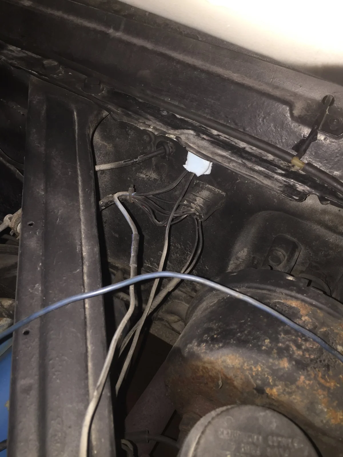

Okay. So here’s a pic of what I’ve got through the firewall. Let me know what you think. The bluish wire is not connected anywhere....the two wires that come out of the firewall with the blue piece of styrofoam plug... one goes nowhere ( the blue wire) and one goes to a sensor or something near the bottom of motor near the power steering pump. The other bundle of wires to the left of those goes to a motor or something attached to the firewall and some wires go towards starter solenoid
Well I can’t find any wires under the dash that could be the reverse lights so I guess I’ll find them under the scuff plate (black red) then run them through the NNS to a wire to battery with a 10 amp in line fuse.... what should I do for the shift circuit?? How do I determine which wires to spice those wires into. I assume it would be ones running to the starter solenoid but which ones? Also any idea what NSS to buy? 1965? 1966? Not sure if the tranny been replaced. Any tips to figure this out?
