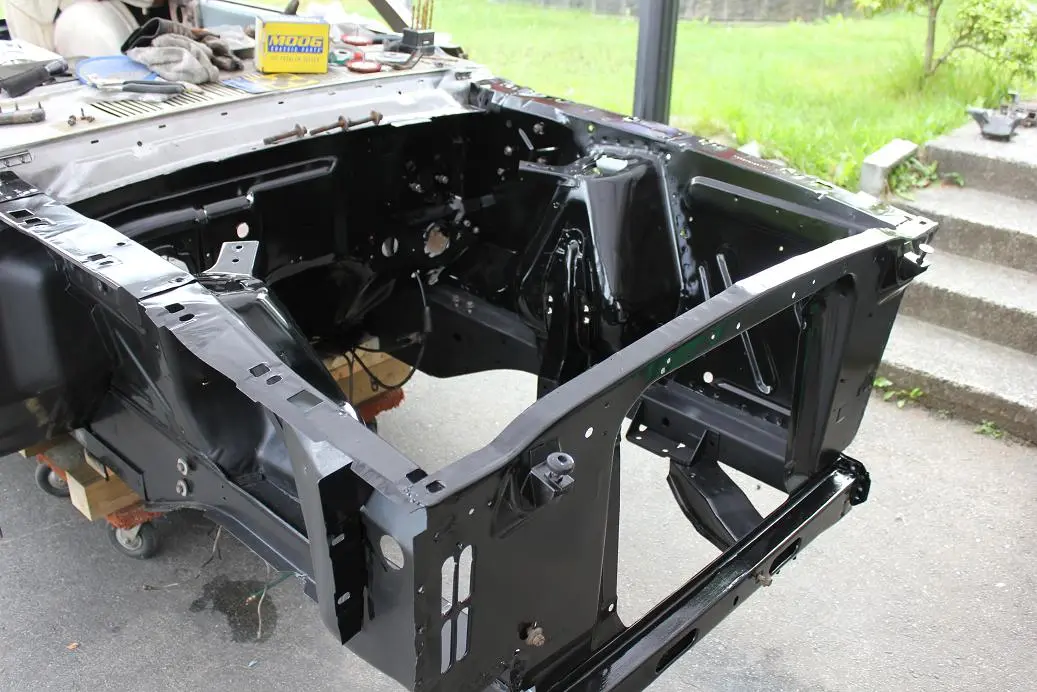

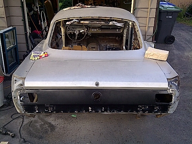

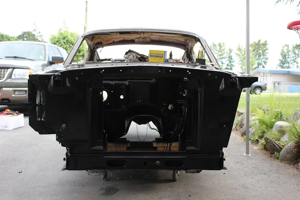

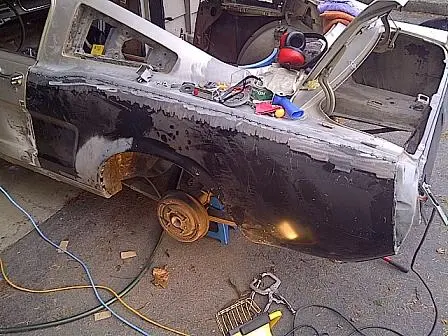

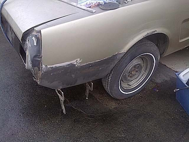

View attachment 71976 Thought I'd throw up a couple of pics of the progress I've made. Basically totally stripped the car down and have done the following to it so far:
Added some new pics today - (June 11th)

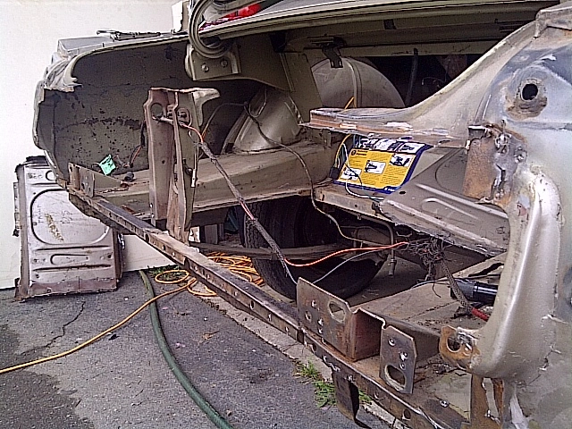

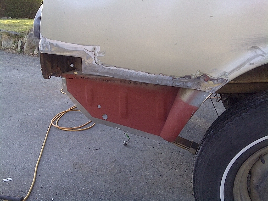

New Drivers rear quarter - replaced due to too much filler from previous repair
Lower patch on Passenger side rear quarter
New rear valance - again due to filler from old repair
New battery tray apron

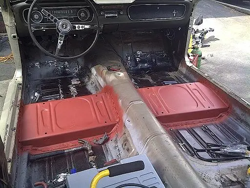

New floor pans

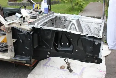

Engine bay stripped and is now ready to be sprayed (I'm using SPI self etching epoxy primer and will leave it as it dries 'satin')
Klaus Arning (Shelby) drop holes have been drilled
POR-15 applied to engine bay exterior and lower frame members
Upper control arms glass blasted and re-used. Rebuilt w/new parts
600 lowering springs going in
New Moog lower control arms
New Moog stabilizer bushings
All new steering linkage
Currently looking for a 16:1 steering box to replace original
1" stabilizer bar will be going in
Granada disc brake conversion will go on with new suspension - all parts ready

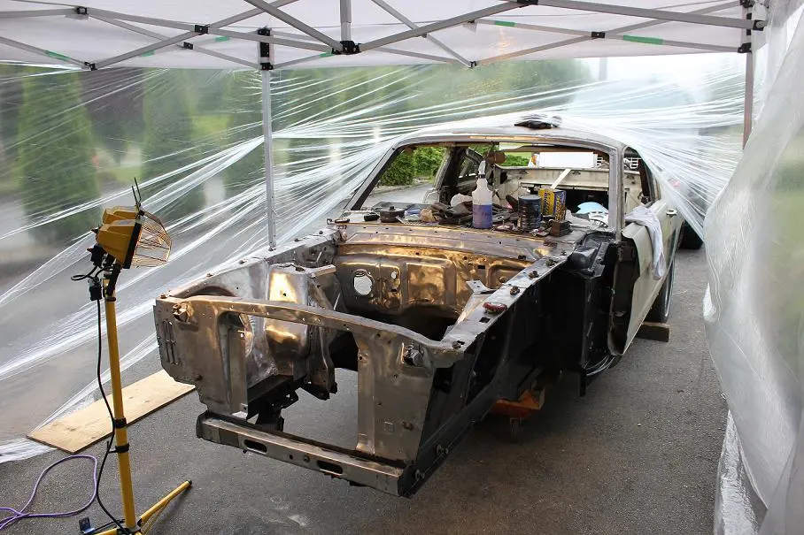

Thanks guys. I have learned a hell of alot along the way as I've done all the work myself. It's not perfect but pretty darn good I'd say. One thing I've learned is that you need to estimate your resoration time frame...then when you've got it all figured out, double it and add another 10%....8^O
The seam sealer is a b!tch. Hate that stuff. Also really bad around the front end cowl and cowl side panels etc. I have been using a nylon stripping wheel and everything comes out really nice until you hit a patch of seam sealer. That sh!t gets everywhere. I use mineral spirits to try and wipe it away once the stripping wheel hits it and makes a mess. That works ok.
For the tighter areas I went to a local auto parts place and picked up a small sand blaster. I've been using crushed glass with my compressor and it takes things off really nice in the tight areas. Makes a helluva mess on the driveway though so lots of sweep up afterwards.
I'm going to spray the SPI in the engine bay this weekend so I'll post a pic and let you know how it turns out. My hope is that if anyone has any questions about the way I've done things I'd be glad to help if I can.

Put on some new pics today. Sprayed the engine bay over the weekend and I'm quite happy with the result. Not sure why some of the pictures doubled up on the post but you'll see the progress. Am now starting to install the front suspension components.
