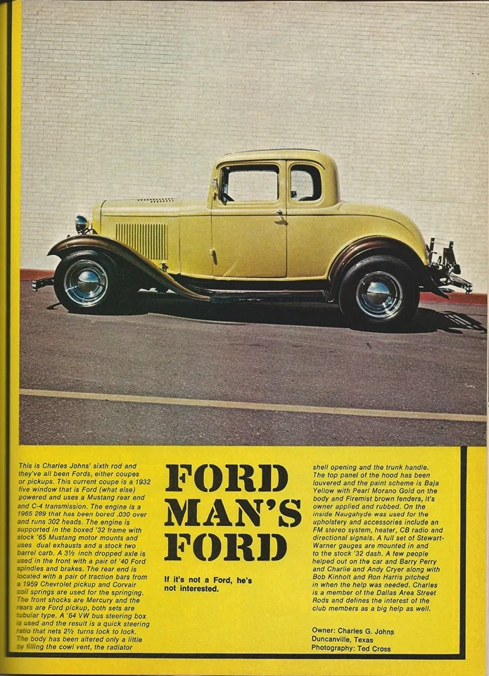

I put a 289 out of a Mercury Cougar (same as Mustang), put a 303 three speed (full-syncromesh) behind it, with the BIG flywheel from a 4 door sedan, installed 2.79 rear gears turning 29" tall radials, then built the motor for torque in the 2000 to 3500 rpm range. Why? In a light 1940 Ford coupe and built to breathe in-and-out at those rpm's (truck cam (van), cast-iron headers, straight-thru little 24" mufflers, Mallory dizzy with vacuum advance, hot coil (I forget which brand but it would weld your butt-crack closed if you got hit), Autolite 2100 carb, Dupree electric fuel pump, flex-fan, bored .040", and lowered to cut highway speeds wind drag. At 55 to 90 mph...and occasionally above...it would run a hole in the wind getting 25 mpg! Why 3-speed? Gets into high gear quicker. Why 2.79 gears? Slow the engine to where the Van cam works best (makes torque). Why 29" tall tires? Every tire revolution it is farther down the road. Why the bigger flywheel? A mass in motion tends to stay in motion, is a law of physics that applies to motor setup. That flywheel was about 10 pounds heavier than the Mustang/Cougar, and once I got up to speed I just tapped the throttle about every hundred yards to keep it at speed. That is a little over-stated, but not by much. The 289/302 is a fine motor for just about every application.

The early 65 289 bell-housing had a smaller bolt pattern than the later 289, but the trans was still a C4. Depending on engine-trans combo, the flywheel must be fitted and balanced to the particular engine. Too many years ago but I put a big-car flywheel behind a Mustang 289 and had to make some mods...but don't remember what they were. It seems the crank harmonic balancer and flywheel balance had to match.

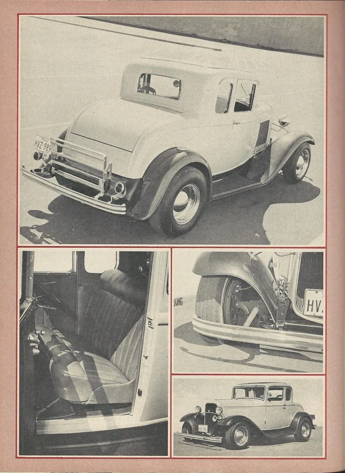

Charlie Cheap
Jun 5, 2018
93
18
76
Abilene, Texas
This 32 coupe I built in the 70's had a early small bell-housing and later OD transmissions would not fit. Also, my 65 200 six will not work with any Overdrive due to odd bell-housing.
