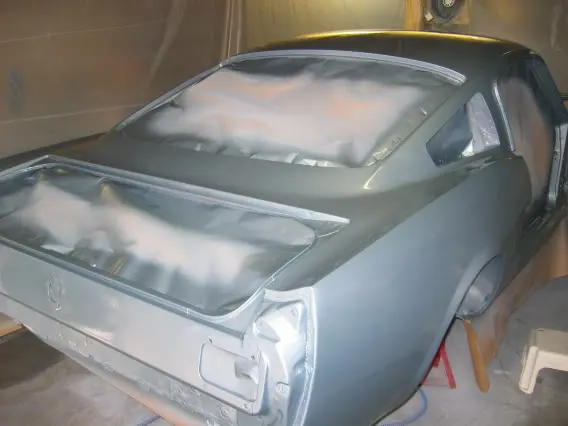

I built a temporary frame out of 2x3s inside my garage. To this I attached heavy plastic sheeting on all four sides and the top. I made doors that latched with hook and eye screws. The fan was an attic fan from Home Depot. I connected the exhaust side of the fan to a cheap plastic duct to route the exhaust outside. I used a couple of large hvac filters in a window for fresh air. Most importantly I used a fresh air respirator with hood. The chemicals in bb/cc can harm/kill you and it's just not worth risking exposure with just a filtered mask. The respirator I used had a 50' hose and I couldn't smell any paint fumes.

Here are a few shots of the homemade paint booth.

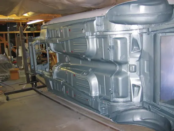

It was a little tight and yes I was sore. However, for most of the job I had the car on the rotisserie. Made things much easier. I could push the car from side to side and rotate to get at hard to reach areas.

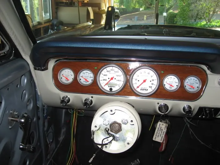

I hadn't mentioned the interior yet because it's not as far along as the rest of the car. Once I'm sure I have all of the gremlins worked out I will assemble the rest of the interior parts. The car came with the original white/blue pony interior. I like the two tone Pony interior but had to update it some. I went with a JME 6 gauge instrument panel. I can't stand the look of vinyl wood so I bought some walnut veneer and using a vinyl woodgrain kit as a template I cut out replacements for the instrument panel, glove compartment and consol. I then mixed stains until I came up with a color that matched the wood steering wheel I bought to replace the original plastic "wood" wheel. I put about 20 coats of spray can polyurethane on each piece.

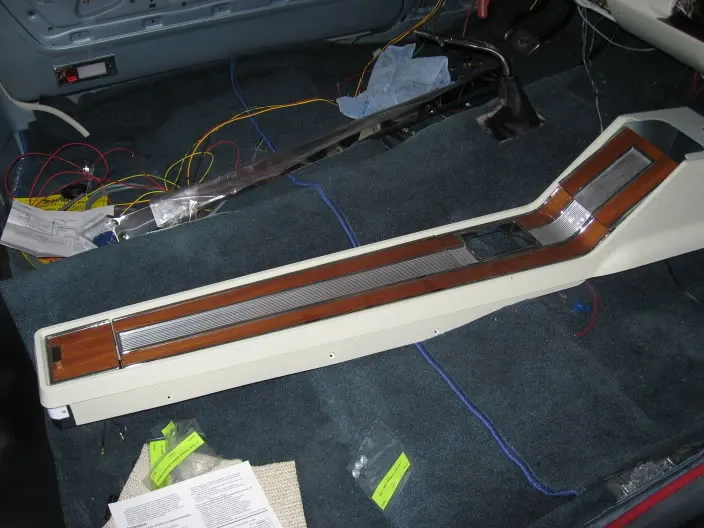

I'm using a repro original style consol with all new parts and the above mentioned walnut veneer.

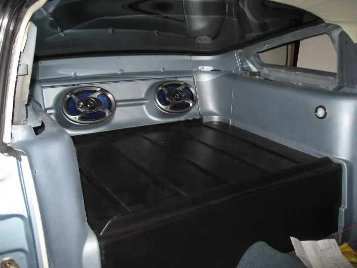

In the interest of weight savings I removed the rear seat and fold down (80lbs!) and replaced it with the Shelby style shelf. I'll probably cover this in carpet.

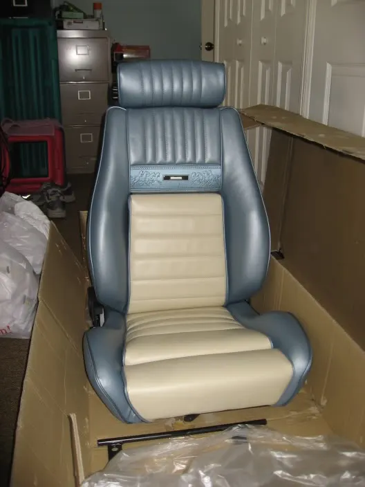

The seats are Flo-Fit with the blue/white pony colors.
The carpet is cut pile instead of nylon loop. I converted the windows to power and mounted an Autoloc switch in the position of the orginal crank handle. Even though the switch was suposed to fit Fords it didn't. I had to drill and tap a hole to attach the crank handle and I had to re-spline the shaft to accept the crank. However, it works and will look original.

I bought the seats from JMC Motorsports for $1545/pair. They are available in white, black and the blue/white like I have. The are essentially the same seats found in Fox body Mustangs but reupholstered to look like Pony seats.
trap door
jcode68,
I bought the trap door from Sacramento Mustang for $240 including speakers. Mustang Depot now carries them and lists a door for 67-70 models for $119 without speakers. I had to drill new mounting holes for the hinges to get it to line up correctly. You also have to cut out the opening for the speakers. It sure beats cutting up the original and the you can still use the trap door feature. I have the matching kick panels in front.

Gotta love the home paint booth - I've painted a couple cars in my garage the same way. :nice: I found that if you mount the fan up high like you did and have it pull air out of the garage, but put the filters down low at the ground, and wet the floor before you spray, you'll get alot less junk in the paint. Wetting the floor presents new opportunities to screw up the paint, but it does reduce the number of particles floating around in the air.
