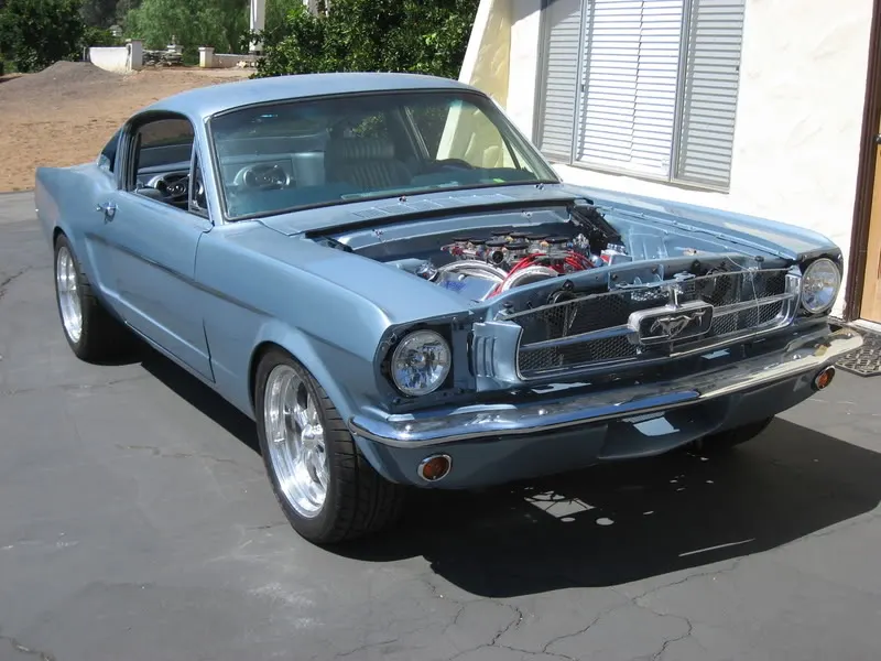

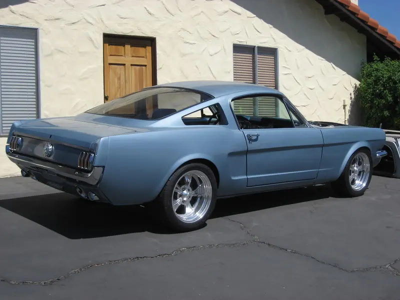

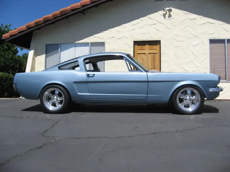

I drove the Fastback for the first time today! Of course it was only from the garage to the upper part of the driveway but it drives. The front end isn't close to being aligned, the brakes felt like mush and there's no exhaust but now I can clean up the garage for the final push to completion.

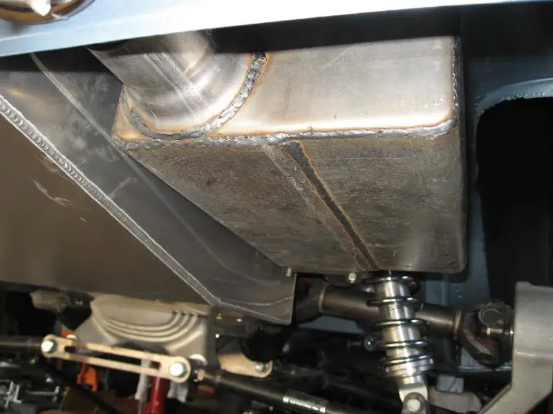

Exhaust

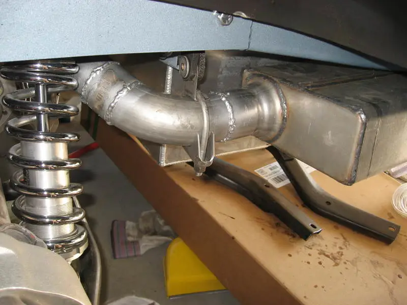

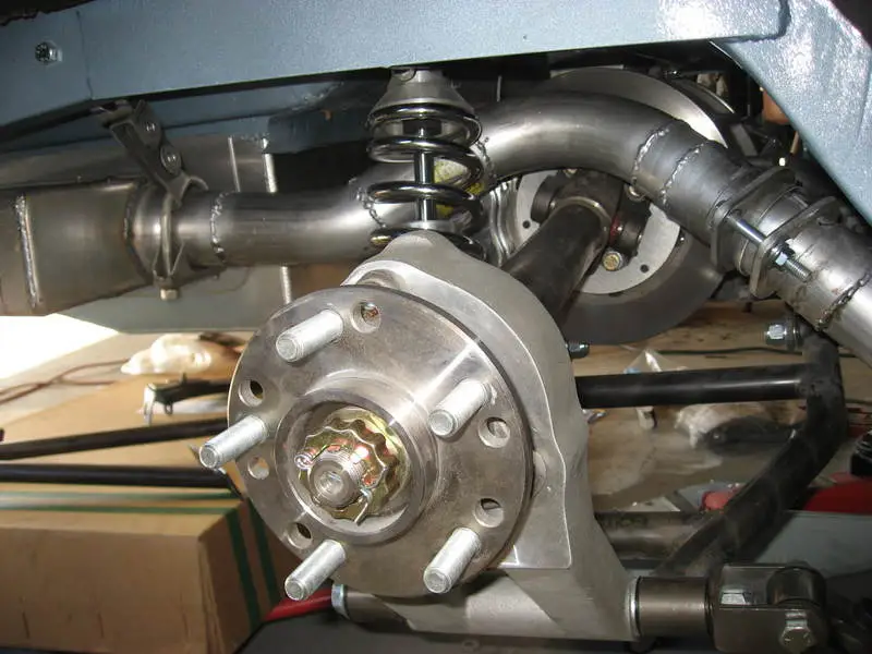

I knew from the beginning that the exhaust system on this car would be a challenge. Unfortunately I really didn't plan for it very well. I wanted full 2.5" with an X-pipe and exiting through the GT valance. After installing the TCP subframes with cross brace it became apparent that the 2.5" X-pipe would not fit. I finally decided to modify the cross brace to make room for the X-pipe. I would have removed it completely but I modified the rear part to mount the forward struts of the IRS. Also, 2.5" looks much bigger under the car than outside in pieces. Anyhow I built the exhaust system out of various J-bends, U-bends, straight pipe and couplings. I built one section at a time cutting and tac welding as I went. I included ball and socket connectors at the front and rear for easy removal.
I lost count of how many pieces are in this.
It's tight in there.
The mufflers sit where the leaf springs used to be.
And I even managed to get them to exit through the GT valance. These are Spintech mufflers and they sound good so far. After starting the car with open headers so many times I wasn't sure the car was actually running at idle. They wake up as you rev the engine. If I really work at it I might have the car driveable this weekend.
