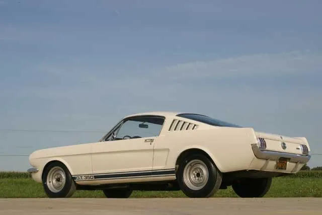

This is a remarkably original 65 GT 350, right down to the tires. The rear nameplate has never even been straightened, having been installed a little crooked.
1965 Shelby GT350 - Mustang Monthly Magazine
