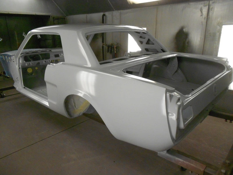

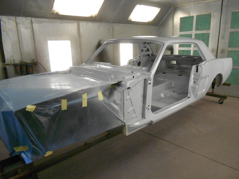

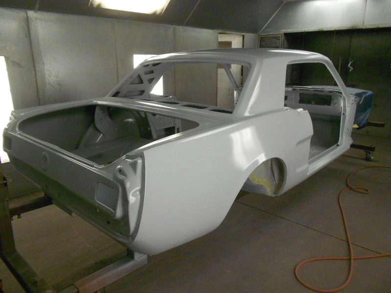

Block sanded the body and fixed a few minor imperfections, taped and epoxy primed.
The rear wheel wells have not been taped in this photo
Epoxy primed

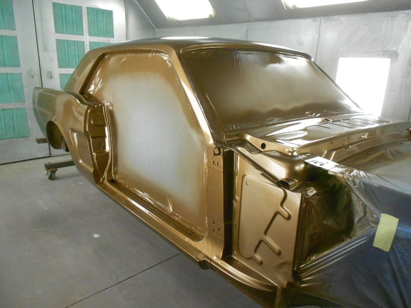

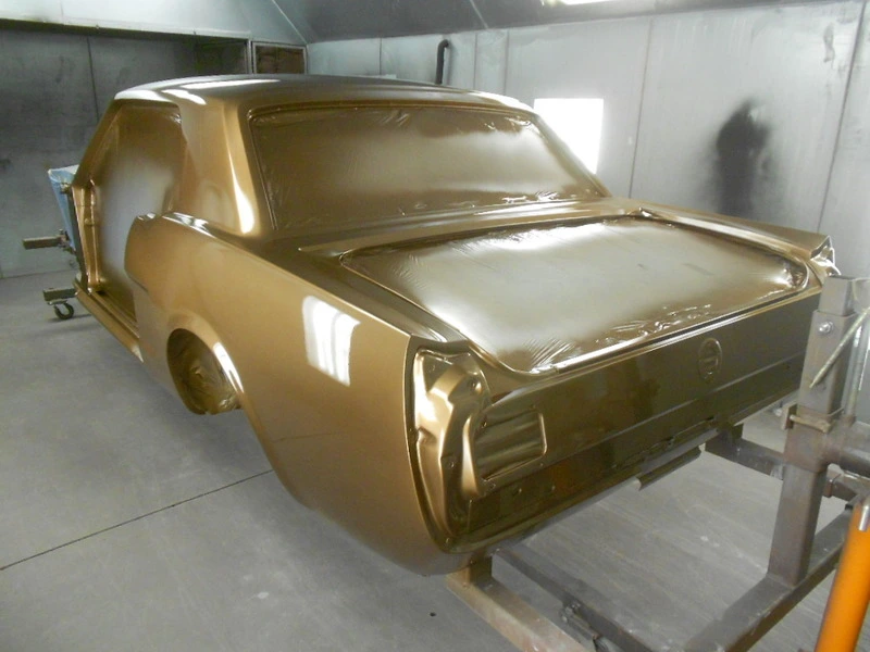

Wet sanded with 600 and sprayed three coats of Caramel Bronze metallic yesterday and this morning 3 coats of SPI Universal clear.

That is just beautiful Rusty . I am getting ready to paint my 66 coupe to fast back conversion .It will either be prairie bronze with black stripes or candy apple red with black stripes .But i am leaning towards Prairie bronze and black ,prairie bronze almost glows when clear coated .
