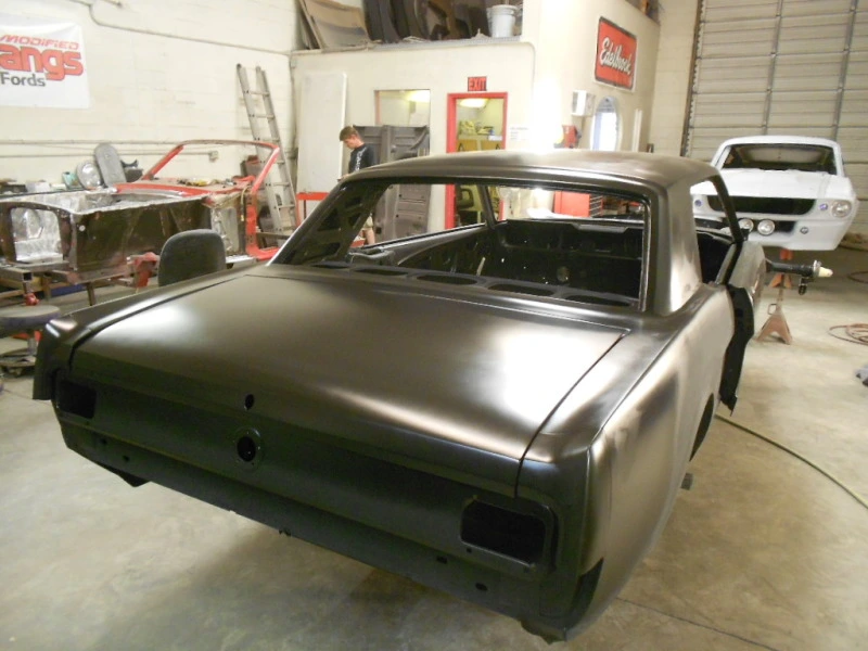

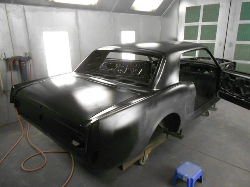

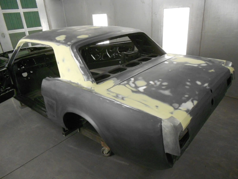

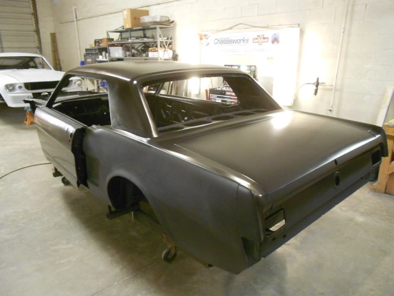

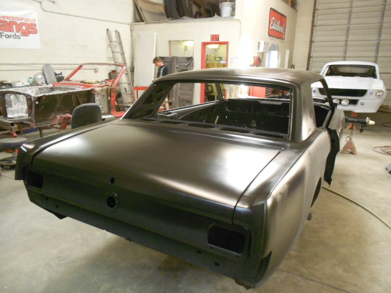

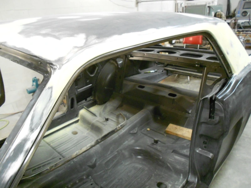

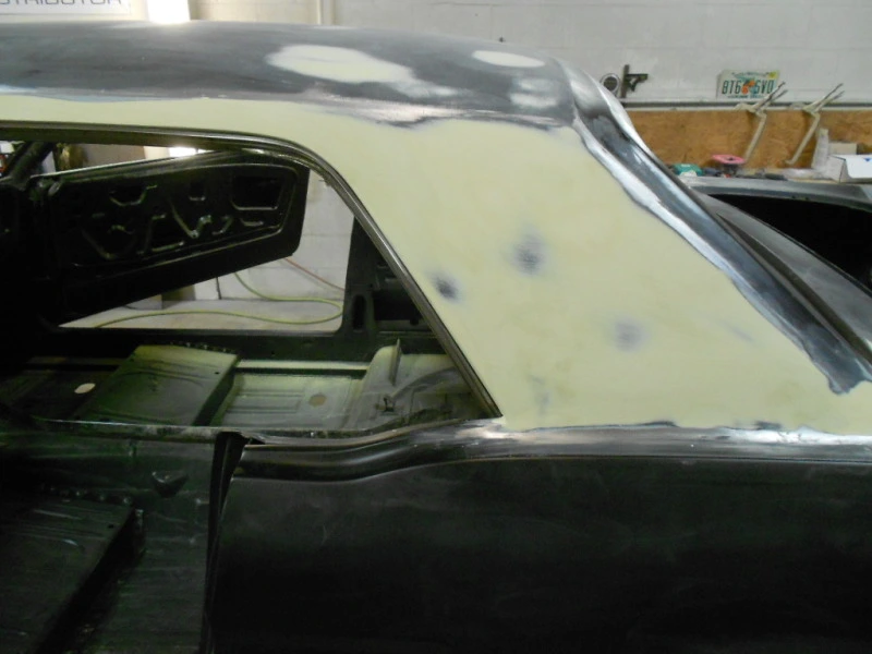

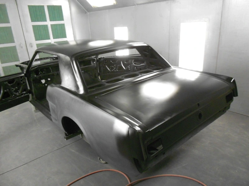

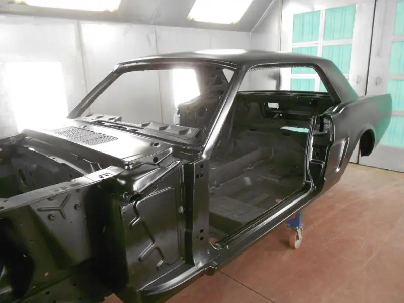

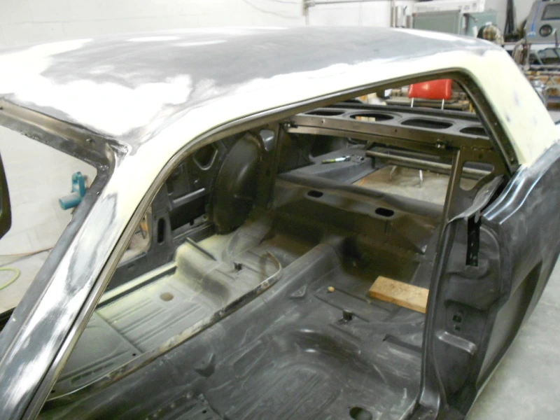

I have the major bodywork finished on the roof.

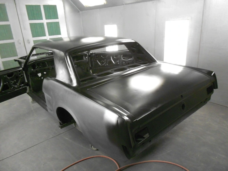

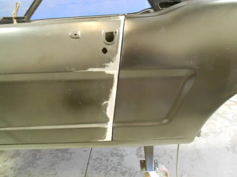

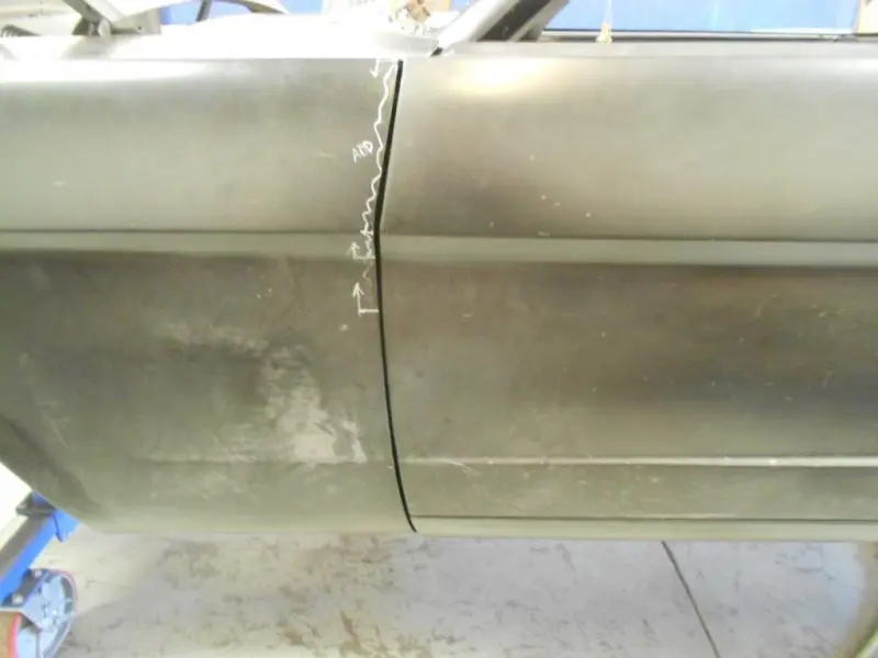

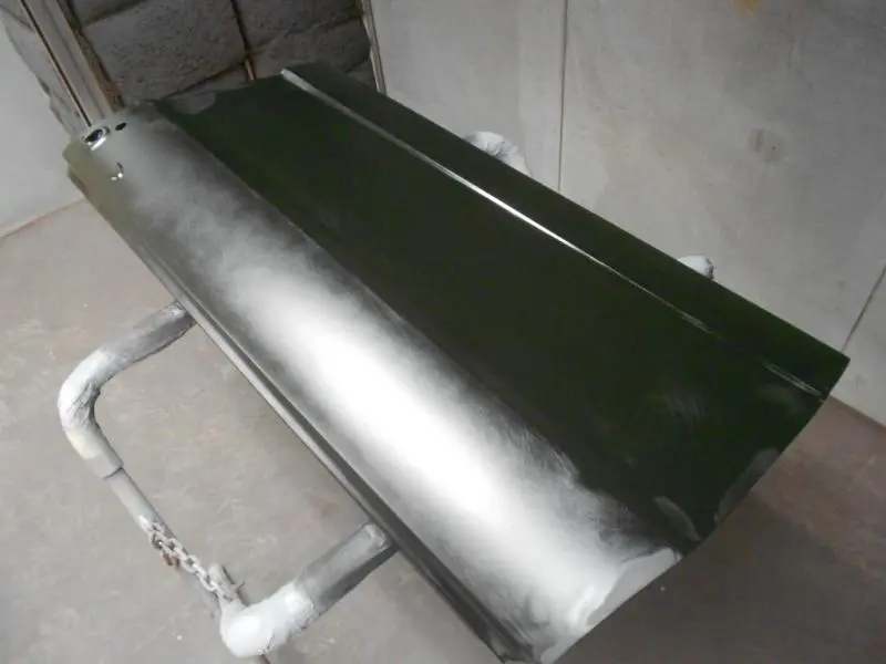

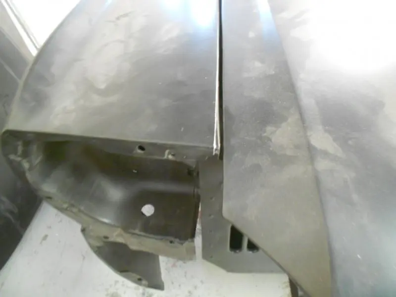

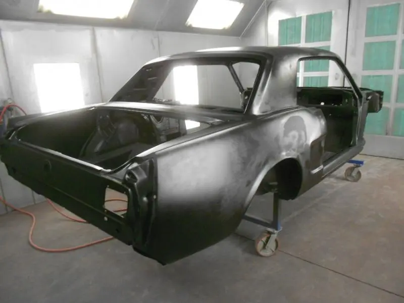

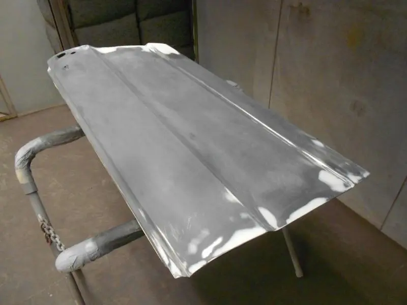

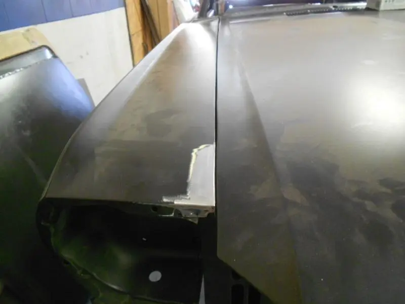

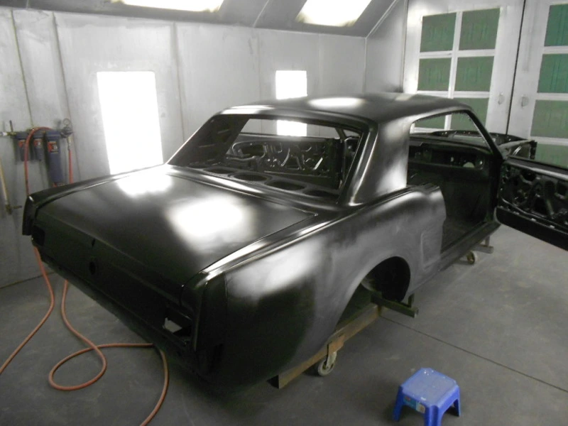

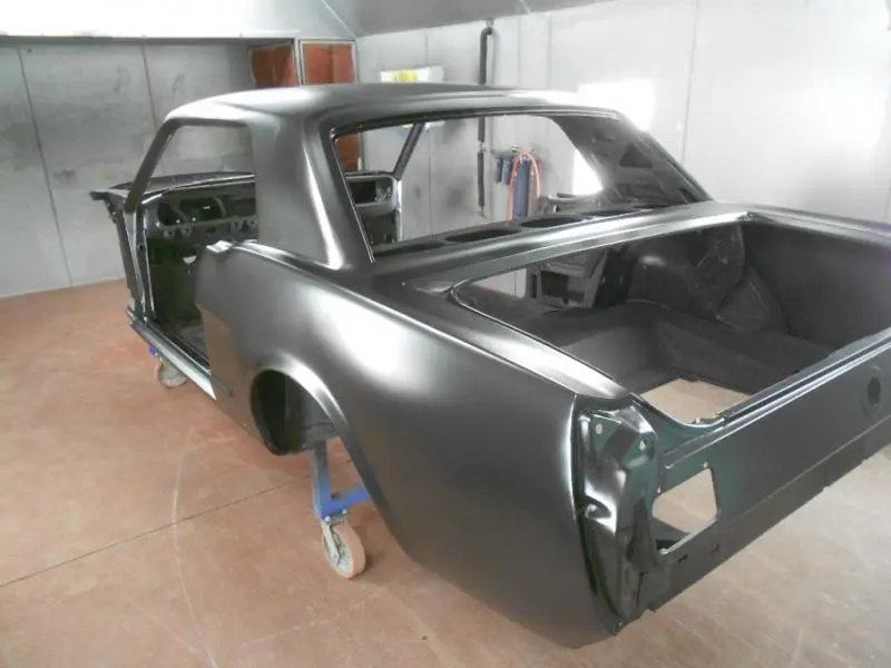

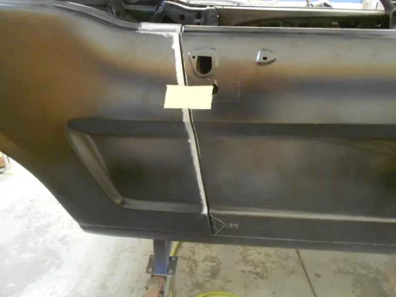

After Brian modified the doors for a good gap I epoxy primed followed with a little bodywork
I sprayed one coat of SPI epoxy
A couple of hours later I sprayed two coats of Slick Sand polyester primer

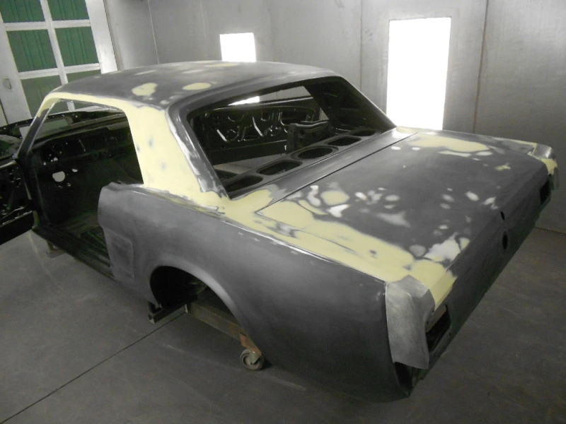

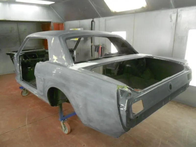

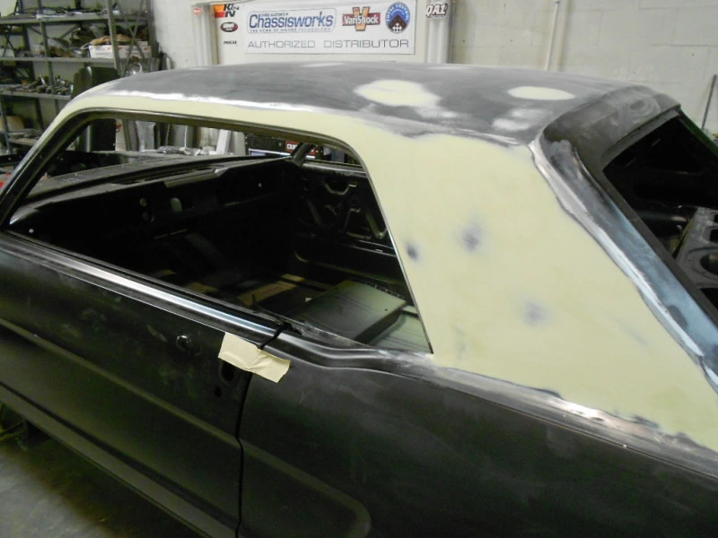

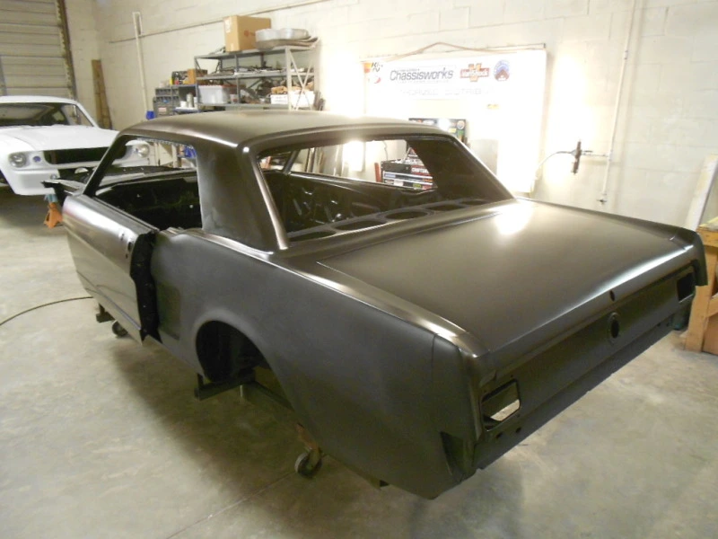

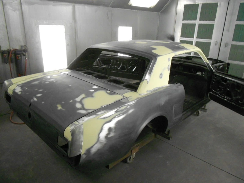

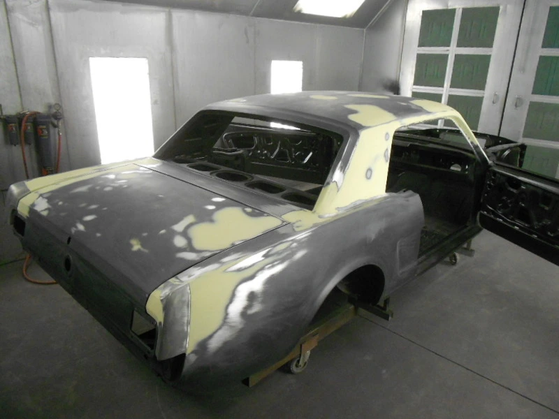

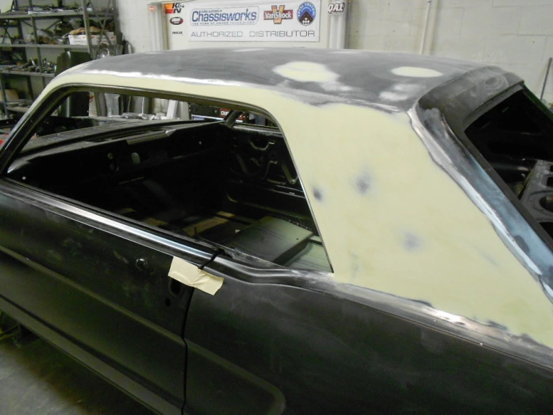

We were not happy withe the quarter panels so I did a little more bodywork and block sanding

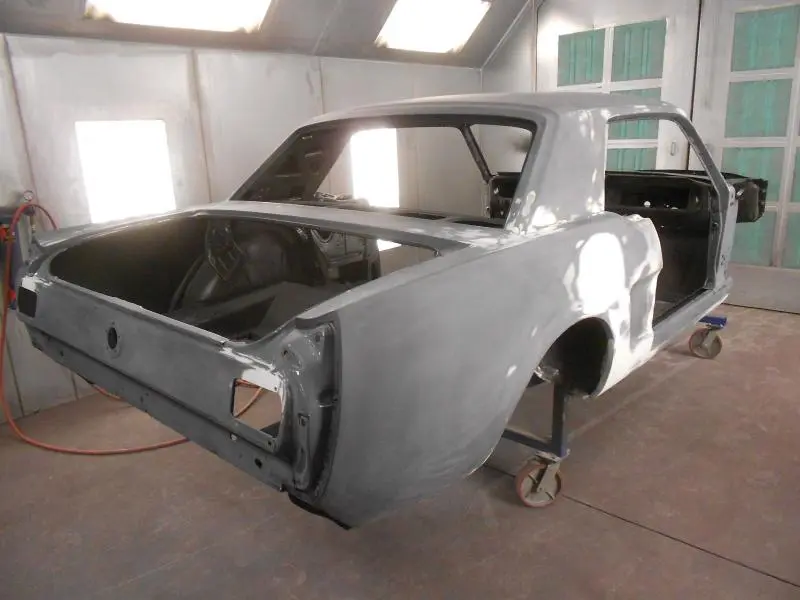

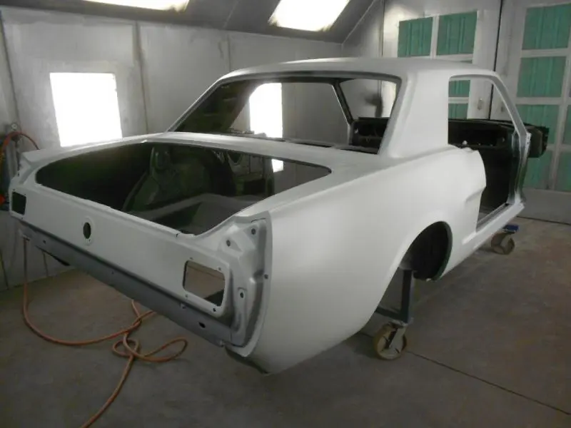

One coat of SPI epoxy
Two coats of Slick Sand
