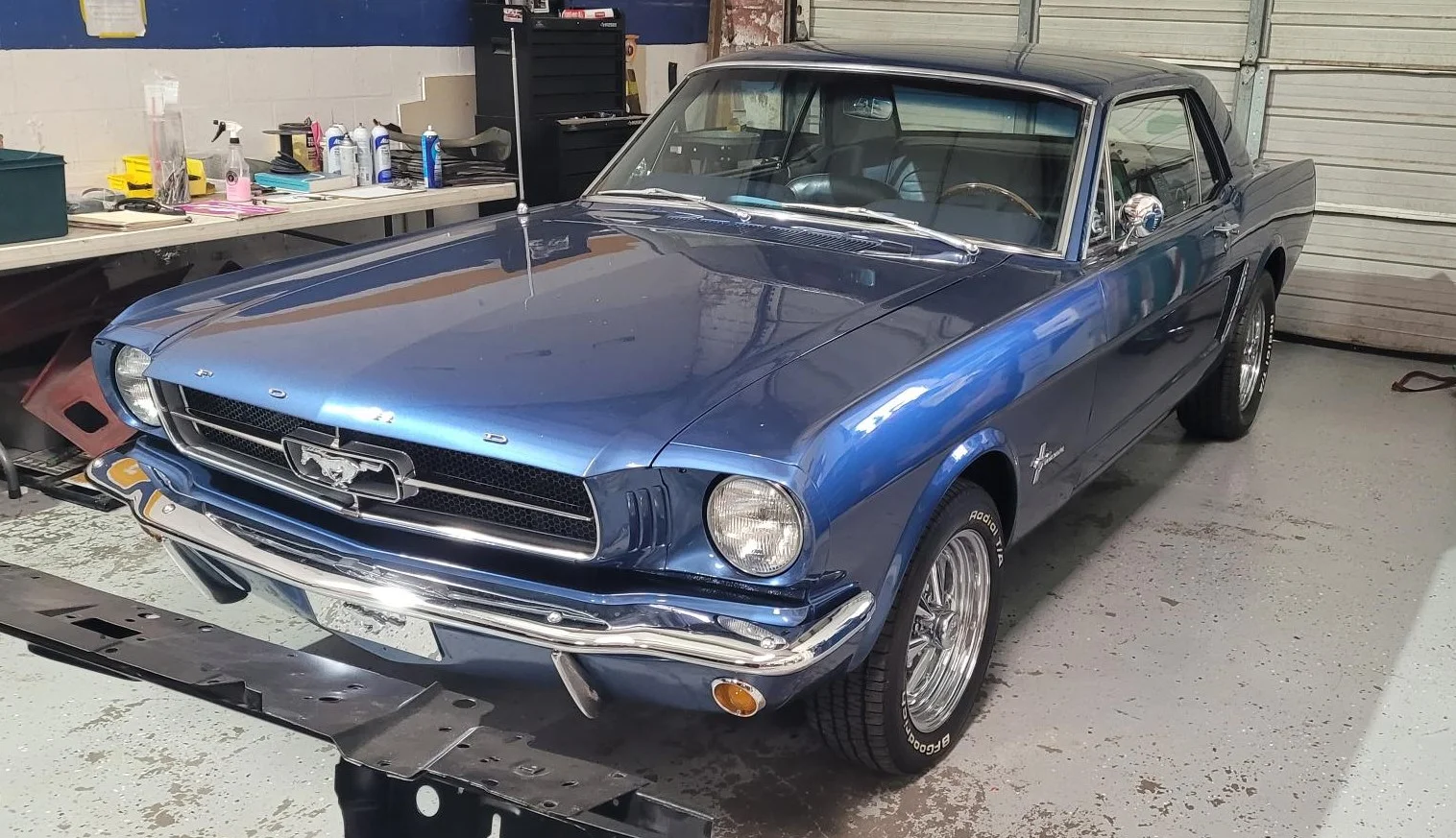

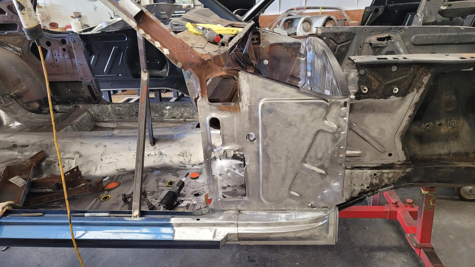

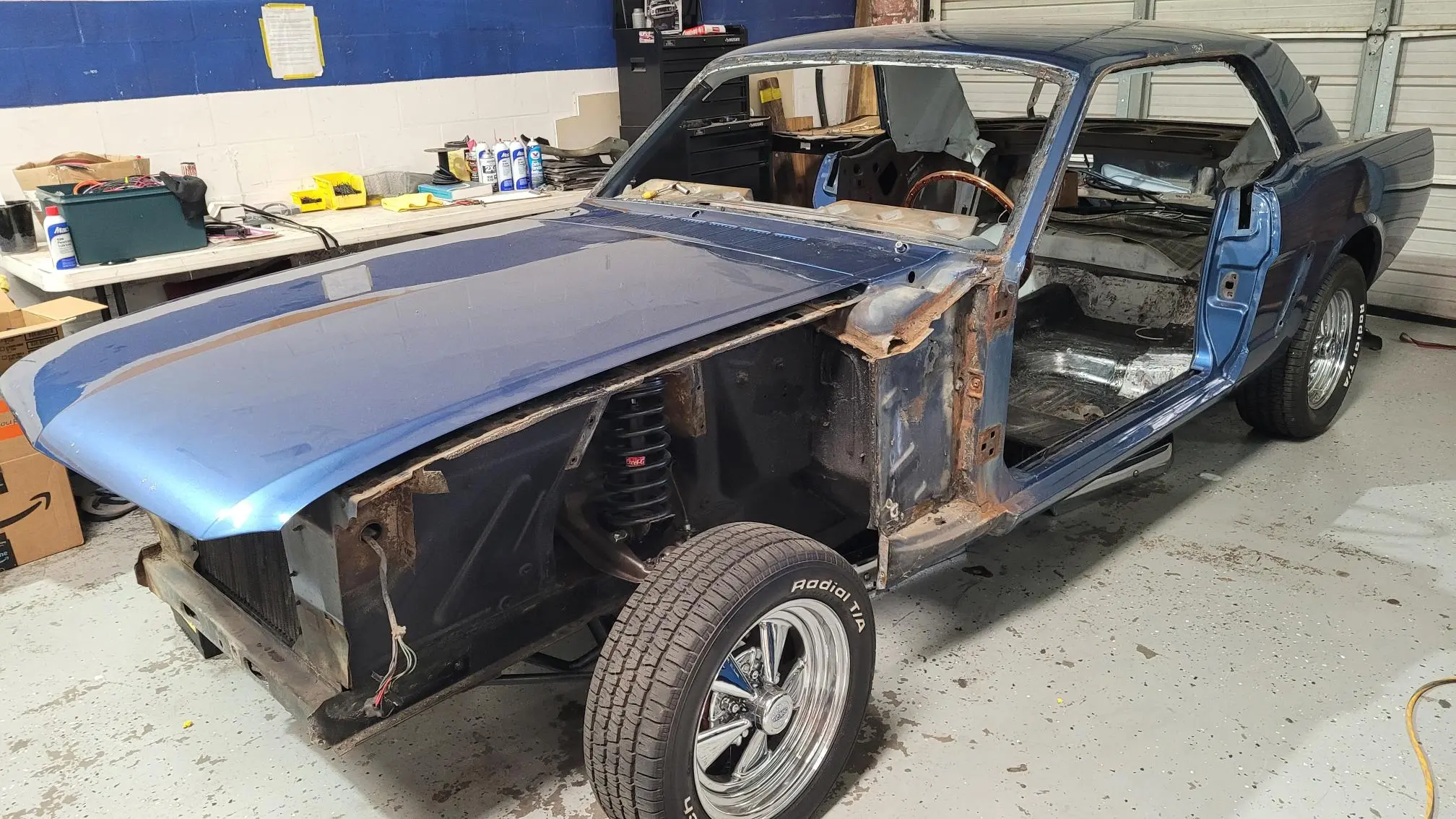

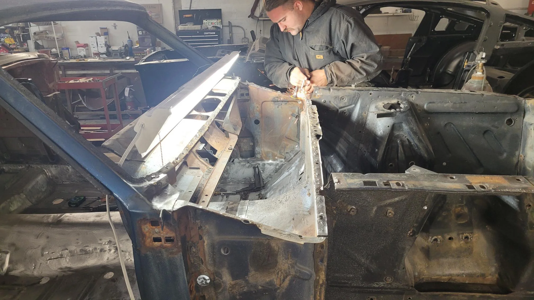

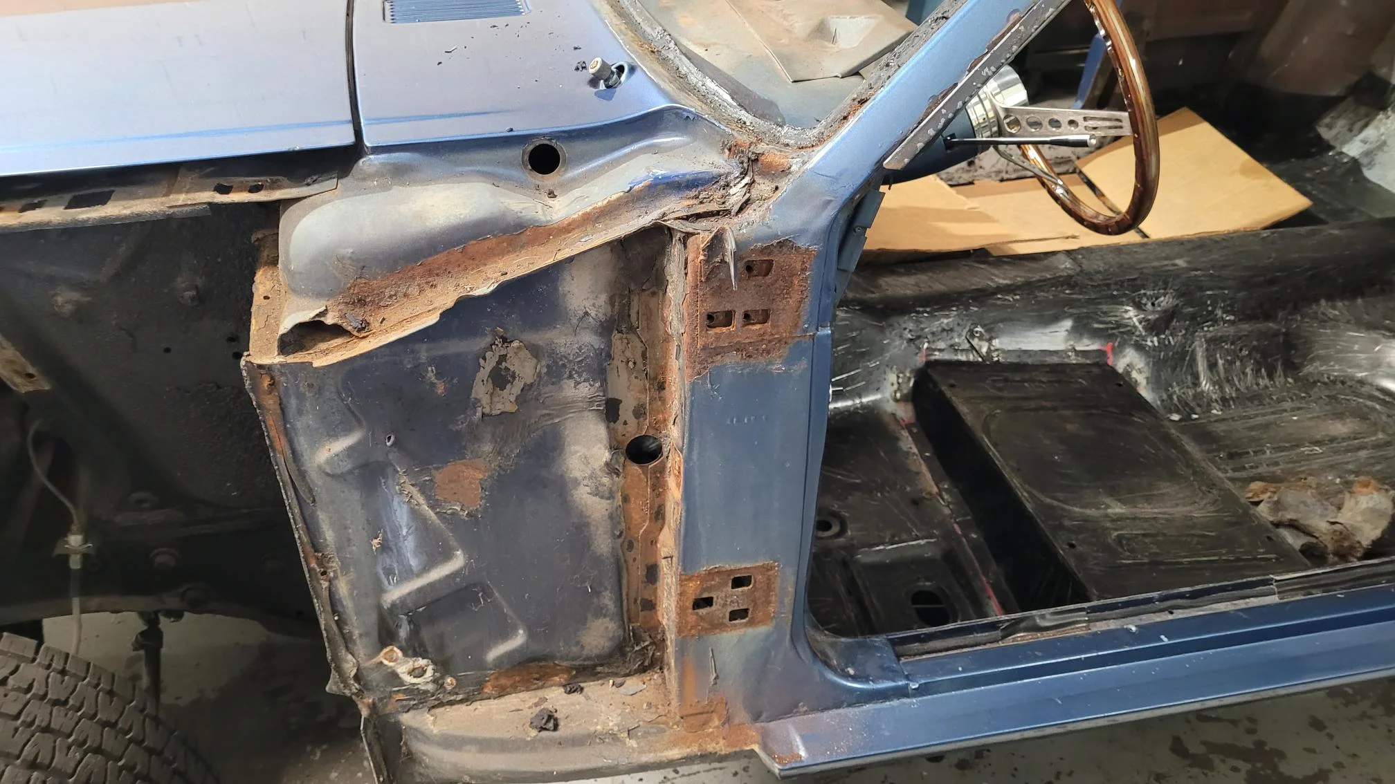

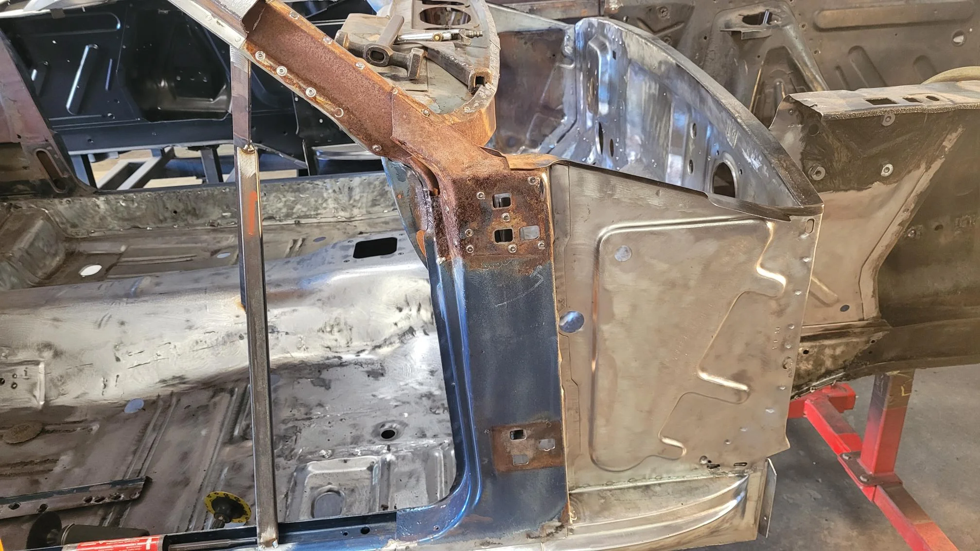

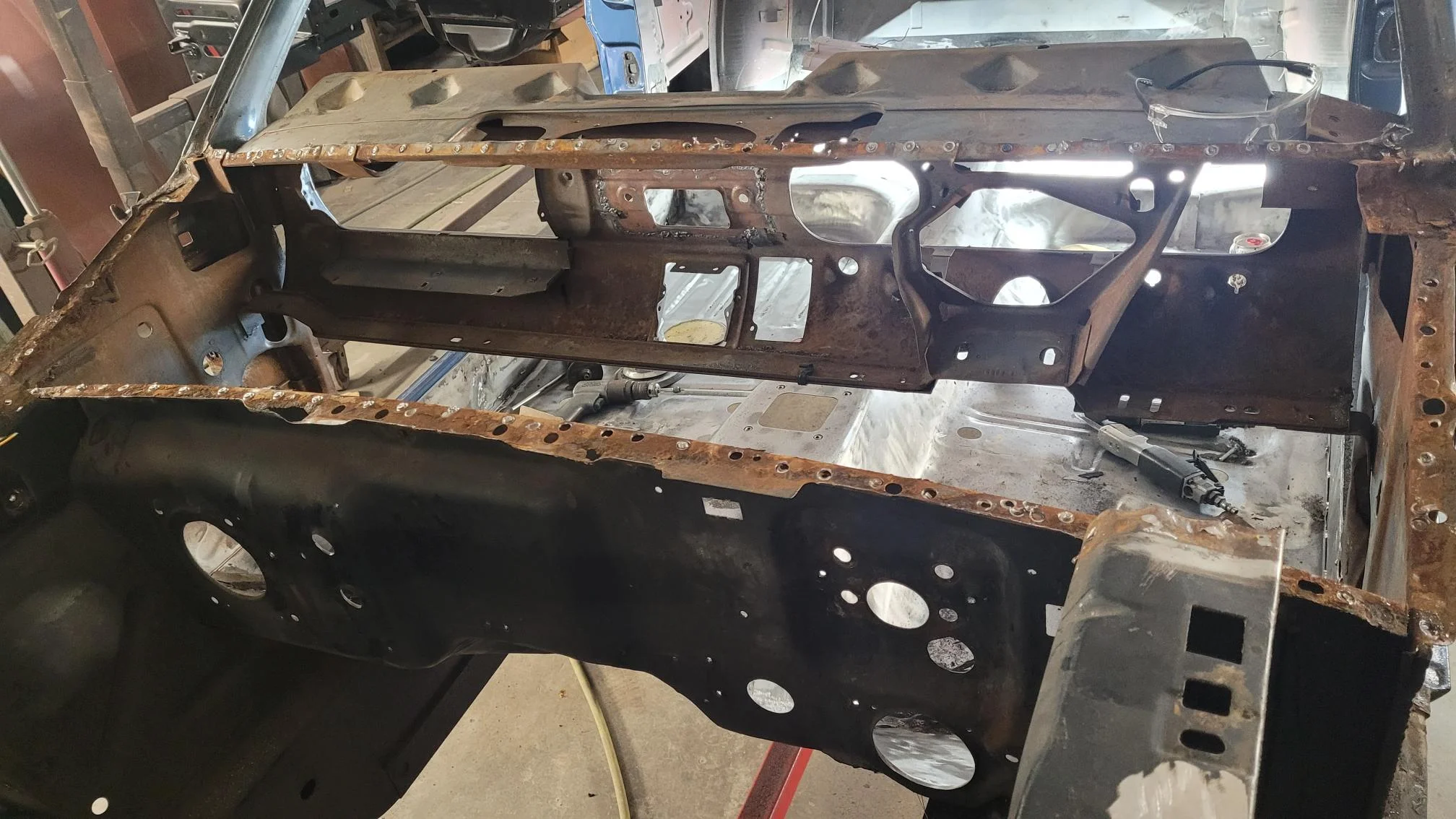

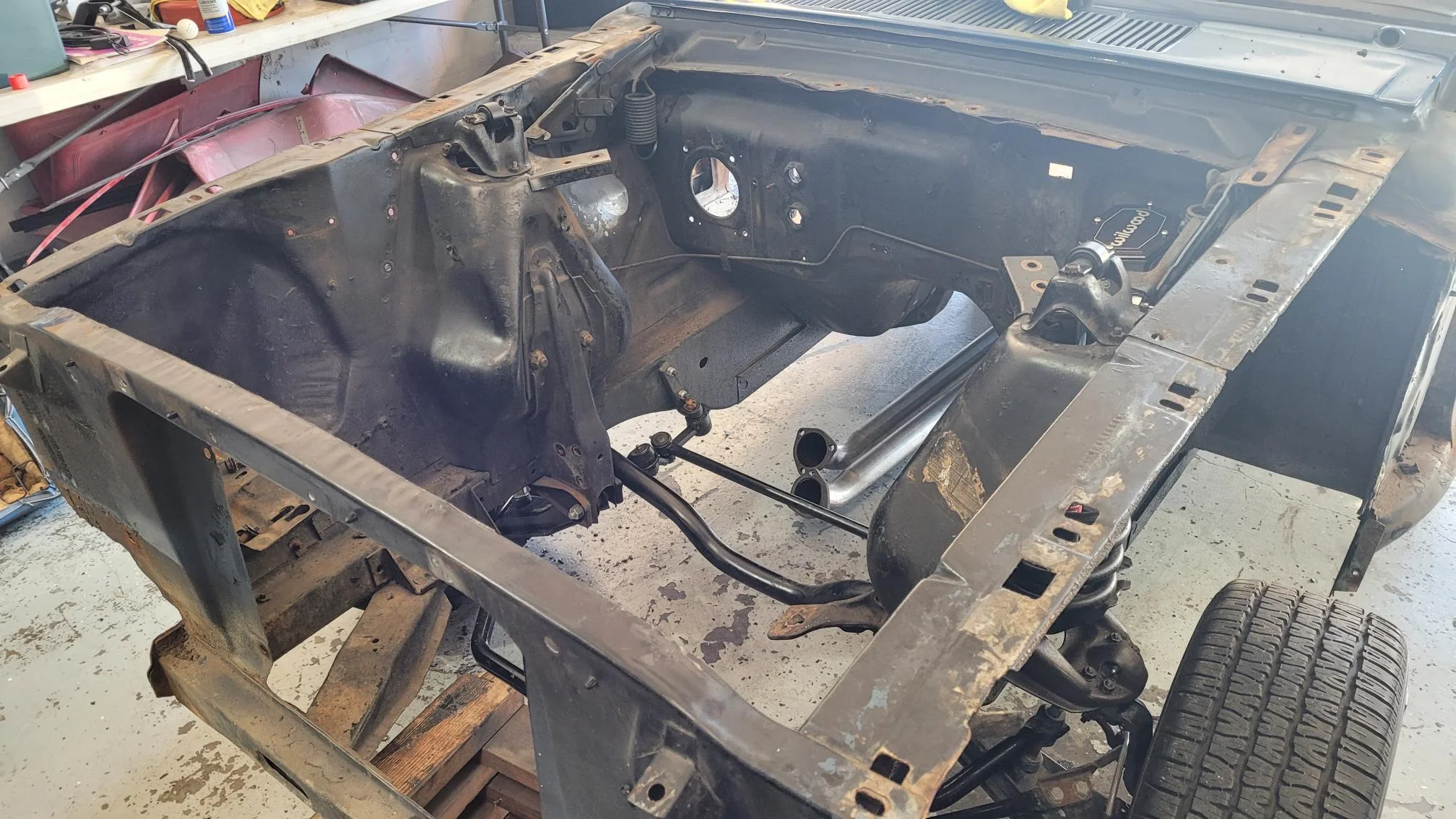

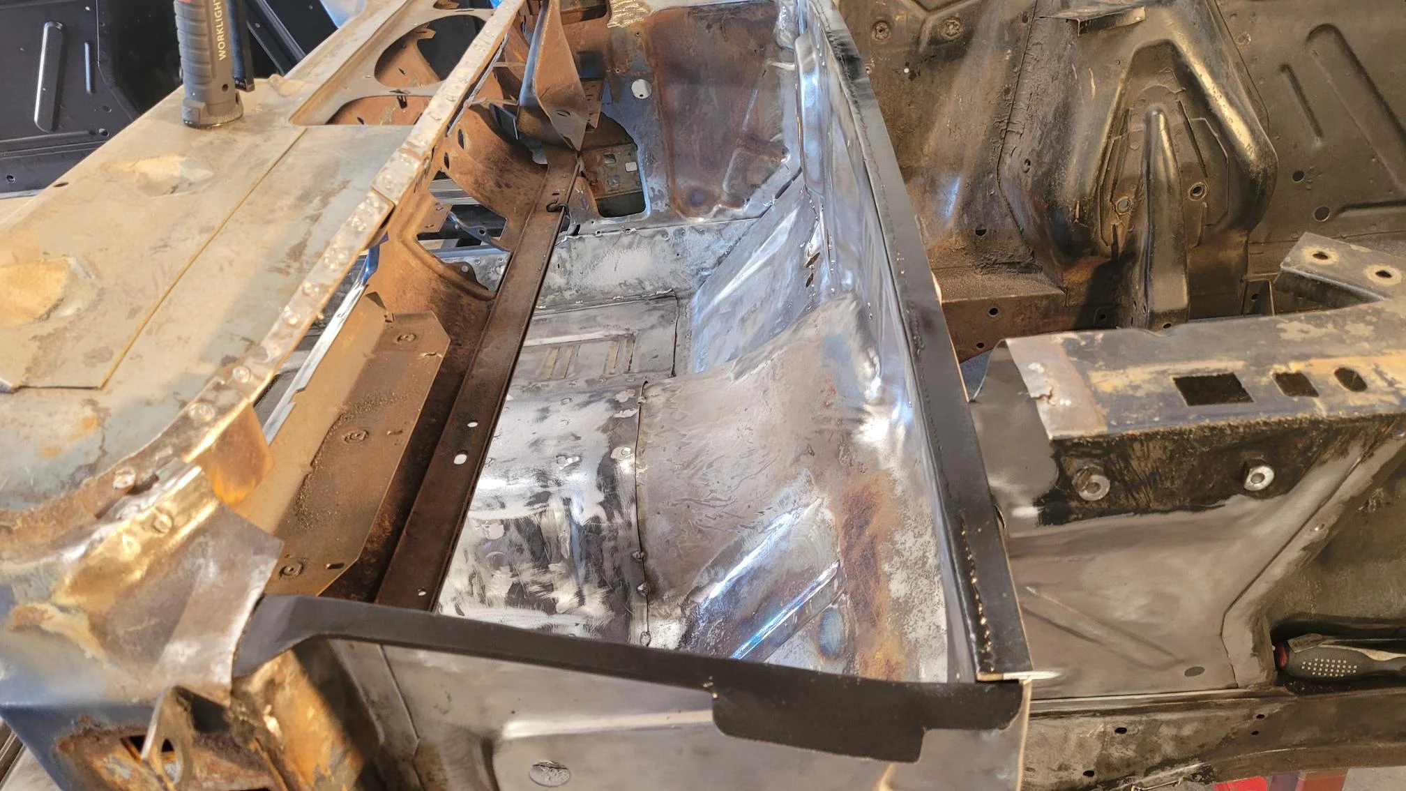

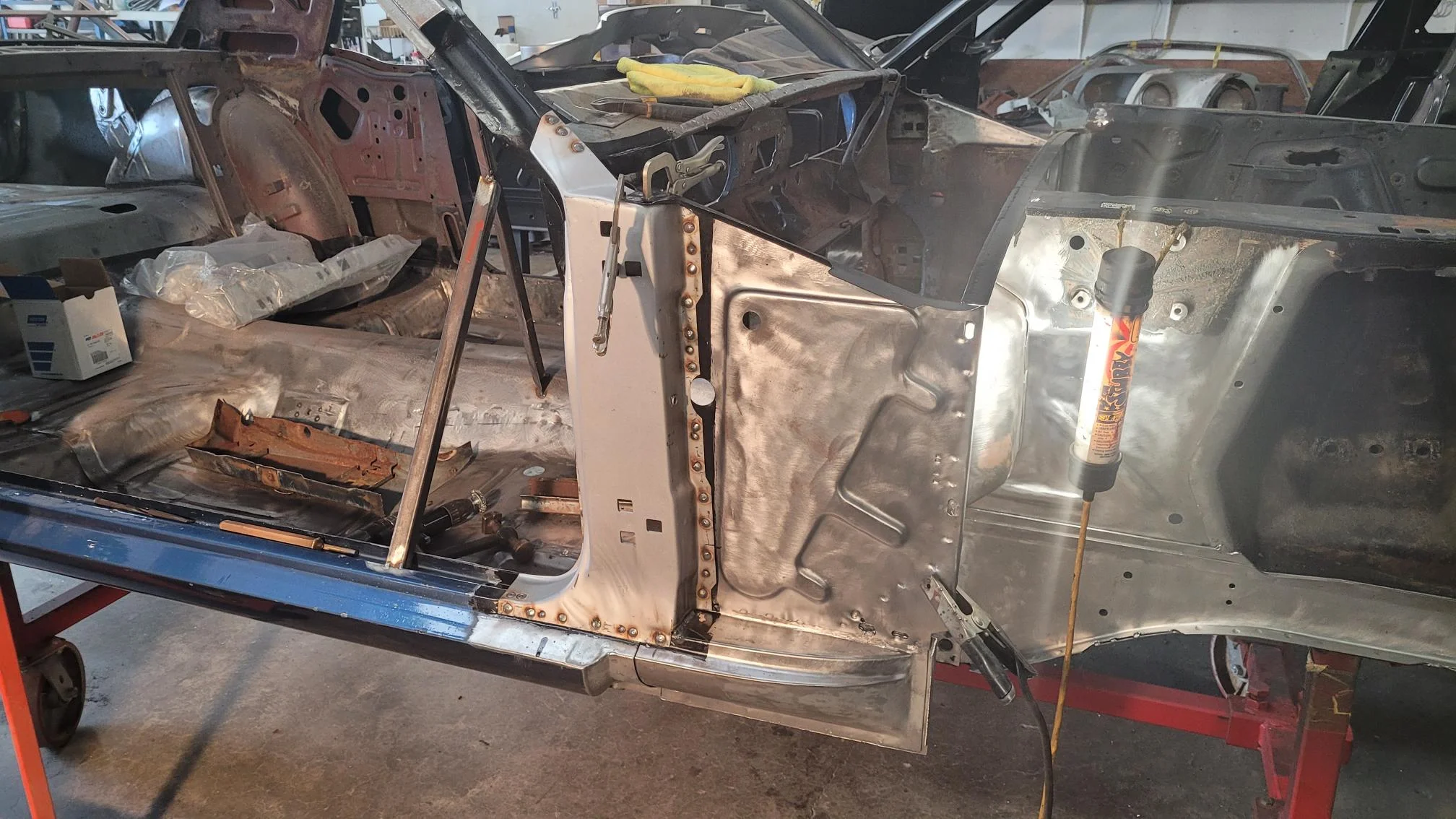

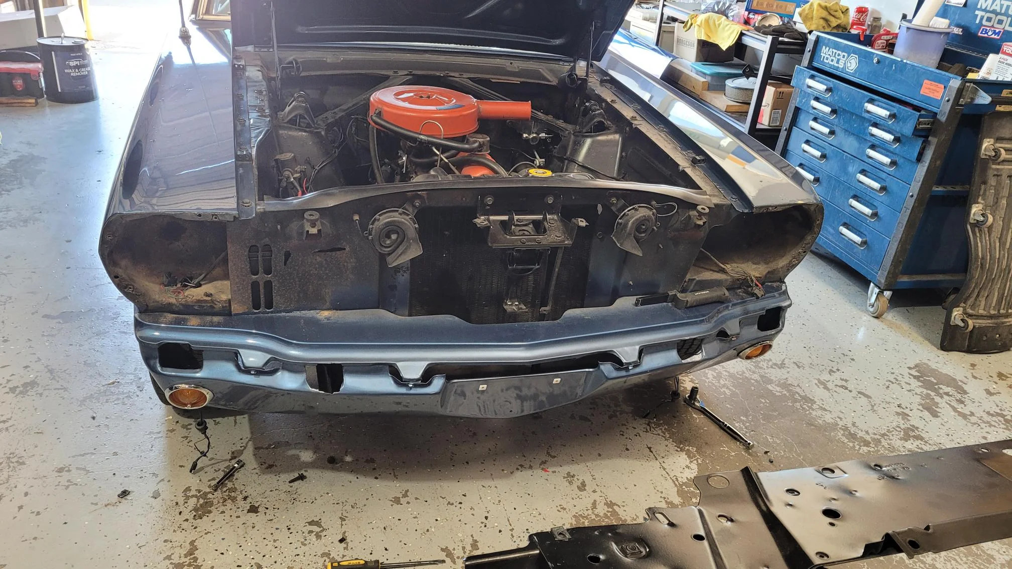

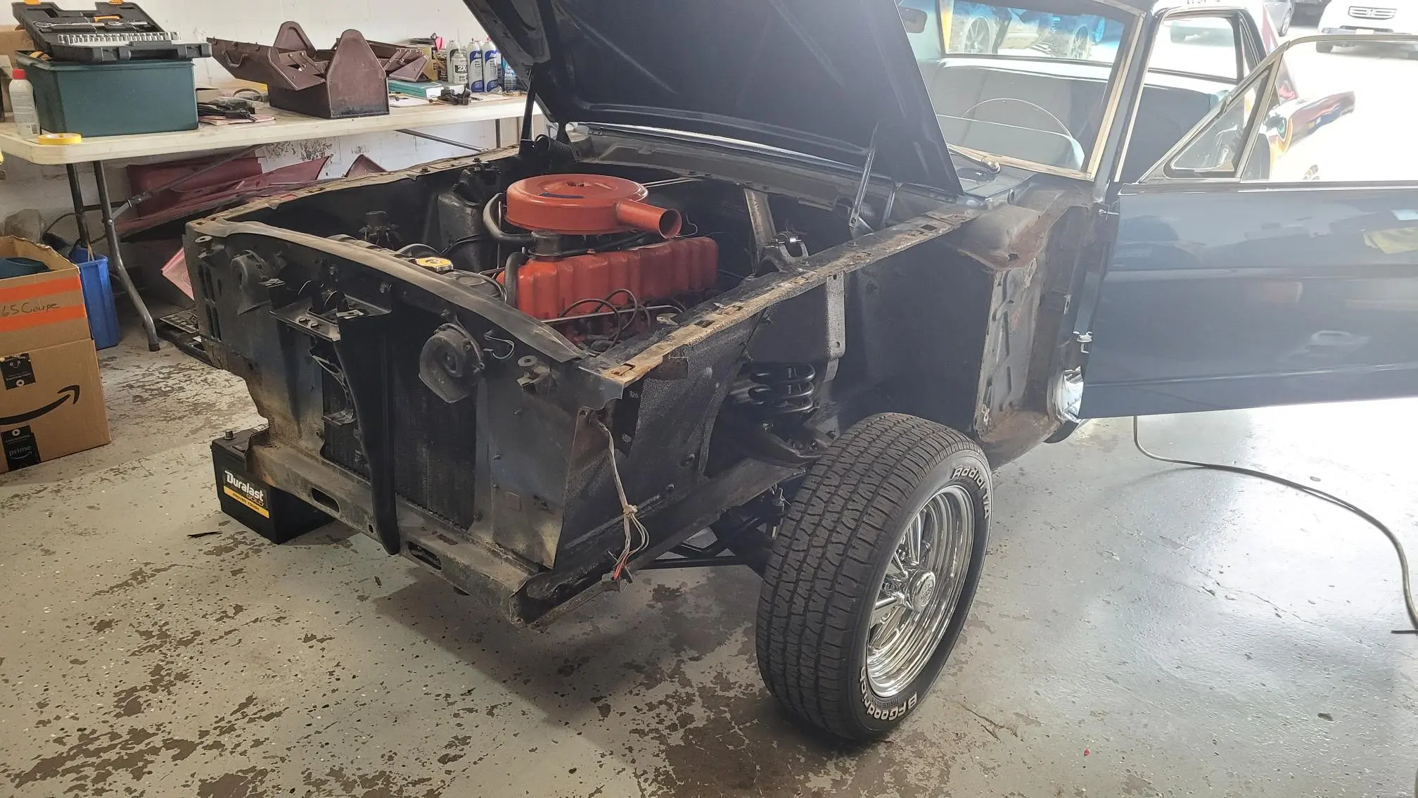

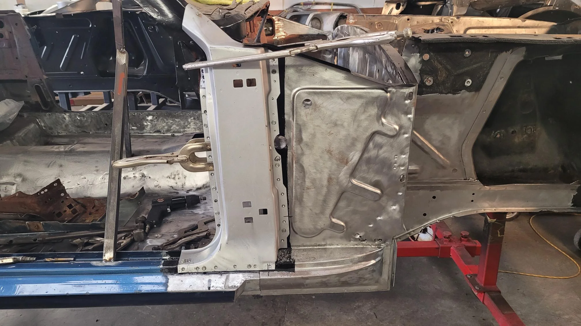

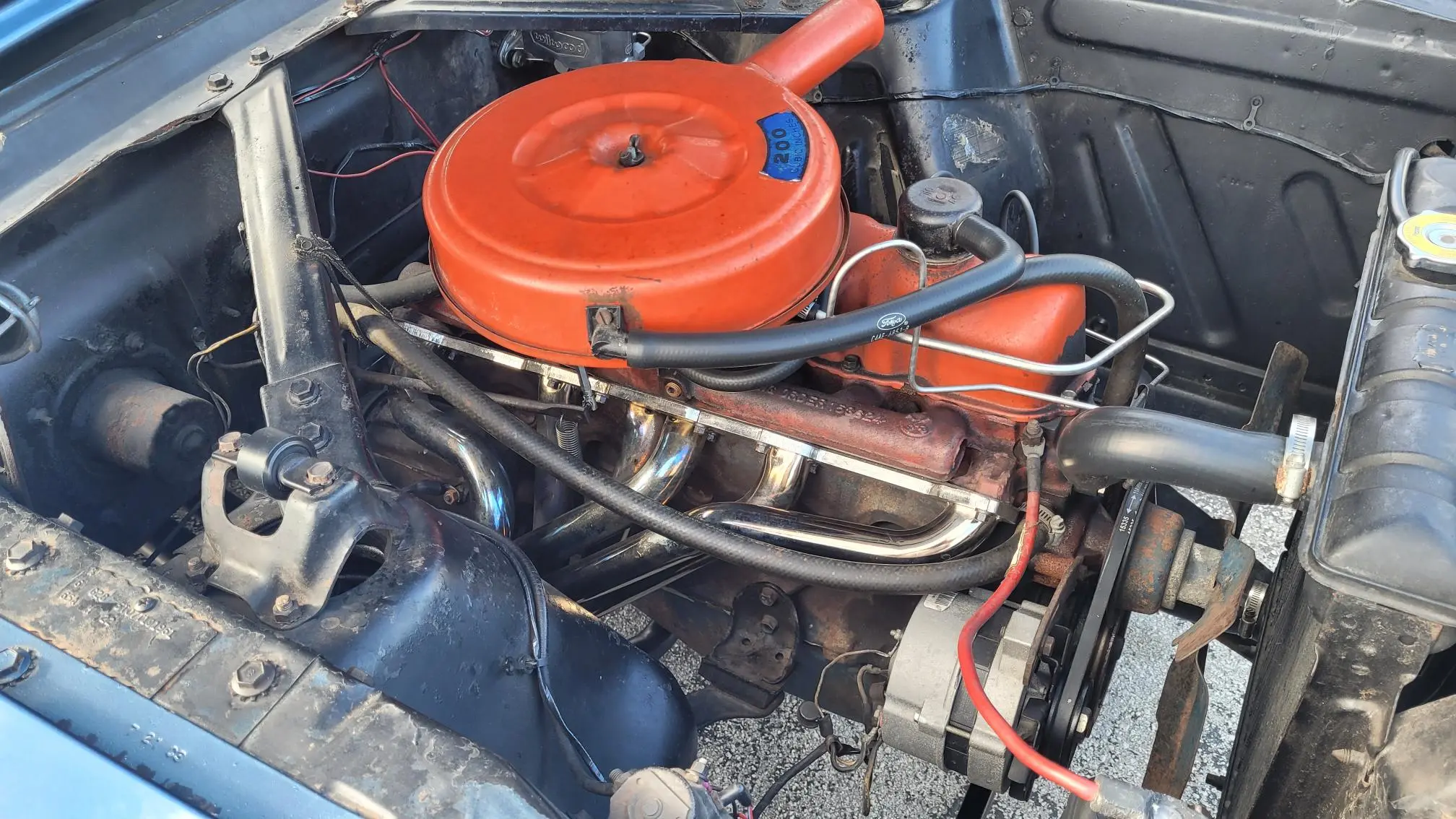

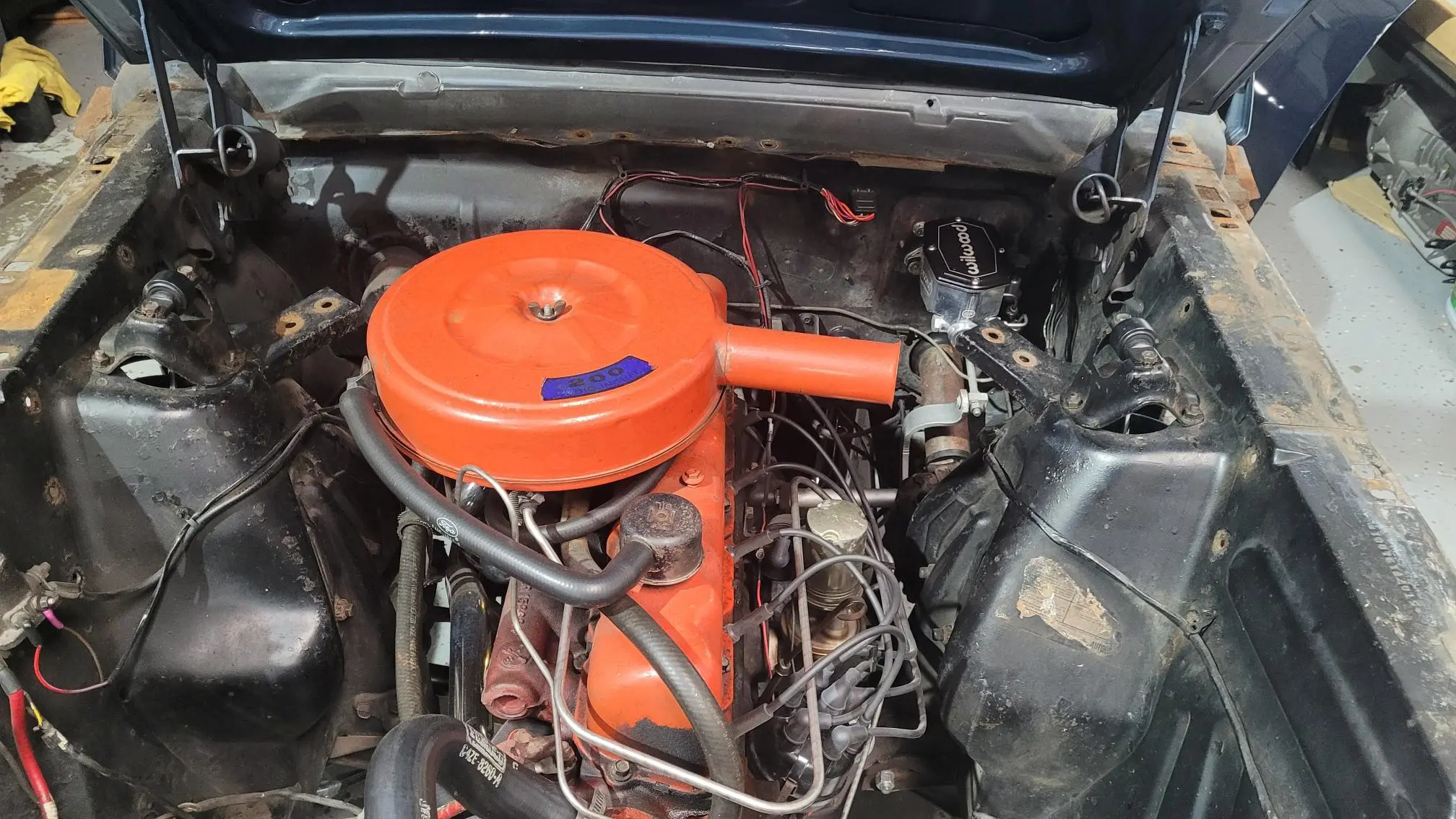

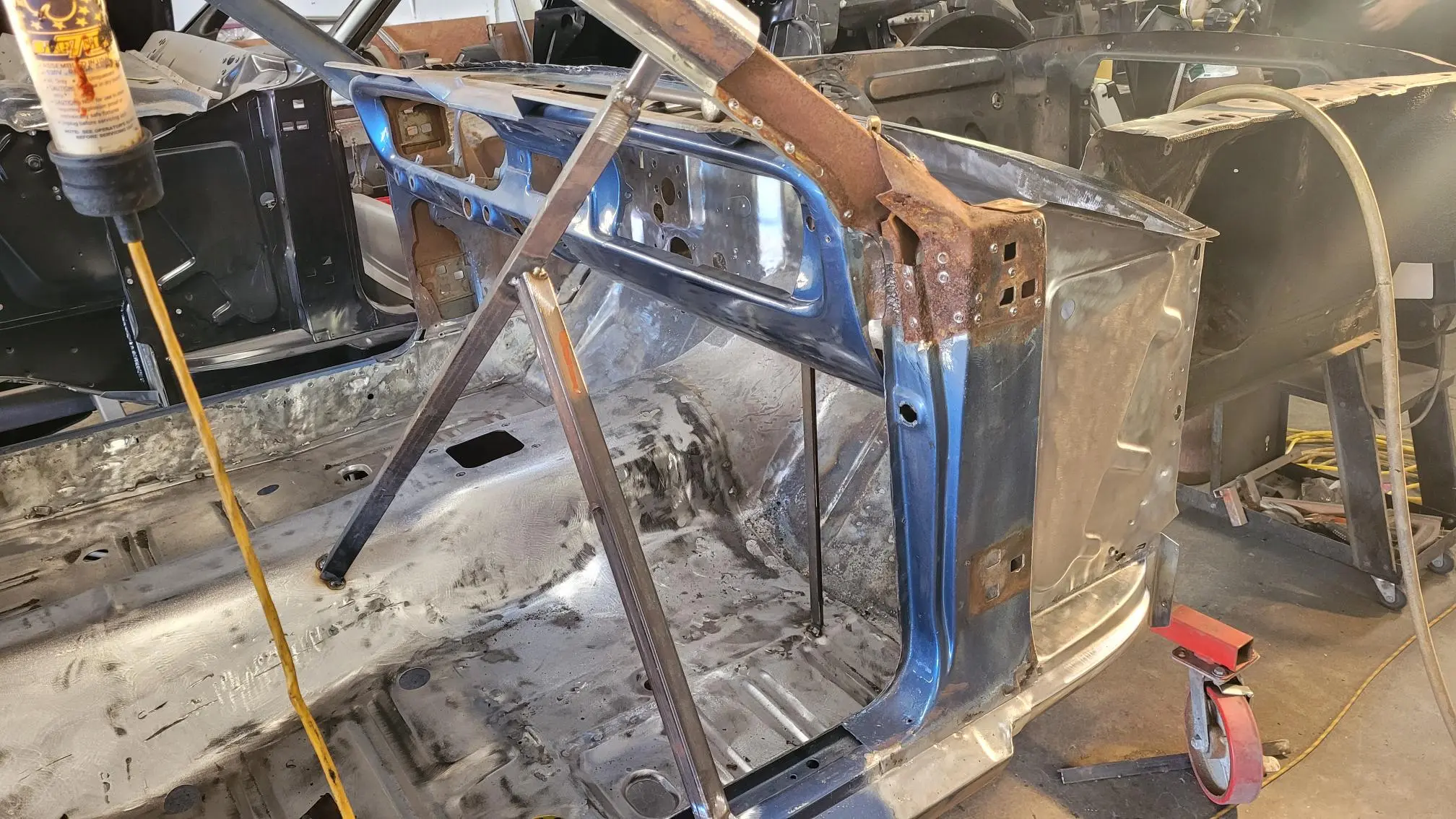

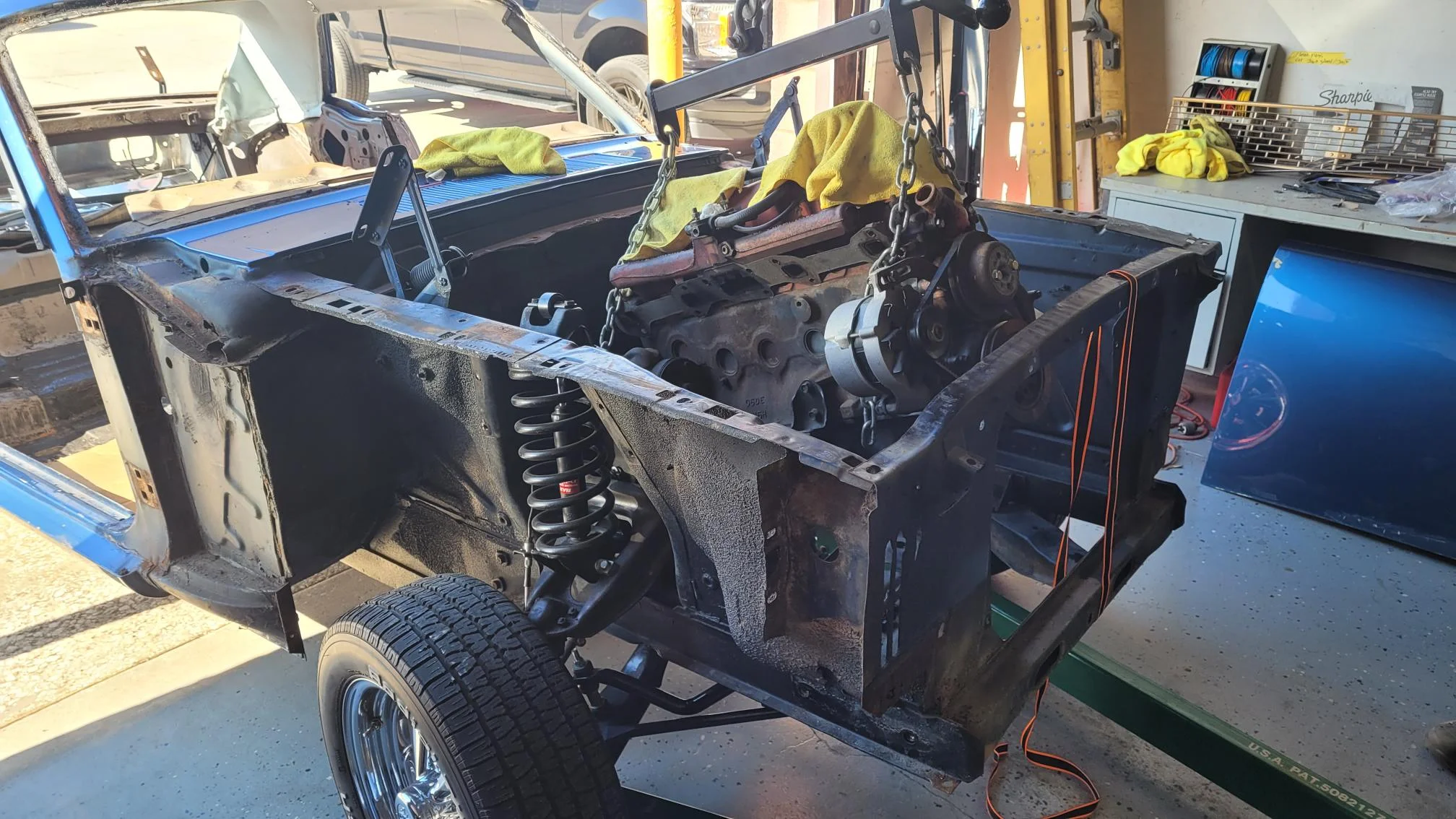

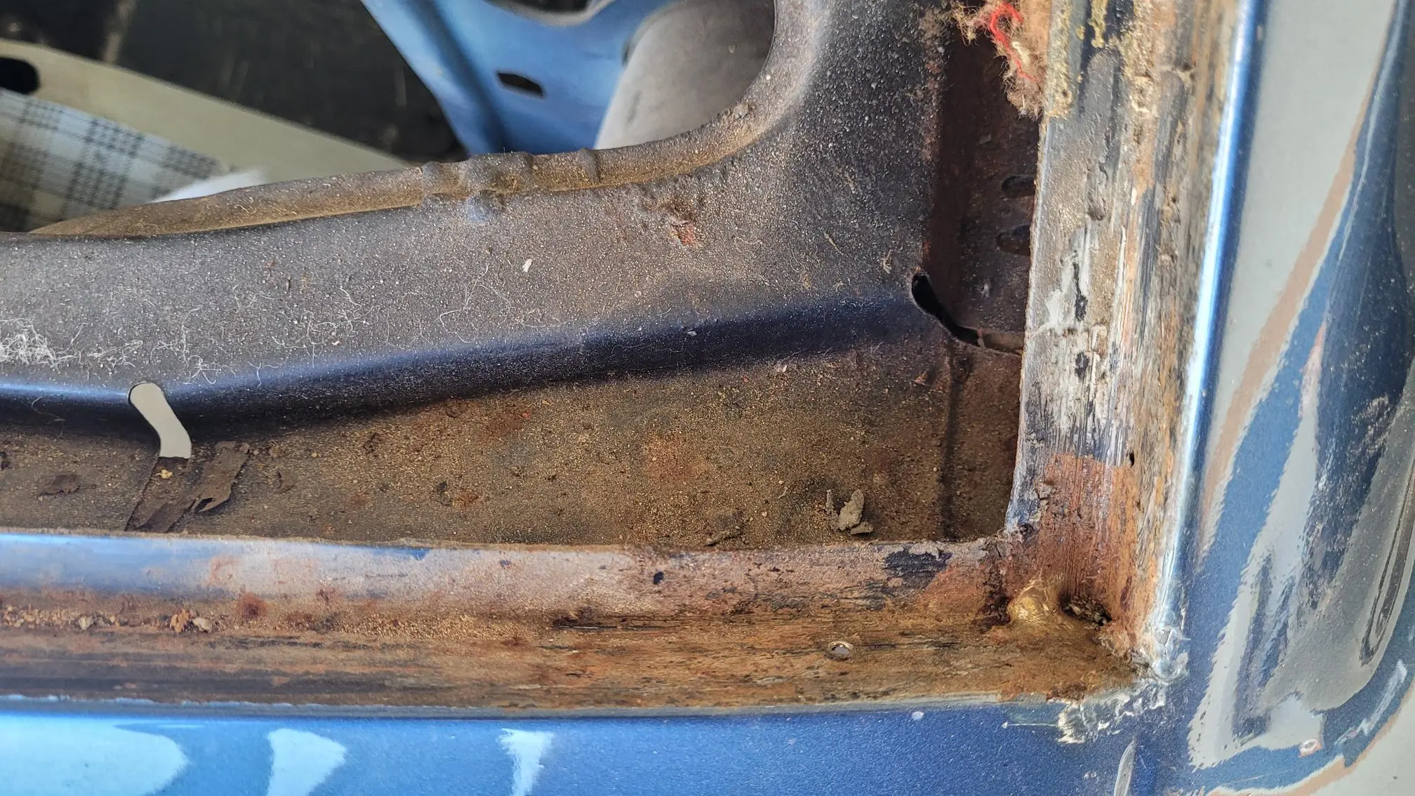

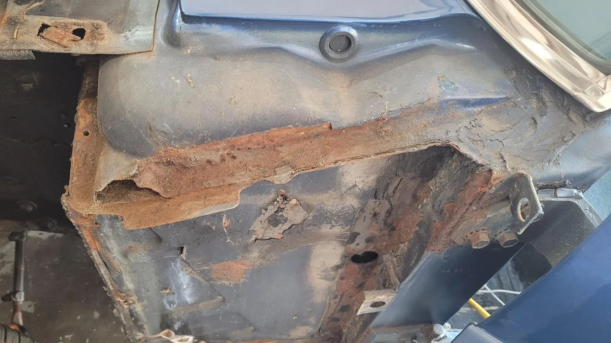

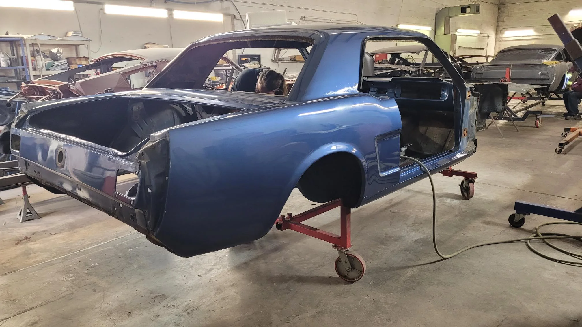

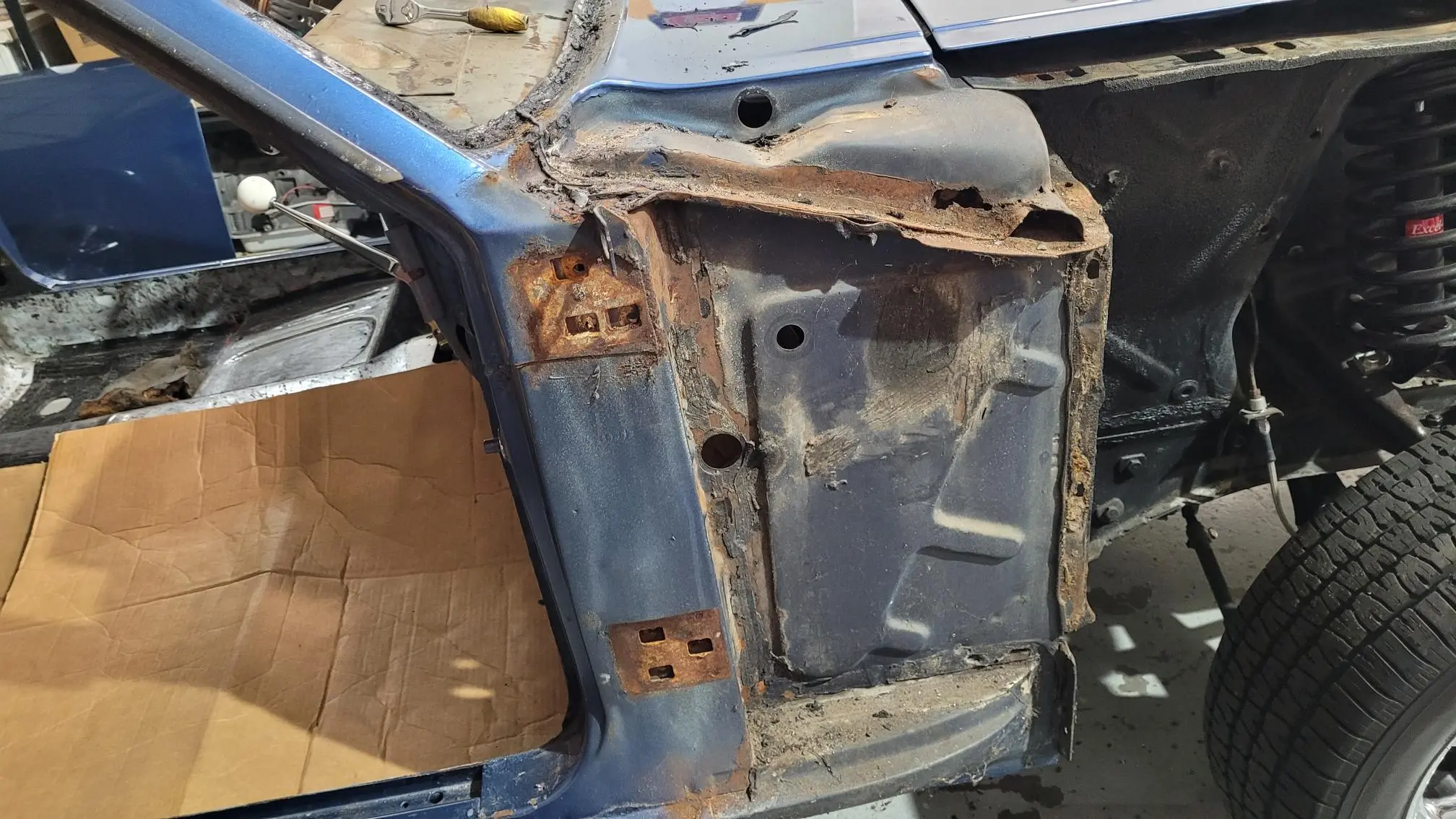

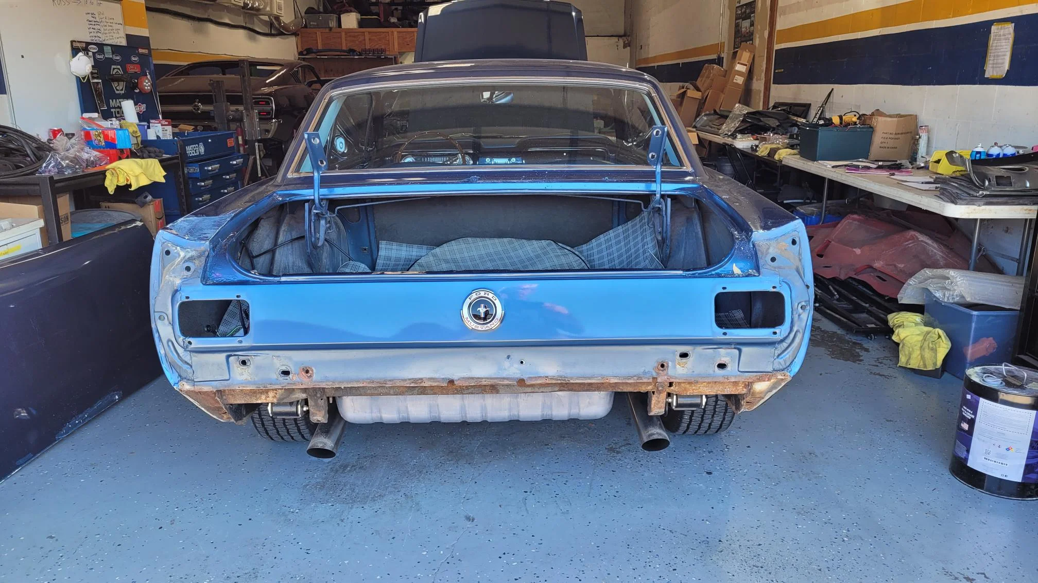

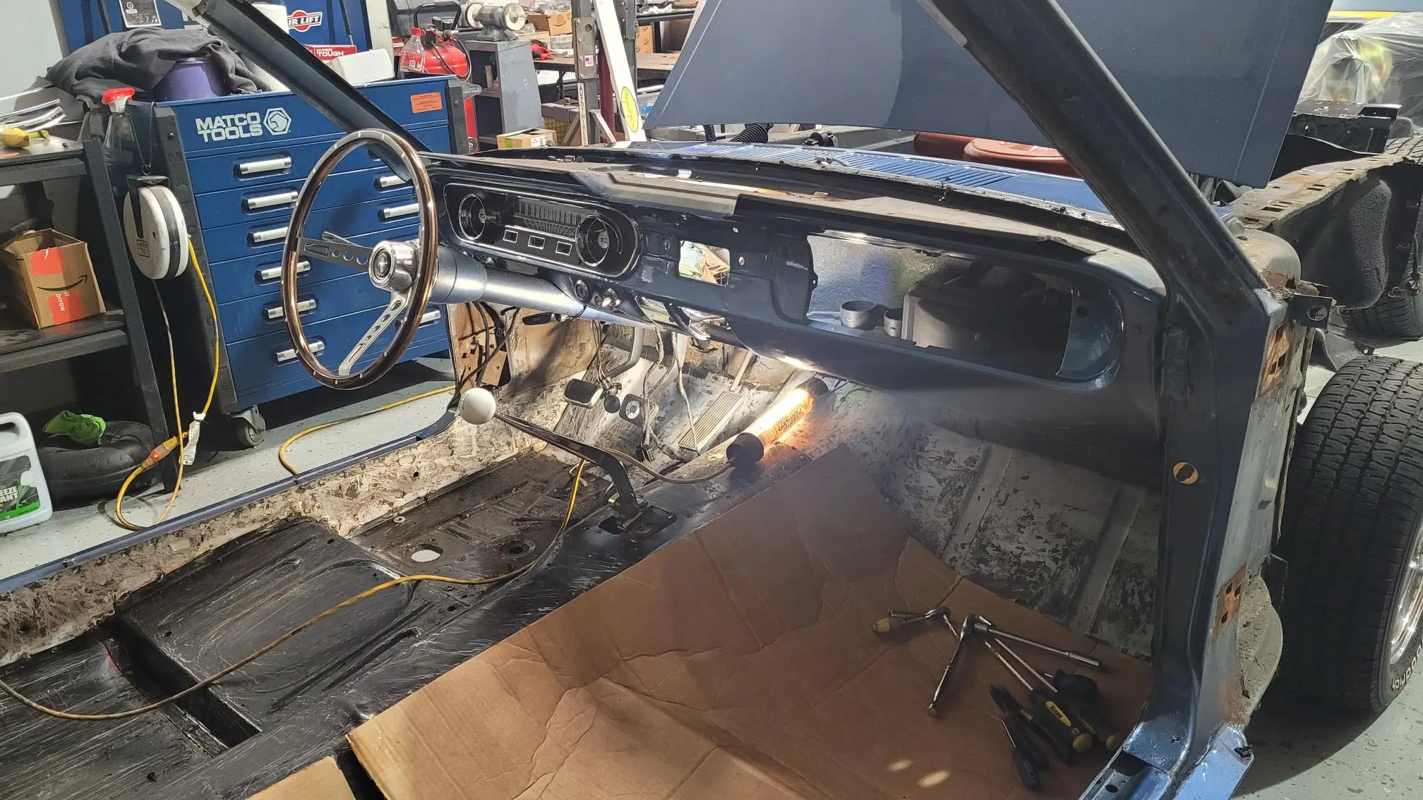

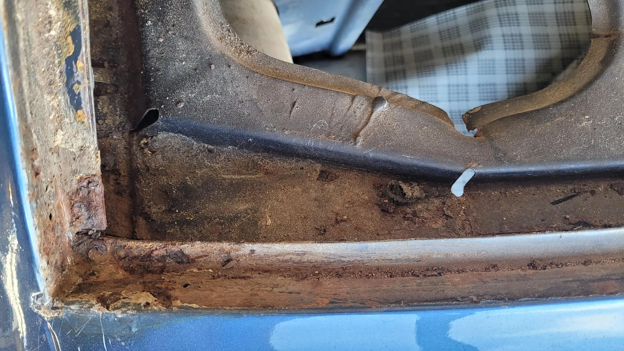

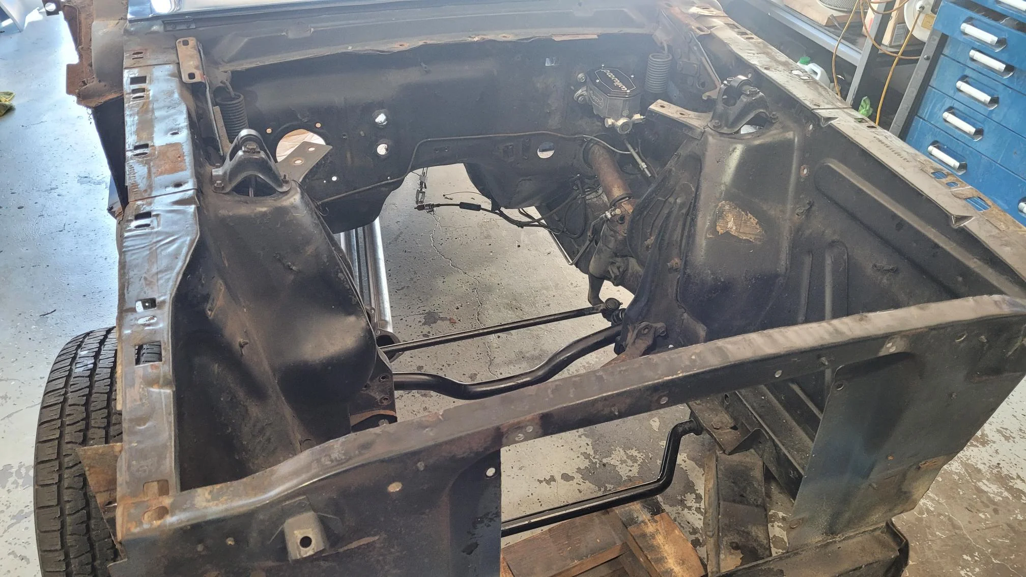

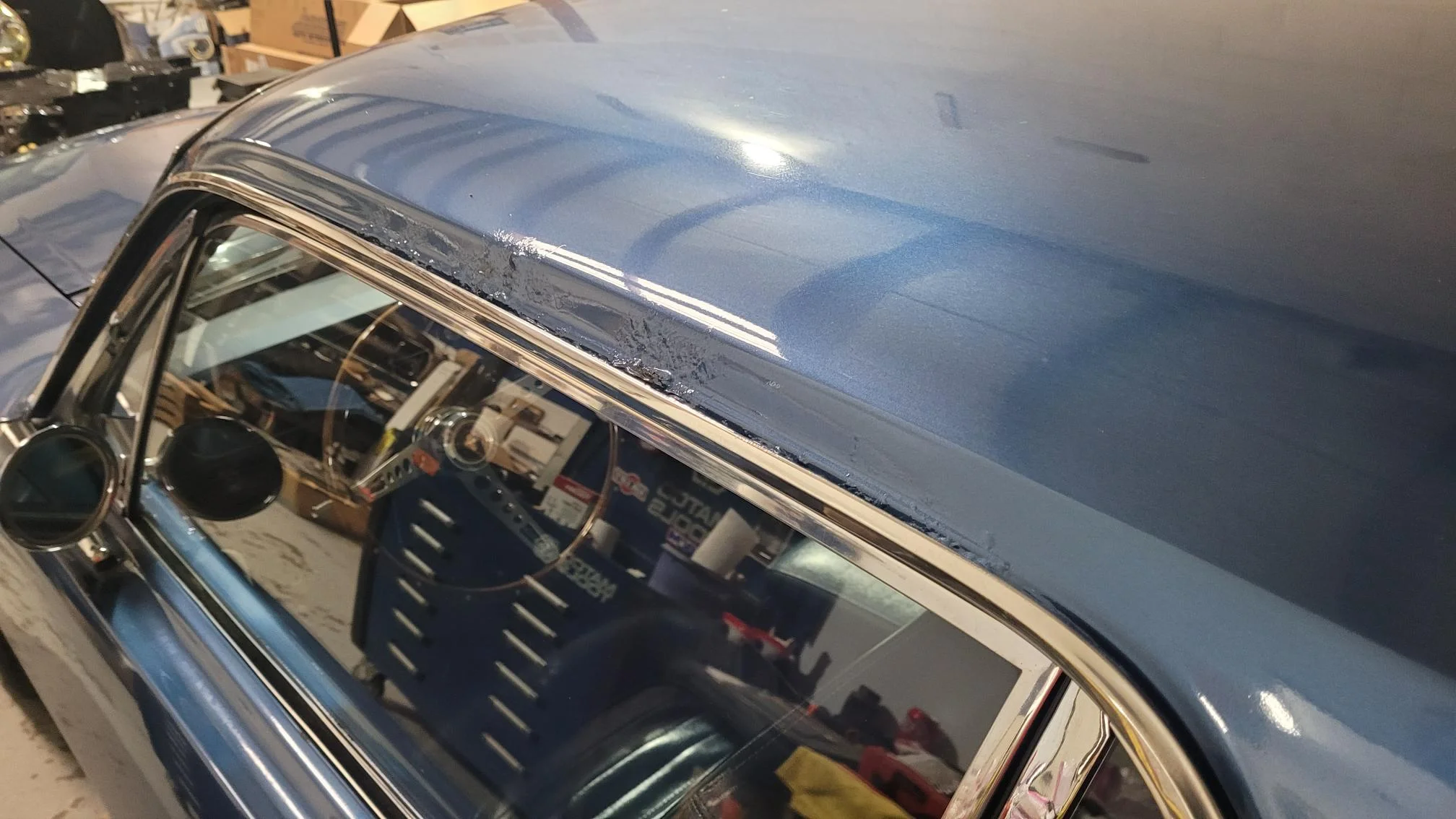

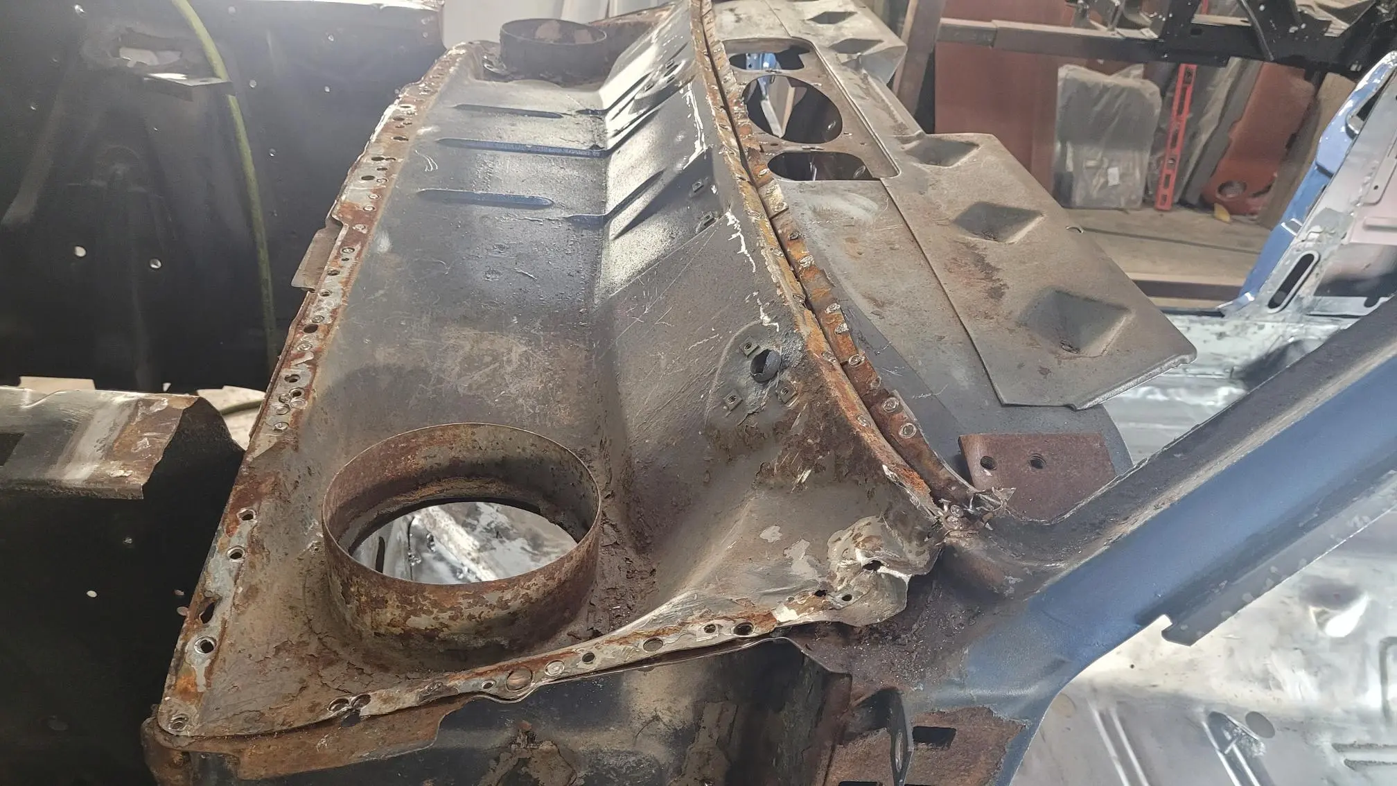

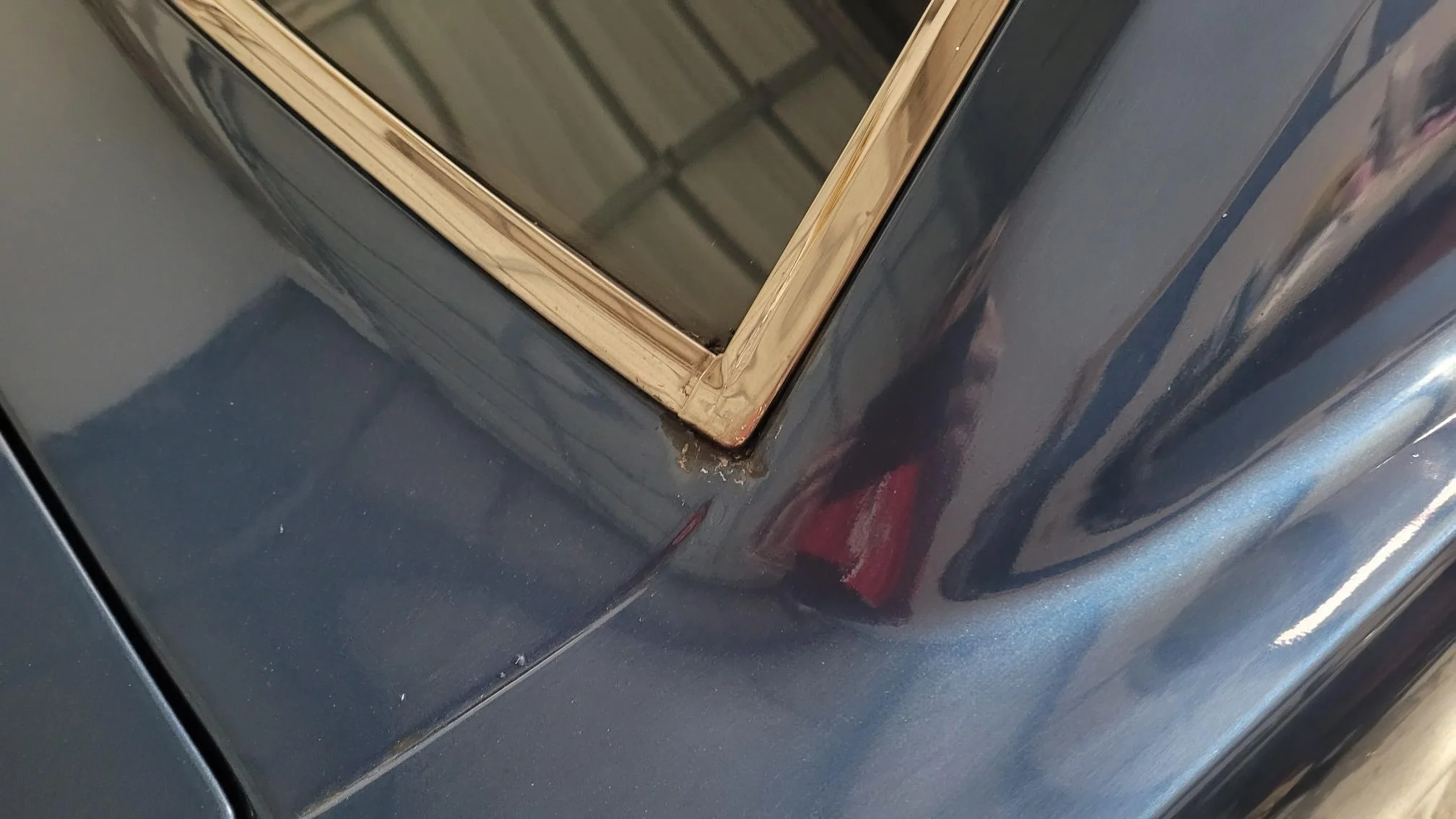

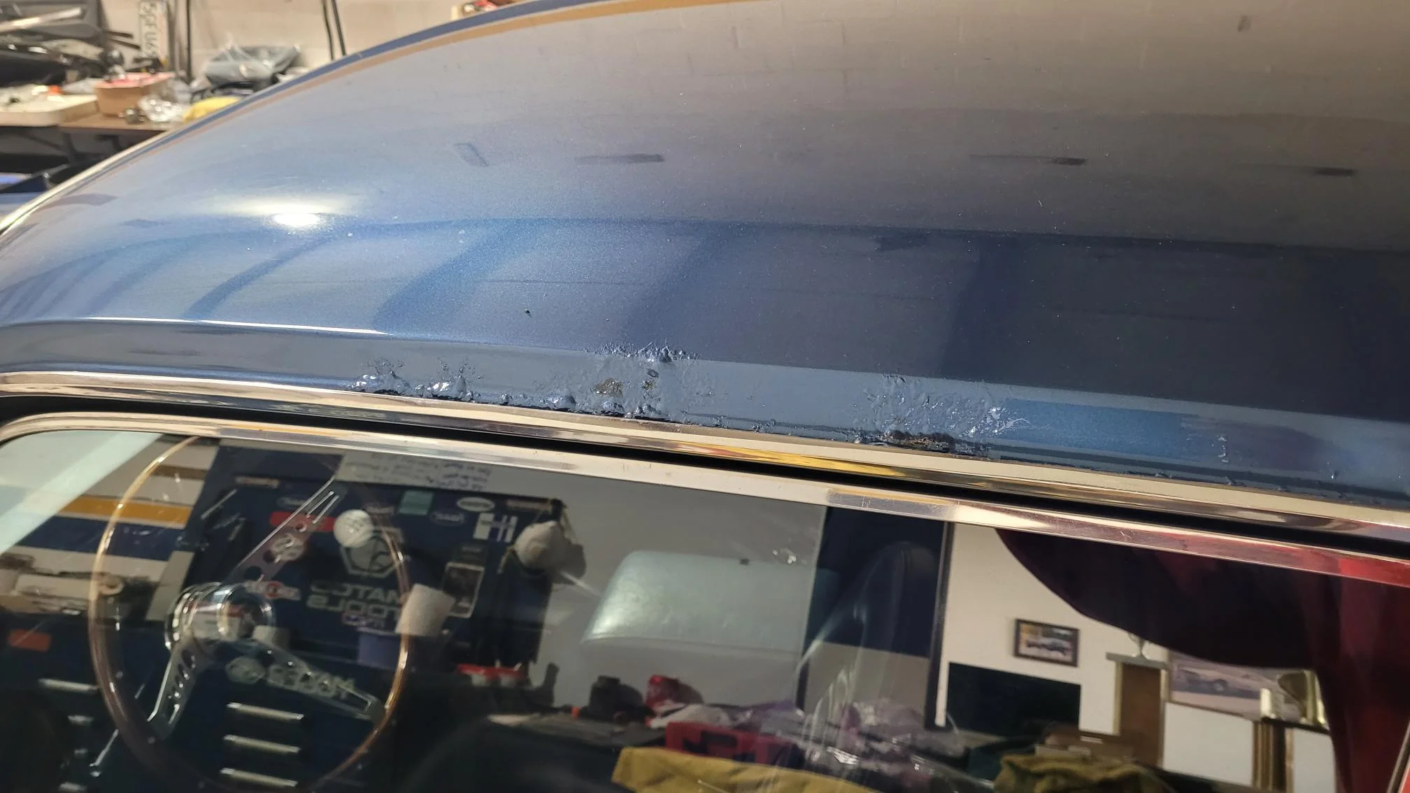

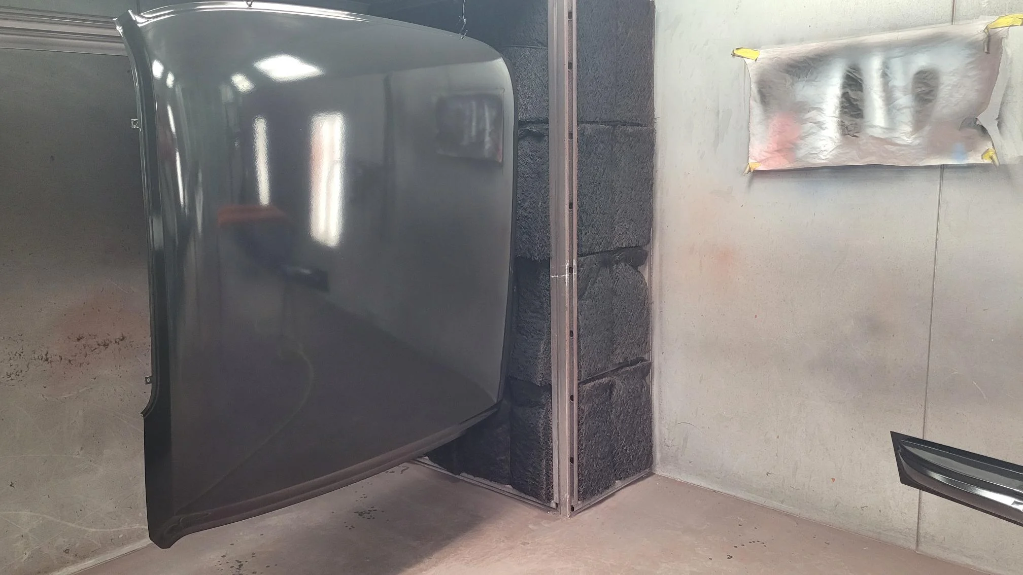

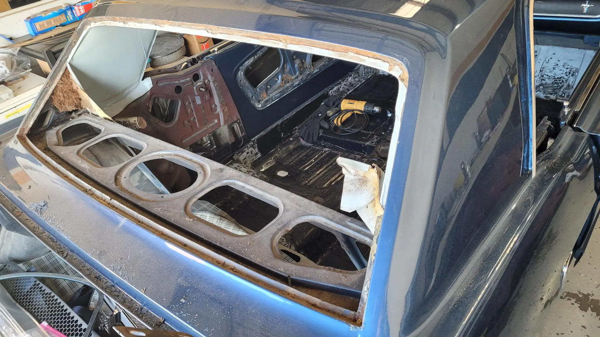

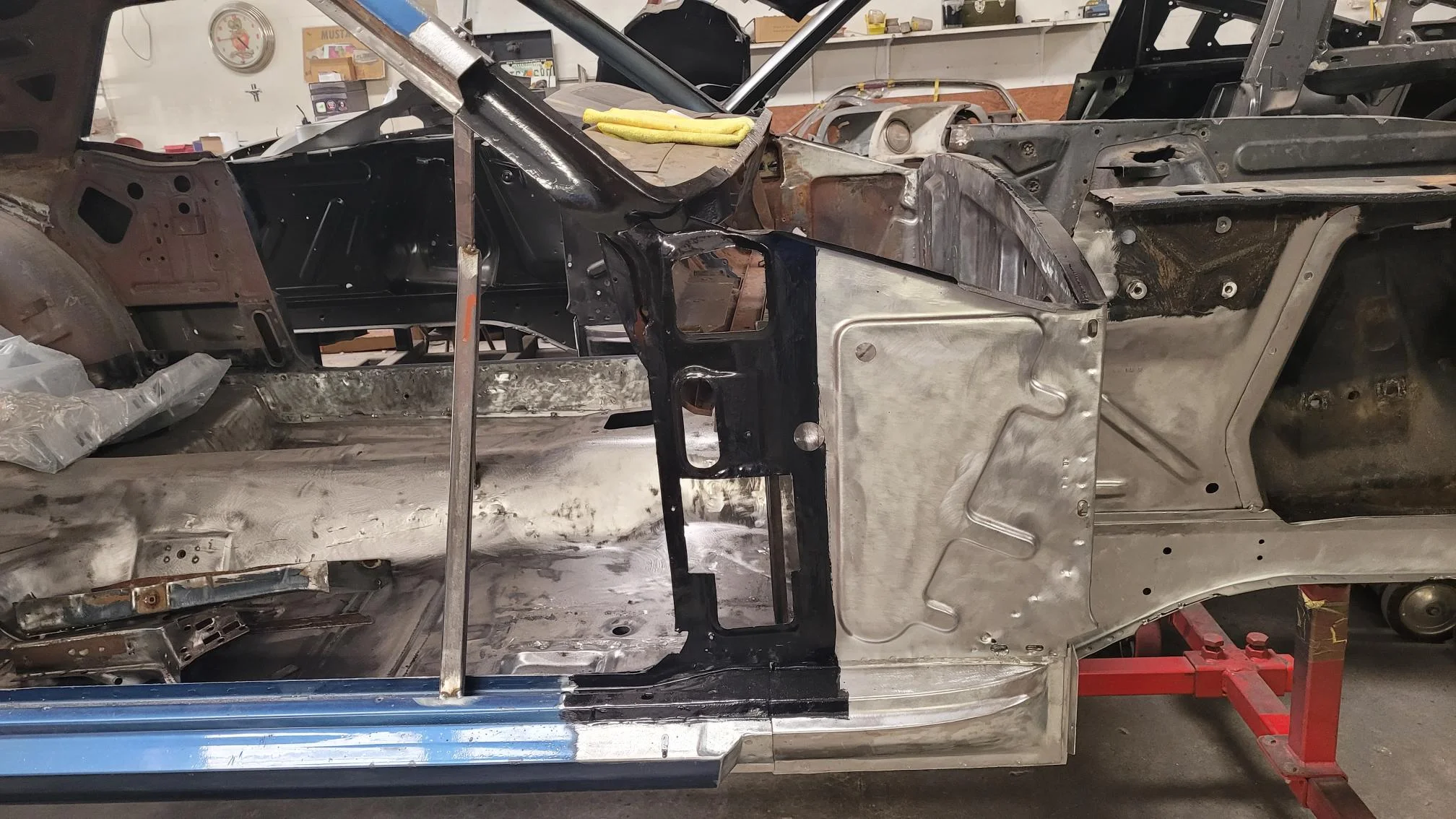

We have a new project that was dropped off at the shop before Christmas. This Mustang looks pretty good at first! It will need some rust repair before we start modifying the body, drive train and suspension. Mike and I started taking it apart.
Reactions: 2Blue2 and 89ripper

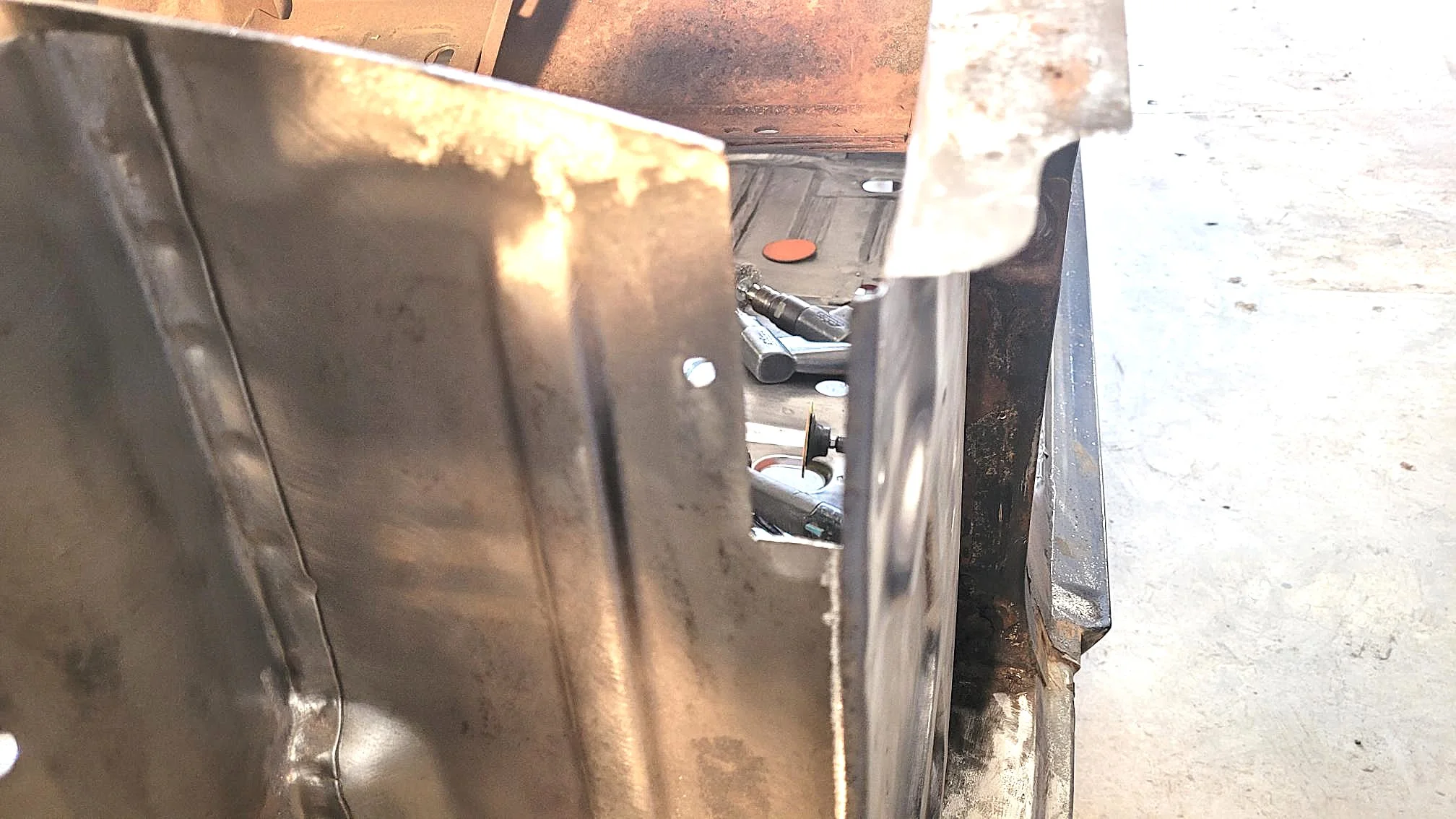

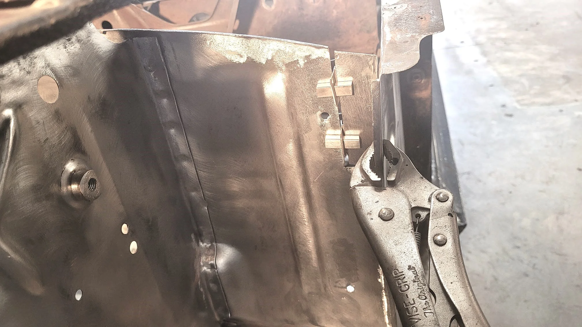

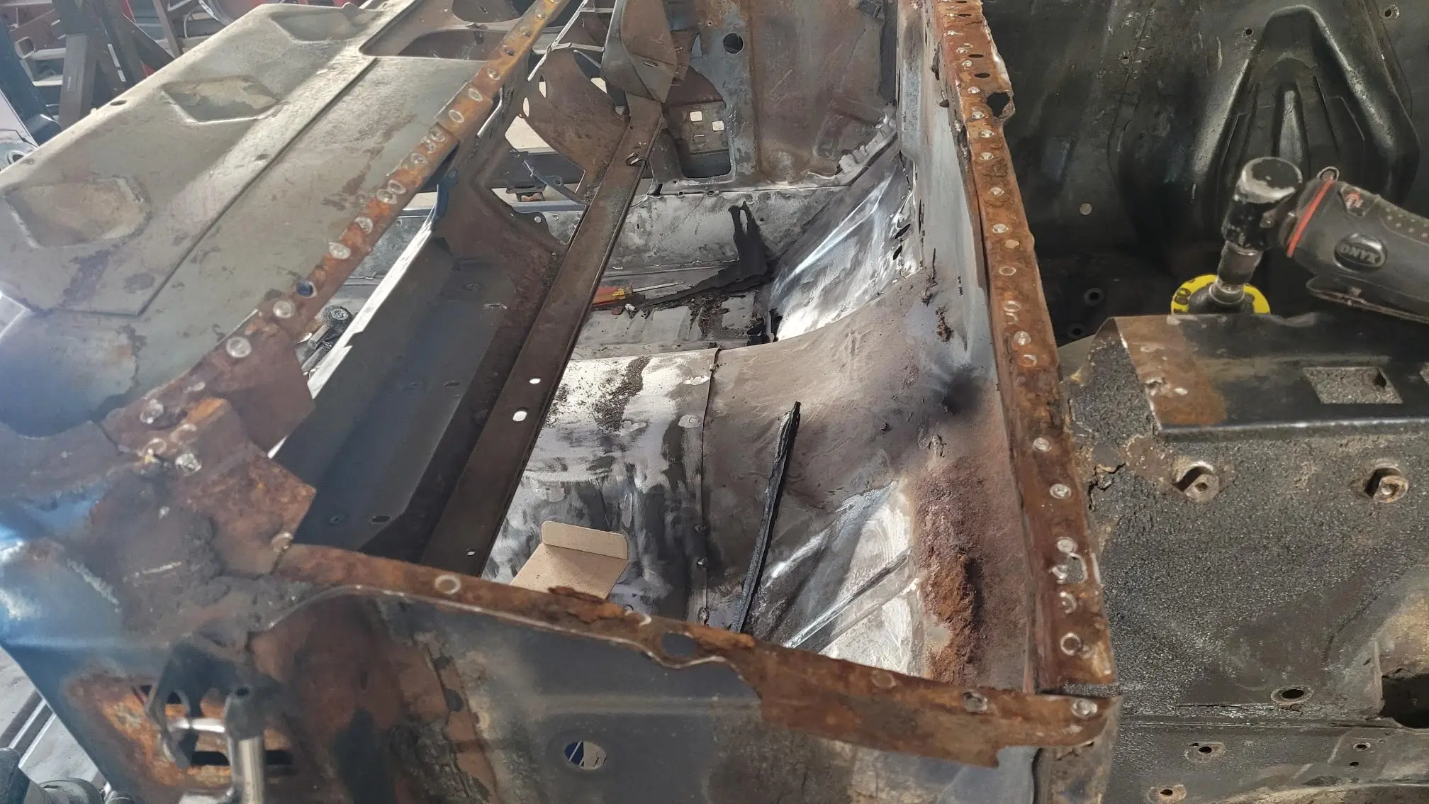

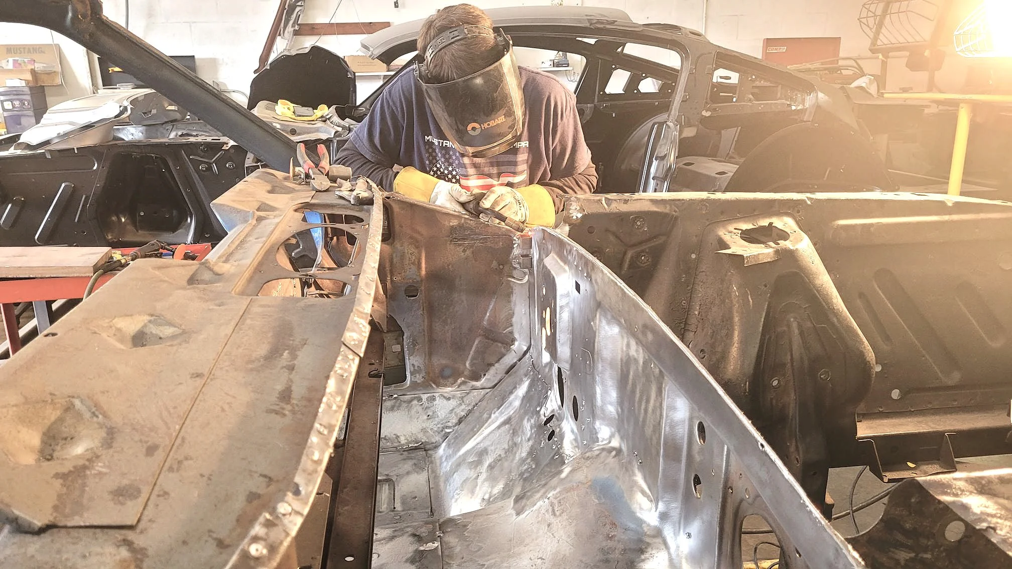

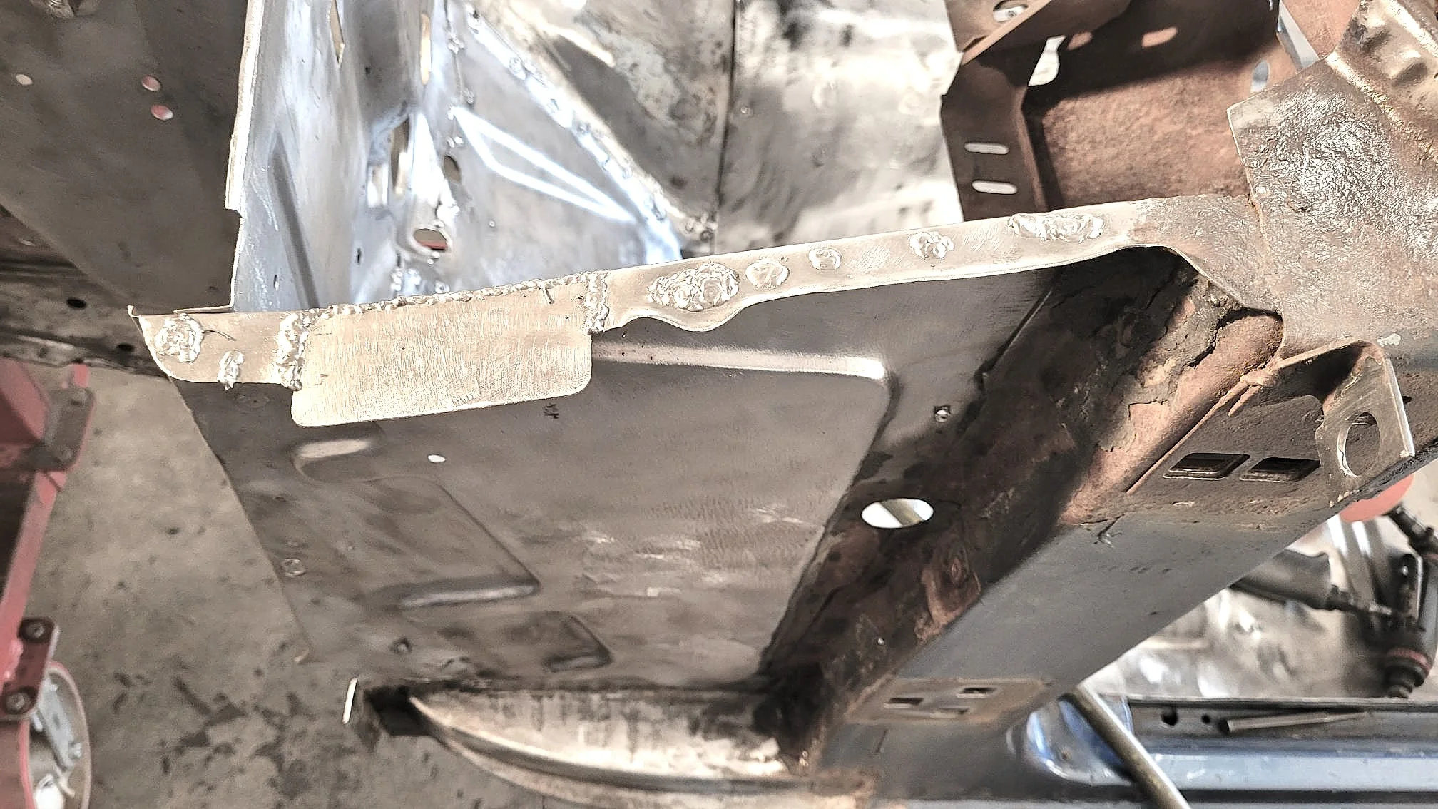

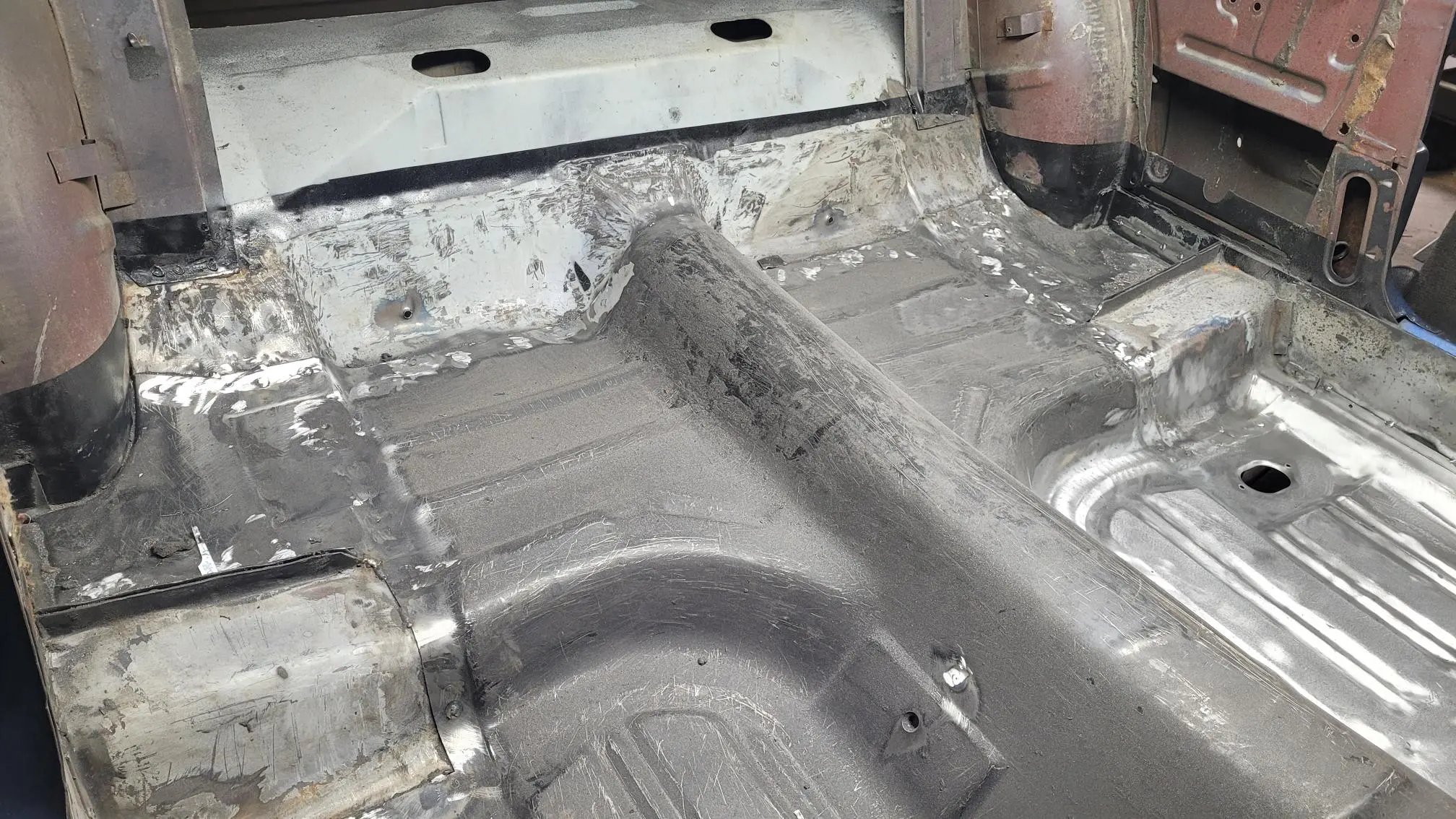

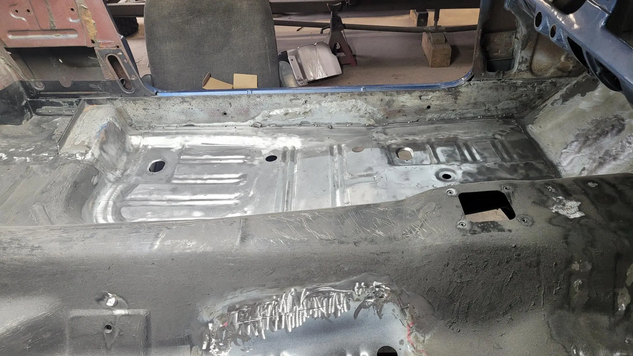

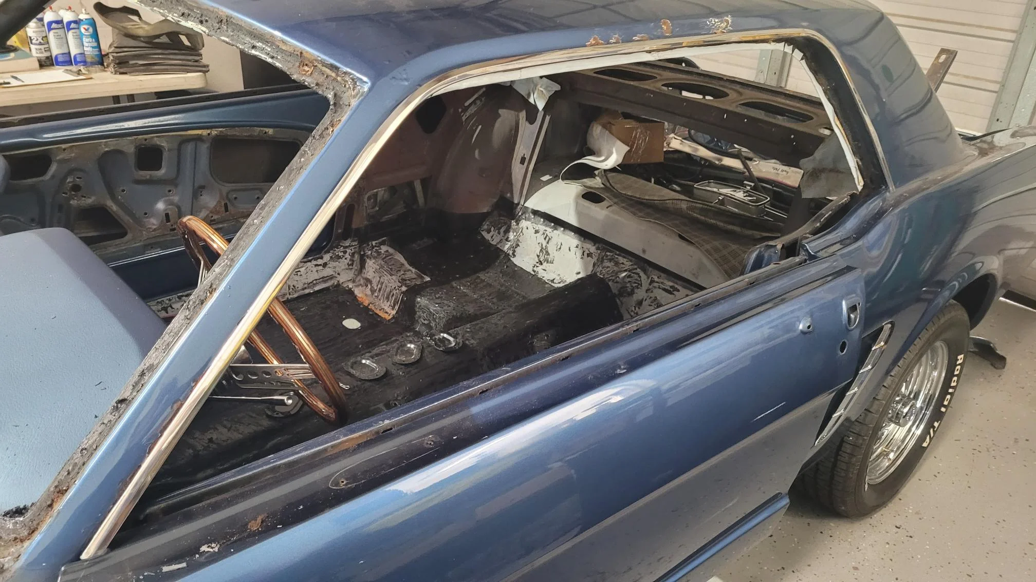

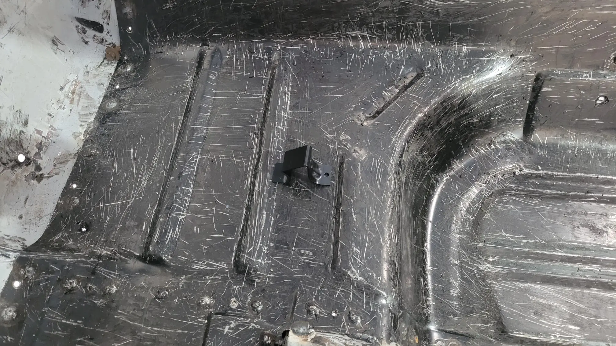

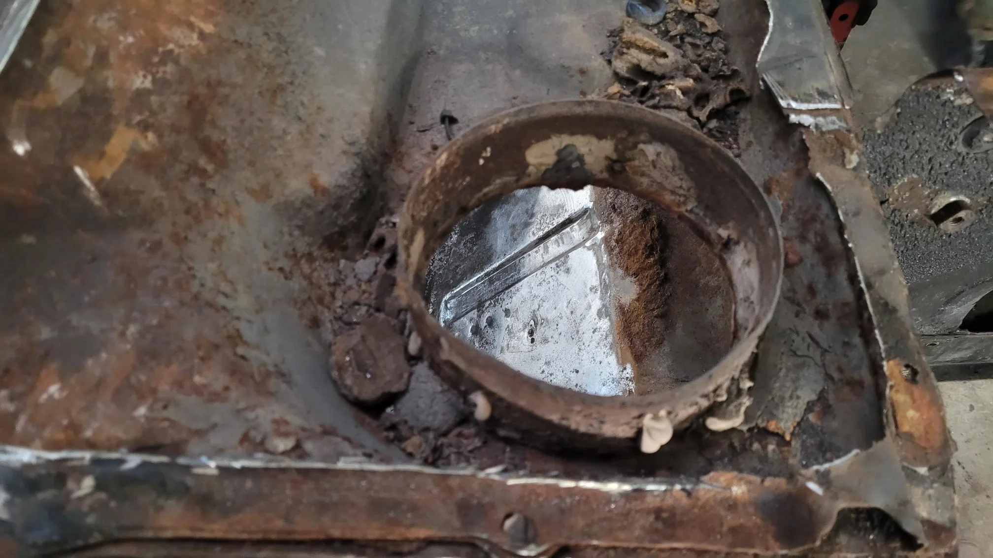

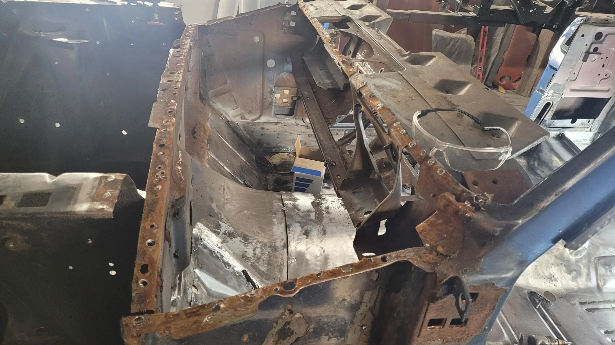

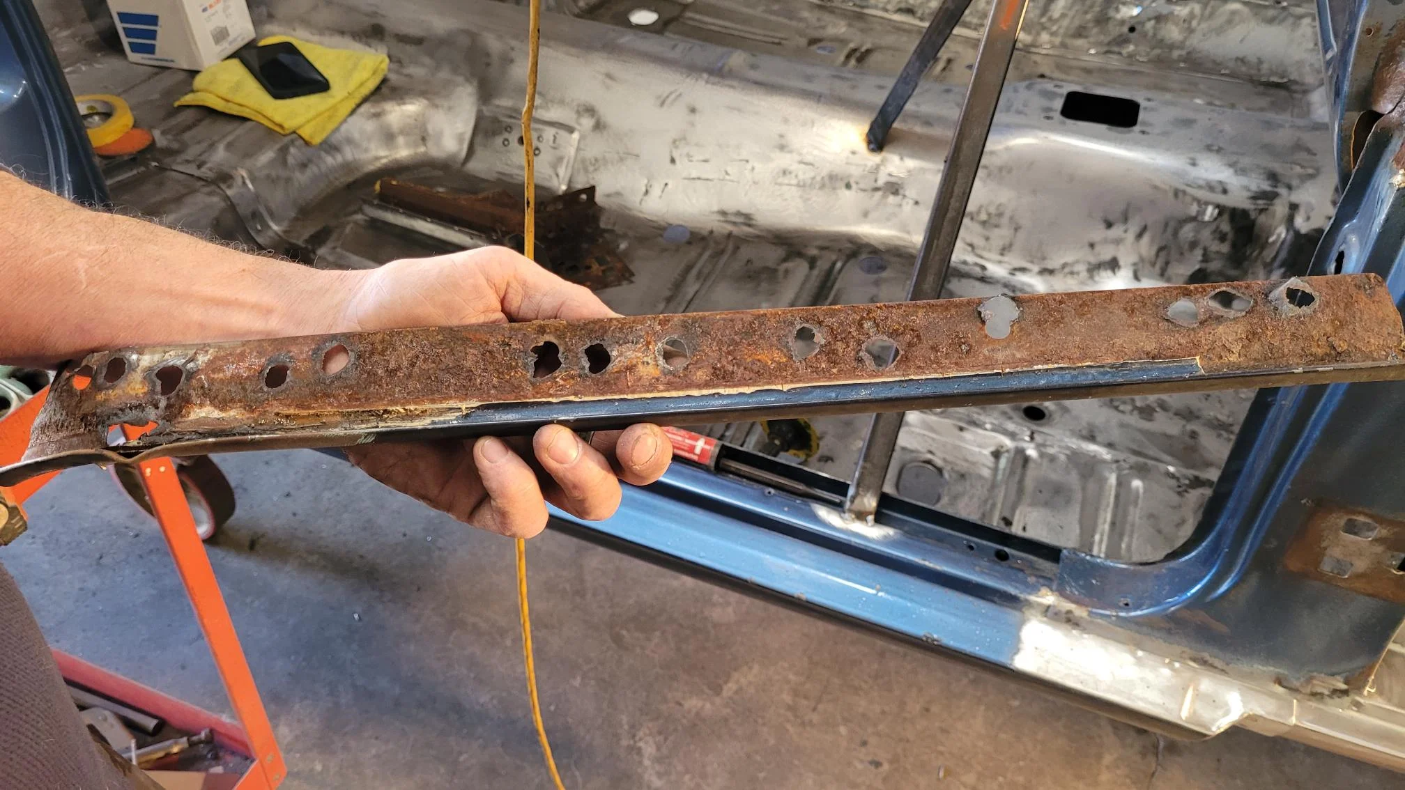

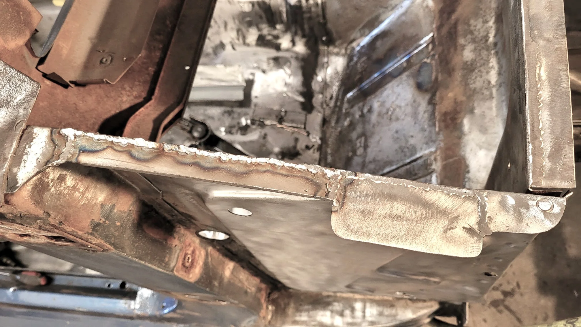

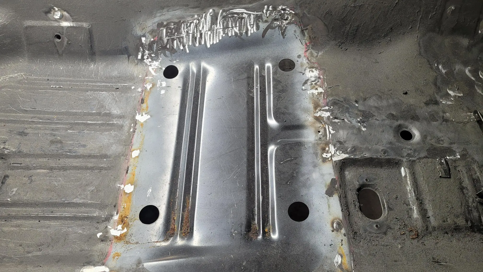

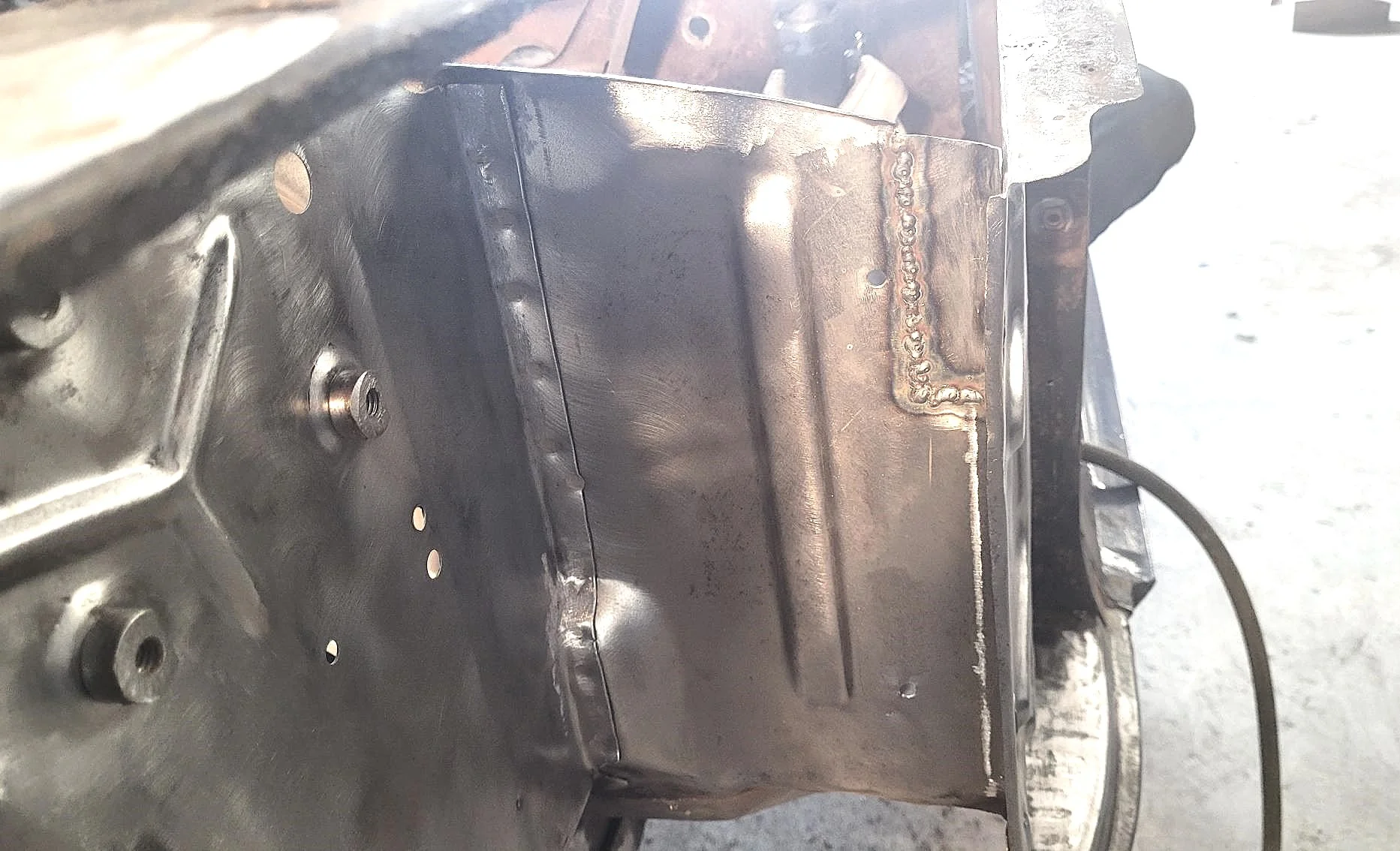

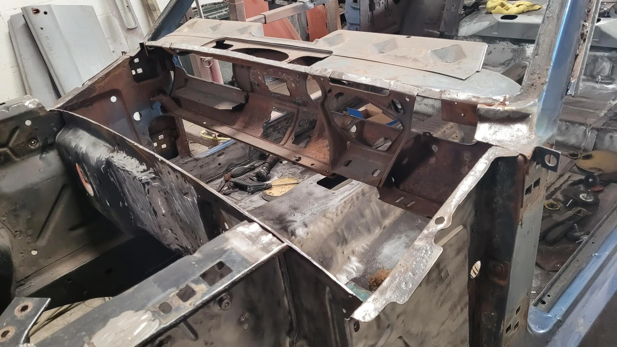

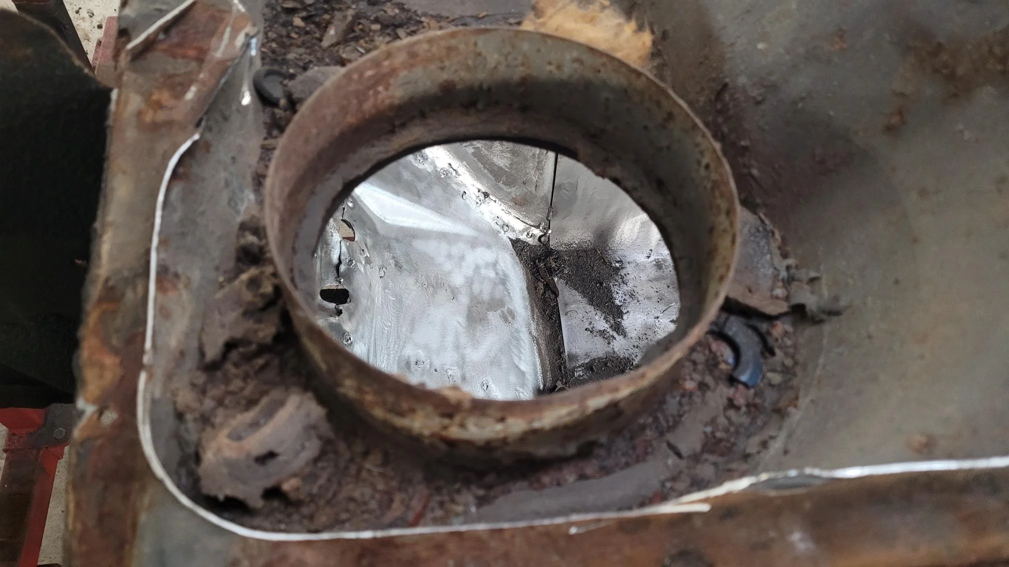

Years ago before he heard about us he had the floor replaced. It was plug welded but where they had it screwed together it was never welded. The screws were removed and they just left the holes for us to fix. They forgot to weld in the seat brackets. He is going to upgrade the seats so we are lowering the seat risers.
