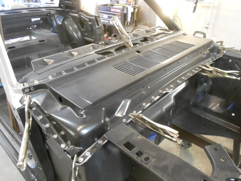

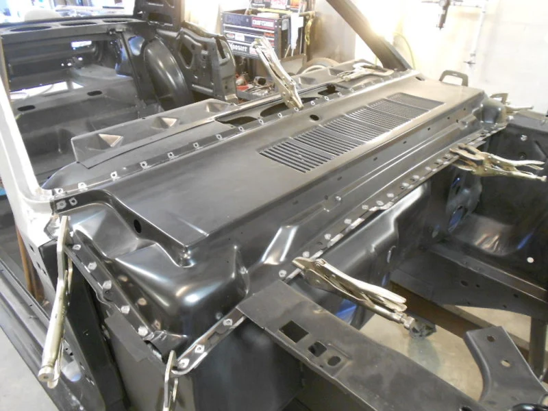

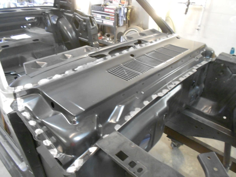

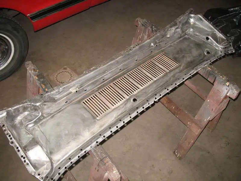

i counted the spot welds ,just in removing the cowl it was somthing like 180
spot welds that i had to drill .i think thats why my shoulder pops and cracks the way it does,an ice pack helps a little, its not to good on the hands either .i know the pain
167 on mine-and it only took one $5 harbor freight spot weld tool to get the job done.

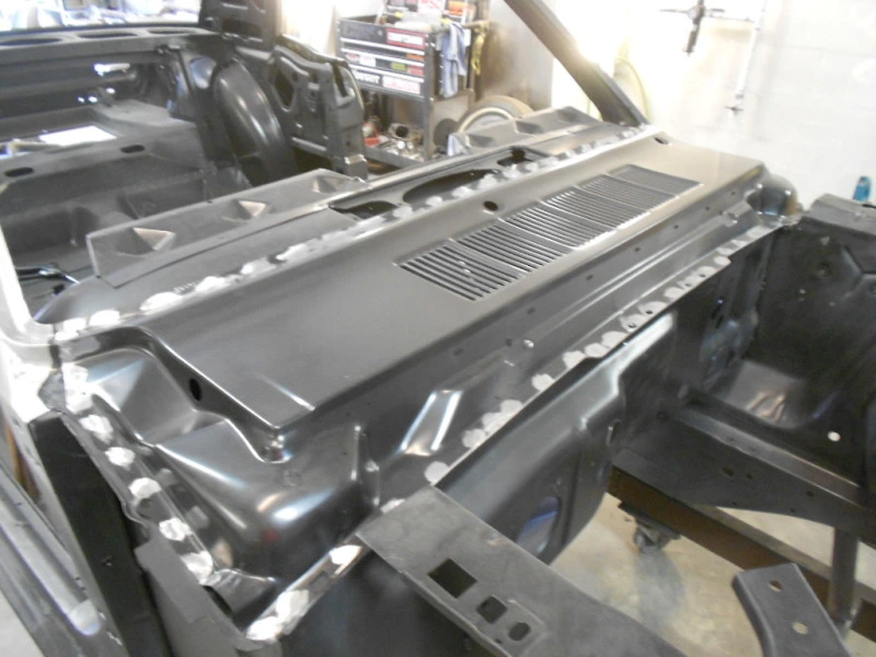

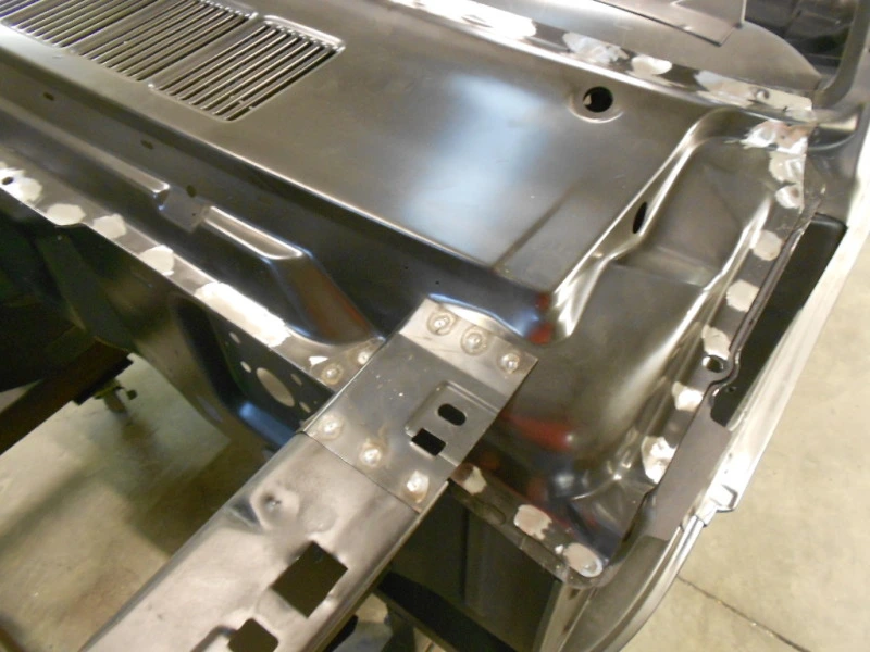

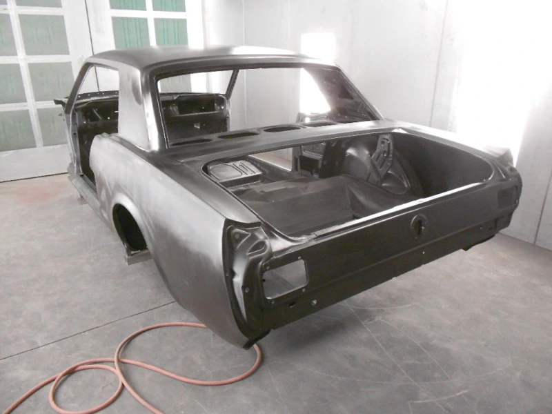

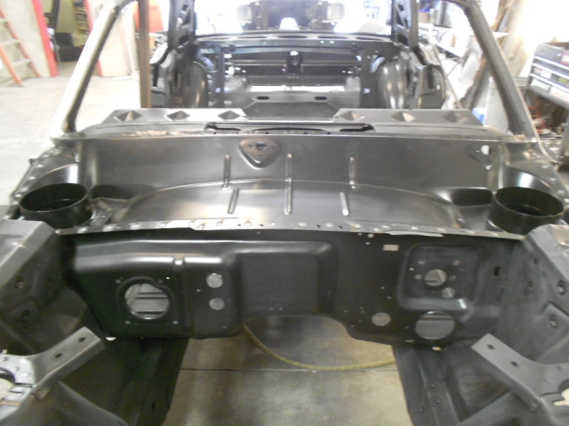

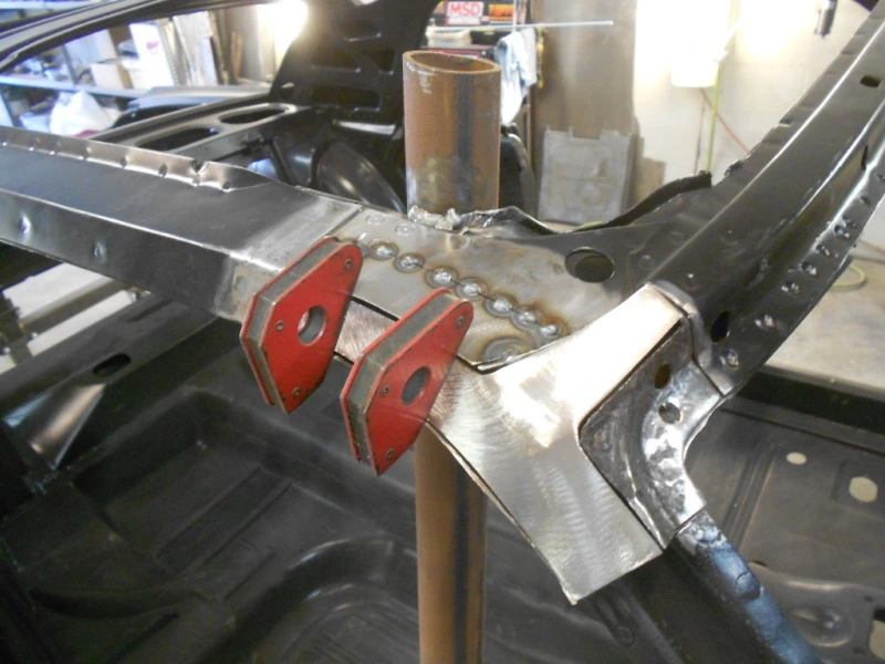

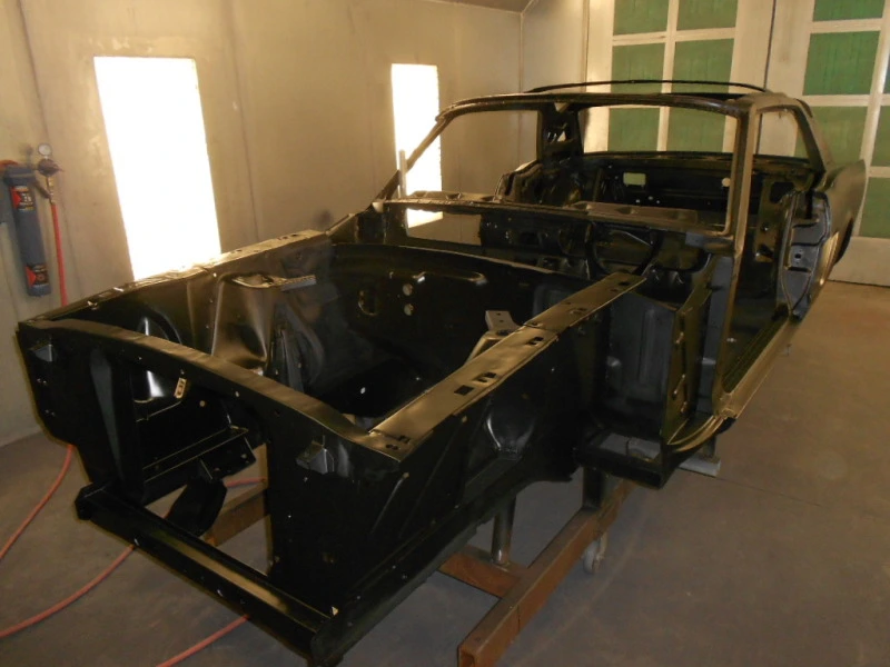

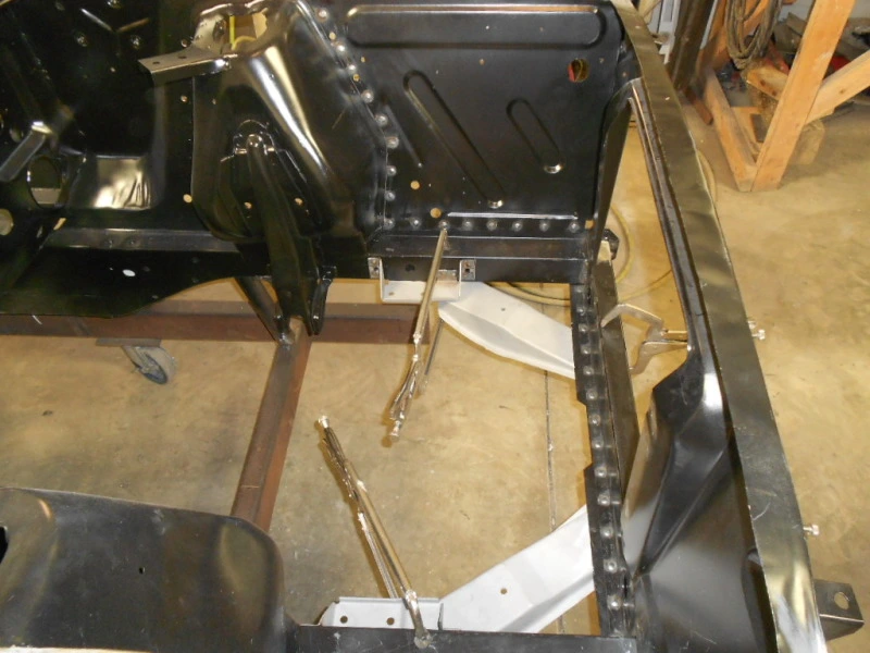

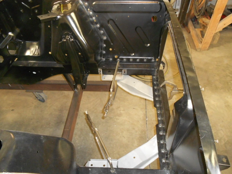

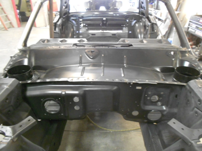

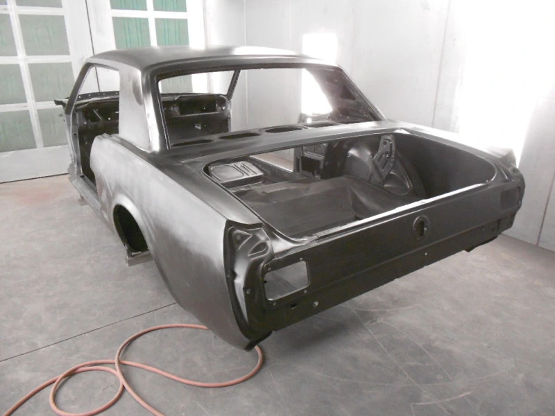

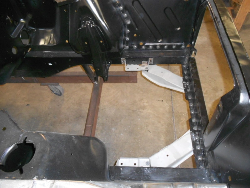

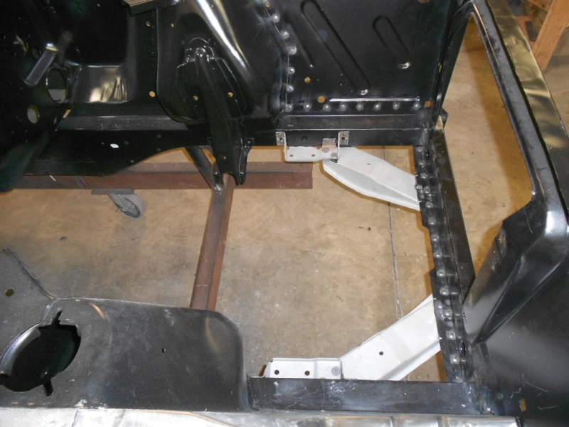

We have not made a lot of progress on this project. Brian fit and welded the strut rod and sway bar brackets
I epoxy primed the engine compartment

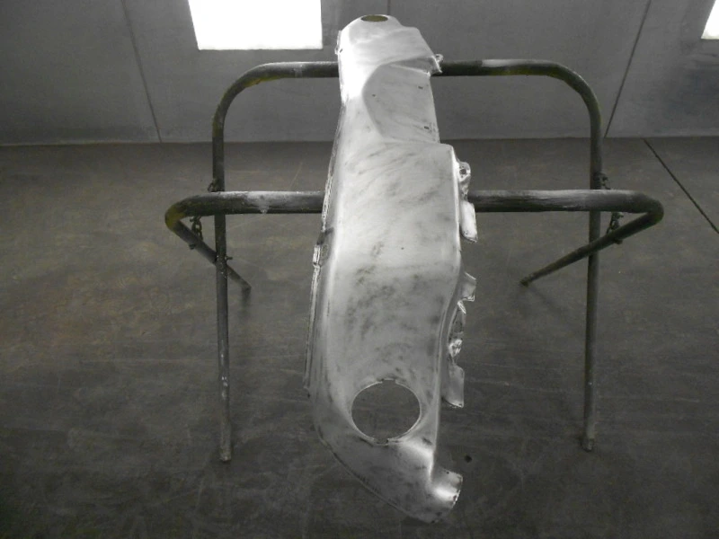

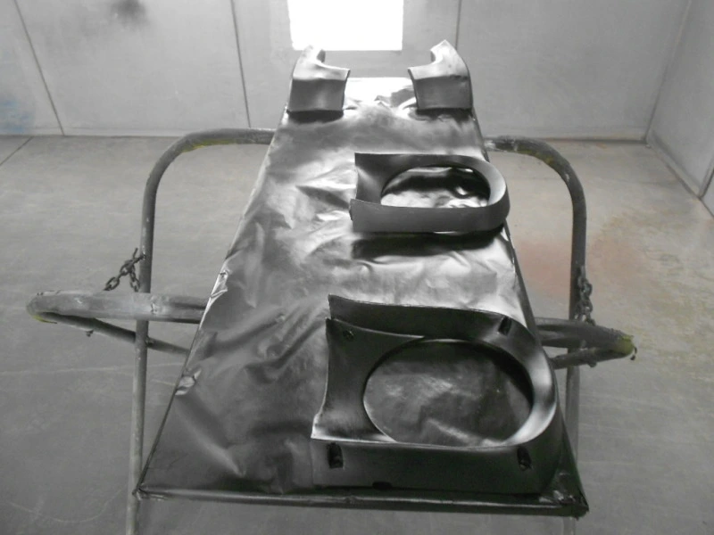

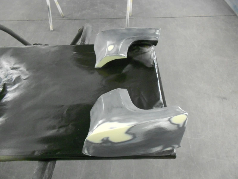

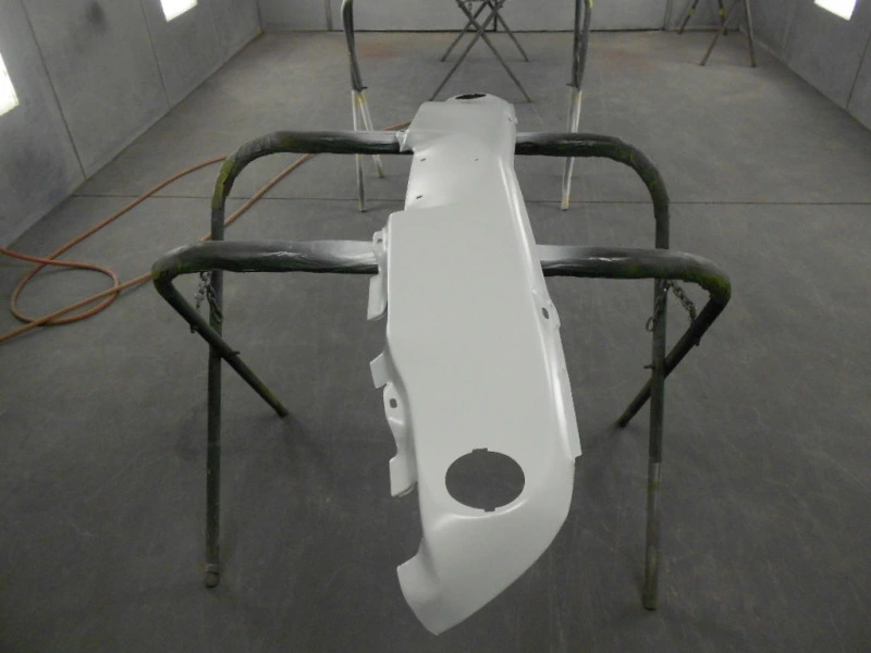

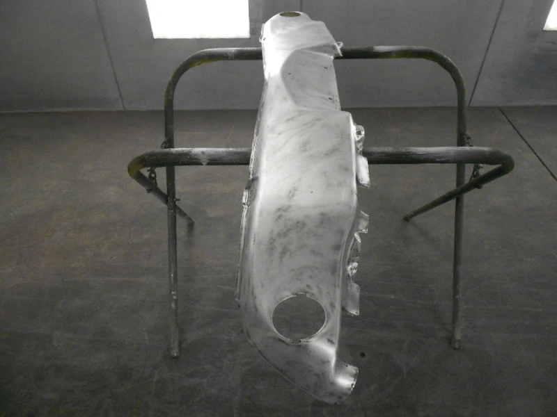

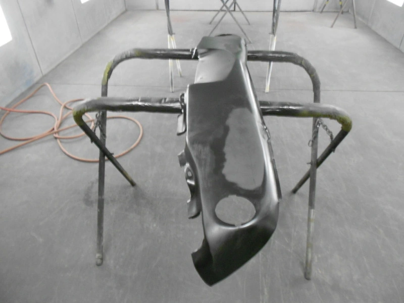

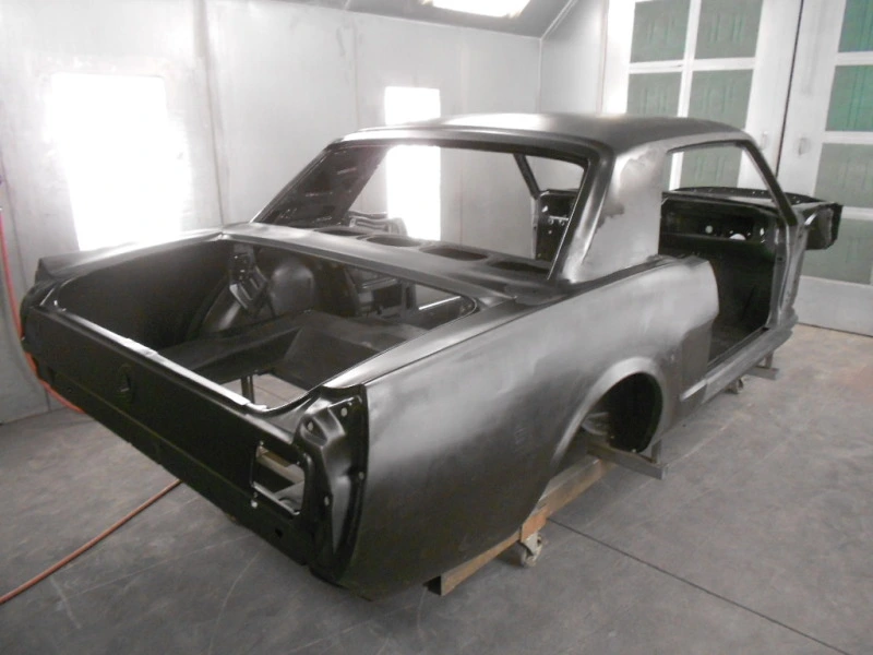

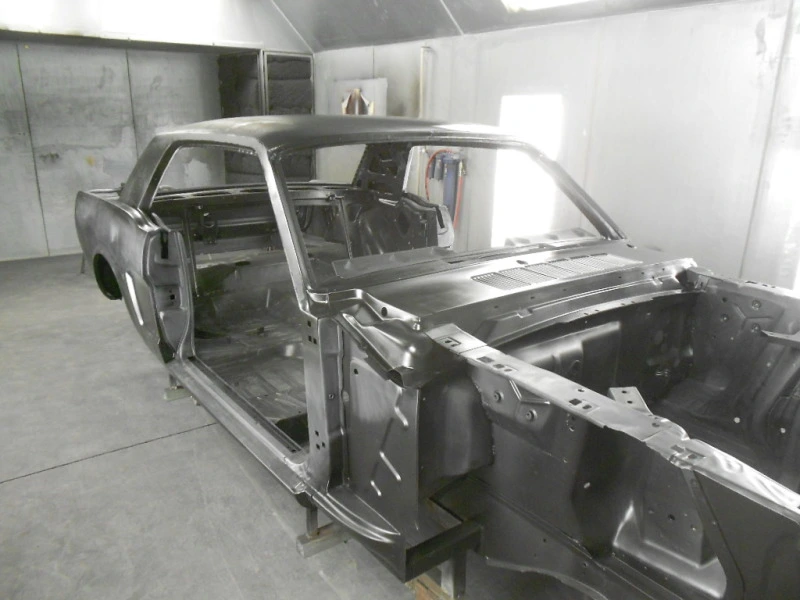

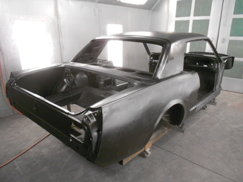

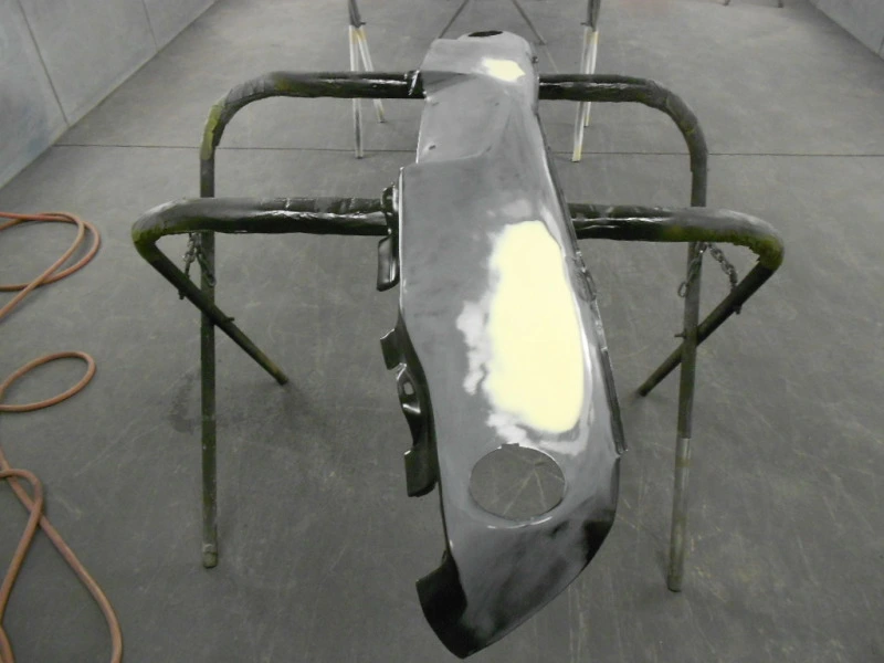

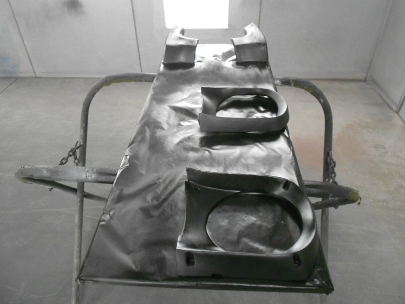

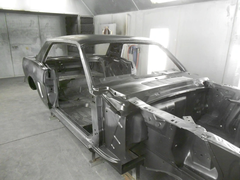

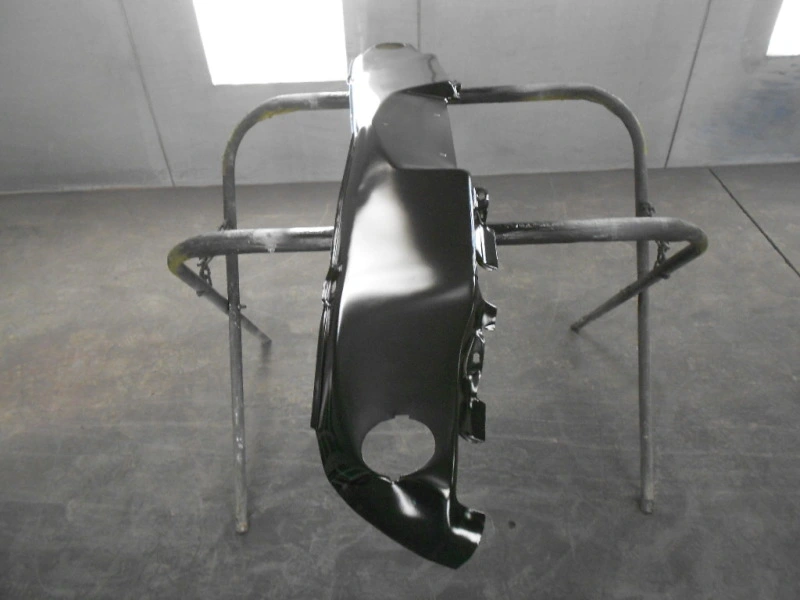

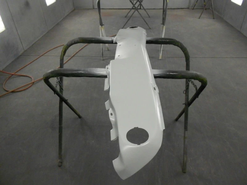

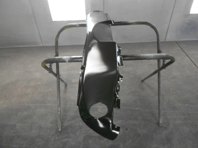

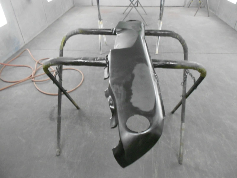

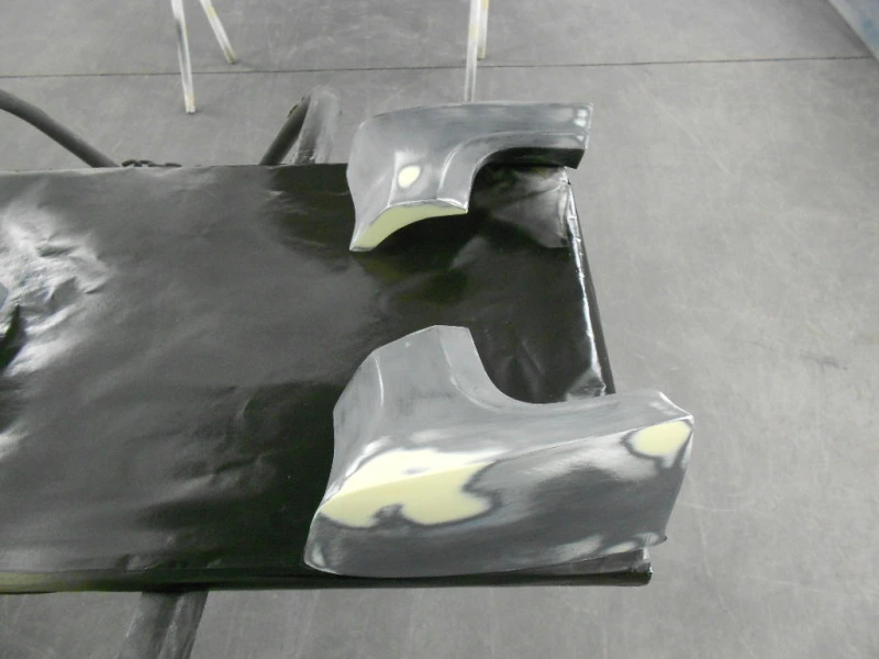

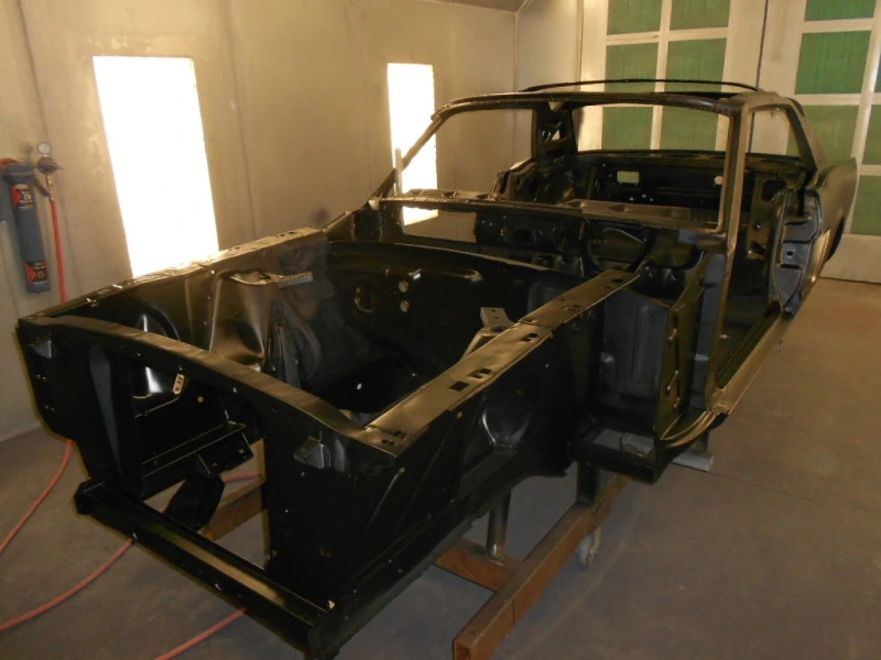

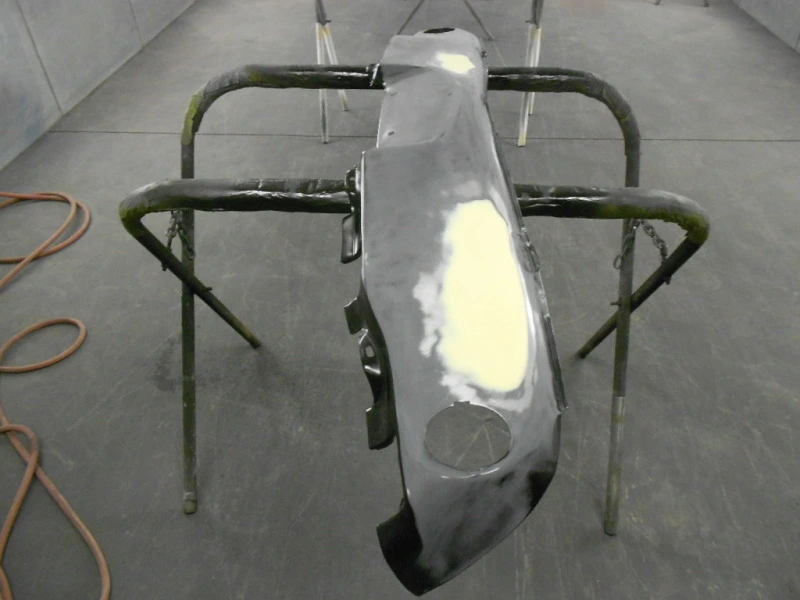

I sanded the front valance, headlight buckets, and end caps down to bare metal than epoxy primed.
I block sanded than did a little bodywork.
Next another coat of SPI epoxy to seal everything
I sprayed a couple of coats of Slick Sand

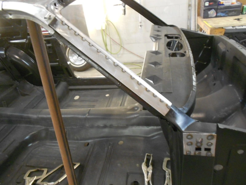

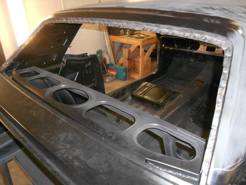

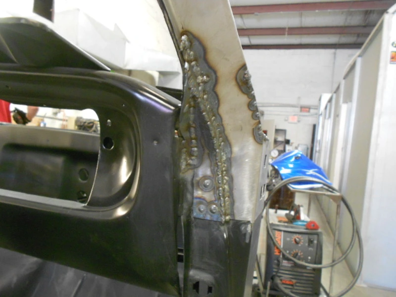

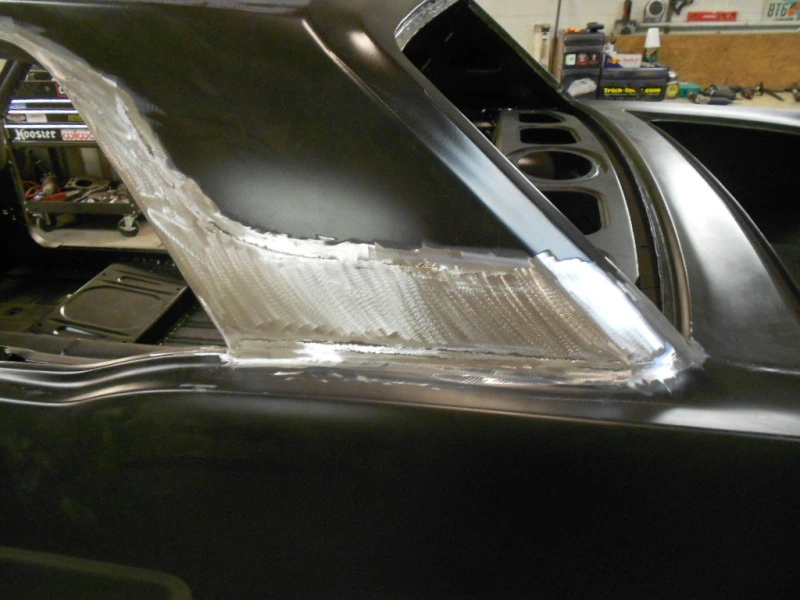

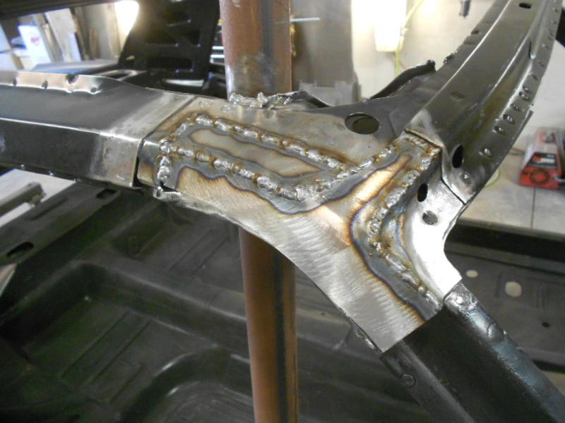

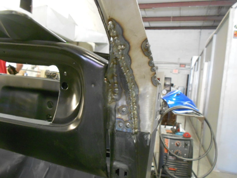

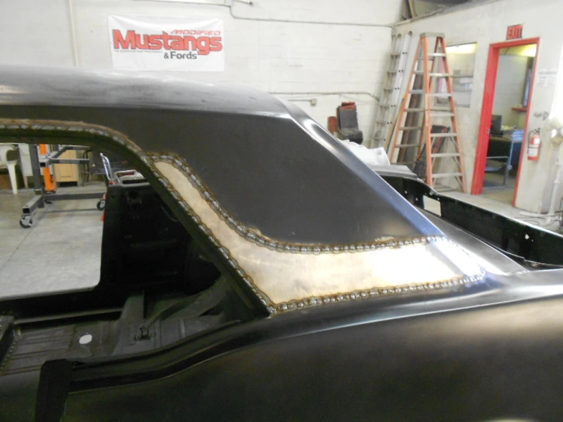

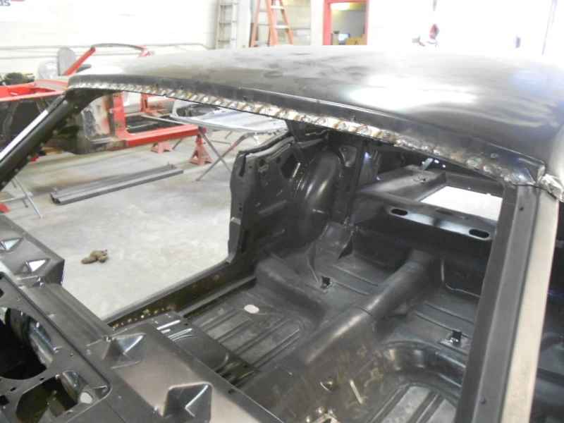

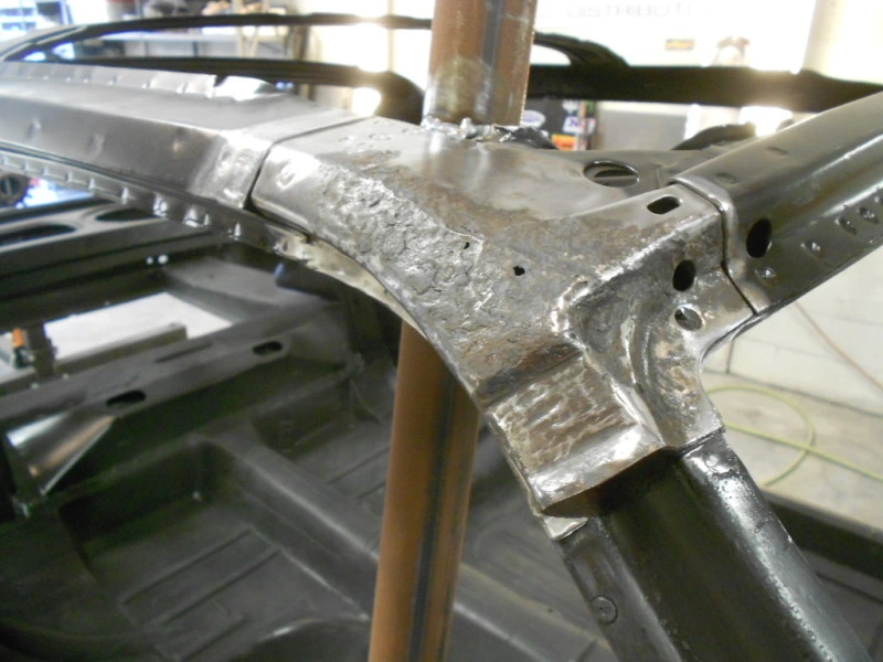

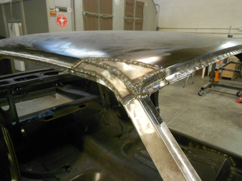

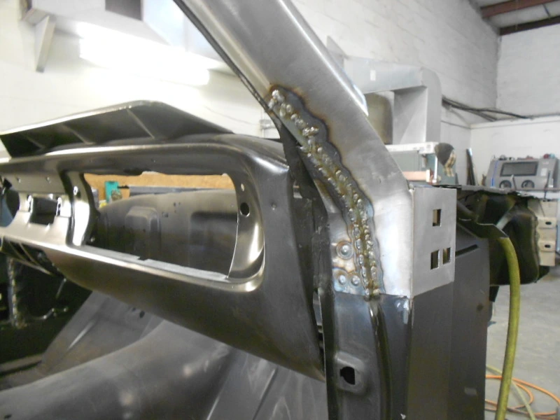

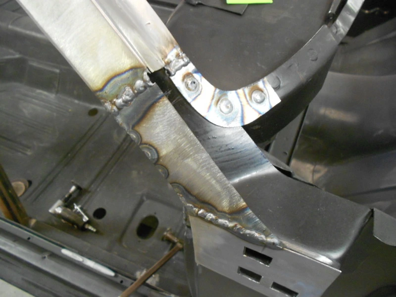

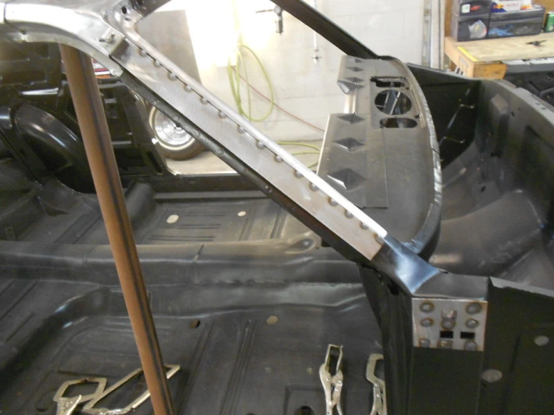

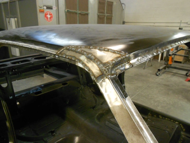

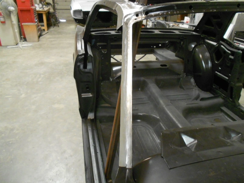

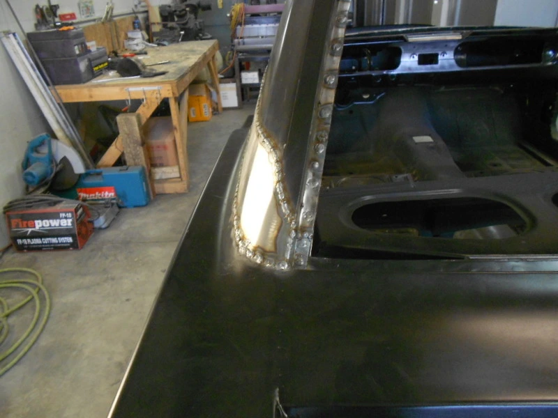

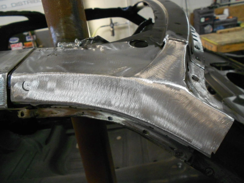

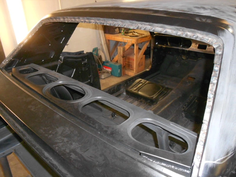

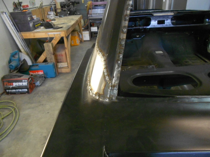

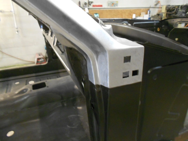

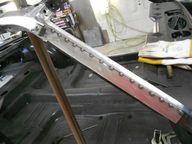

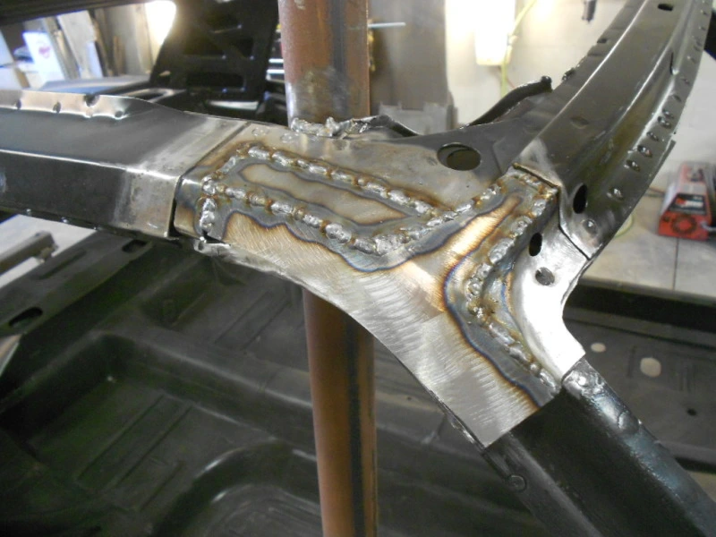

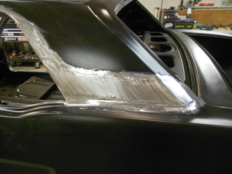

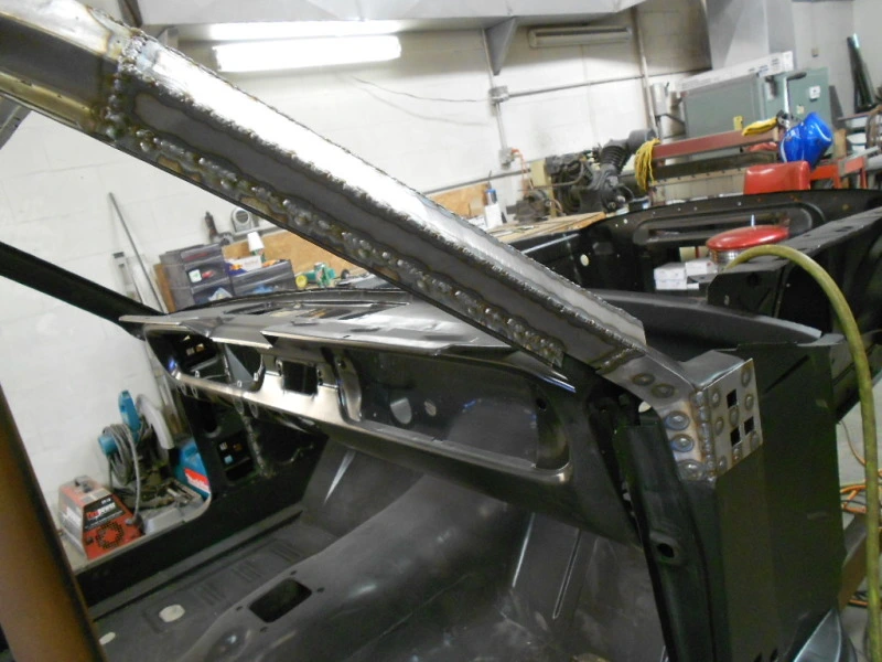

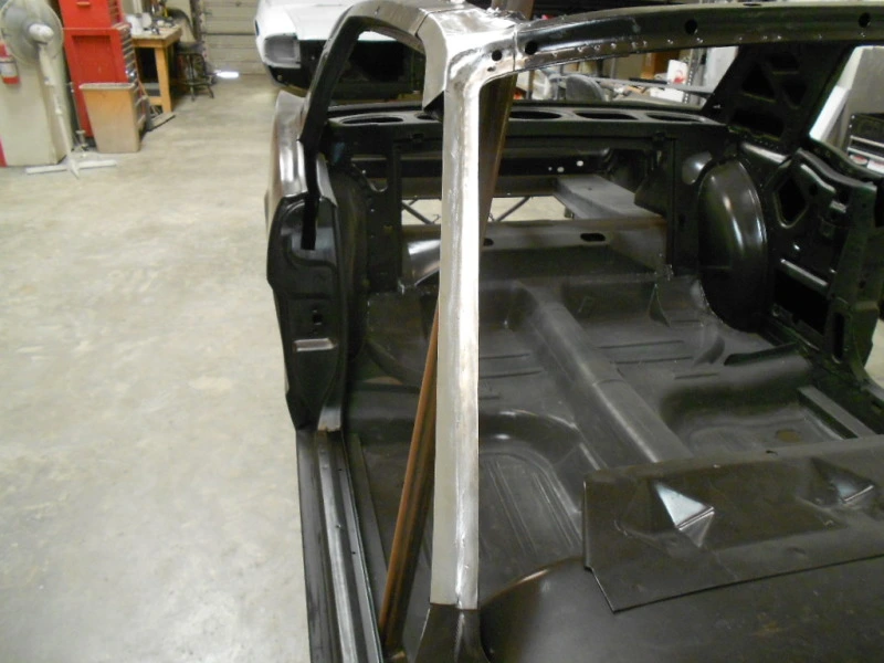

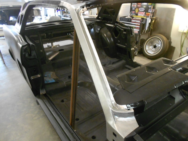

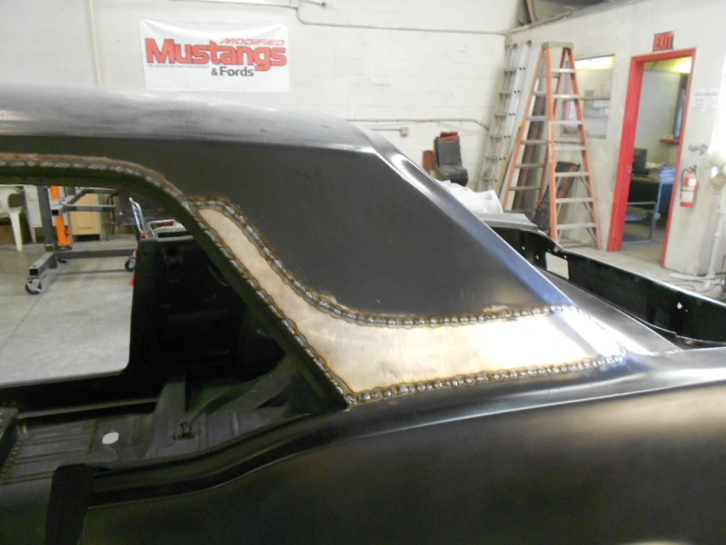

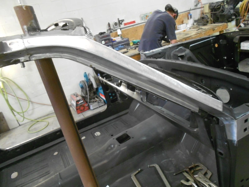

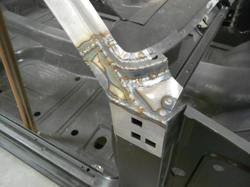

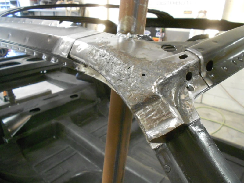

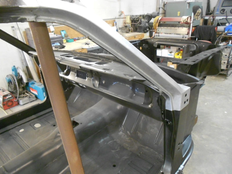

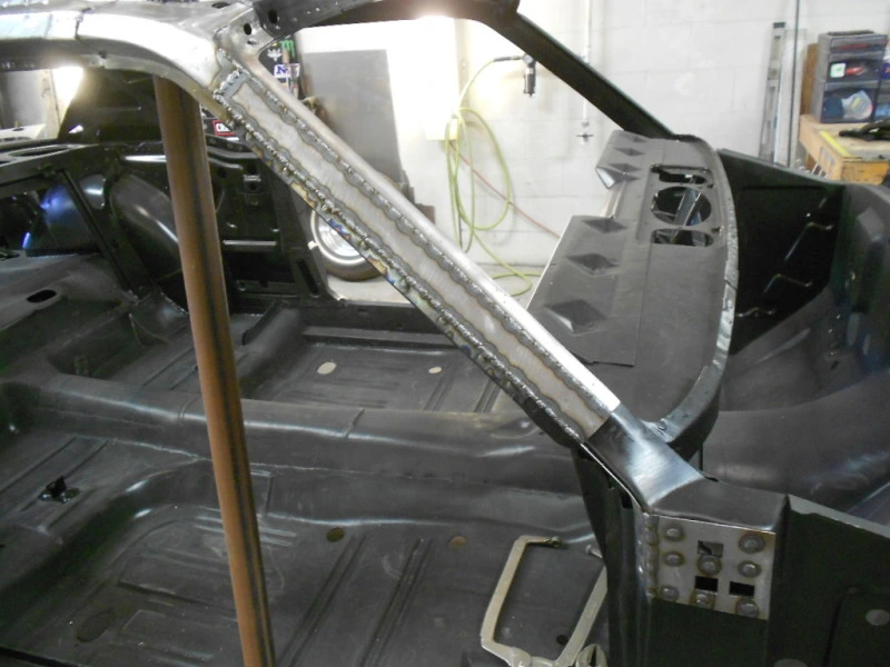

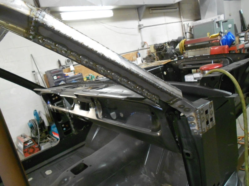

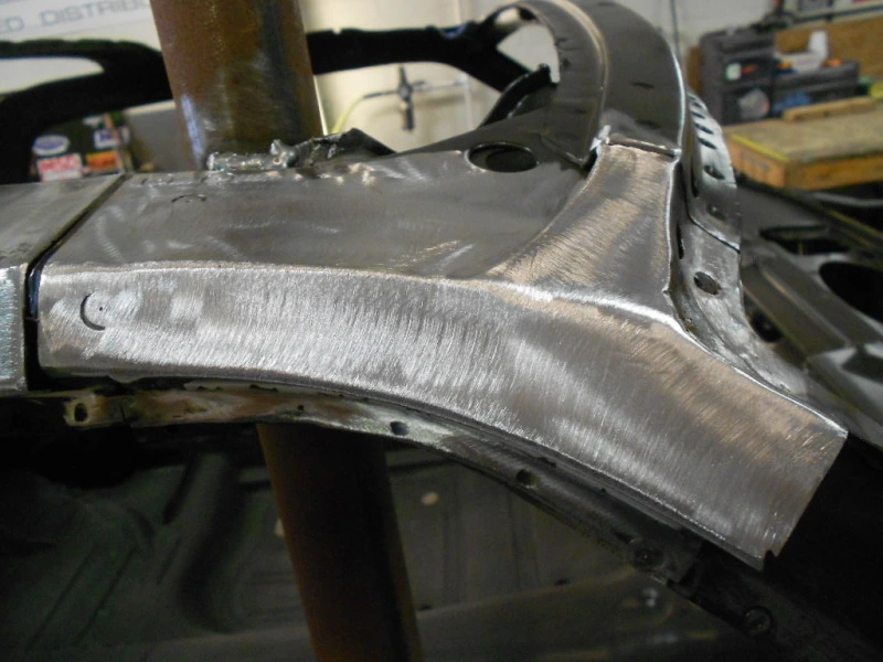

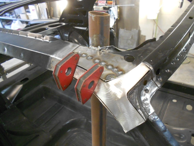

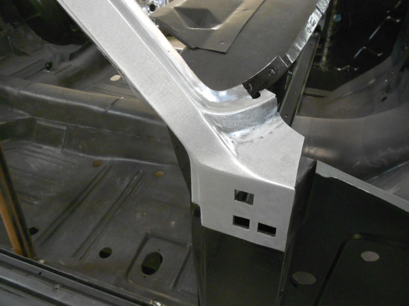

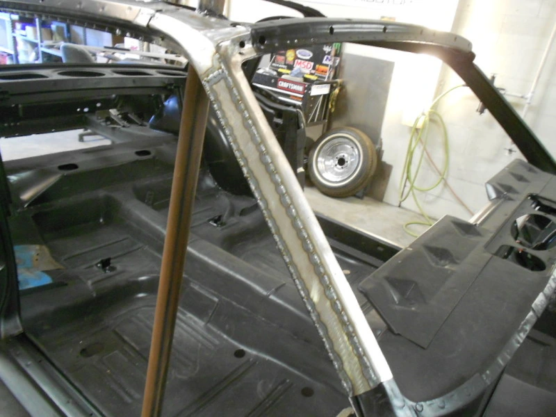

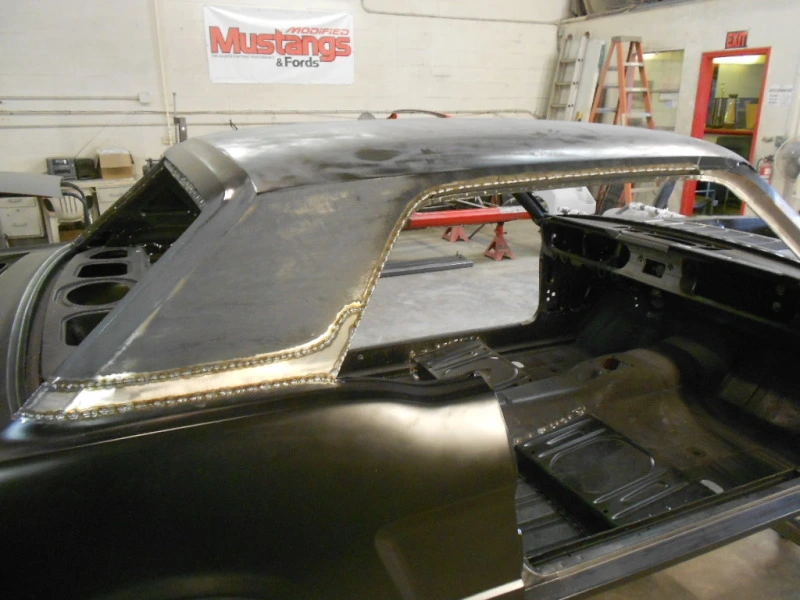

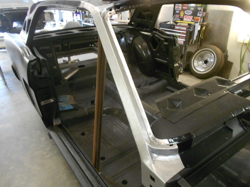

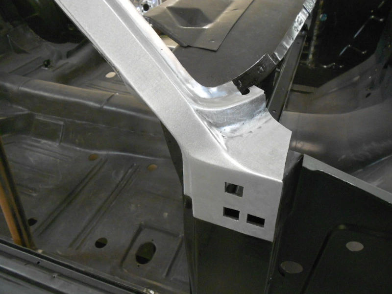

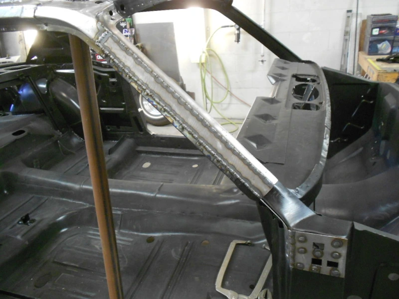

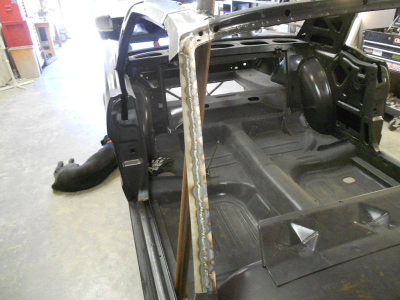

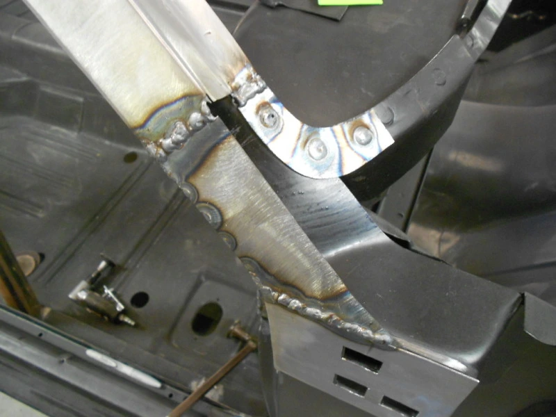

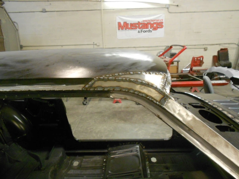

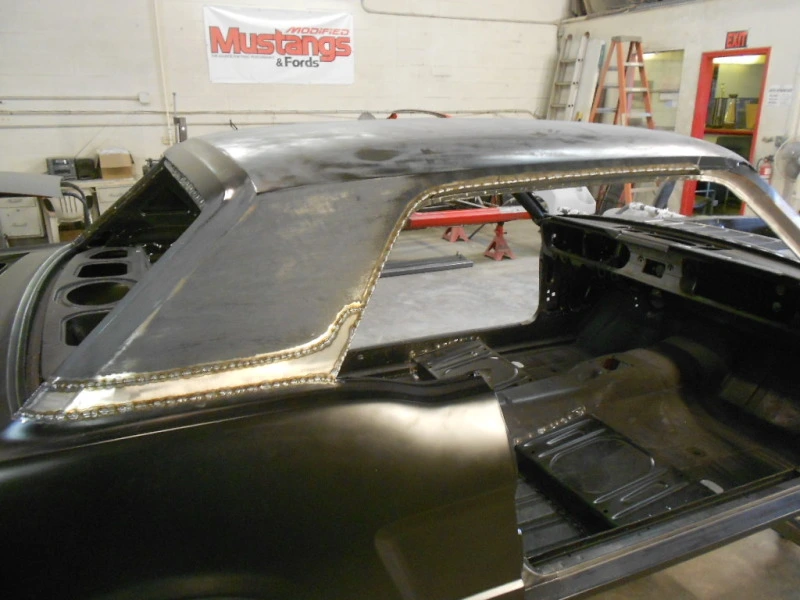

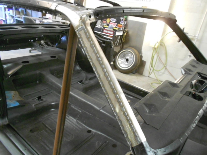

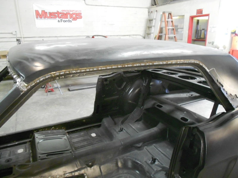

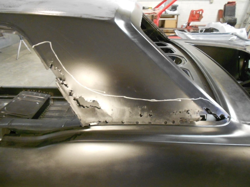

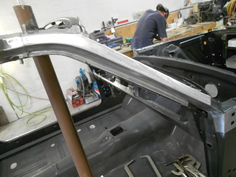

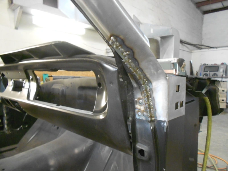

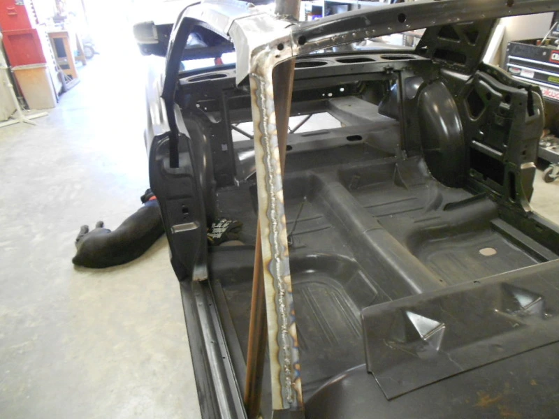

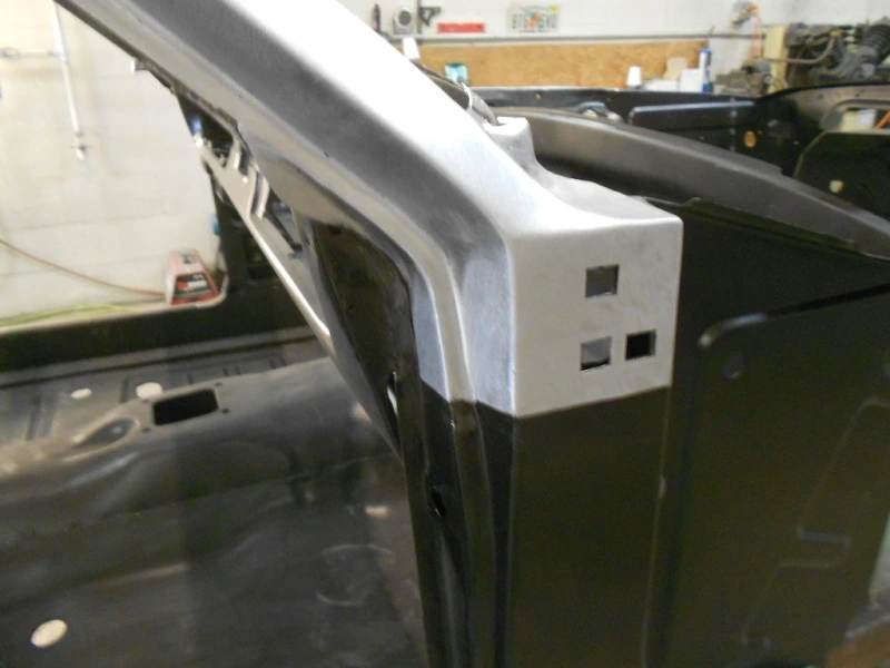

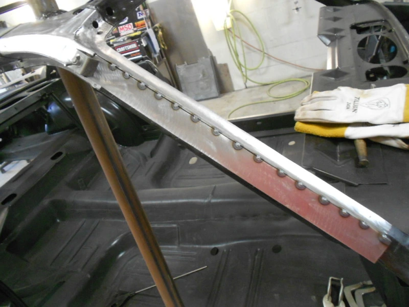

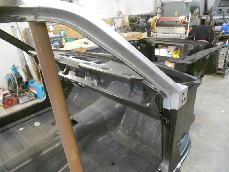

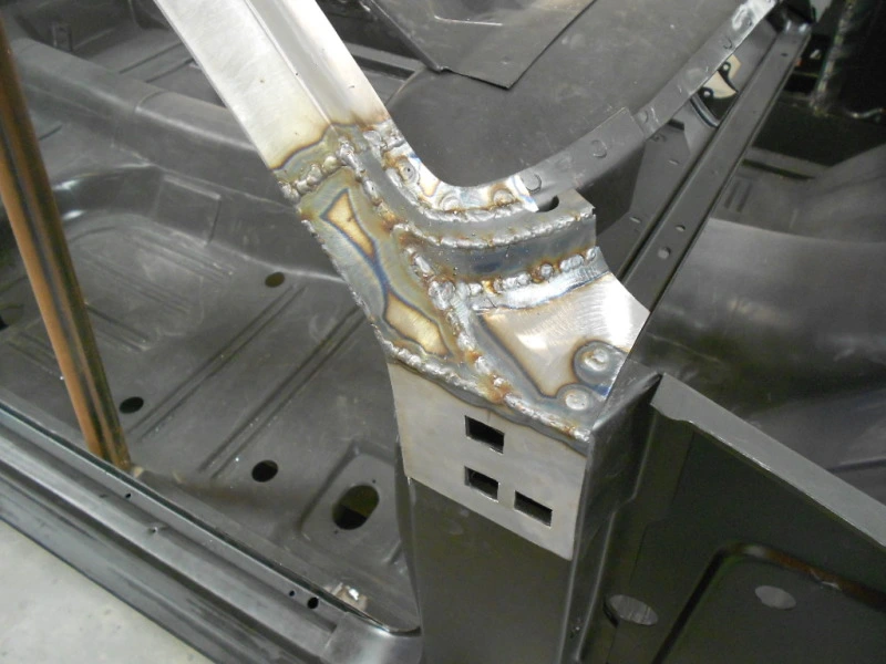

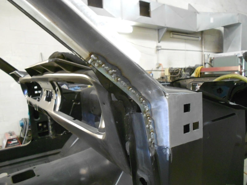

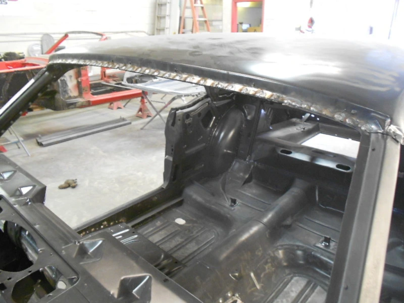

Now Brian has to fabricate the windshield post

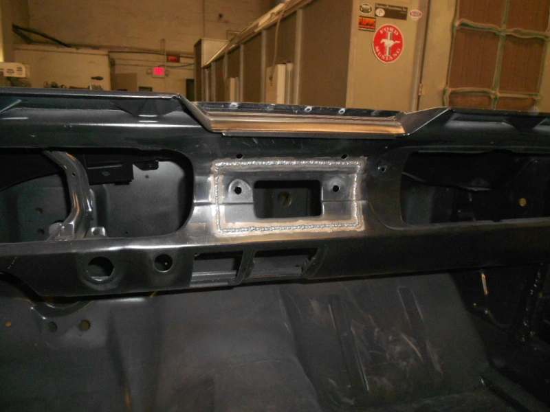

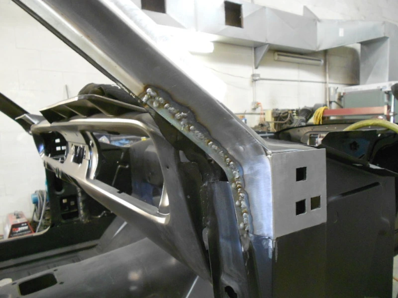

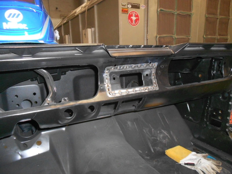

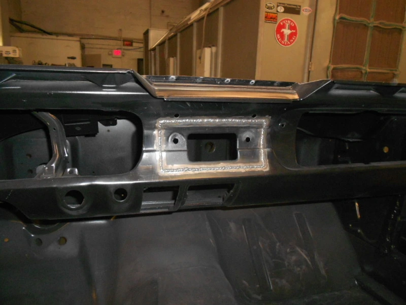

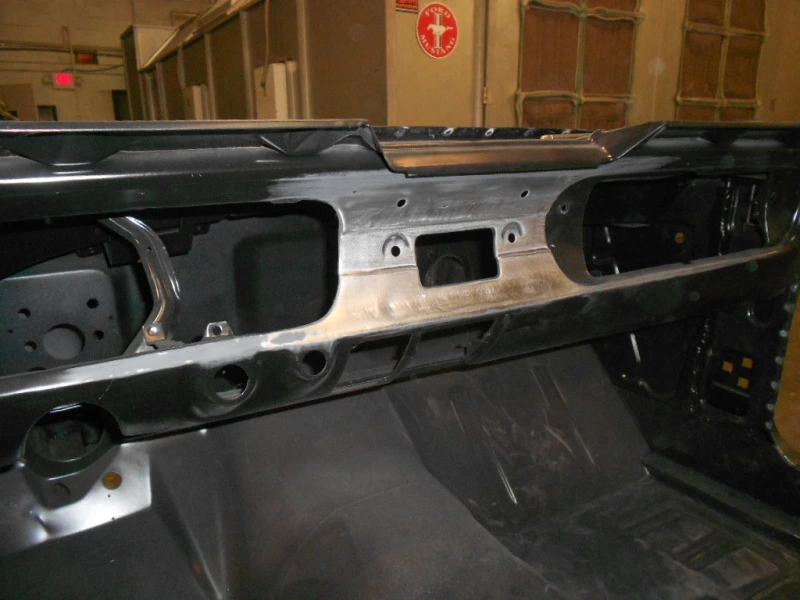

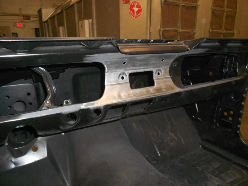

At one time somebody had drilled extra holes in the dash for a radio. We had an old dash that was replaced on another car so Brian cut it out and installed in this car.
