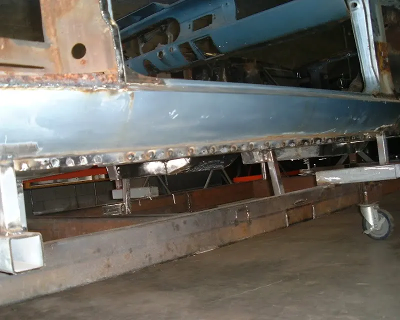

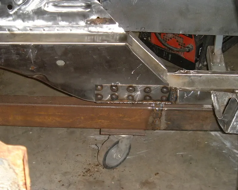

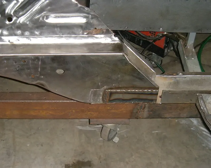

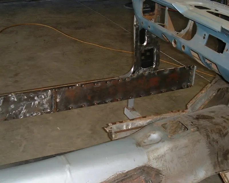

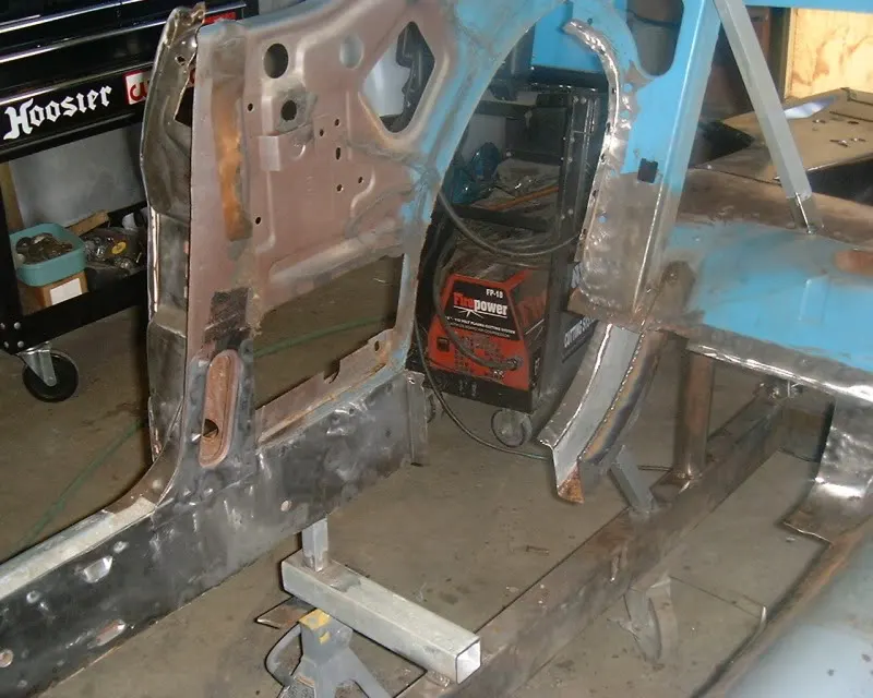

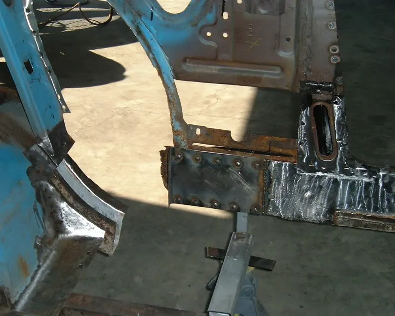

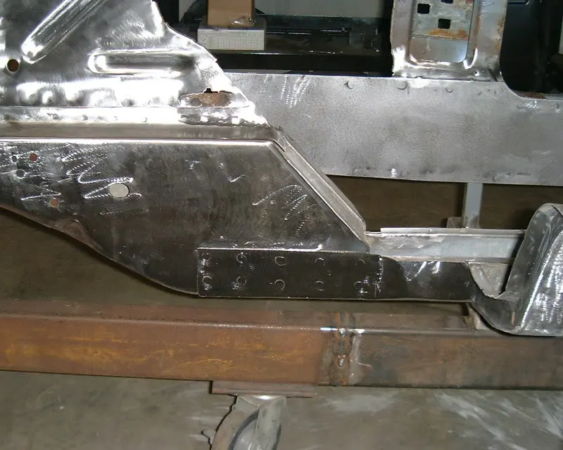

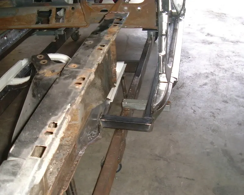

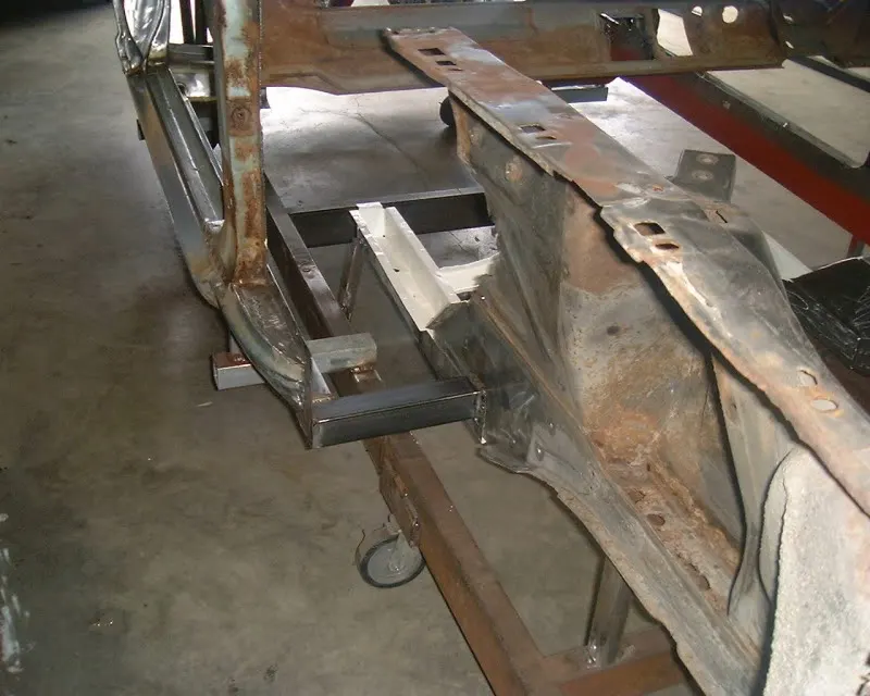

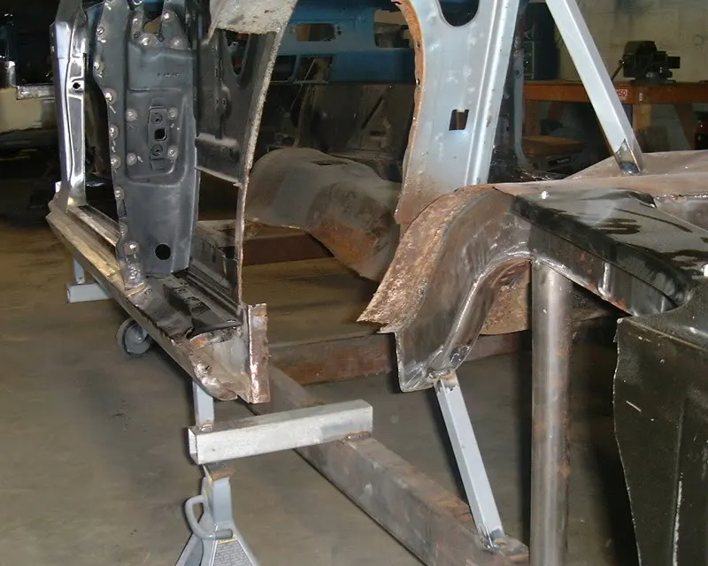

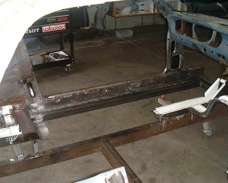

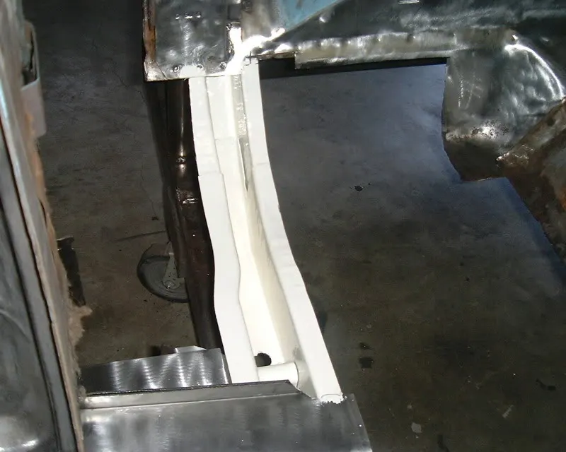

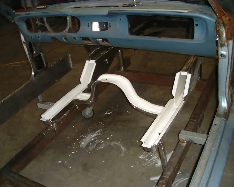

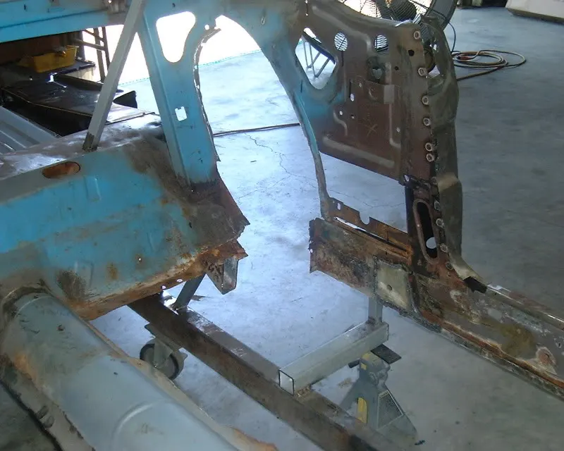

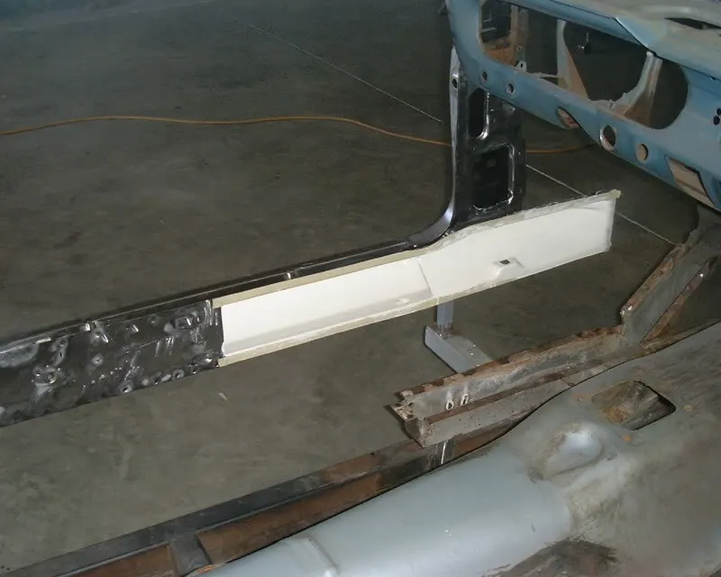

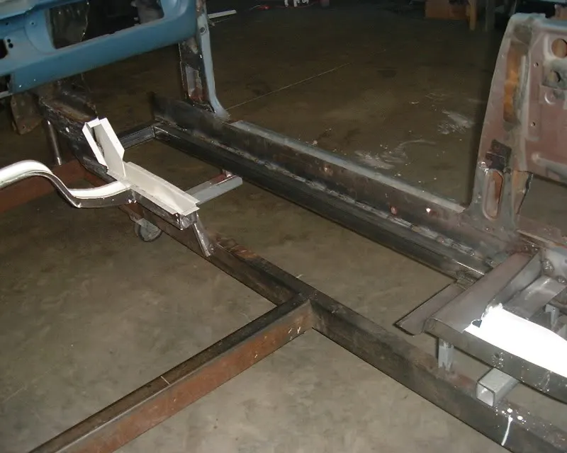

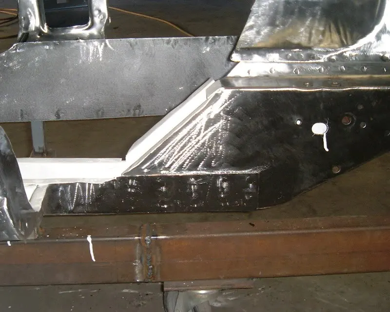

There was a lot of rust in the rear torque boxes so Brian added a brace and than will repair one at a time.

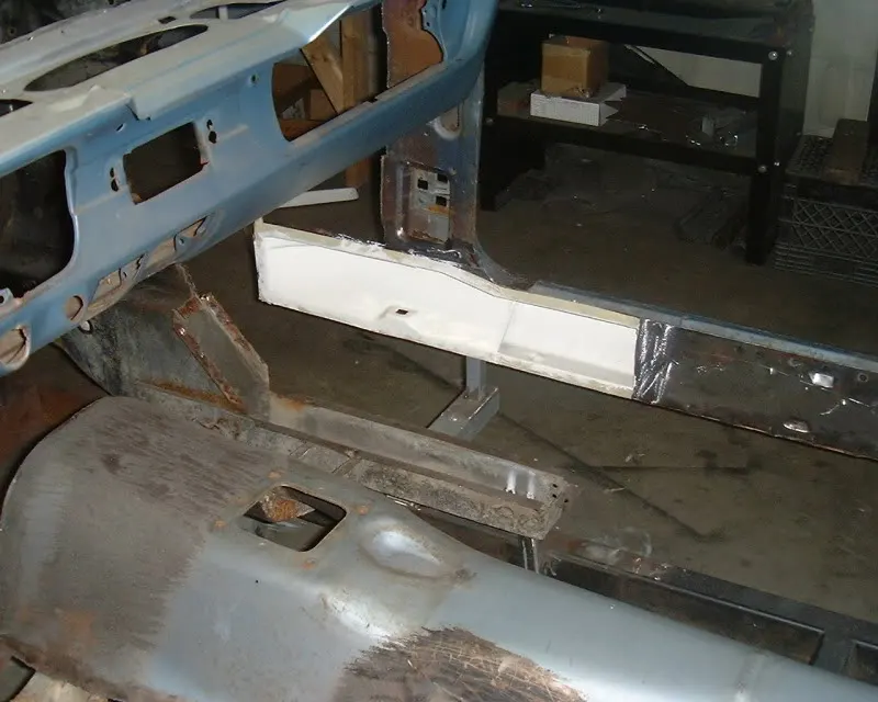

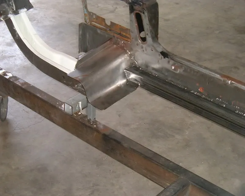

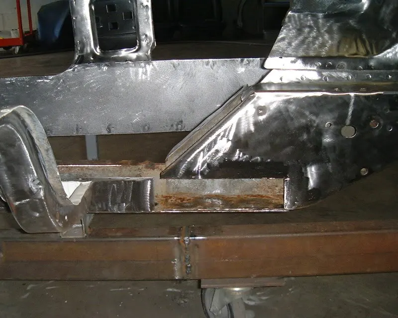

Once the torque box was removed he noticed a little rust in the rocker so he made a patch
