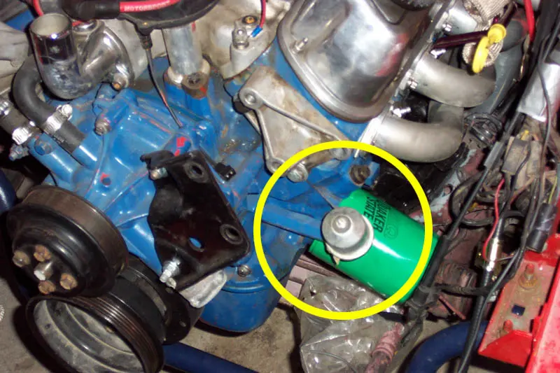

Can you post a picture of it? Is the sending unit just screwed into the block? Usually there is a hex tube that is 2 or 3" long that screws into the block and the sending unit screws onto that.
Something like this.
Reactions: 2Blue2

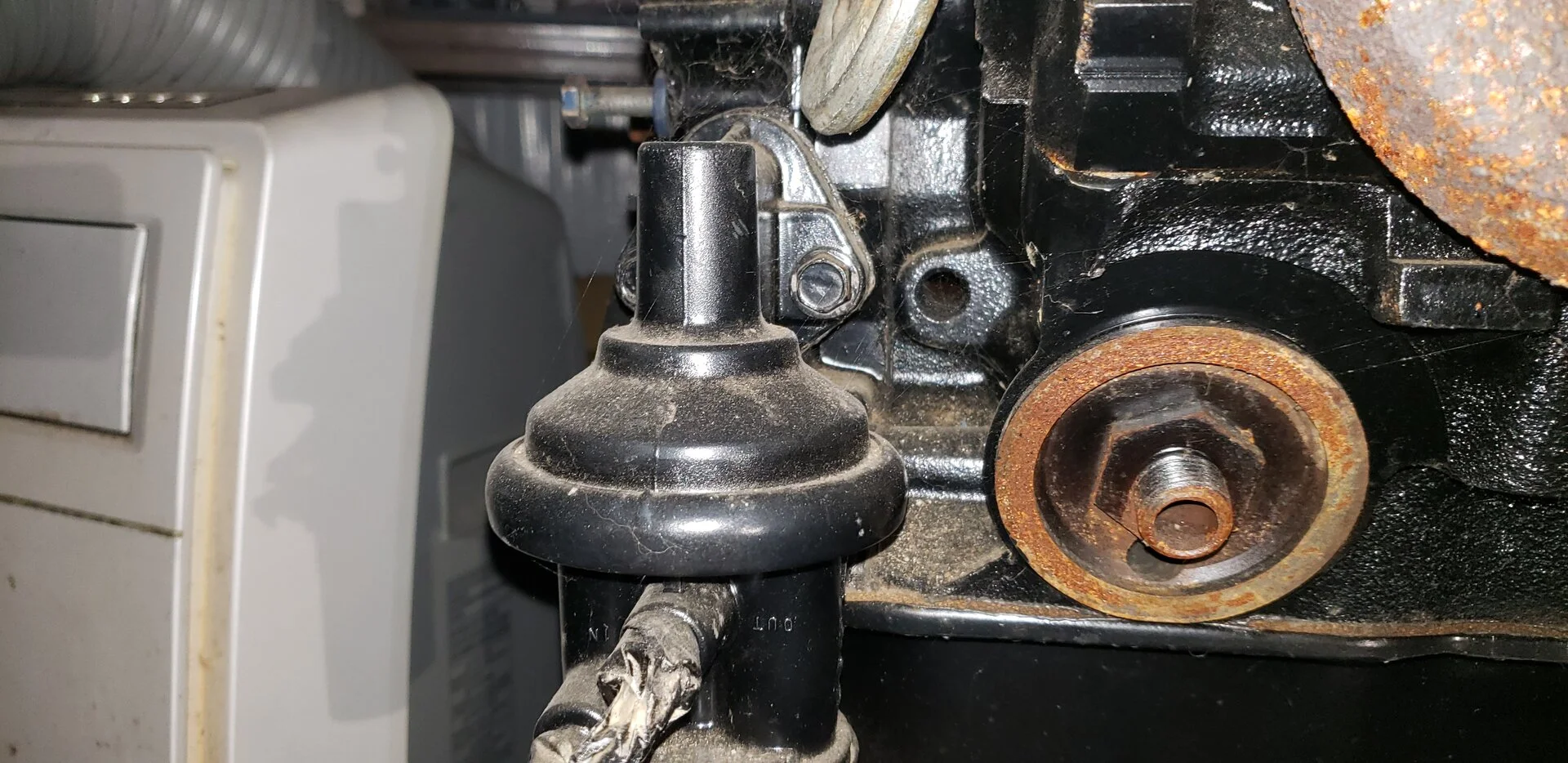

That was just a random picture that I found on the internet to illustrate what I was talking about. I have the 289 out of my 65 on an engine stand at home. I'll take a look at it when I get home. I might have a picture of it on my computer here....
Also, the fuel pump was removed on that picture that I posted. Making it way easier to get to. I'm not suggesting that you remove your fuel pump though.
Yeah, man. I'm sorry I didnt post earlier. I've been with the family all day. I looked at the engine. The sending unit is not installed at the moment. Just a hole in the block. I can take a picture of it if you want.
