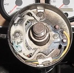

I have a 65 coupe. My turn signal was replaced about a year ago. But what I am trying to find out is why I have to cancel it all the time? When I turn the wheel back the signal keeps going until I manually cancel it.
Is this correct? Is there a way to have an auto cancelling turn signal in a 65?
Thanks

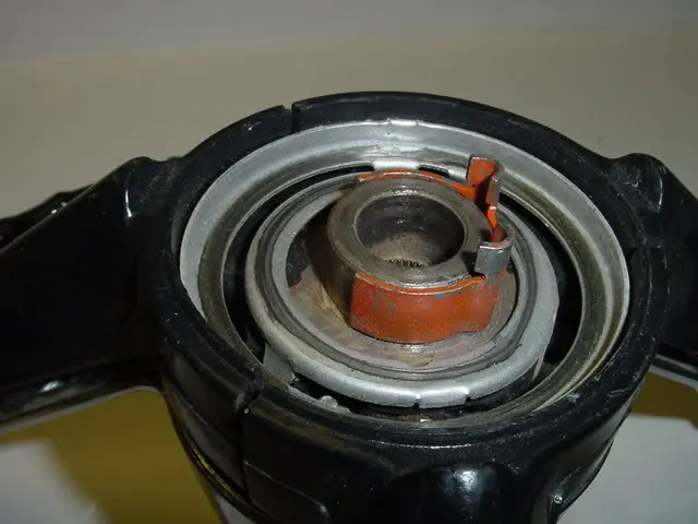

On the back of the steering wheel hub, there should be a ring with two ribs on it. The "release fingers" on the turn signal switch hit the ribs to cancel. If these are broken, missing or out of place, the turn signals will not cancel.

would this cancelling peice be in the adaptor kit?
Yes, he likely left out the pins that do this.
They could be replaced, most likely that's the cause. Personally, I'd replace the wheel. My opinion, formed over the last 40 years or so, of Grant wheels is not repeatable in a family setting.
