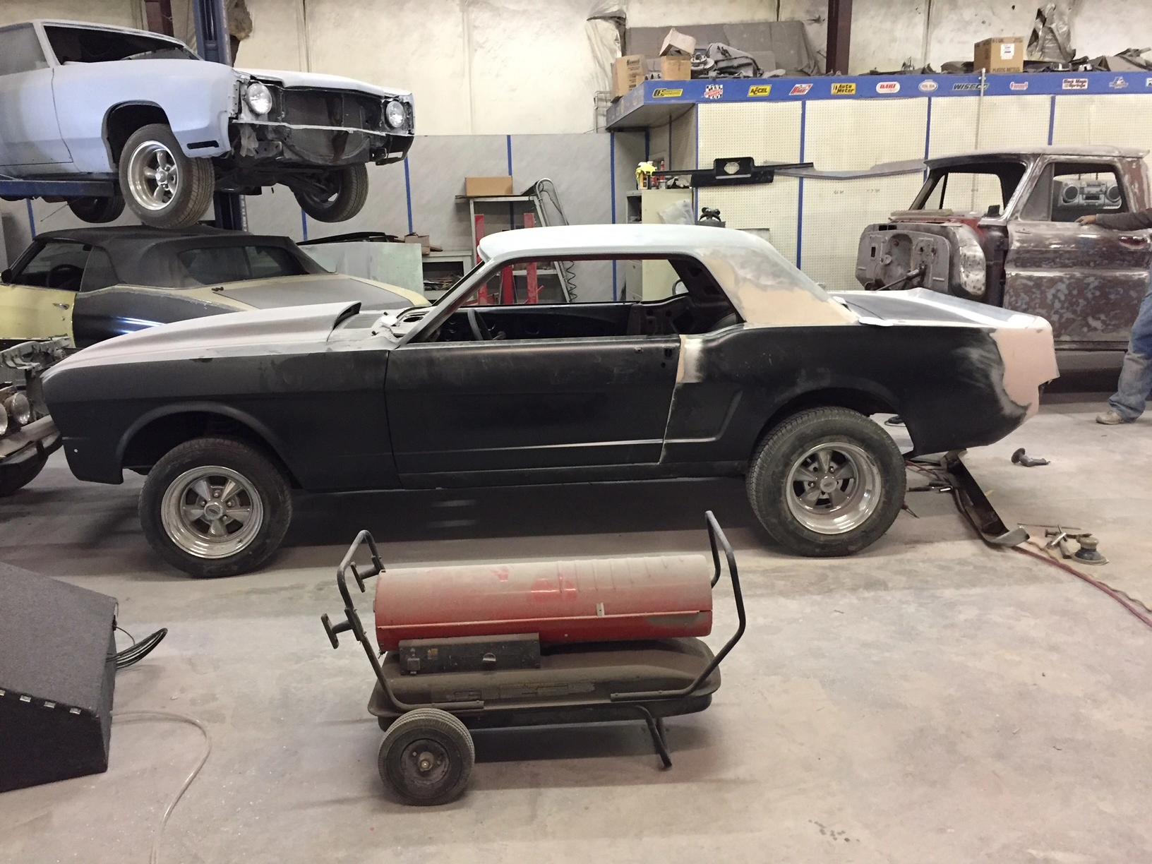

Thats what our project car is....a 6 cyl. that someone had done a 5 lug change with a 8" rearend with 5 lug drums on the front. They left the 6cyl front springs in so it sits lower in the front BUT if you hit dip in the road it will get jumpy because of the weaker springs.I am looking at a front spring up grade and disc brake set up and needed to find out what type spindles I have. My thoughts are that some one could have resized the inner and outter bearings to make the 5 lug hub work. So part number is the way to go... C5DA-3107-B is a V-8 spindle and C3DA-3107-A is 6banger.Hope this helps.
