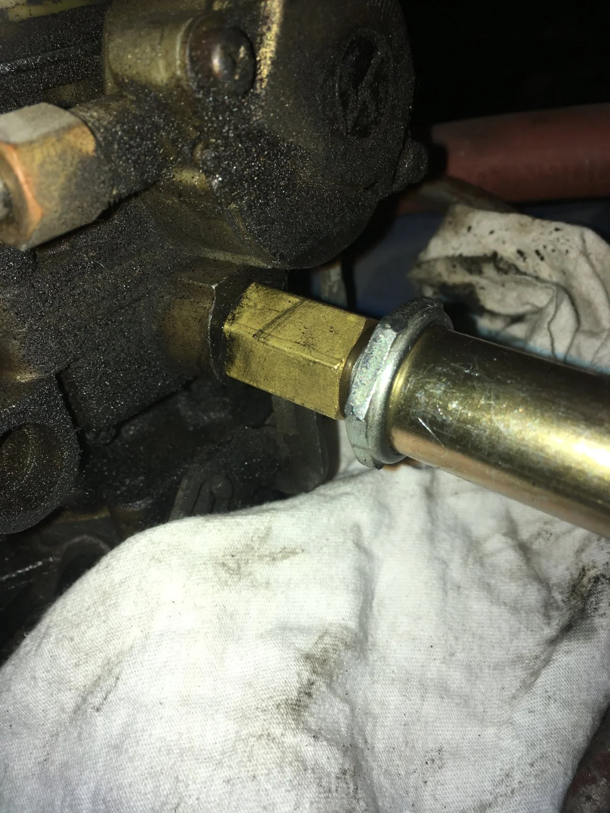

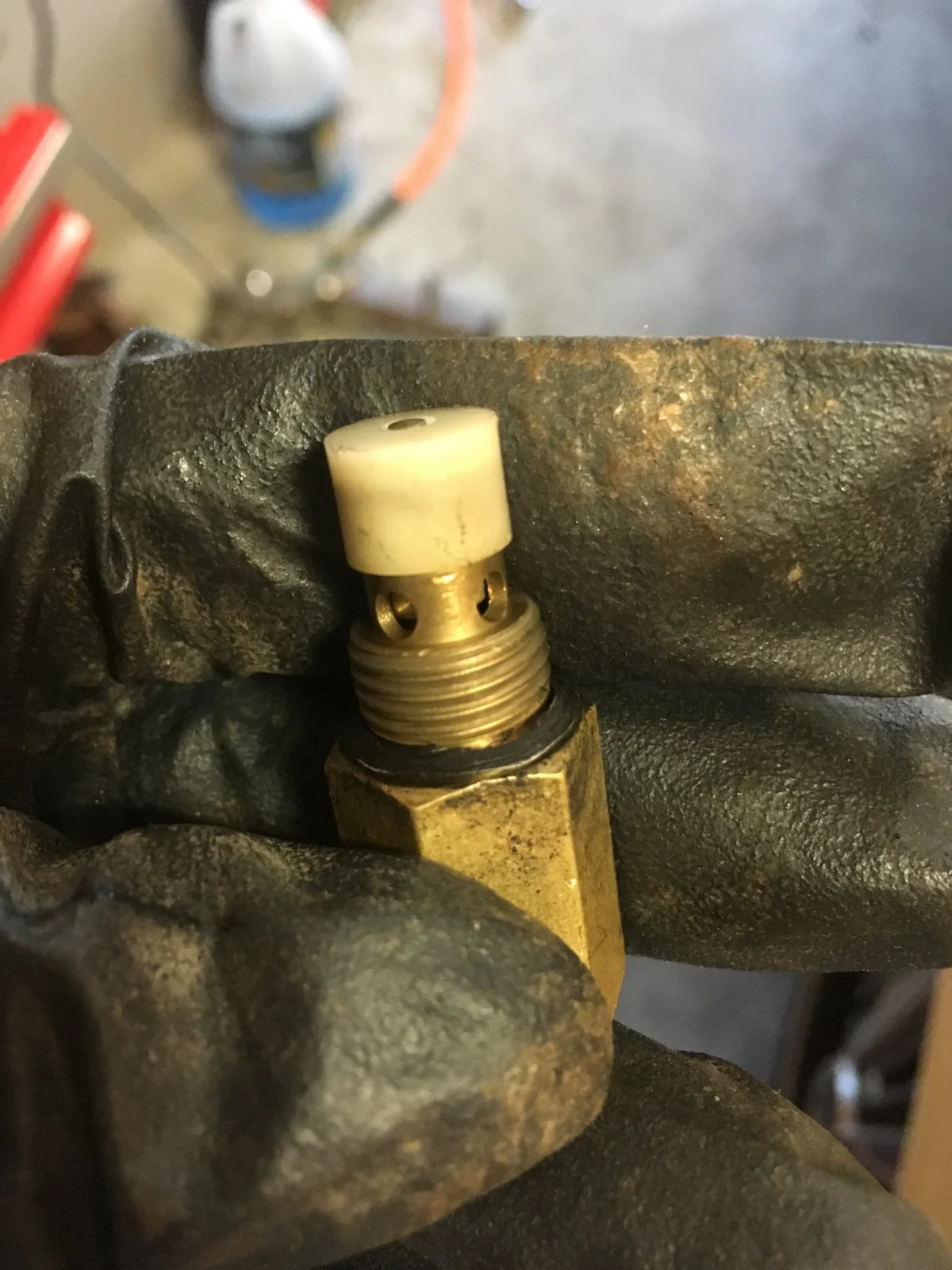

Thanks for replying I drive it about once a month. I believe I have isolated the problem to what appears to be an external brass check valve between the fuel filter and the carburetor. Having a hard time finding it anywhere to replace it.
Attached photos AC013956-68F9-436D-A142-1F0275331C99.webp 31038B87-B8B6-4169-8056-189B129A7071.webp
I don't remember those, from what I remember that type of filter screwed directly into the carb. I wonder what it's purpose was? Can you take the guts out of it and just use it as a fitting? Unless it's a pressure regulator ? I'd gut it and see how it runs.
