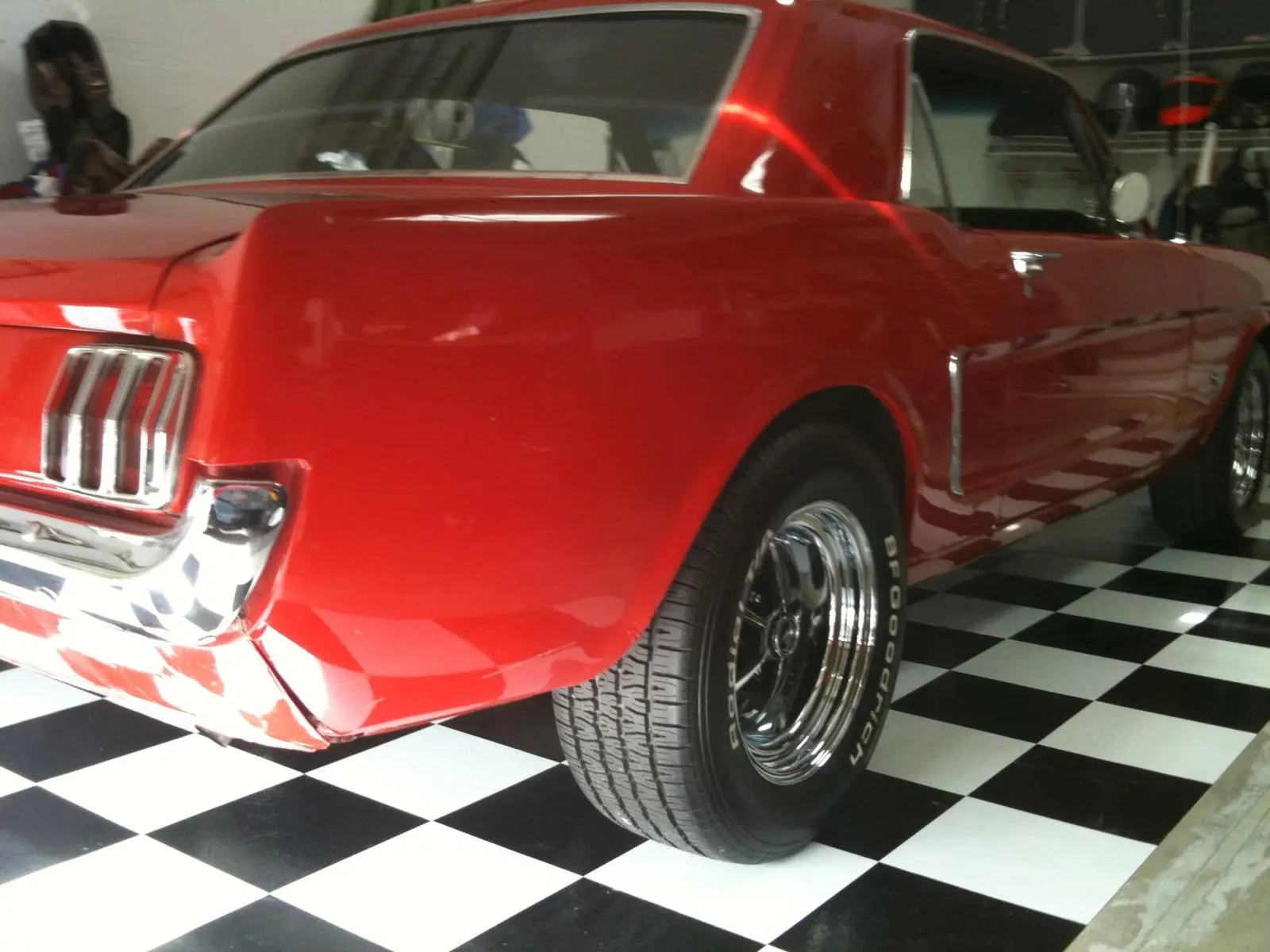

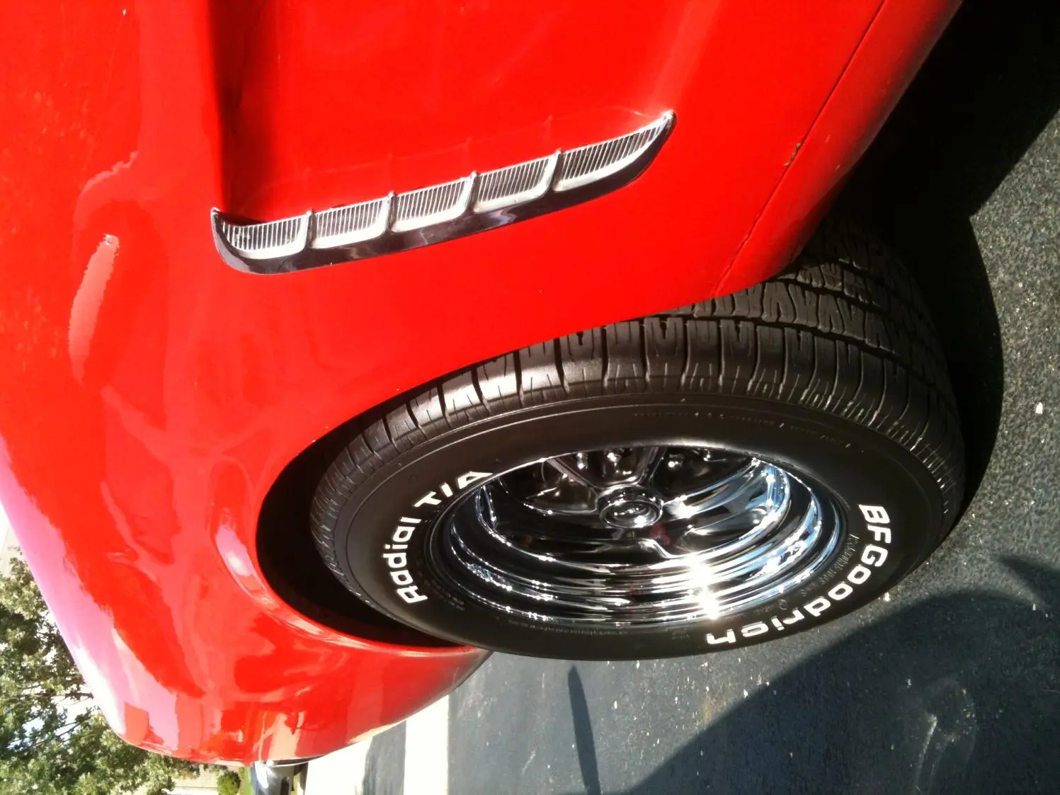

You can have it narrowed, thats how I did mine, I'm a few months ahead of you doing the same project. I have my 289 sitting here 75% done and my suspension and rear end are all in. the rear end was a lot of work, I have a little over 2K into the rear end alone, but its a 9" narrowed to fit 15x8 magnums 500's running 245/60/15 bfgs's.
