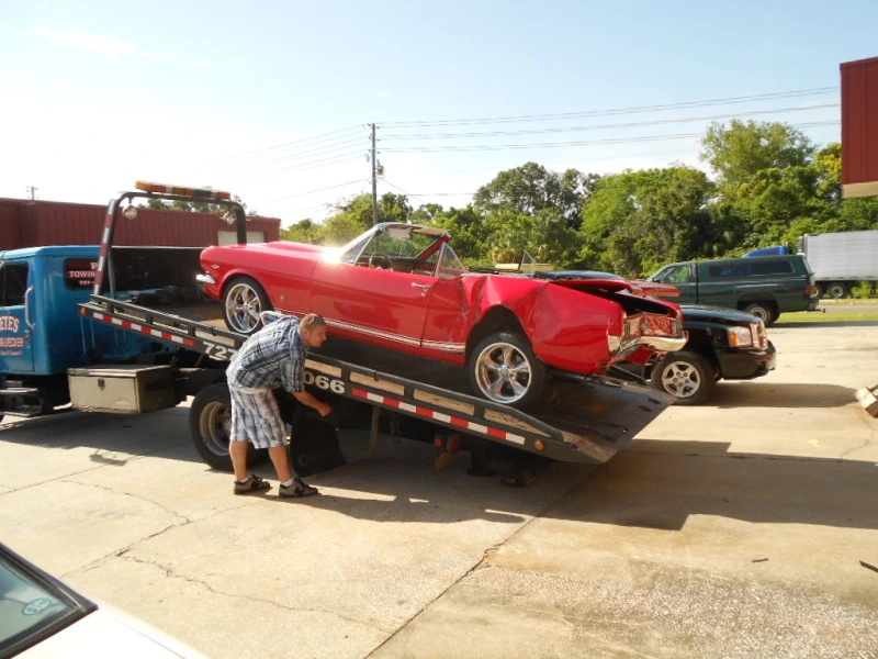

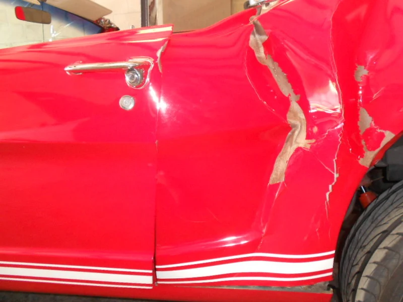

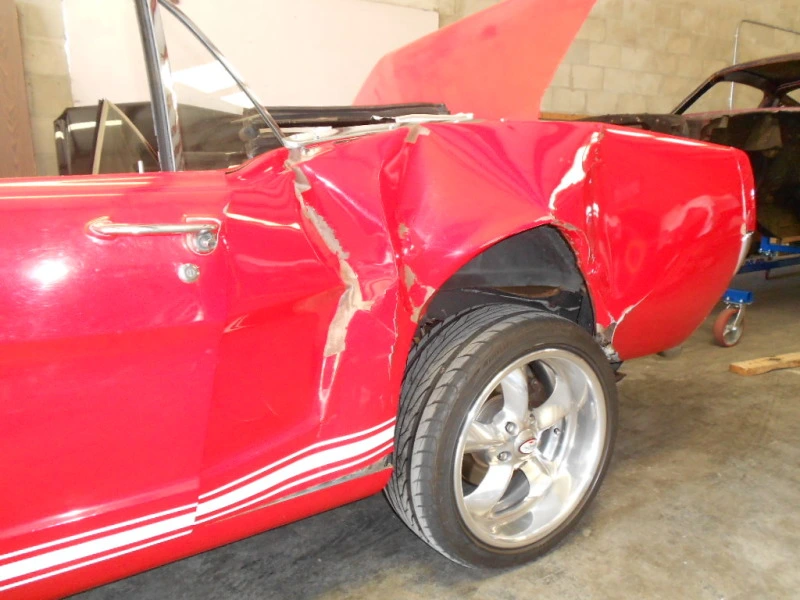

This project came in the other day for us to repair.
oh ouch, did one for a ford rep. in san louis with almost the same dammage
was not fun the rockers were bent in the middle ,frame straightener just barely straightend them had to replace from the rear of the doors back, that was the easy part . but i think you guys can handle it

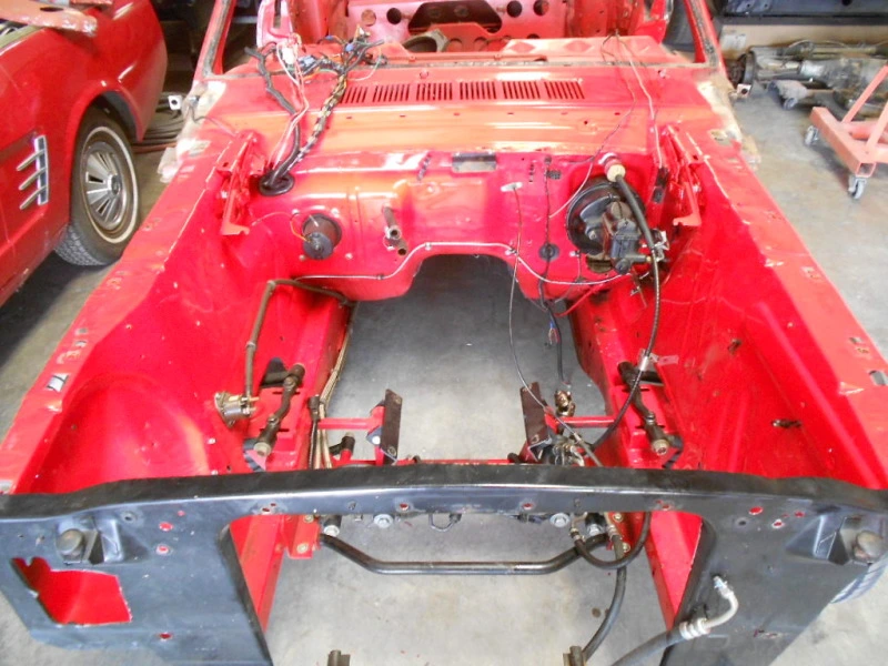

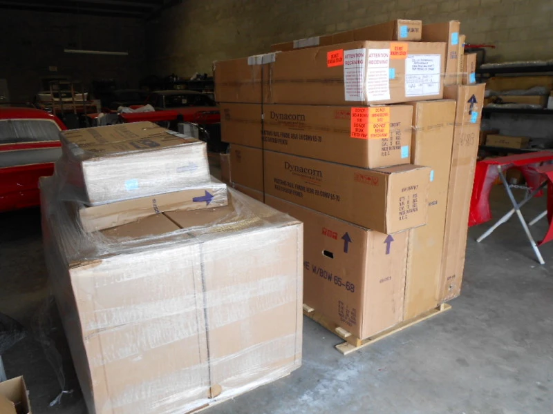

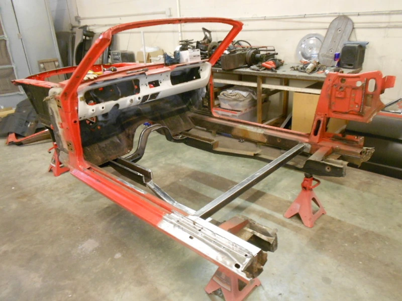

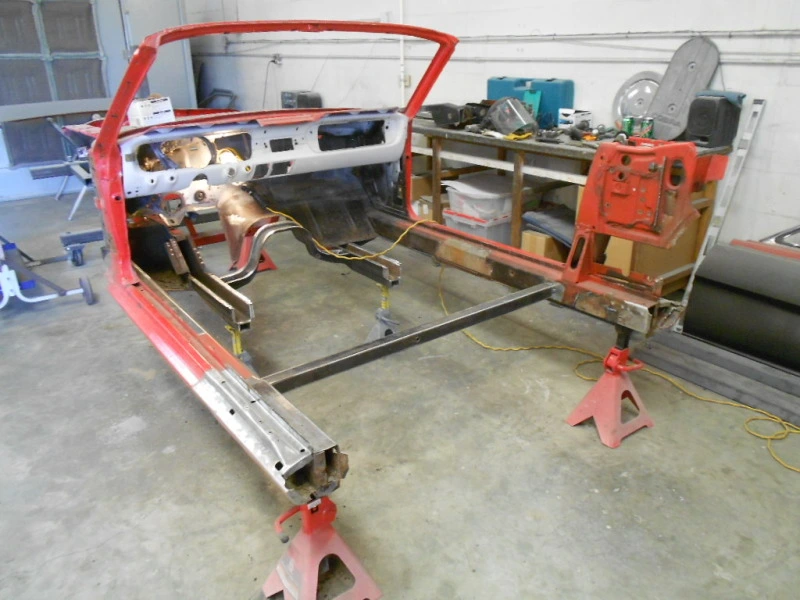

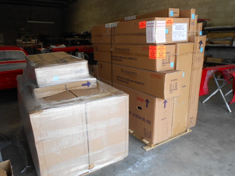

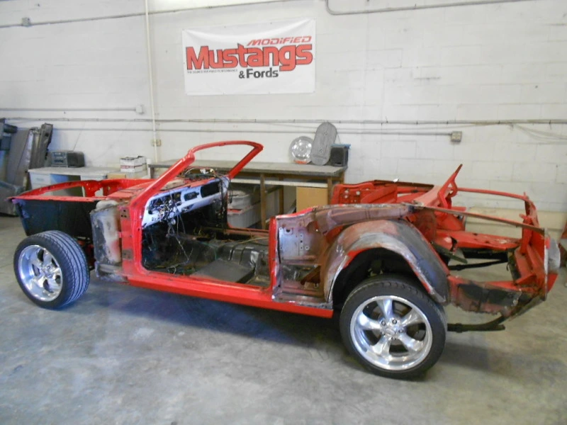

We have not had a lot of time to work on this because of other projects. The parts came in.

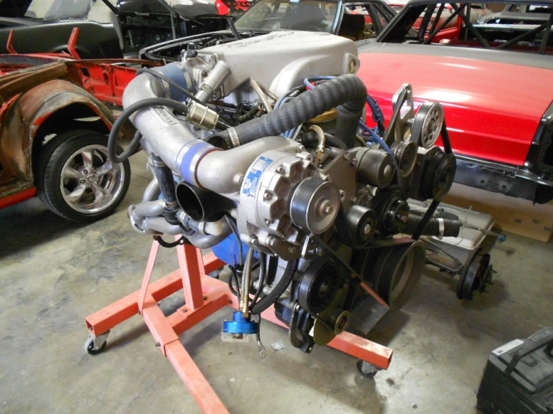

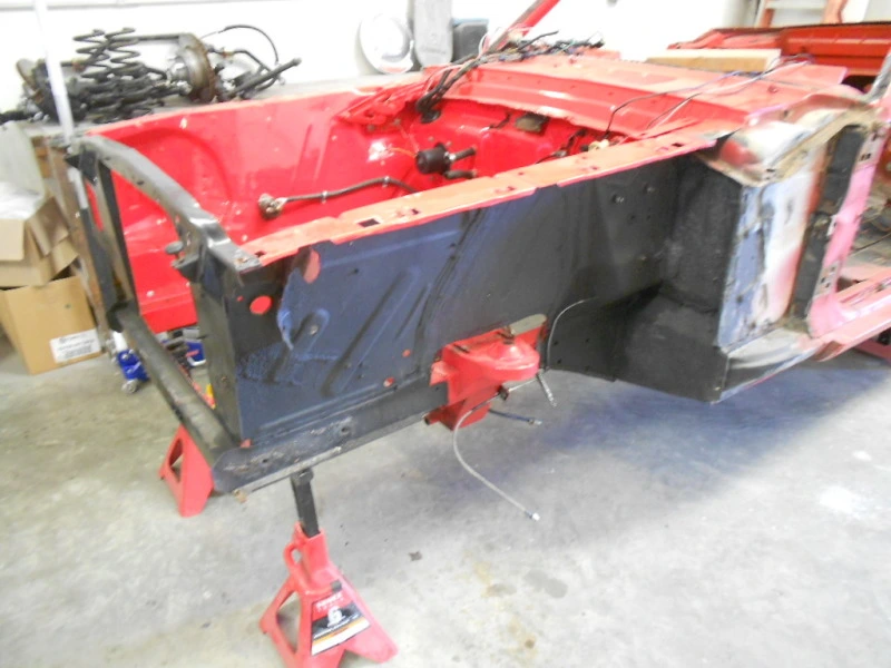

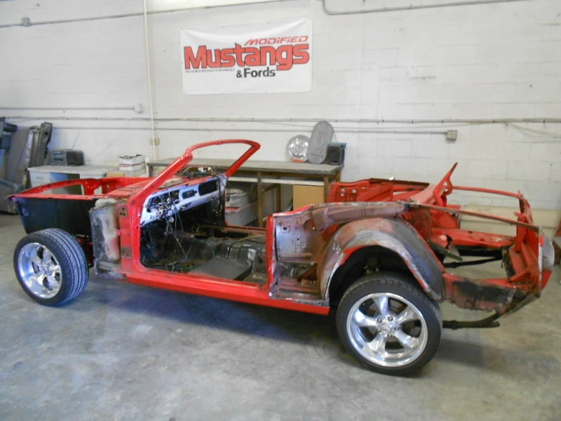

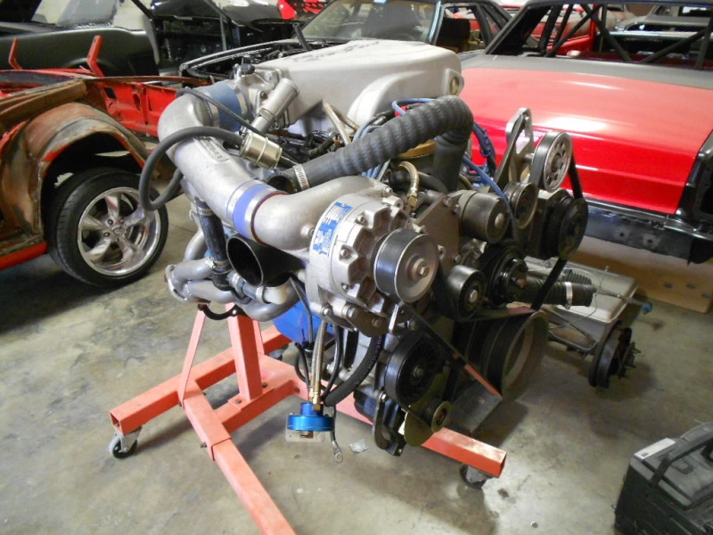

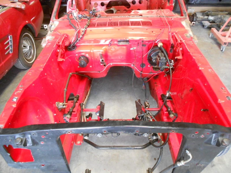

The engine was removed

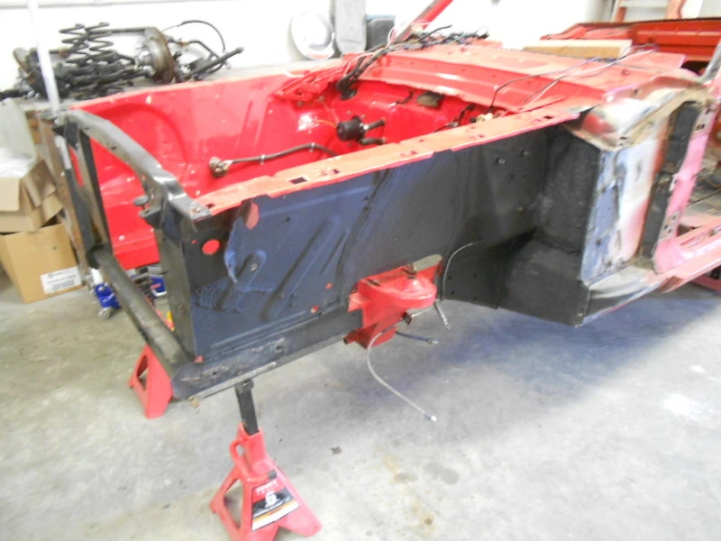

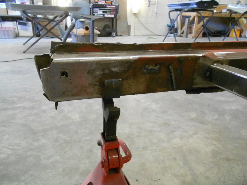

We moved it to the shop and started removing the suspension

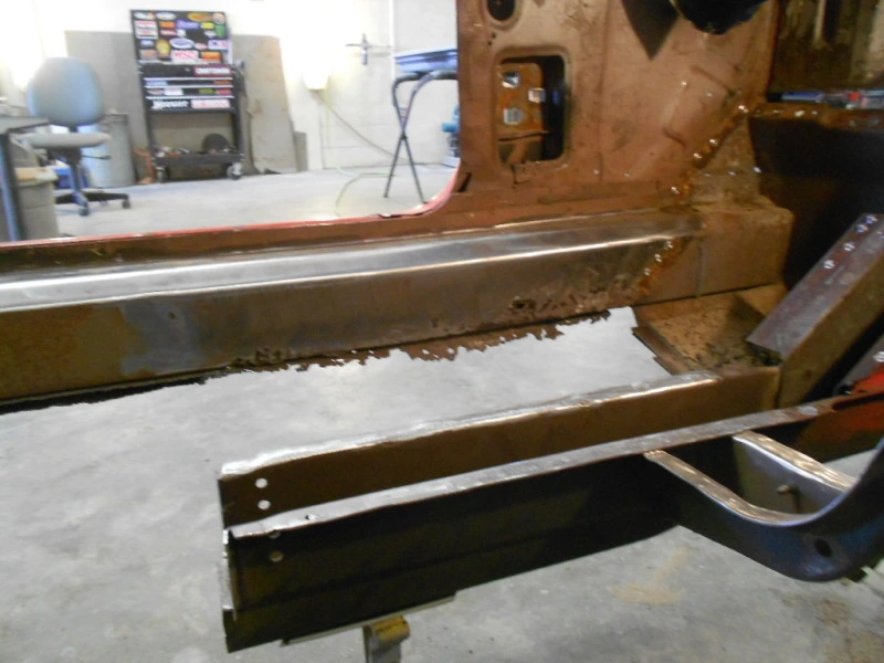

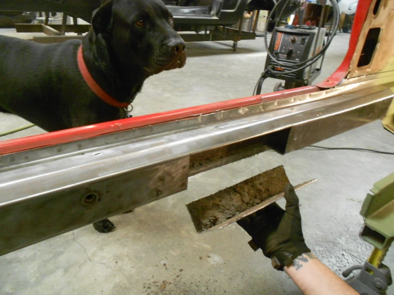

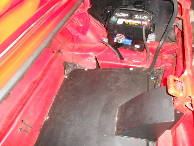

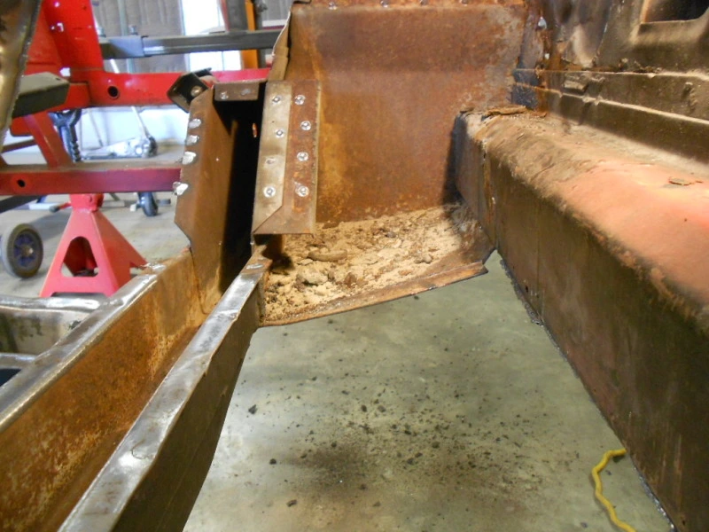

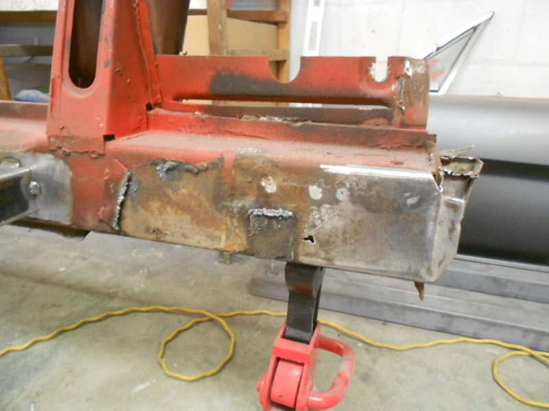

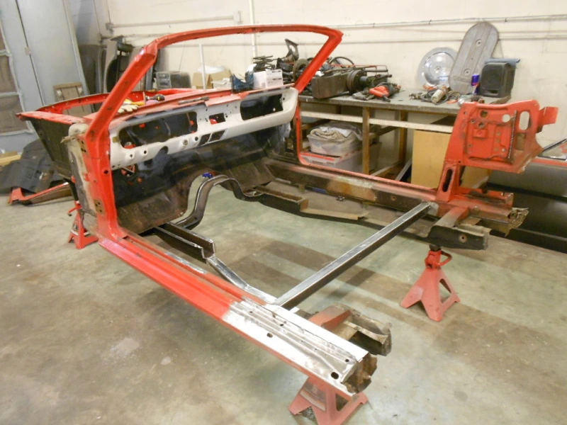

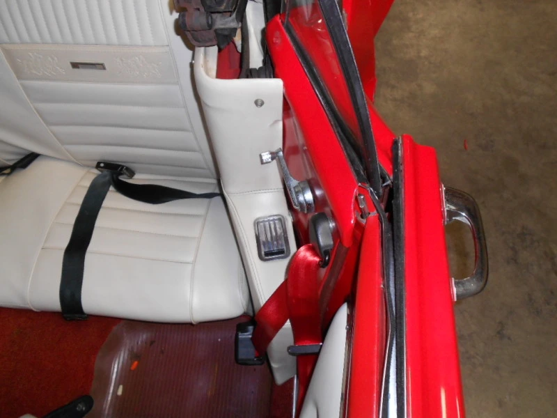

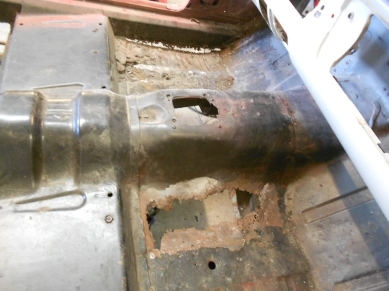

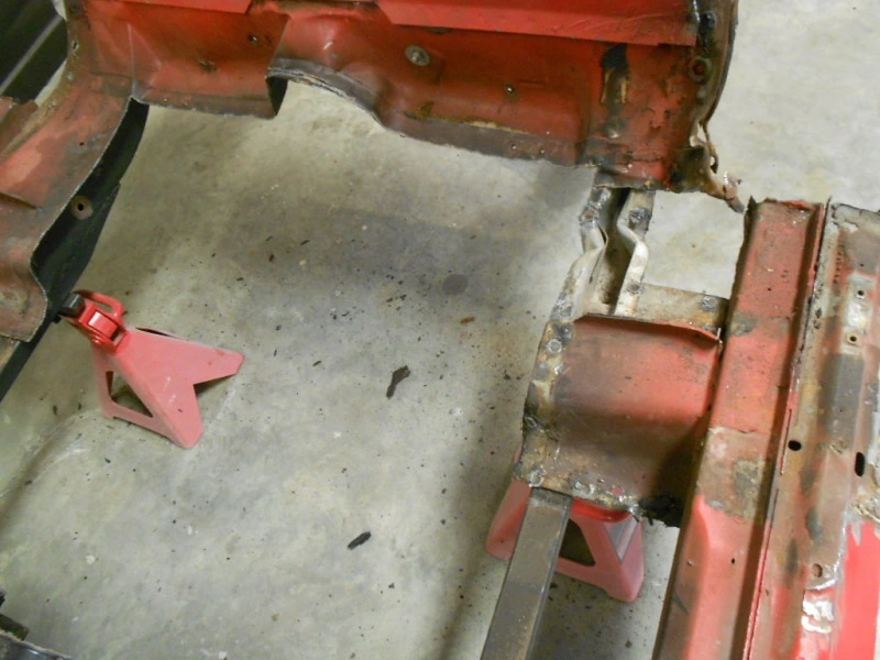

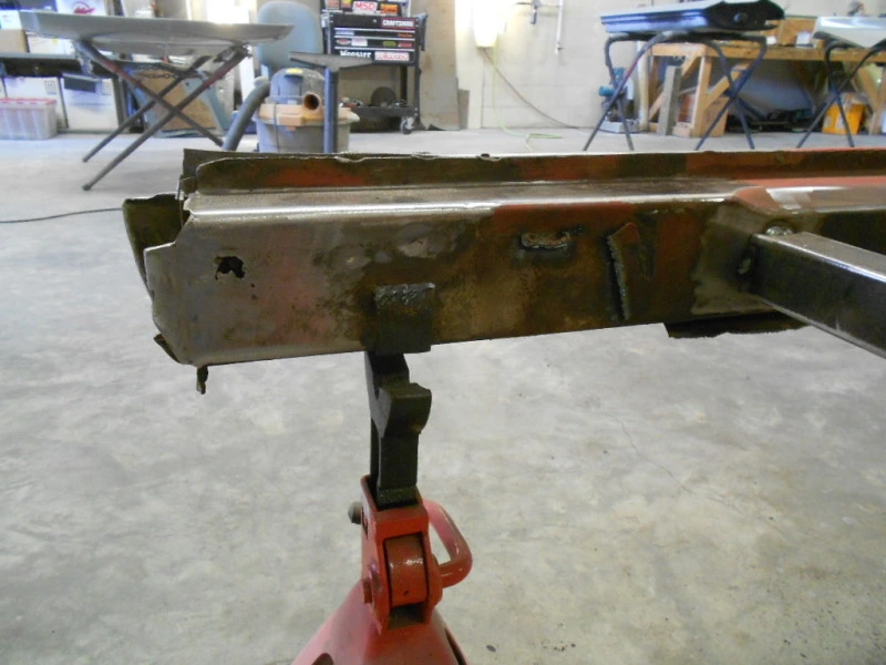

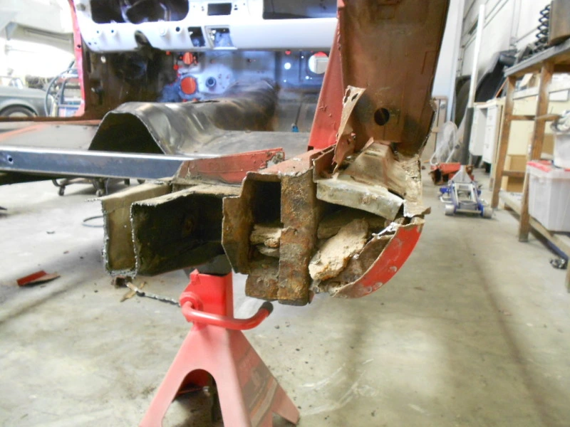

Because the subframe connectors were welded to the rear torque box the frame rail and rear floorboard was damaged but it stopped here.

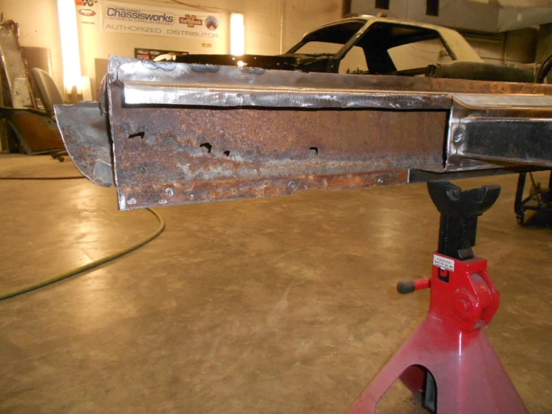

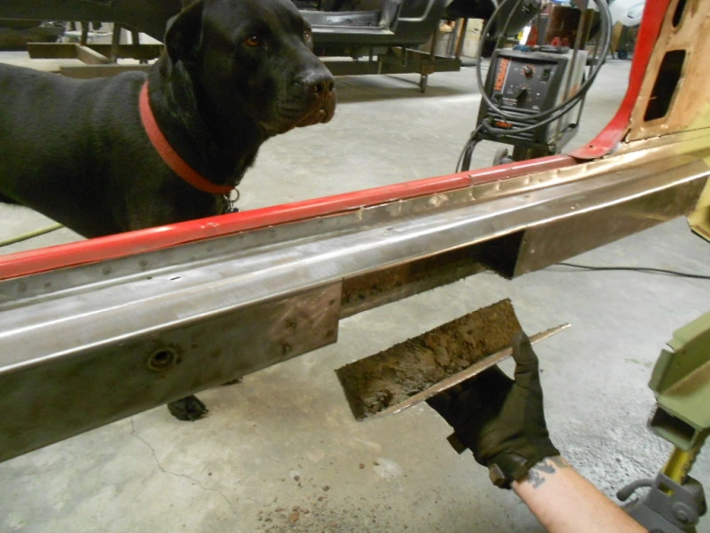

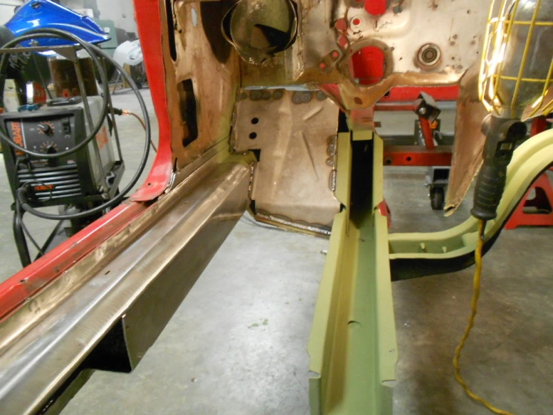

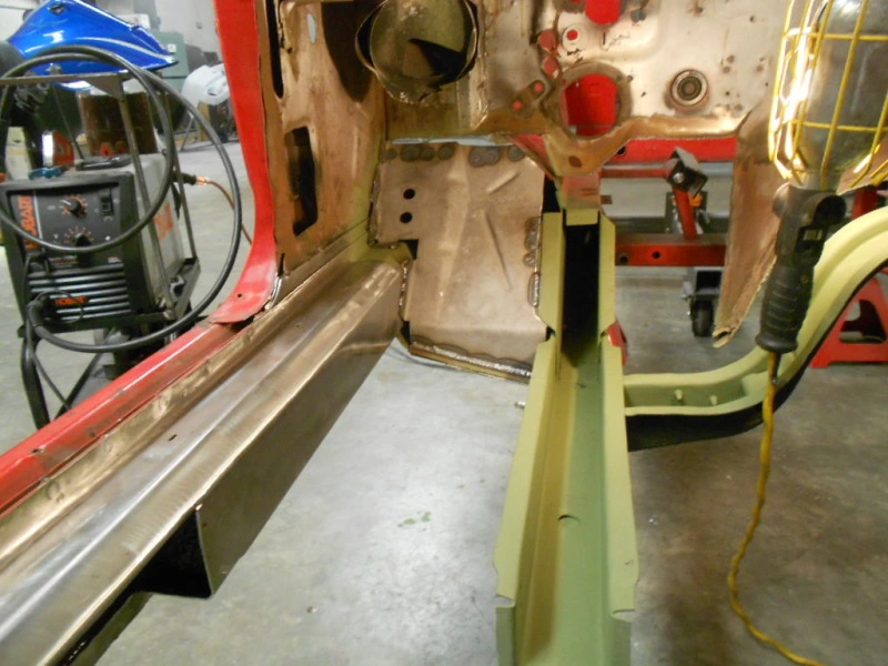

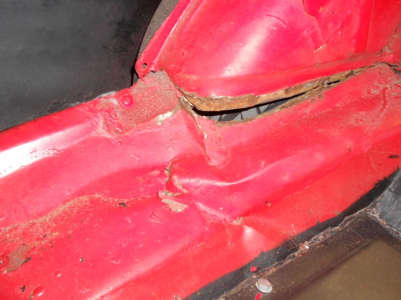

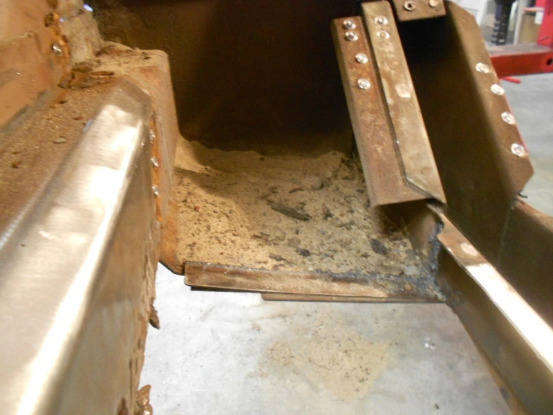

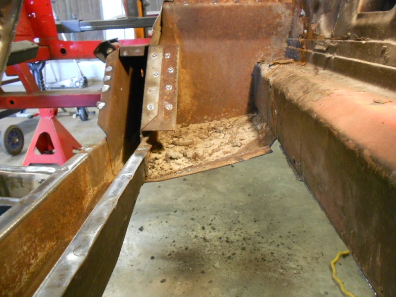

You never know what is inside your rocker panels

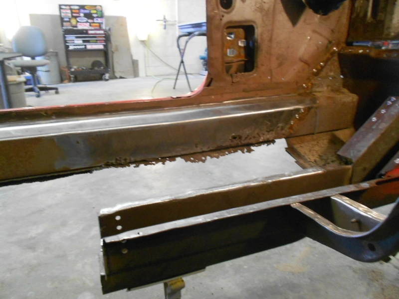

The floors had been patched with fiberglass a long time ago.

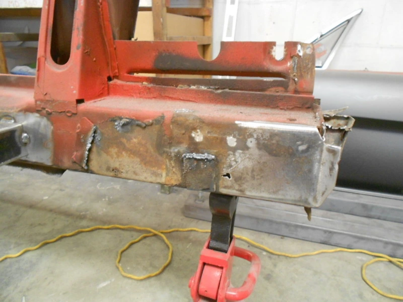

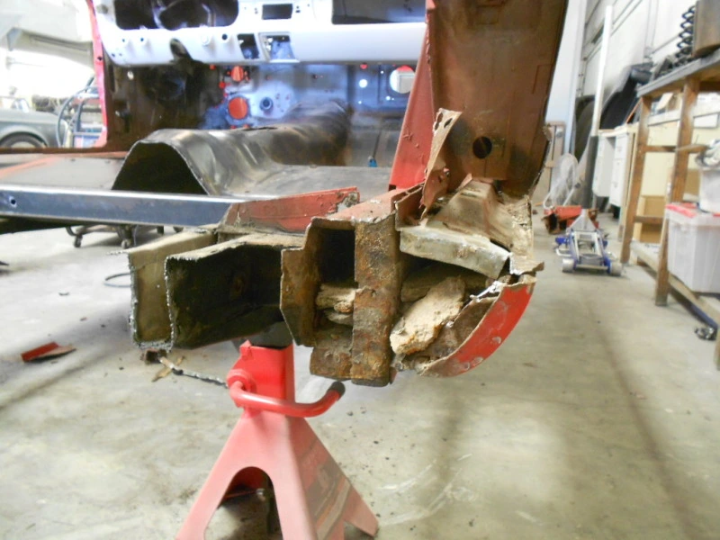

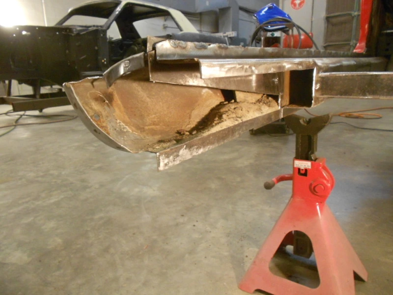

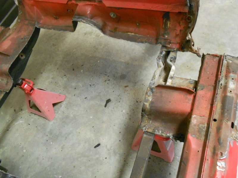

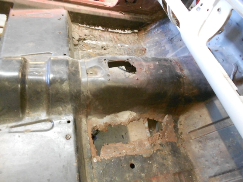

The toe boards had to come off and also the top of the torque box because of rust.

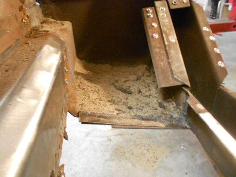

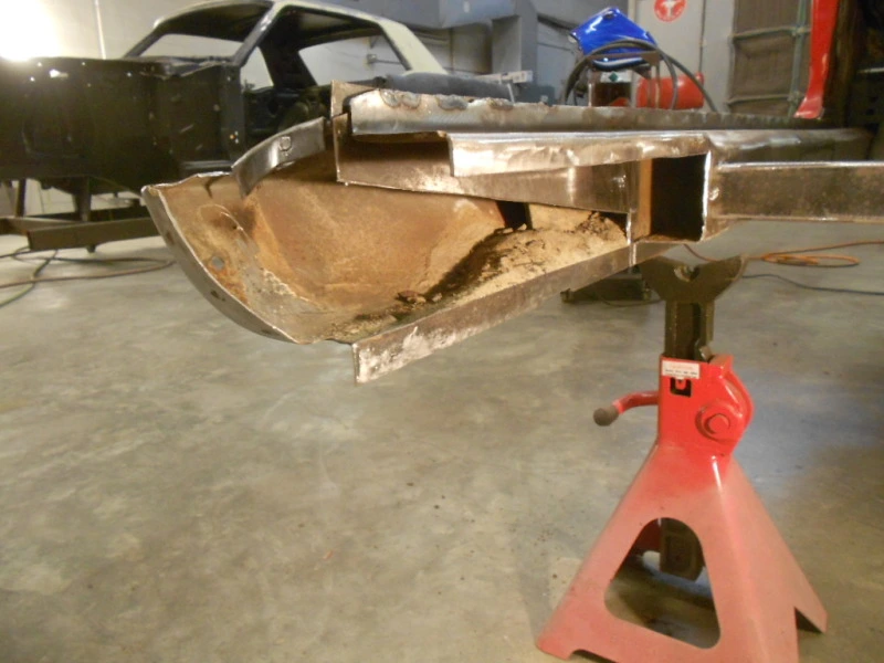

This is what was inside the torque box
The first patch

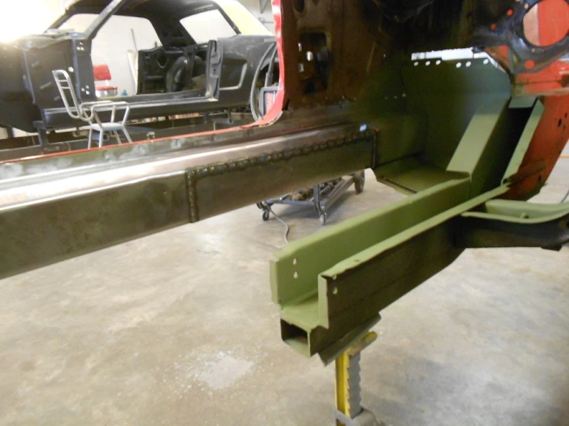

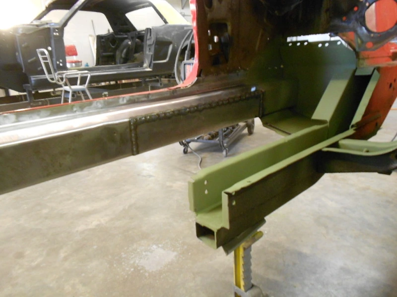

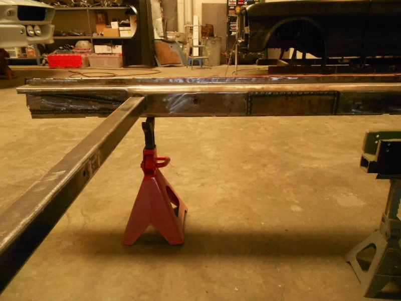

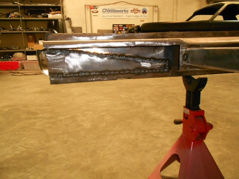

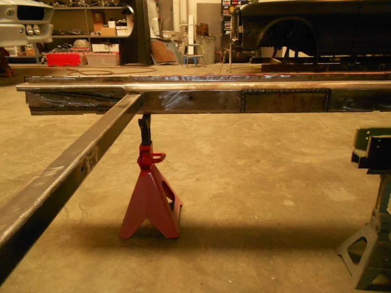

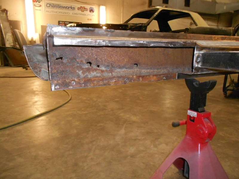

More sand and rust

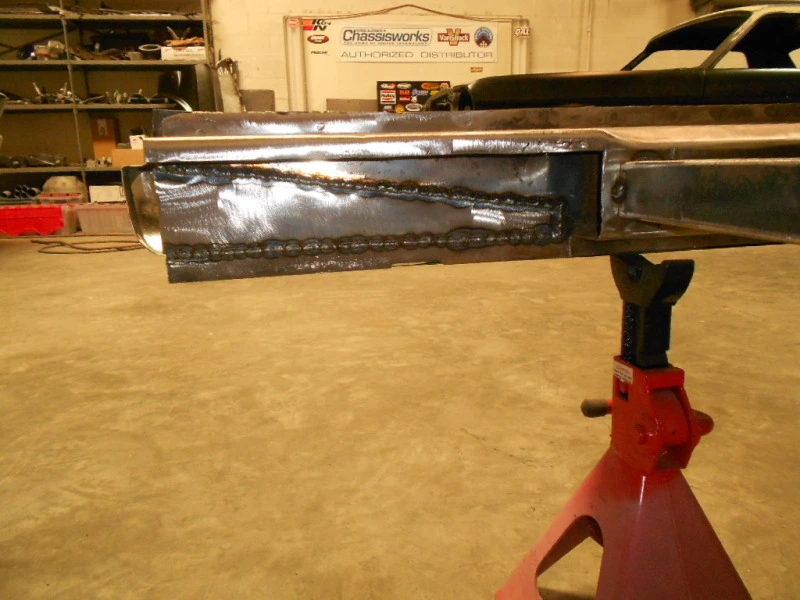

Brian has the top of the torque box welded back together after epoxy priming the back side.
