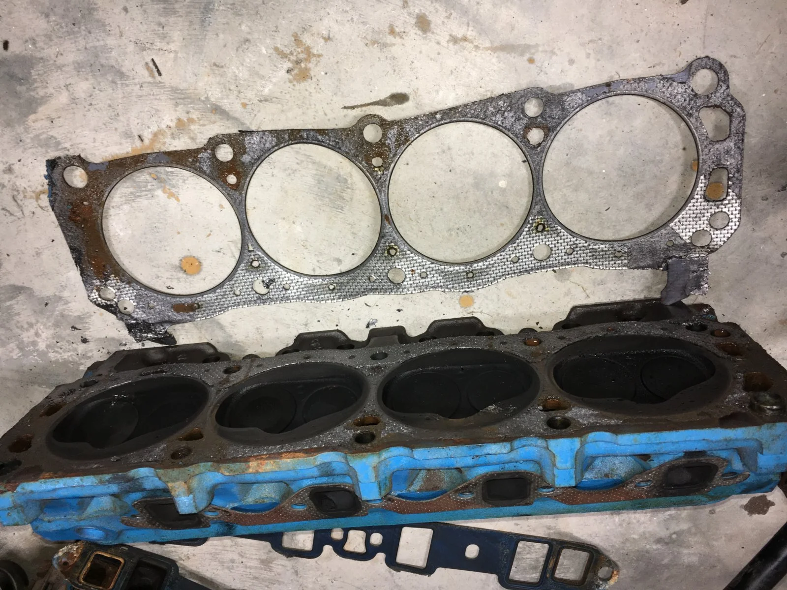

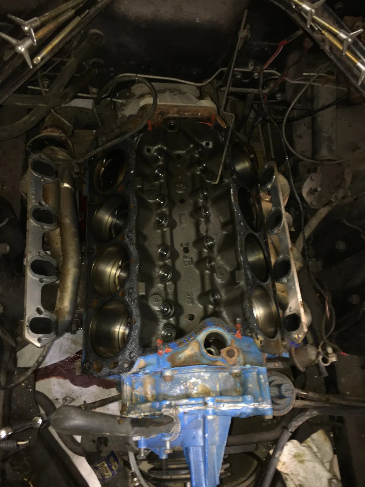

Well I finally got the engine to rotate only after I removed both heads. With the driver side head it still wouldn’t rotate two full turns. After I removed the passenger side head it rotated. Their were no signs of any issues such as blown head gasket etc. it’s a mystery to me. I noticed with the driver head off three lifters, two on passenger side and one on driver side wouldn’t move. I thought stuck lifter but once passenger head was removed it rotated. Wierd. Now time to reassemble.

I'd say there was a very good chance your valves were in contact with your pistons if the pushrods were still installed on the passenger side. No way I'd re-assemble without pulling that timing cover and checking the condition of the timing chain and gears and making sure it hasn't slipped.

All pushrods were removed. I plan on removing cam just to check it since I’m this far in. The engine was rebuilt about 15 years ago and only ran a couple hours since then. It hasn’t been driven on street in 20 years. The owner said he couldn’t get it to run right and move the plug wires, advanced dizzy. It’s in good hands now however.
If I understand what you have written it seems to me that the camshaft was interfering with the stuck lifter and that's why the engine wouldn't rotate more than 1 full revolution.
when you turn it now, does every lifter go up and down for 2 complete revolutions? the only thing that turns half as fast as the crank is the can, lifters, pushrods and valves. has to be there, there is no magical force field. I'm assuming there was no fluid on top of a piston when you pulled the second head?
