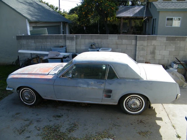

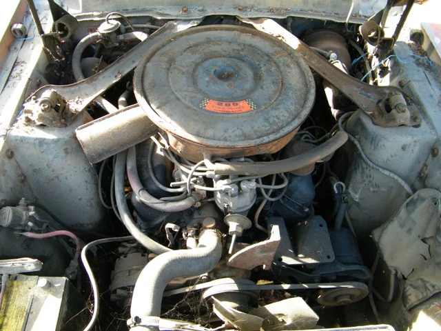

Ok, we are pulling the 289/4v (A-code) and tranny out so I can prep the engine bay and rebuild the suspension and brakes, while I make a decision on the tranny, AOD or rebuild the C4, Please advise.
The motor runs good, it was rebuilt approx 20 years ago (sat for last 15yrs or so) and probably has no more than 30k on the motor since the rebuild. I'm going to put it on a stand and replace the gaskets, seals and do some part upgrades, here is a list of what i plan to replace and any recomendations of brands and whatever I missed is appreciated. BTW I want to add a little kick (HP) to that 289 with some bolt on upgrades.

I would upgrade to some mild aftermarket heads. Factory 289 heads are garbage, and that will really waker the motor up with the headers and new intake. I would also consider an upgraded cam. You can do a lot better than factory, even with an RV grind.
