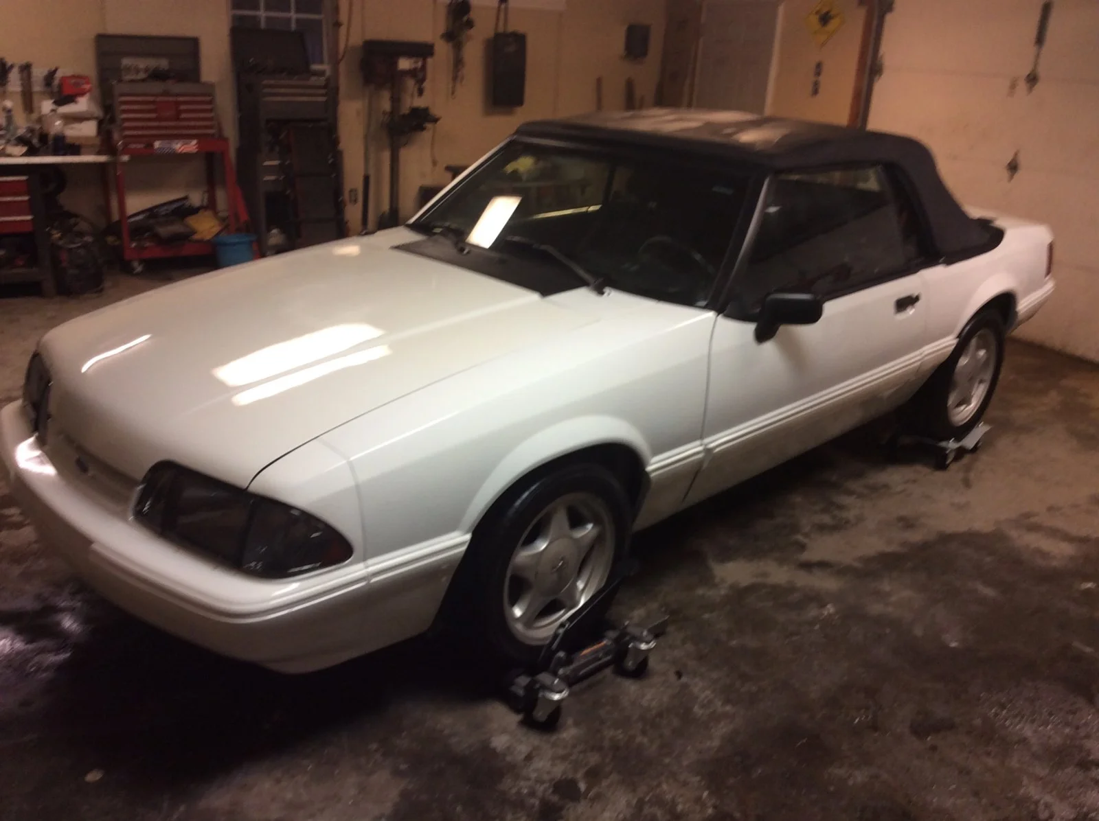

Starting a prodject need advise
I have a 93 5.0 convertible bone stock
I painted the car added a double din stereo, fixed all window motors and door locks.
The car ran but rear main seal leaked and the rack was leaking other than that the car was ok.
The car has been sitting for two years while I finished a 442 prodject.
Plans are to dive in and , replace rebuild engine ( need advise on the best route to go this will be a driver but I want some power, maybe turbo / super charged, but will still need working AC.
Replace steering rack ( need advise on parts )
Change to 5 speed ( need advise on parts and weather to go cable or hydro clutch )
5 lug and rear disk conversion ( need advise on parts )
Suspension / needs to be rebuilt and car needs to be lowered ( need advise on parts maybe coil overs )
Also for anyone who has successfully tackled a similar project with success any advise would be appreciated especially when it comes to any useful upgrades I didn’t mention above or a efficienct order to tackle the work.

About the rack, they make 3 different ones that will fit. The difference is the number of steering wheel turns from lock to lock. The quickest ratio rack is listed at 2.25 turns. Get that one. The others are 2.5 and 3. The 2.25 one will be the sporty feeling one while driving.
When lowering be very careful not to go too low. So many people do, and while they may like the look, the ride turns to total crap and it rubs and bottoms out everywhere. It can make an otherwise nice car not enjoyable.
I rescued a 93 convertible. It had been lowered and it rode like total garbage. I put the stock springs back in and now it rides great. I like it more every time I drive it.
My 92 LX has stock rear springs but I have a rear mount battery, a pretty heavy sub woofer box and a tool kit back there. I don't mind the extra weight as it gives me more traction that I need. I bet the weight I have back there lowers the rear maybe an inch. In the front I have about the mildest lowering springs you can get. 1.25 inch with the isolaters I think they are. It gives the car a slight forward rake that I prefer for looks. I get tons of compliments and nobody ever says I need to lower it. I have Strange adjustable drag struts on the front set at the softest setting. There's a slight amount of float at bumps during highway speeds but otherwise at lower speeds it handles bumps way smoother and quieter than the stock struts did. I retain the stock sway bars front and rear and even with the softer front struts, cornering is still spot on.
Does the current engine have any serious issues like burning oil or knocking?
If not, I see no reason to rebuild it. Fix the main seal and power steering leaks.
Forget the turbo, just read up a little and you will find all the jack stands jokes.
I'd probably forgo the SC too.
It's a vert, first thing to do would be sure up the chassis and suspension, especially if the car isn't beat. Extra power turns a vert into a rattle trap.
There are a lot of things that should be taken into considering before adding power to any fox, that goes double for convertibles.
Brakes and suspension should be done first.
You add a bunch of power to a car with mediocre brakes and poor suspension it's a recipe for trouble.
Then i'd do a heads cam intake setup.
If that doesn't cut it, add an SC later.

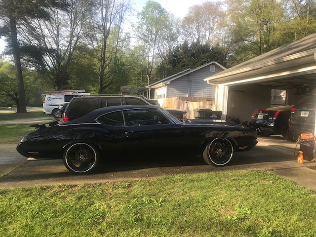

BTW, 442's are badass! Lets see a pic of that!

I used QA1 coil overs and control arms on my last build ( 72 442 ) and I am happy.
