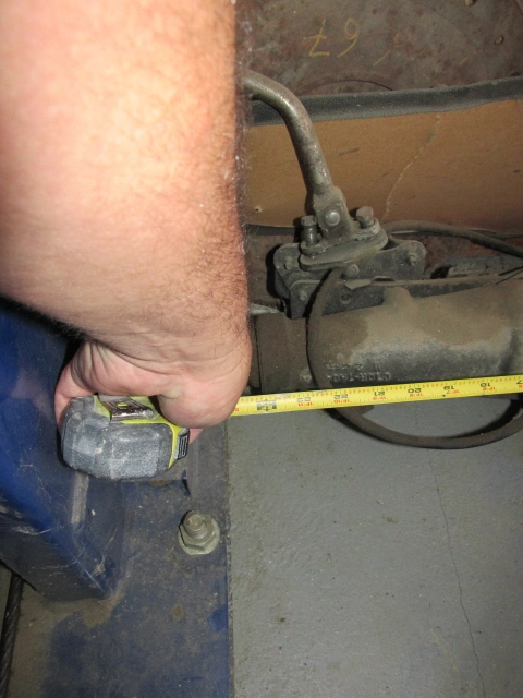

There is another possibility ,it could be a Torino 4 speed ,they are longer than a mustang 4 speed . Can you get a length measurement from the front mounting flange to the end of the tail housing of your 4 speed ?

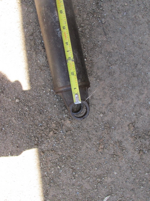

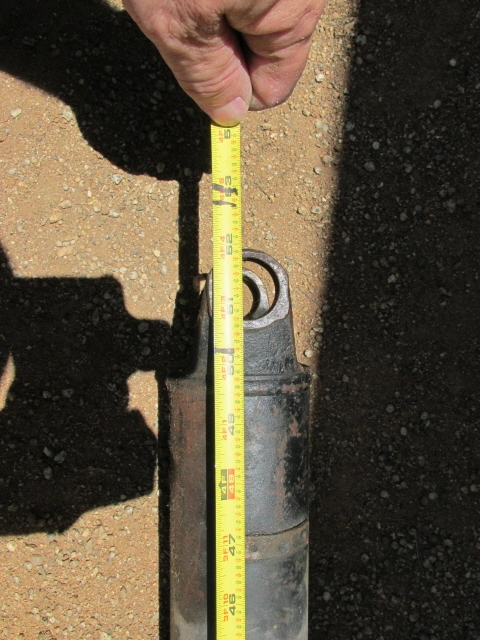

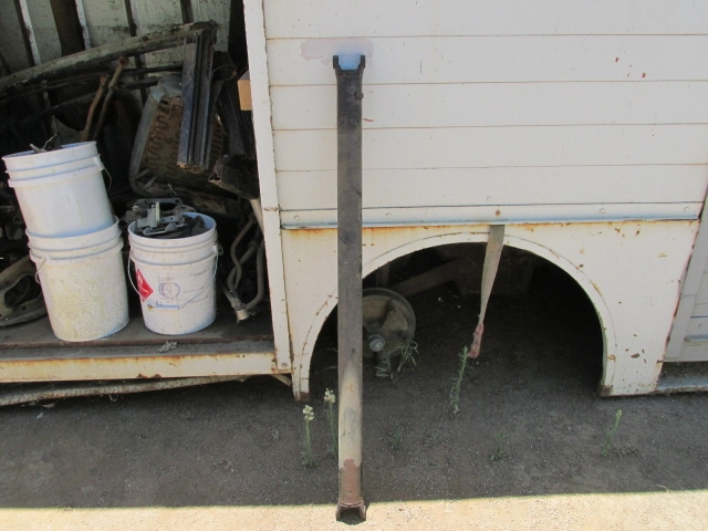

Well the pics didn't turn out real great but ,this is a 67 early drive shaft .It is the one piece shaft and has the same size joints on both ends .it measures 50 3/4 inside of cap opening to inside of opposite cap opening , it does not have a step down .

The measurements on the 4 speed is 24 inches from the front of the mounting flange to the end of the tail housing ,not the shaft .
