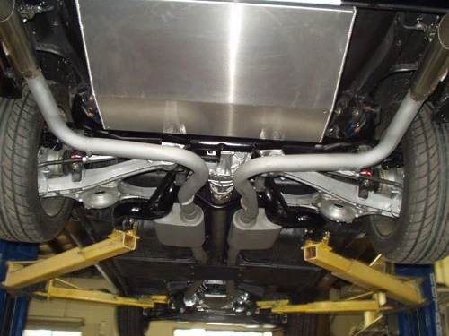

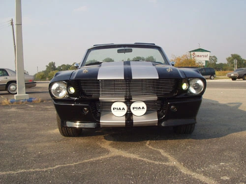

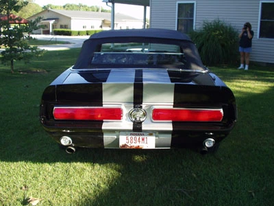

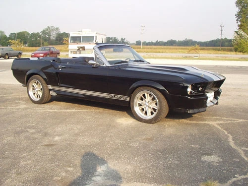

Hello all, I was checking out the forums and saw all the projects. I thought I would show off the one I just finished. 1967 Vert with the Maier Eleanor kit installed. 01 Cobra IRS, Heidt's Mustang II frt suspension W/ power Rack & pinion, IDIDIT tilt steering column, Coil over shocks, Griffin aluminum Radiator, Dual Cooling fans, Ford 1 wire alt, Rear mounted power antenna, 4 wheel cobra brakes, 22 gallon fuel safe fuel tank, Aluminum driveshaft. This car was ordered and pre sold so it didn't get all the little Eleanor things, (go baby go button & NOS). No roll bar, I didn't want to cut thru both inner & outer rocker panels so it has grilles instead of exhaust outlets in the side. Turned out really nice and drives even nicer. Customer didn't want a drag car so it got a small block with the stock C4 trans. Just enough power to keep the chevys at bay. With the Heidt's front suspension he can always go with more power later. Just thought you guys might like to see her before she goes. I'm delivering her on the 27th of the month to New Jersey. I'm also showing her at the James Dean Festival's Duck Tail Run in Gas city IND. this weekend. if anyone wants to see her in person, I'll be there with her and my other 67 Fastback. or if anyone wants one built let me know I can build one with any engine, any trans, any axle, or any color, takes me about 6 months to build one. Complete Rotesserie restoration. I do all of the parts,sheetmetal fab, body work, paint, engine, interior, top, The only time it leaves my shop is when it gets Media blasted. Check out my web site at WWW.Mustangmaker.com

Pretty neat. Tell the new owner that next time I am down in that area that I want to take a look. Undercarriage of the car looks amazing.

If you decide to install one one these. You only need to know how to mig weld & measure. The install was much easier then installing a Rear quarter panel or floor pans. To answer question, You don't need a Rotessie. Jack stands will do. If you have a 1968 you won't have to change steering column. Overall, Very easy. But you will need to weld good. If you can't weld I would hire someone else to do it. (Body Shop). Heidt's sends very nice installation manual with the kit. Good luck!!! If you need help let me know I would be glad to walk you thru it.
Also, I just got back from NJ. New owner test drove the car like he stole it. I was very impressed myself with the handling(from the passenger seat). He loves the car and was very impressed with the way it drove & how tight it felt.
Nice work, looks good. :nice: Probably the only thing I would have done differently (aside from also preffering original Shelby glass over Eleanor) is either leave the rockers stock or modified w/o the exhaust holes or have hidden the real exhaust out back with turn downs. I respect the reason you did not make them functional 100%, I just hate seeing fake anything on a car, especially one that is detailed so nice anywhere else. Granted side scoops are usually fake but the average Joe would have to tear it apart first to prove they were not in fact cooling the brakes. Anyone however can see that no exhaust is coming out where it appears it should.
I agree, on the exhaust. I was under a deadline, which I was behind on 60 days. Customer wanted it to be as Identical as Unique motor's vert as I could make it. He wanted black & silver, I already had the IRS & IFS mocked up for a Cobra build. Next vert won't have false exhaust vents. They will be deleted all together. Along with the Air Vents between wipers. Fuel fill will be in the side with a recessed door. Like new cars. Several things will be different. Thanks for the Thought, Always like hearing from Mustang guys.
