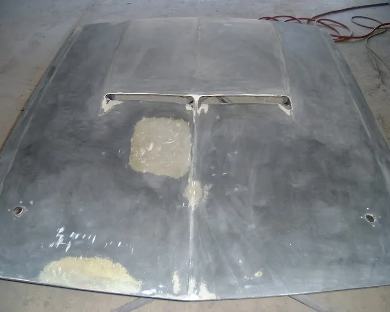

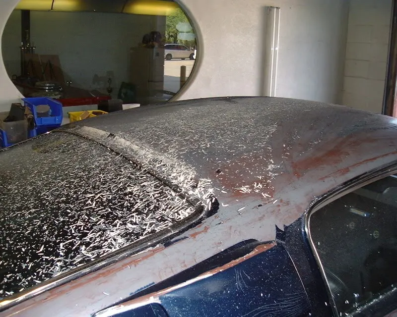

I used a razor blade to strip off the blue paint which is not the original color.
I did it that way on an early bronco, that truck had 5 colors stacked up and the paint literally exploded off the body.
Please keep posting the rest of the steps and tell us what materials you are going to use!
My 67's paint come off the exact same way...my and my brother in law had most of the paint peeled off of that car in a couple of hours with a razor blade, the paint was as thick as peanut brittle. I used a pressure washer and would blow huge chunks the size of maple leaves off of it, it was fun, lol.

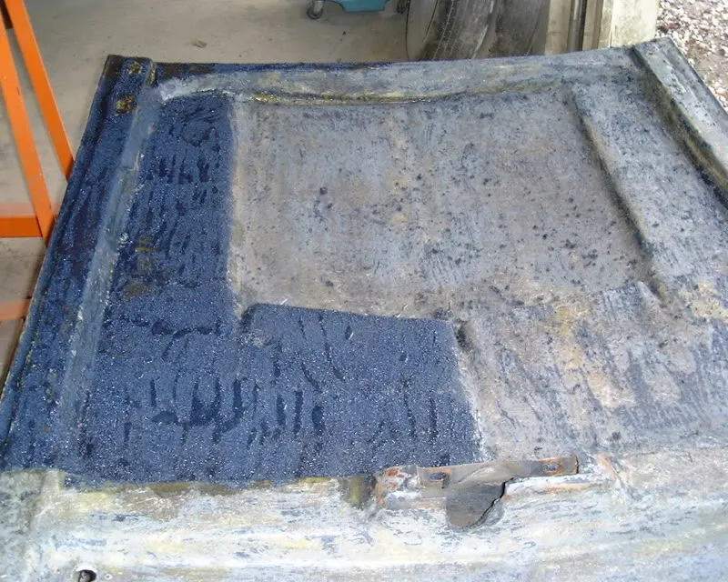

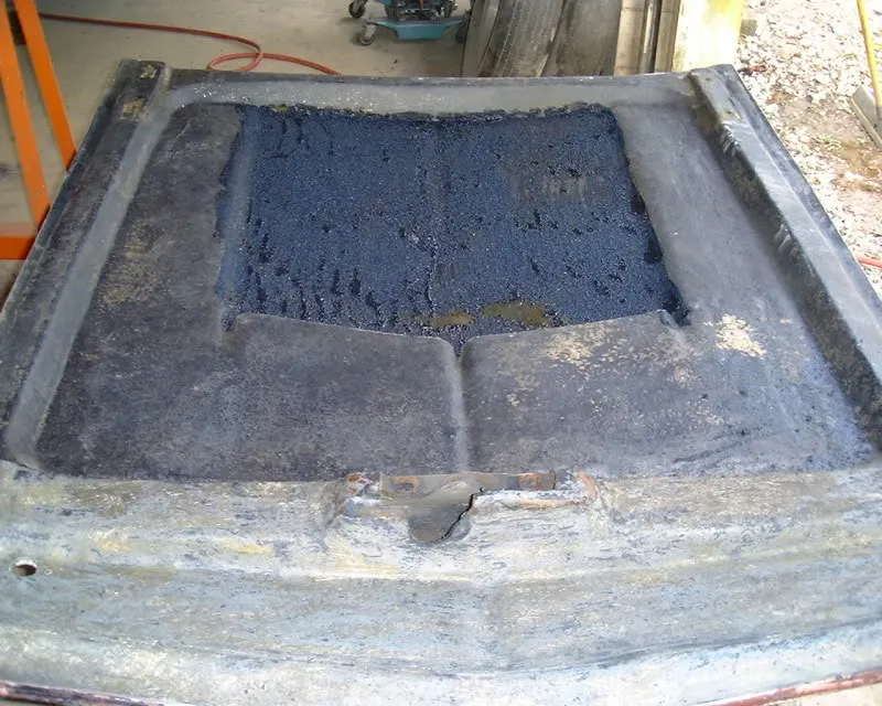

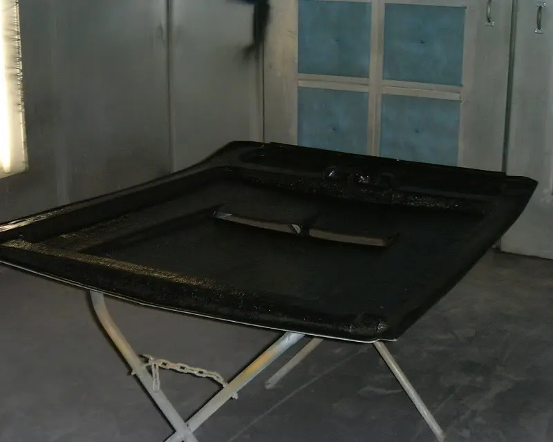

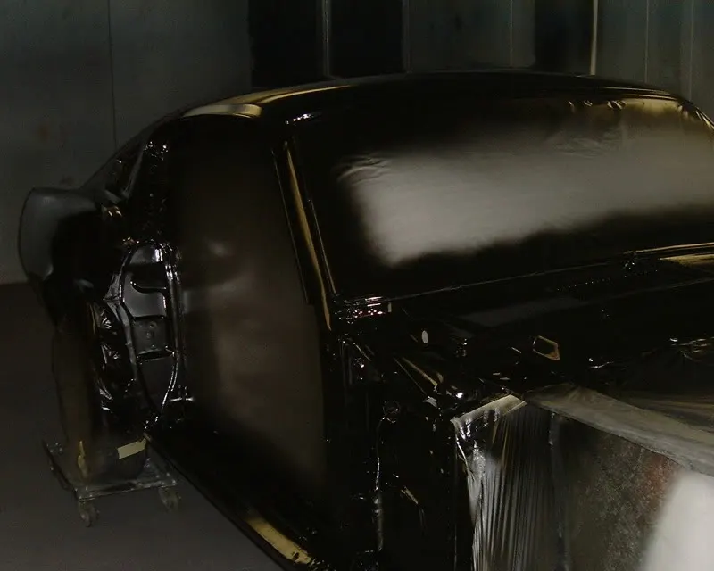

The back side of this Shelby hood is supposed to be black and has a rough finish. When it was painted years ago they painted it blue. I used stripper for fiberglass stripping small areas at a time with a small wire brush.

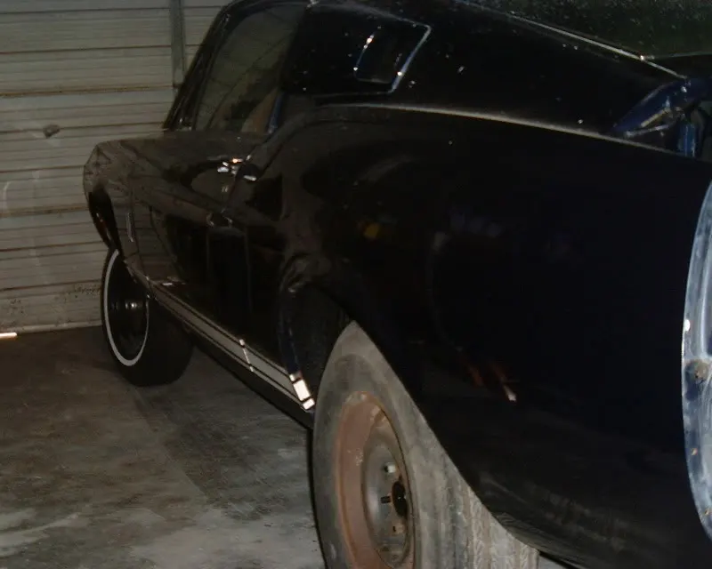

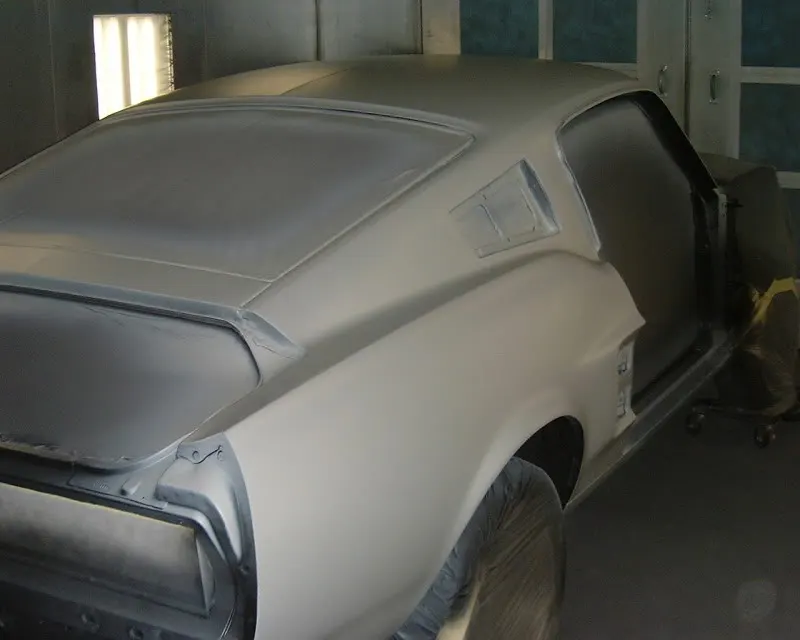

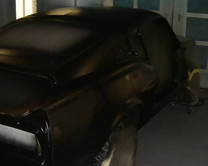

After I was finished I washed it a few times and let it sit in the sun. After a few days I epoxy primed.

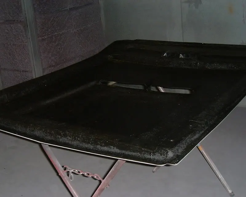

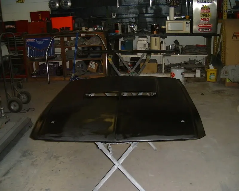

The surface was very rough after the wire brush so I used a red scuff pad to smooth it out and applied 2 more coats of SPI black epoxy.

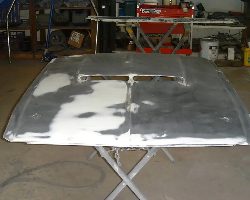

Very nice work! I have a question: are you sure that's an original hood? I thought the originals had a slight indentation in the rear bracing to allow the oval air cleaner to clear. Mine is a repro and I had to cut the bracing and add the indentation on mine, but the only real '67 I've ever seen had it from the factory.

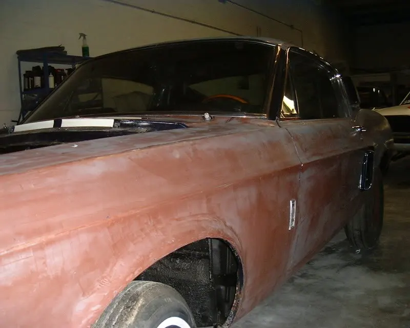

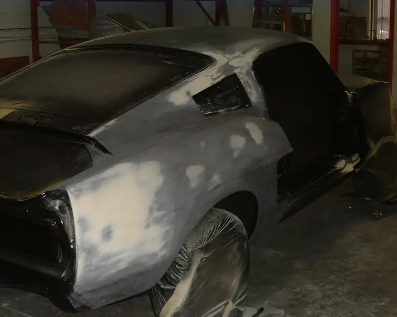

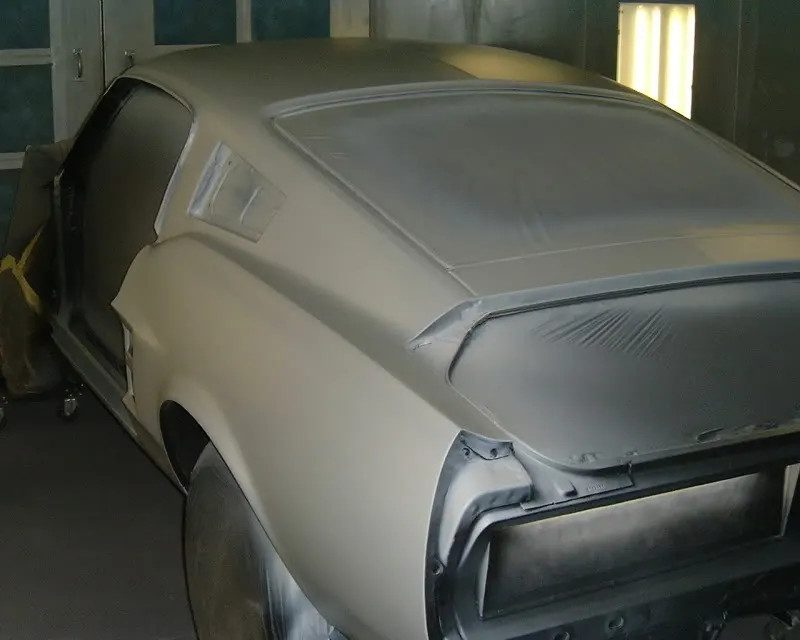

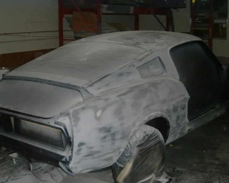

There is only two of us. I have done all the body work and priming my son Brian taped and bagged it which took a long time to keep overspray off the undercarriage. I have worked on this for awhile off and on between other projects. This week started taping the body and doing the bodywork and priming.
