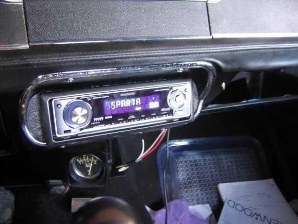

Yeah, its pretty easy to retrofit a modern (single DIN) stereo in the 67-68 radio bezel, you just need a dremel and a cutting disc .
About a month ago I installed mine, I just needed to trim slightly the bottom of the stereo rectangular trim, here is a pic:
