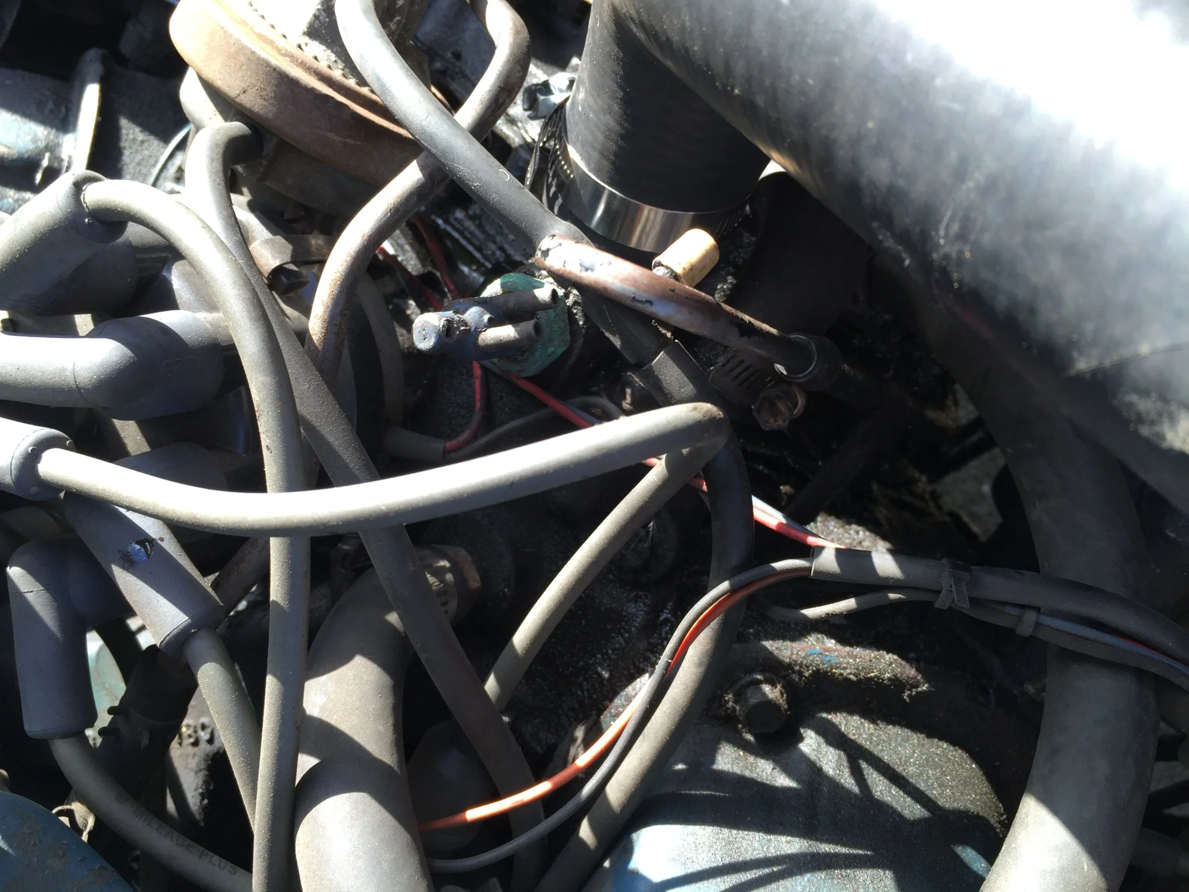

But hey I just bought a 68 cougar from a guy. Runs and starts perfect but it over heats. I feel pressure building in the top hose so I thought thermostat. Changed that and the hose and I am still experiencing the problem. What are some other things I can check? I guess it could be a faulty thermostat, but anything else I can try? Also there is like a vacuum tree coming out of the thermostat housing that looks damaged and is not hooked to anything. Could that be the issue? Does anyone know what it is supposed to hook to? Ill post a pic shortly.

Here is the pic of the vacuum tree on the thermostat housing.

As for the vacuum: That fitting in the picture is a temperature sending unit, that probably switches something on/off in the vacuum system based on engine temperature. It does not have any vacuum attached to it. Whatever that vacuum tree attached to *may* be making the engine run hot, but I'm doubtful about that if the aren't open vacuum lines.

You prolly shouldn't worry about the vacuum tree, then.
