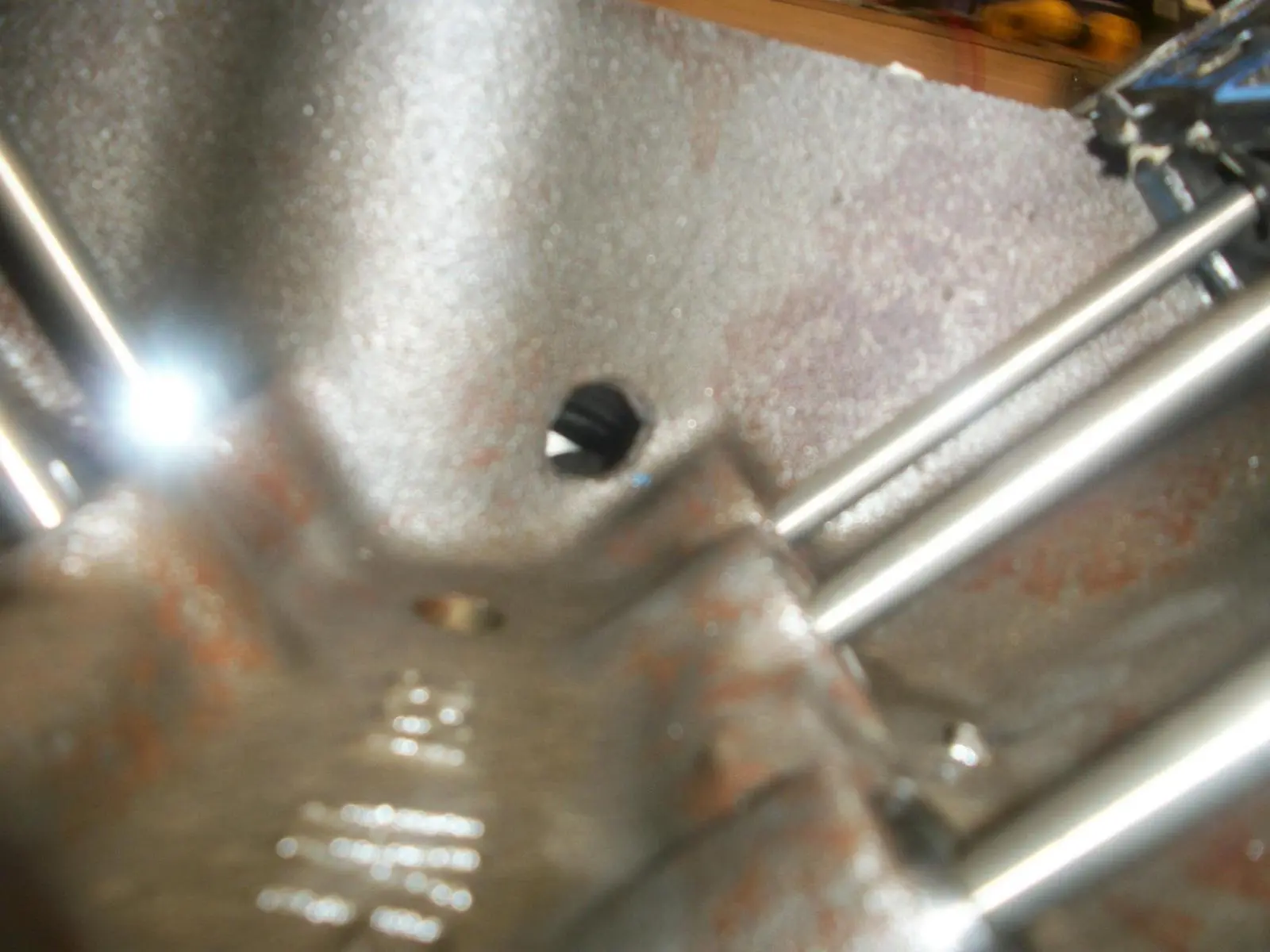

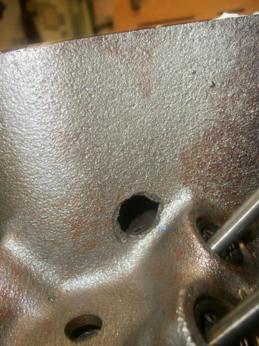

S scrrewchamp New Member Oct 12, 2010 11 0 0 laurel md Nov 5, 2010 #1 Nov 5, 2010 #1 I removed my intake manafold and on the inside of the block behind the distribtor there is a hole in the block should this hole be there ? Attachments dev -kling kids 013.webp 61 KB · Views: 177 dev -kling kids 012.webp 168.3 KB · Views: 177
BuckeyeDemon Member Apr 13, 2010 130 9 19 Cincinnati, OH Nov 5, 2010 #2 Nov 5, 2010 #2 yes. looks pretty crude doesn't it.
S scrrewchamp New Member Oct 12, 2010 11 0 0 laurel md Nov 6, 2010 #4 Nov 6, 2010 #4 ok thanks for the info ,you are talking about the hole not the stang .
H htwheelz67 Member May 18, 2007 444 0 16 mission viejo ca. Nov 6, 2010 #5 Nov 6, 2010 #5 its an oil drain back hole
armand67Fstback Member Oct 30, 2007 146 1 19 Nov 7, 2010 #6 Nov 7, 2010 #6 Just curious, I opened mine up yesterday and saw the same thing. When I rebuild it is it worth making it any bigger to return more oil?
Max Power Active Member Jul 31, 2003 1,774 1 36 St Paul Nov 12, 2010 #7 Nov 12, 2010 #7 armand67Fstback said: Just curious, I opened mine up yesterday and saw the same thing. When I rebuild it is it worth making it any bigger to return more oil? Click to expand... Are you having problems with the amount of oil it's returning now?
D D.Hearne New Member Sep 29, 2000 11,730 6 0 south louisiana Nov 12, 2010 #8 Nov 12, 2010 #8 armand67Fstback said: Just curious, I opened mine up yesterday and saw the same thing. When I rebuild it is it worth making it any bigger to return more oil? Click to expand... It's been 40 years since that hole's been there. If you haven't seen any adverse effects from it being there, leave it be.
Rick 91GT Mustang Master Nov 29, 1999 9,692 95 99 PA Nov 13, 2010 #9 Nov 13, 2010 #9 I typically just radius the edges and smooth it out to make the flow a little smoother...
