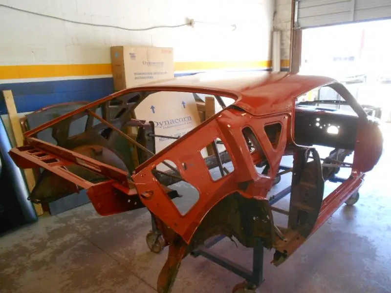

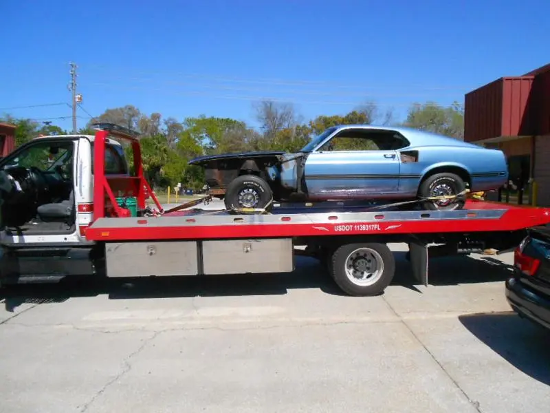

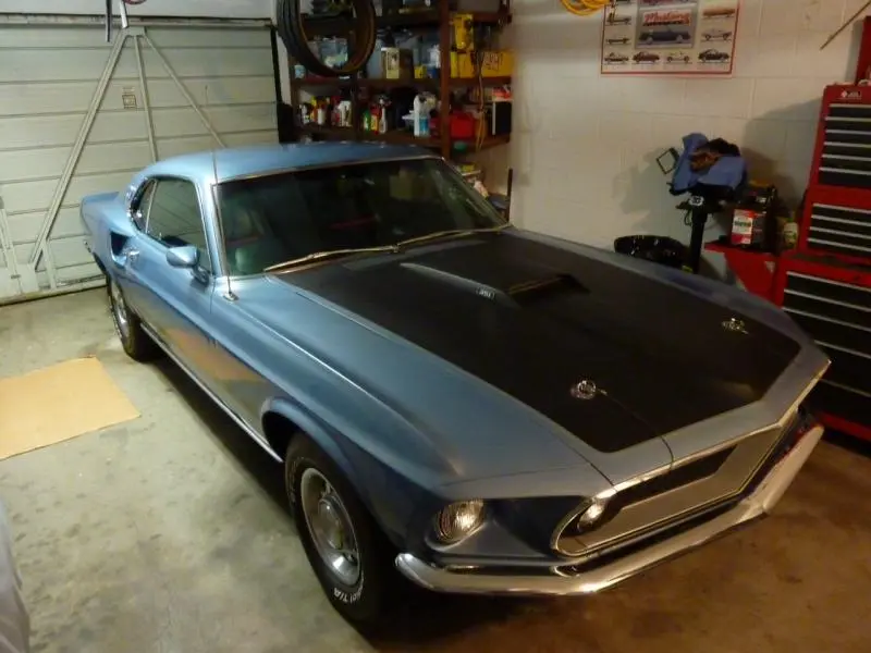

This 1969 Mach 1 was bought new by the current owners Aunt who was a school teacher in West Virginia. It has a 351 with a 3 speed manual transmission. The current owner bought it in 1992.
Looks pretty good in the photo.

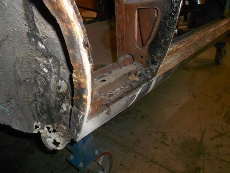

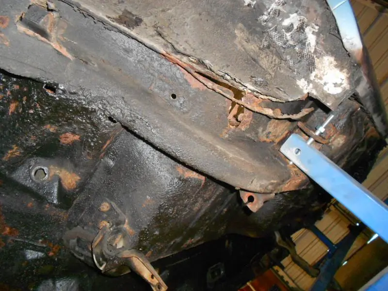

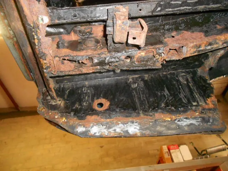

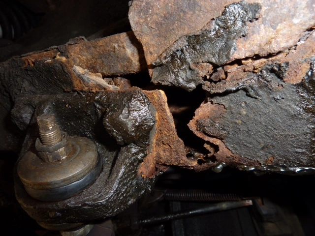

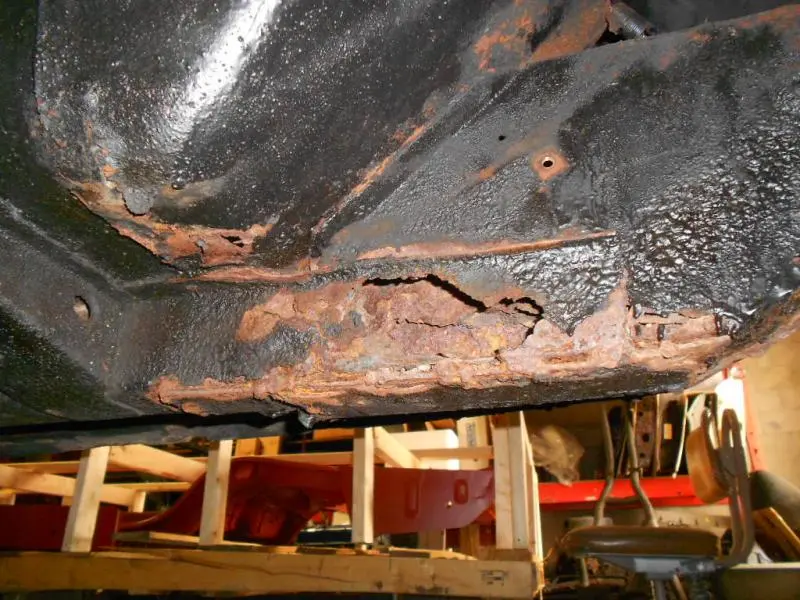

Around 10 years ago he quit driving it when he noticed this rust around the power steering bracket. He did tell me a few years ago he did take it out for a short drive.
The owner starting taking it apart and had it delivered to us.

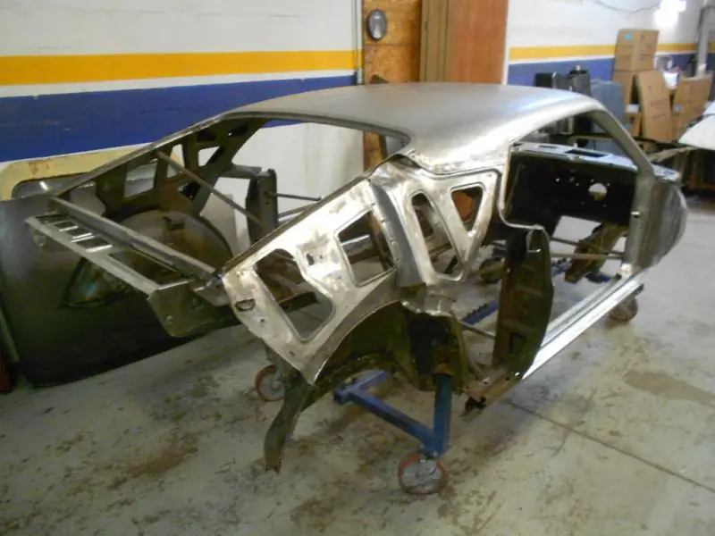

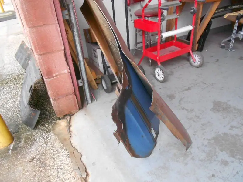

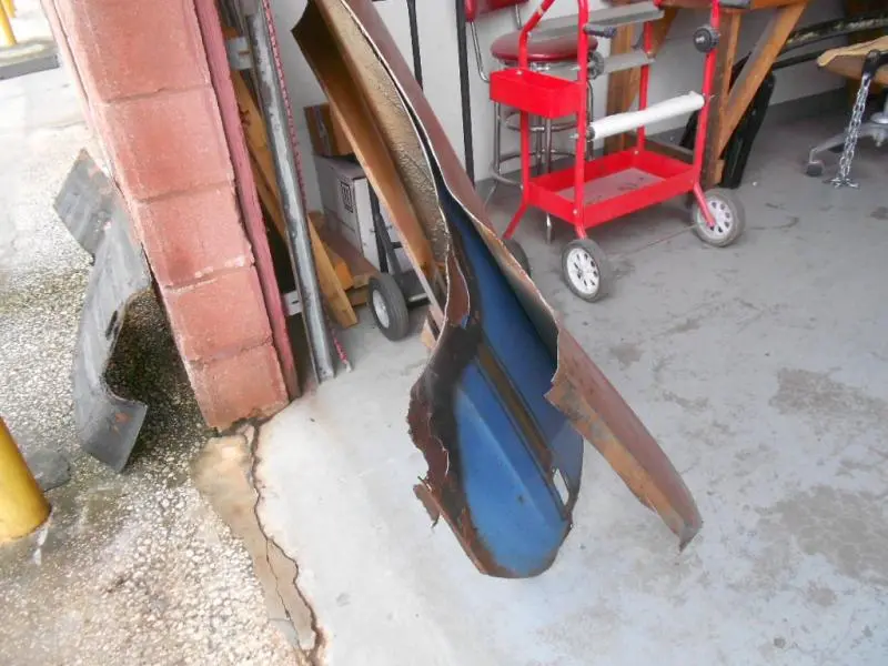

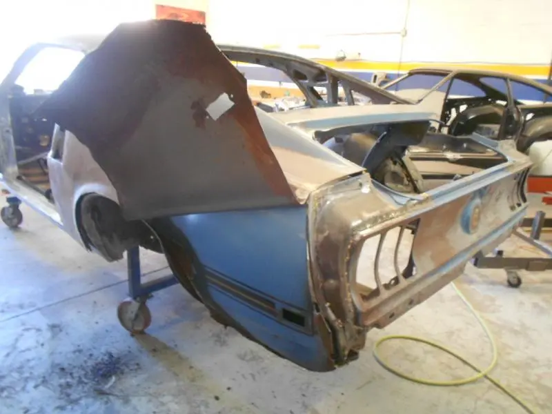

I noticed around the quarter scoop hole that something was going on. It looked like they had put a quarter patch on. This is what we found. They had a quarter skin over the original rusted out quarter panel.

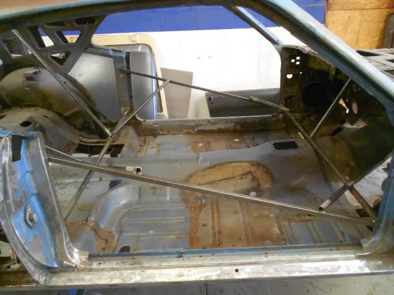

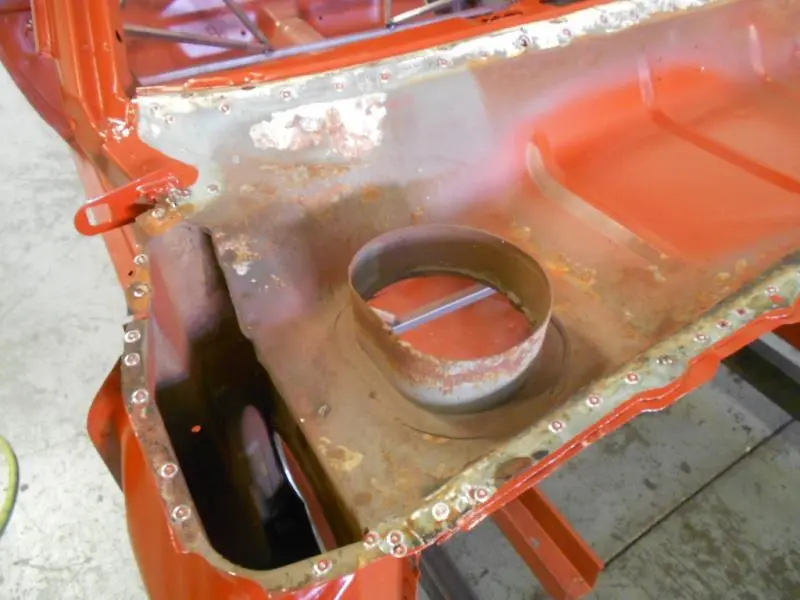

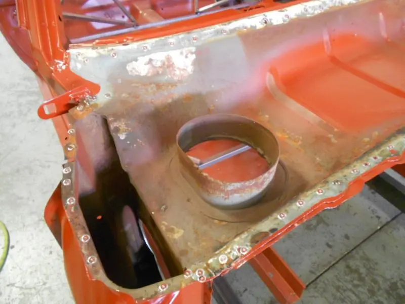

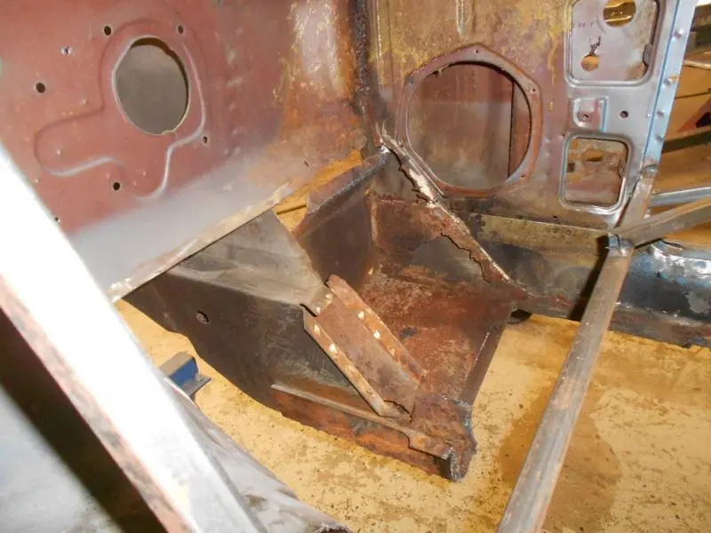

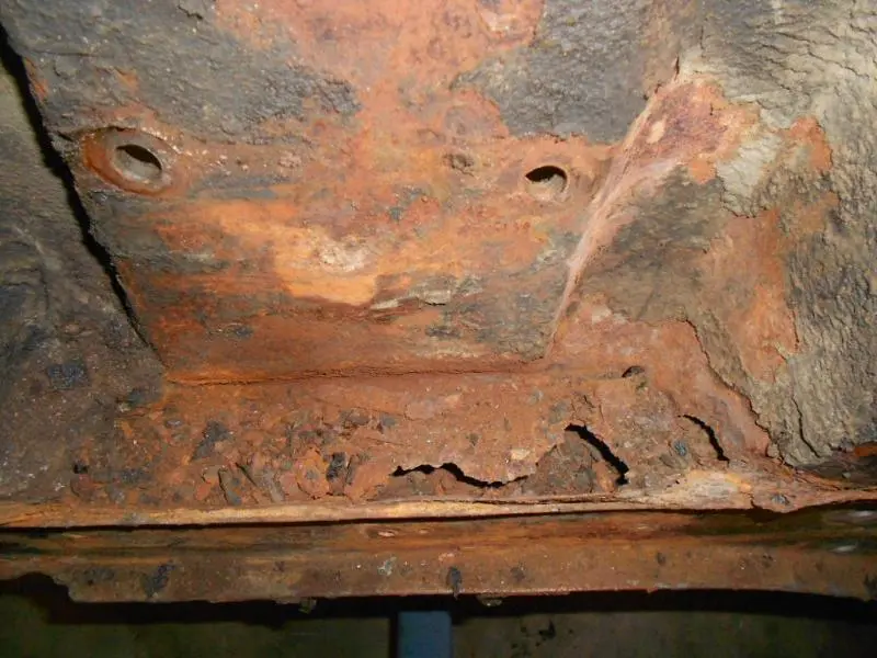

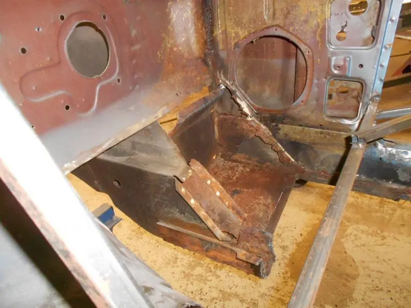

This is inside one of the shock towers

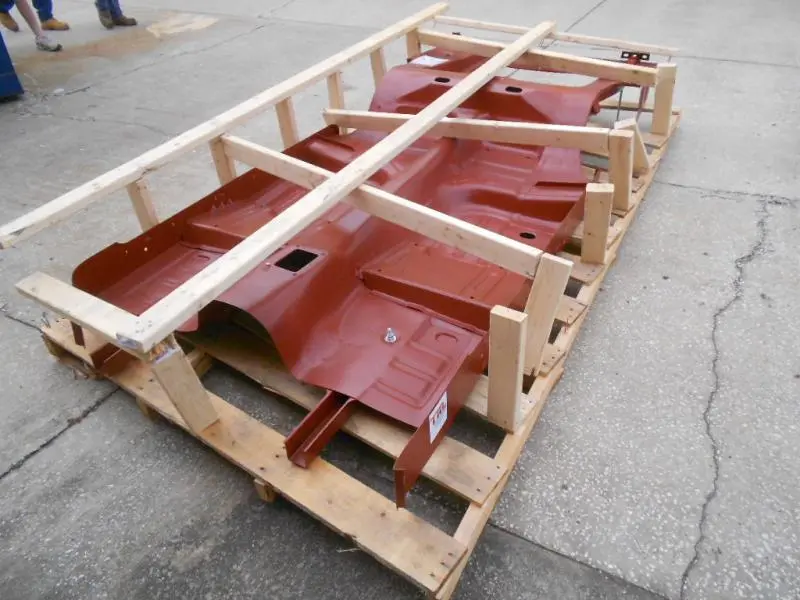

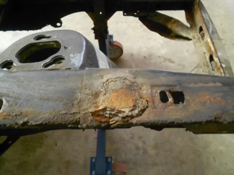

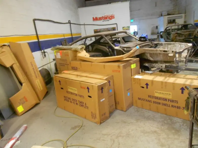

Since the floor and frame rails were so bad we ordered this from Thoroughbred.

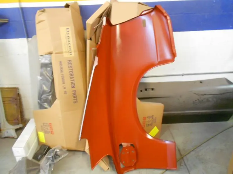

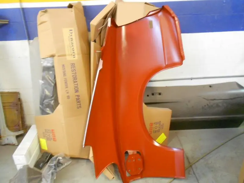

Dynacorn parts that have come in

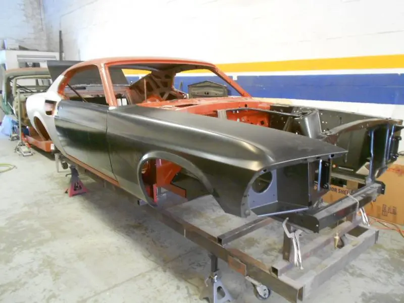

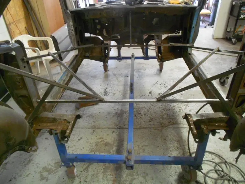

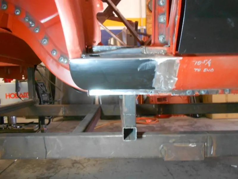

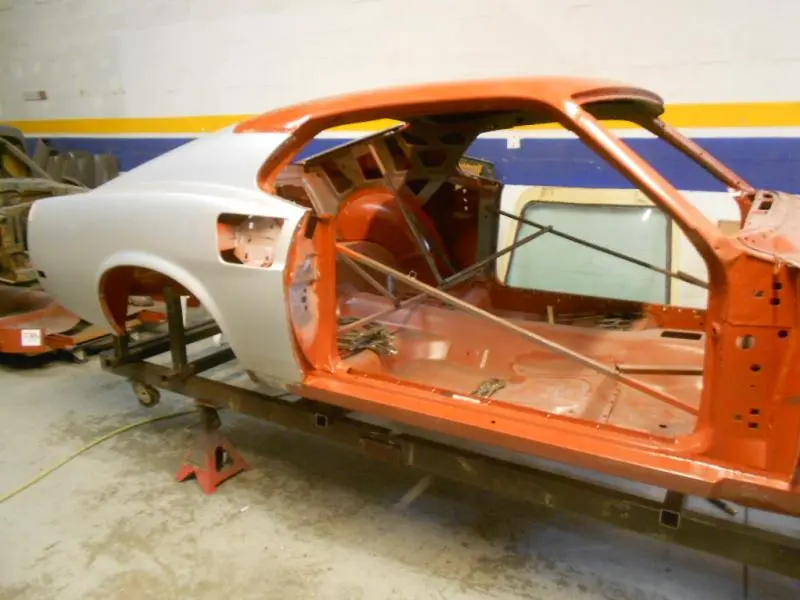

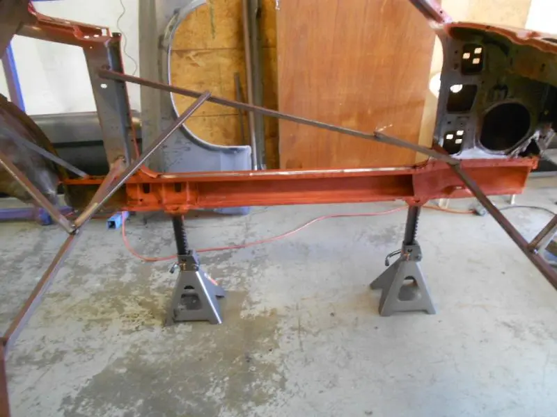

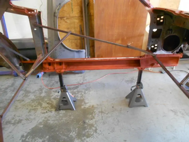

We made a jig with the stock suspension points and correct dimensions to build the car on.
Brian has the floor cut out

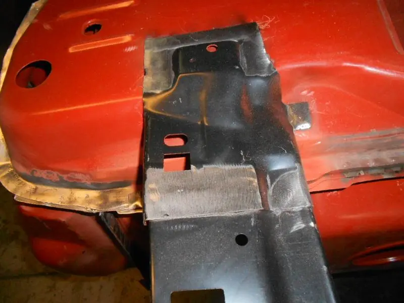

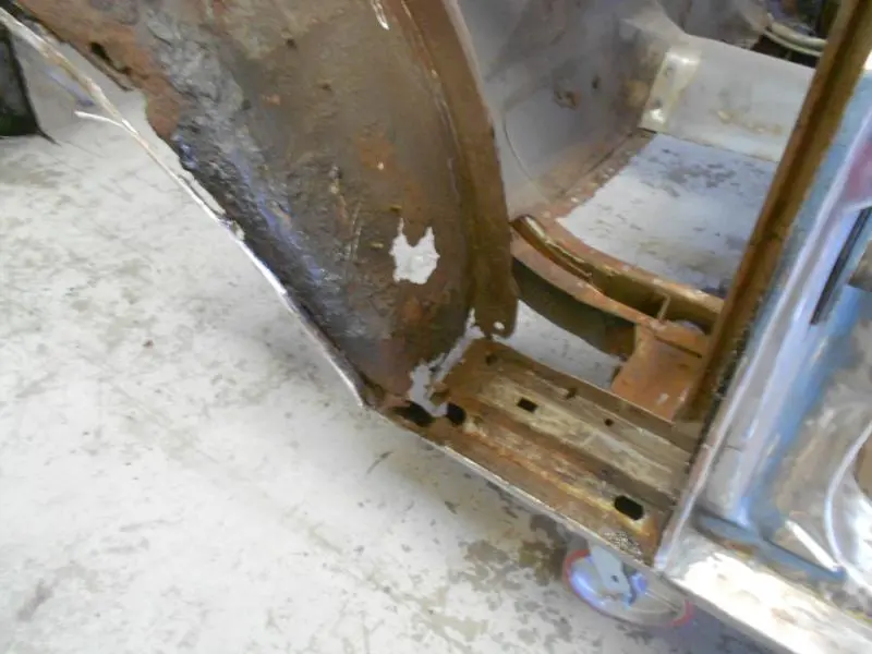

Needs new torque boxes

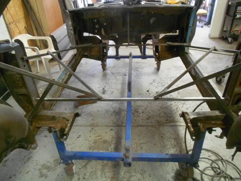

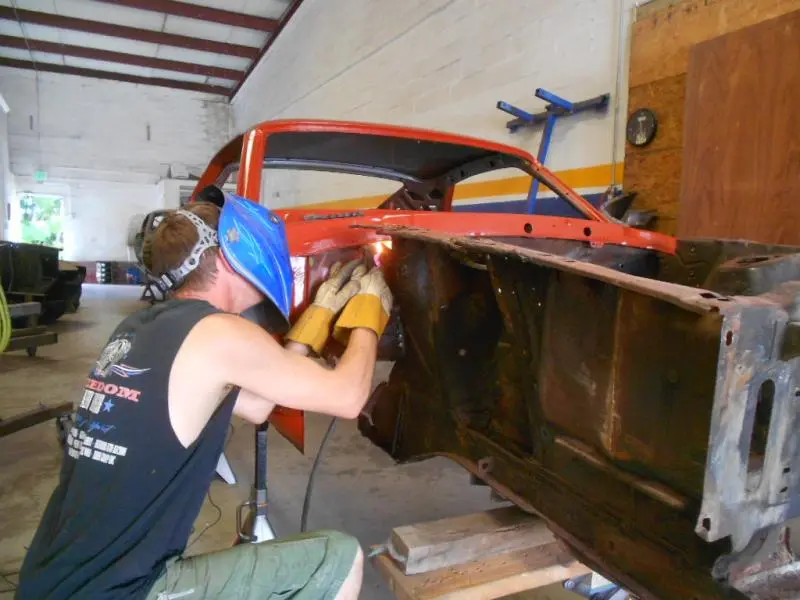

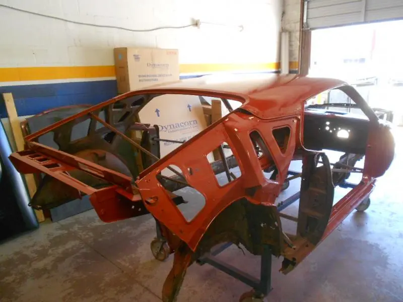

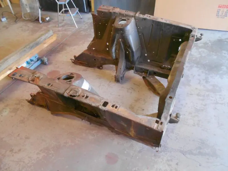

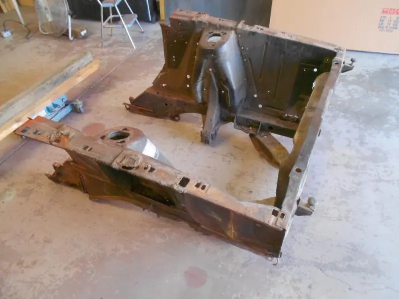

We removed the cart and now Brian is cutting off the front end
There wasn't a lot holding in on

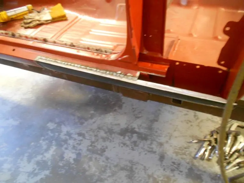

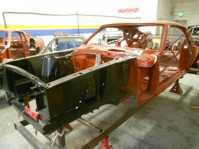

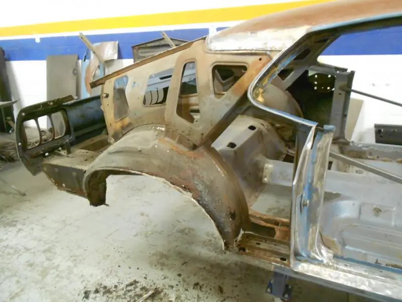

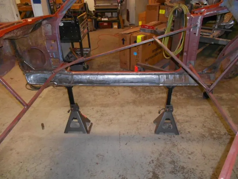

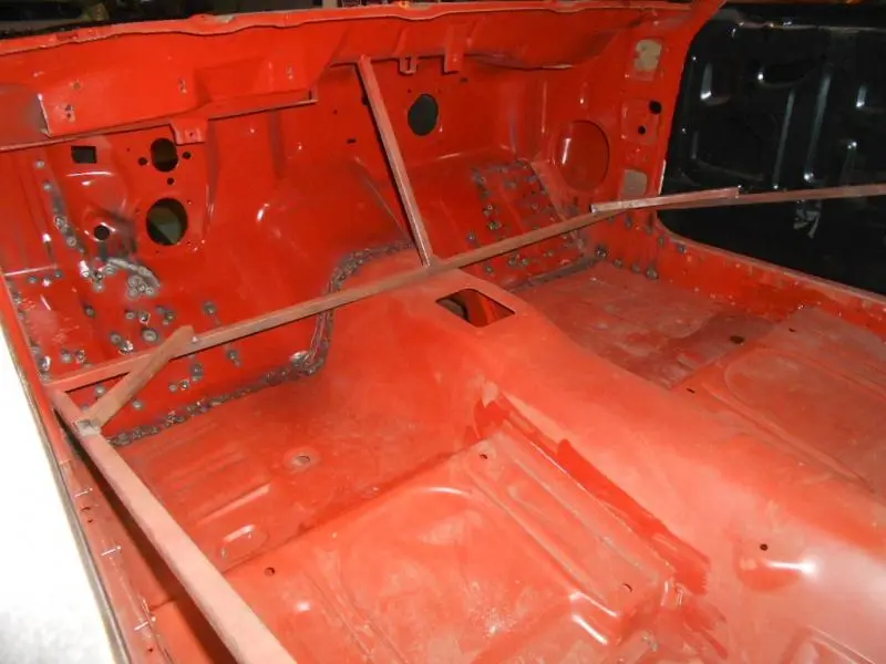

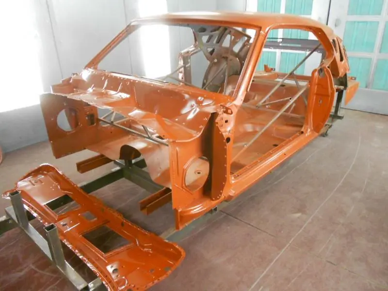

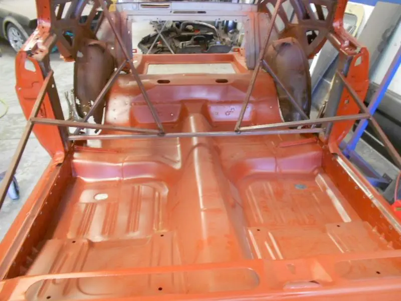

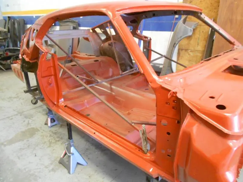

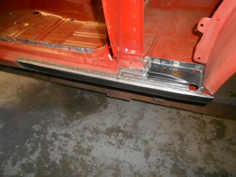

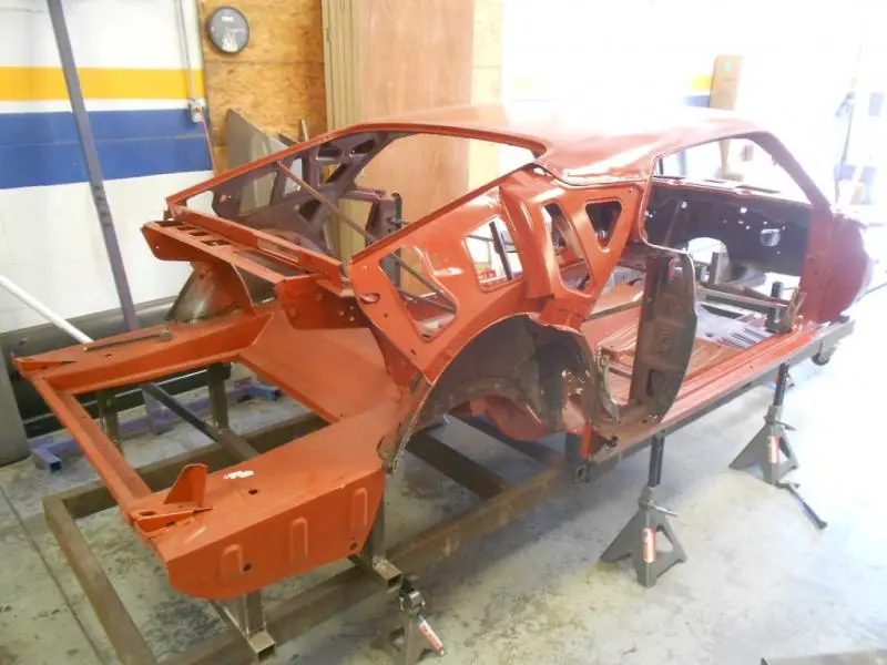

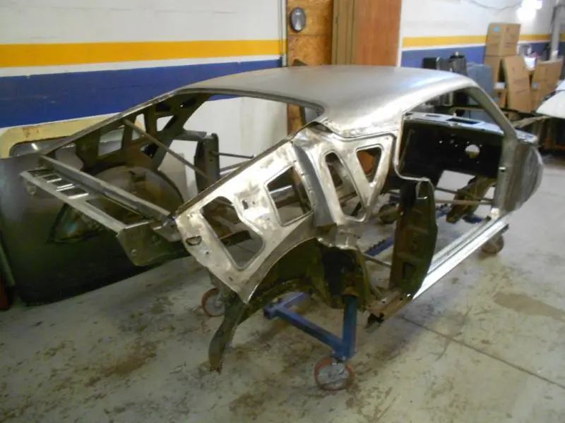

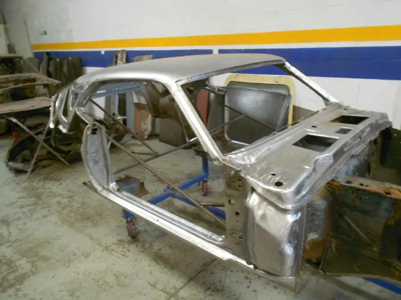

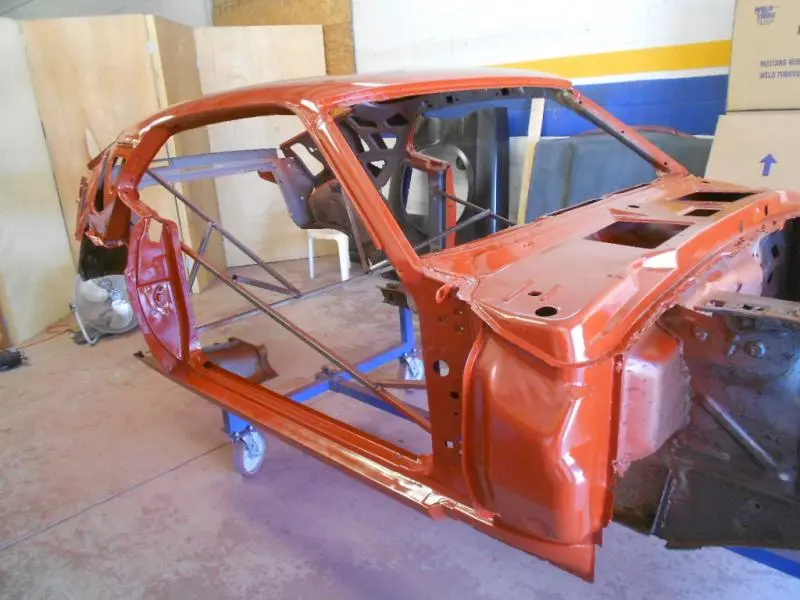

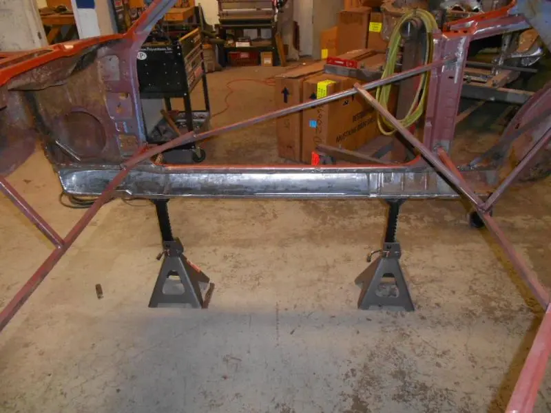

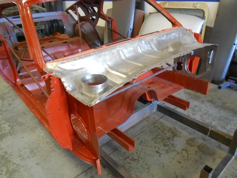

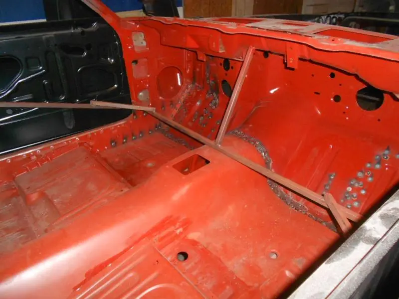

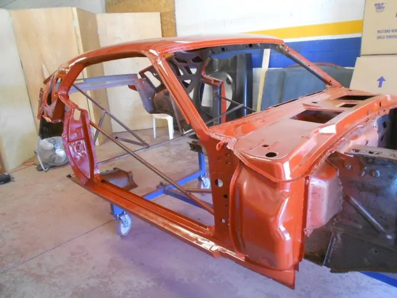

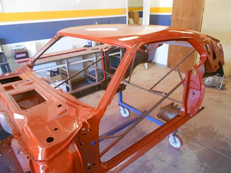

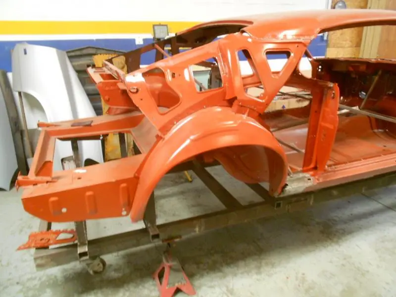

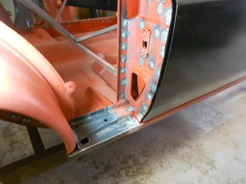

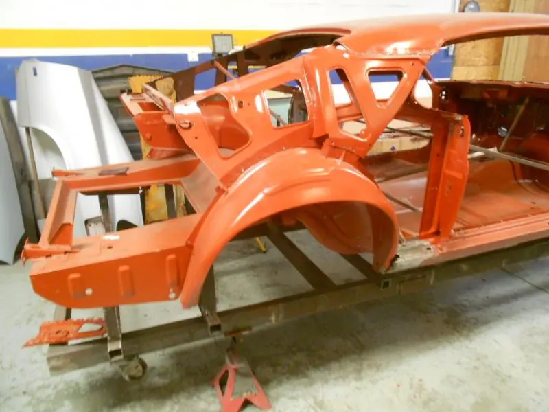

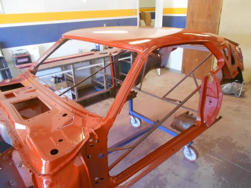

The inner rocker was removed and the inside of the outer rocker panel was epoxy primed

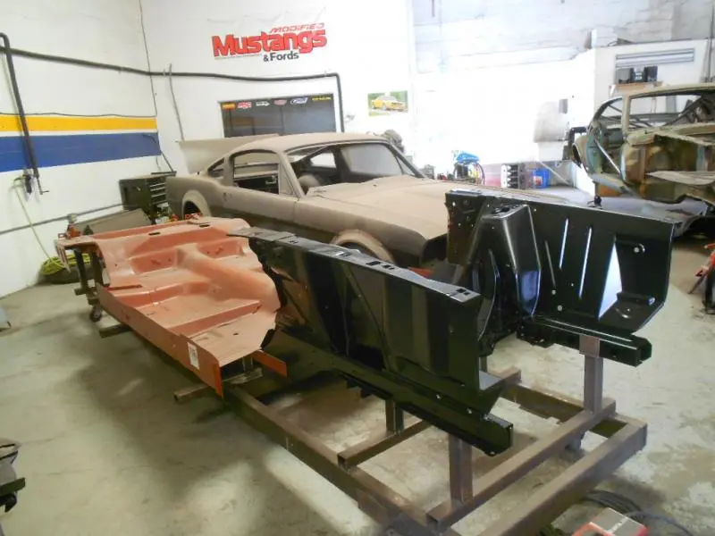

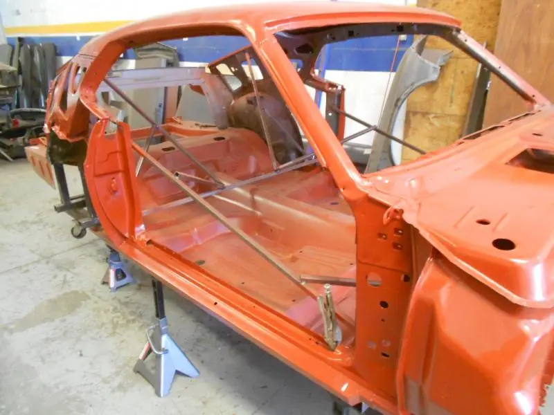

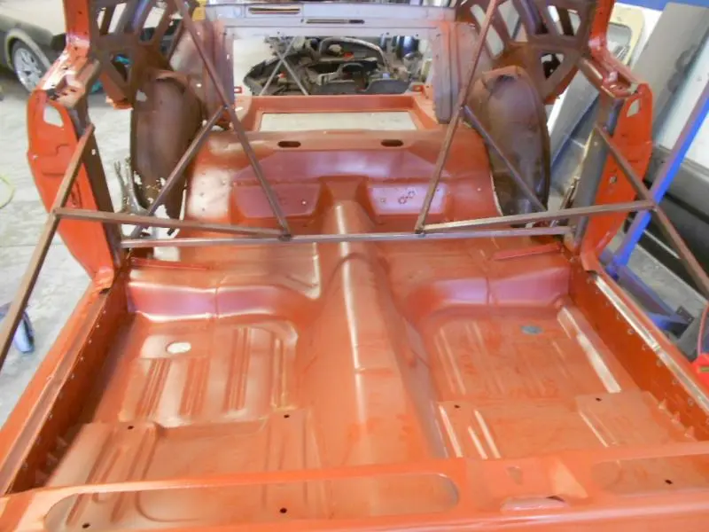

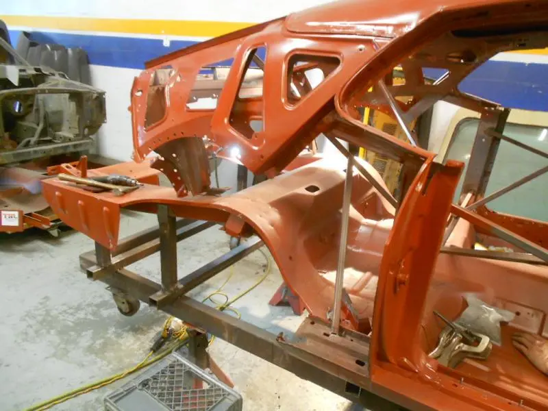

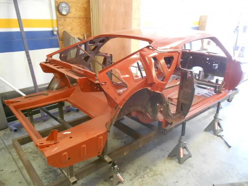

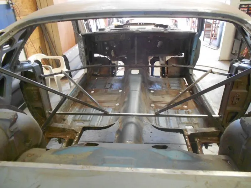

The Thoroughbred floor was mounted on our jig and rolled under the body. Jacks were used on both ends. Once everything was level the body was attached with sheetmetal screws to the new floor.
The old inner wheelhouses were left in place to keep the inner structure together and a reference point to line up the floor.

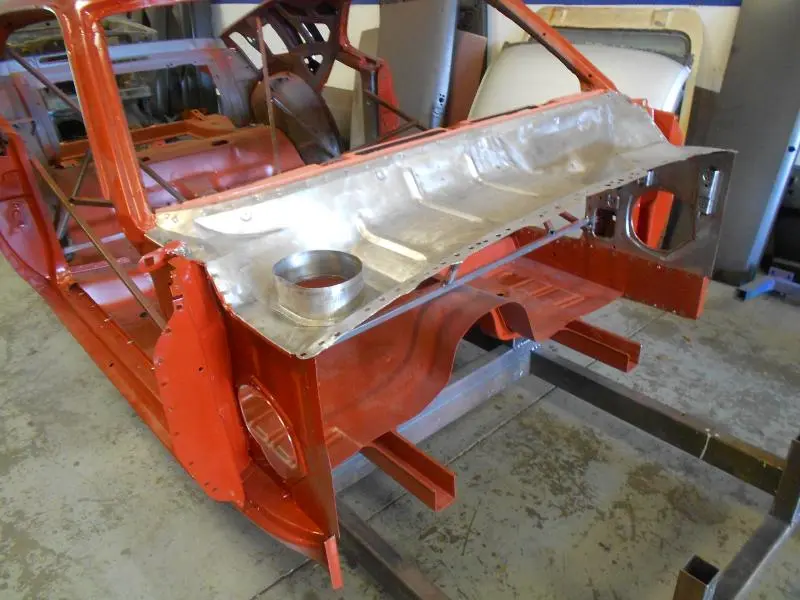

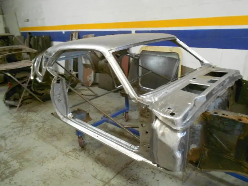

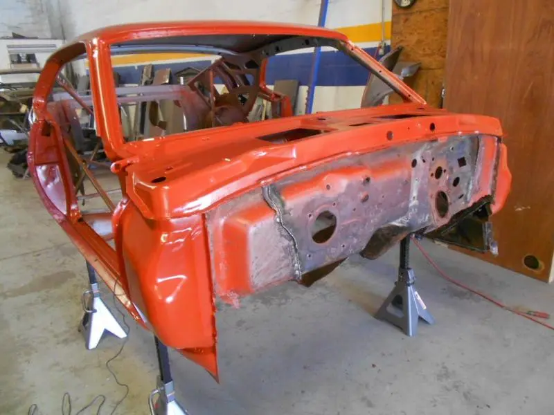

We were surprised to find no rust in the cowl
The cowl was sanded and epoxy primed

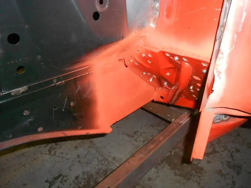

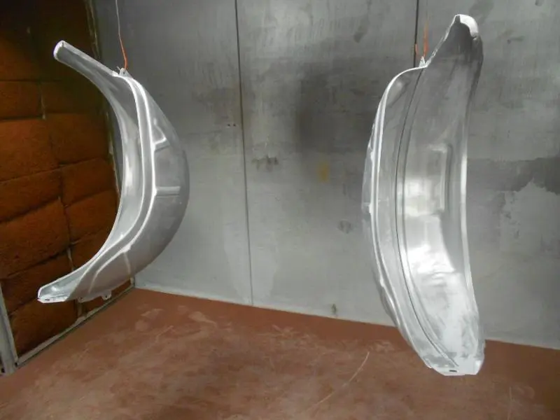

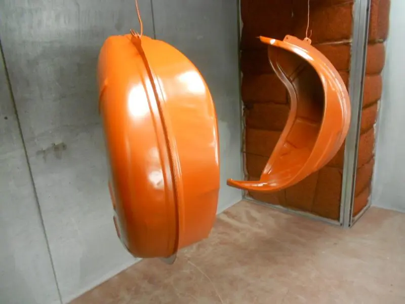

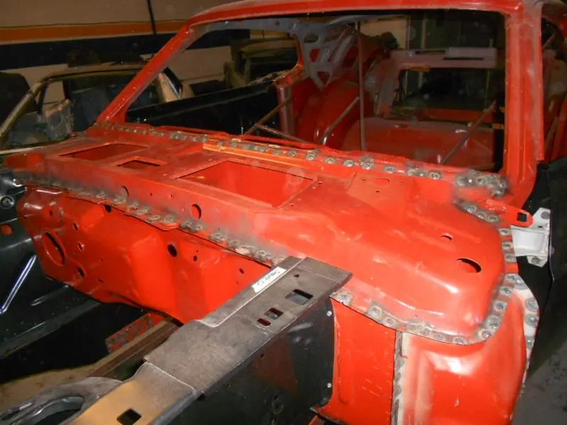

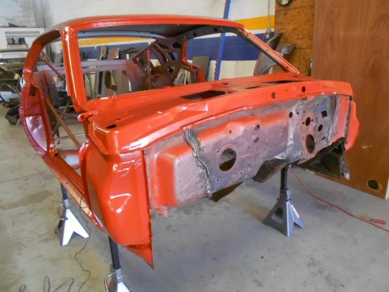

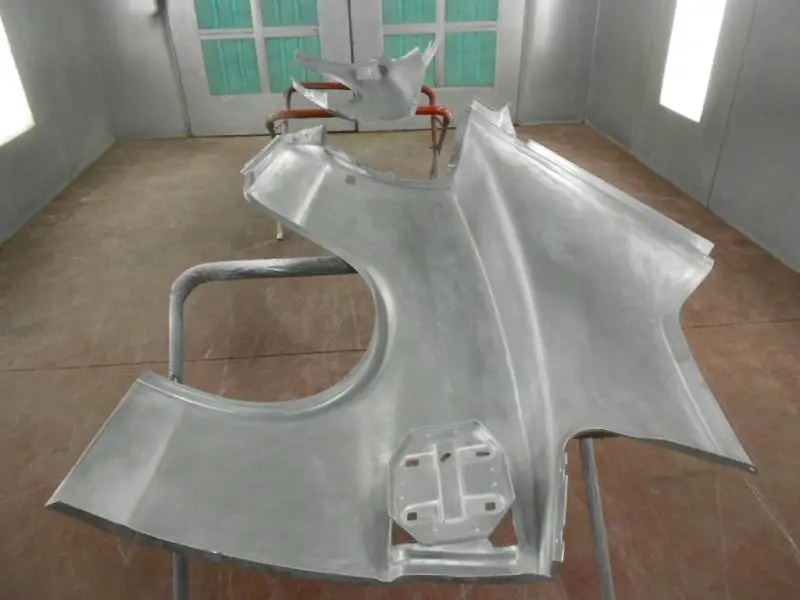

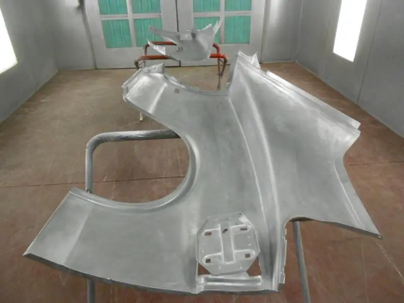

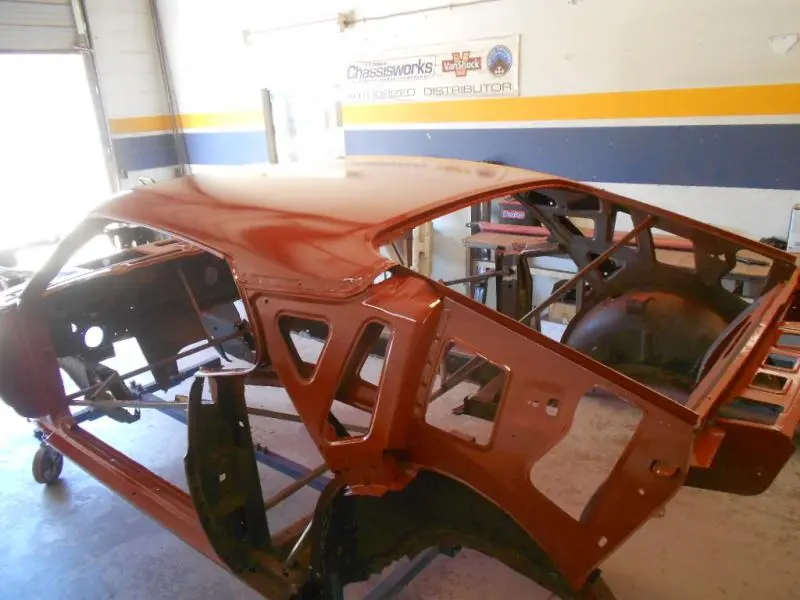

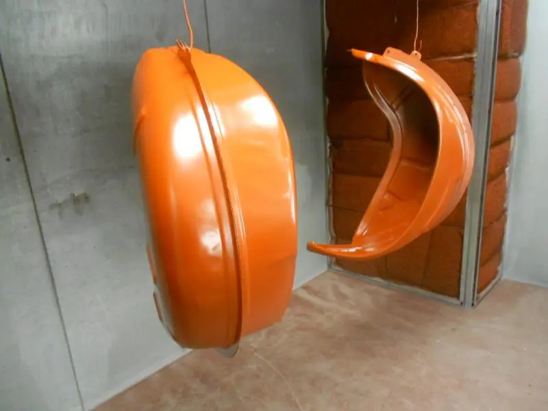

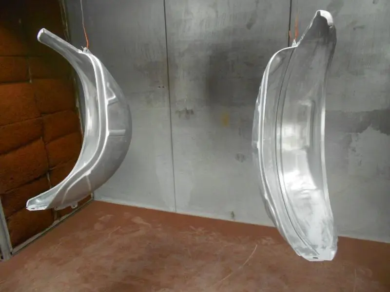

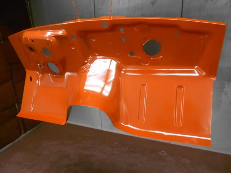

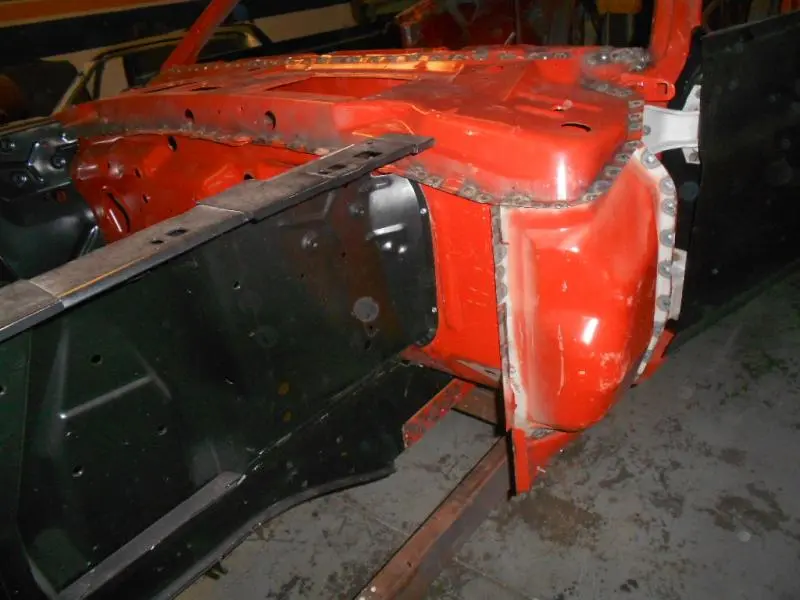

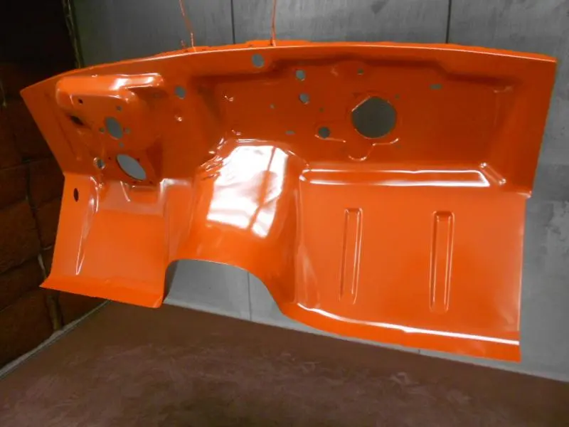

The firewall, one piece wheelhouses and quarter panels were sanded and epoxy primed.

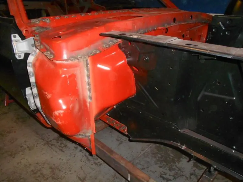

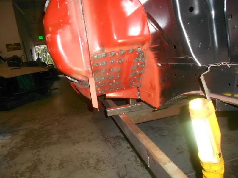

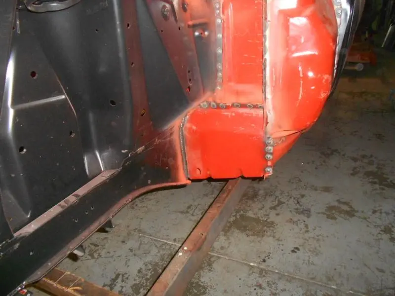

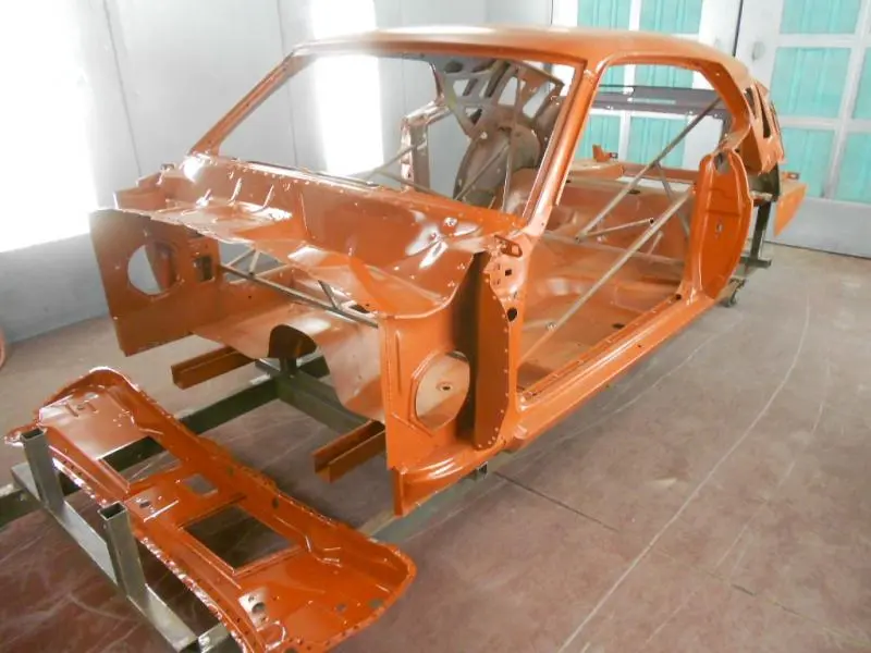

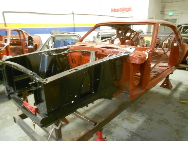

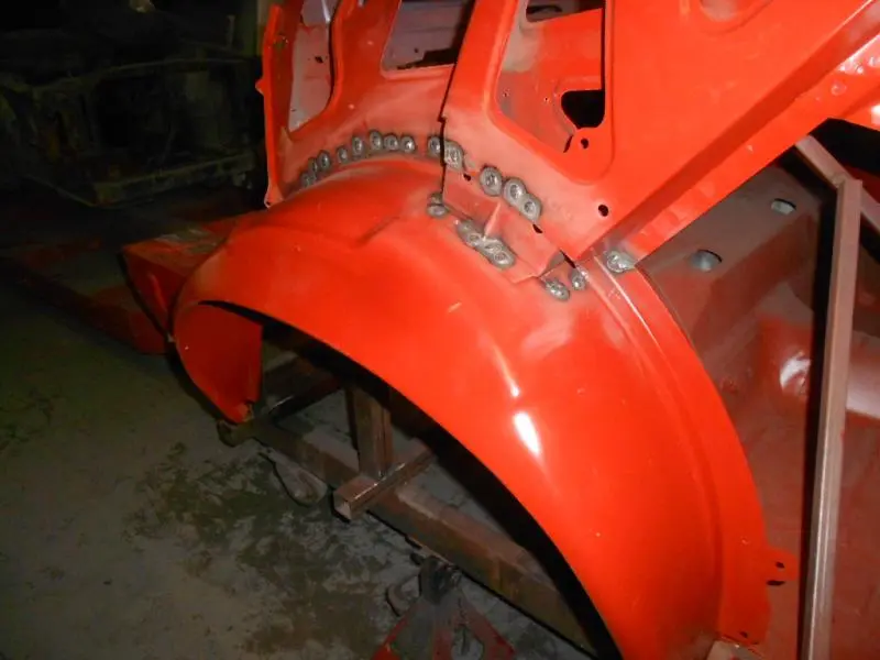

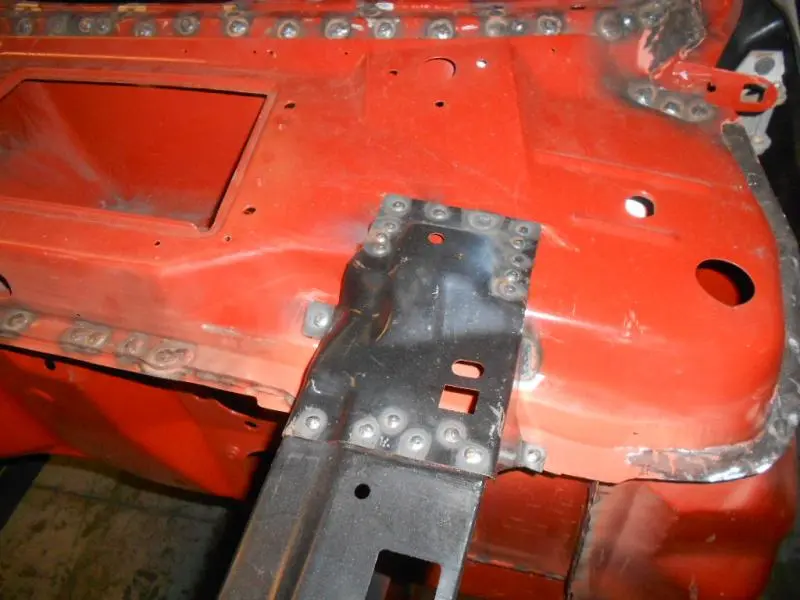

The old inner wheelhouse was removed
New one was screwed in place

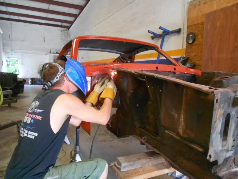

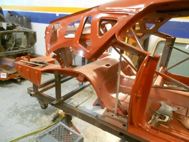

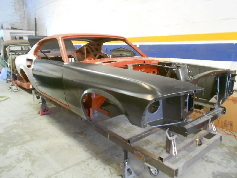

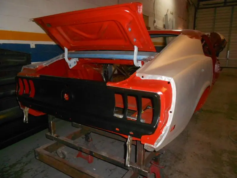

Lining up the front end

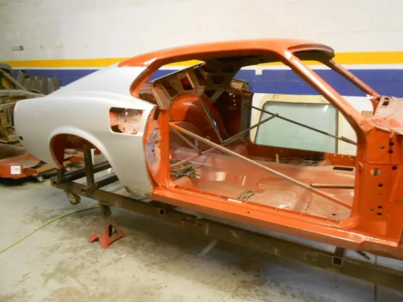

Test fitting the quarter panels

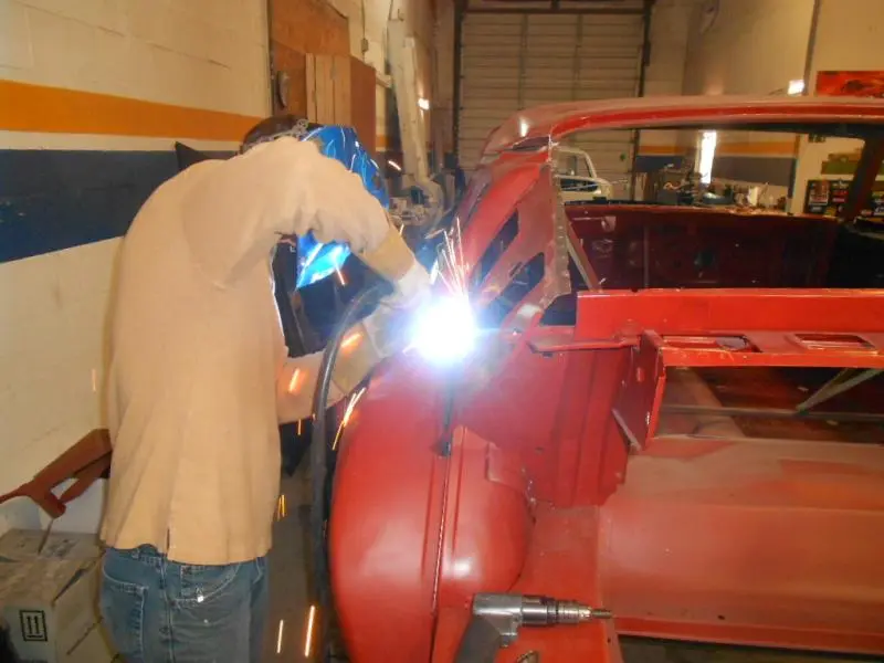

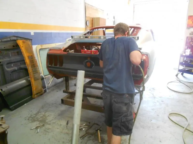

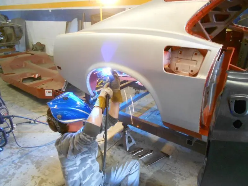

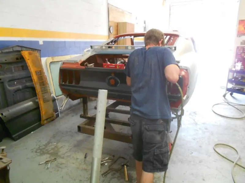

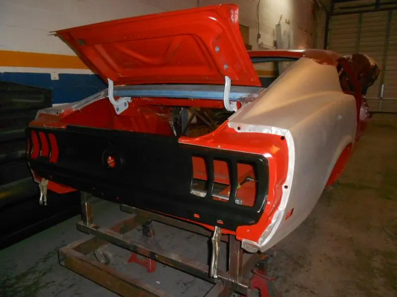

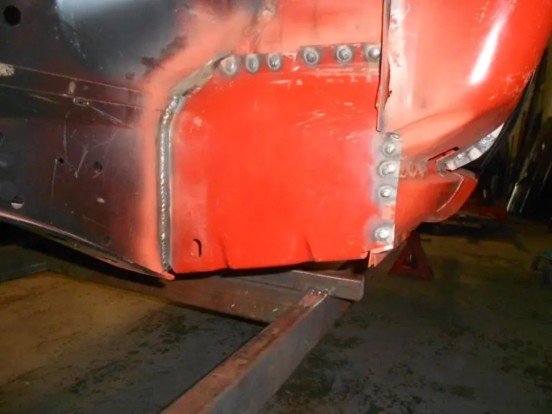

Brian is attaching the taillight panel with screws

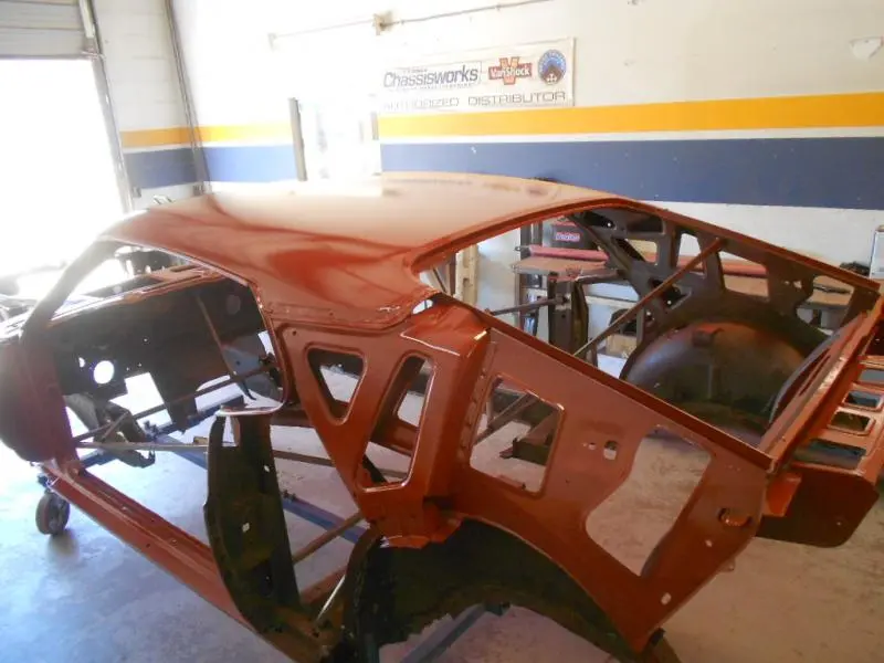

The sheetmetal is lining up great almost ready to start welding.
