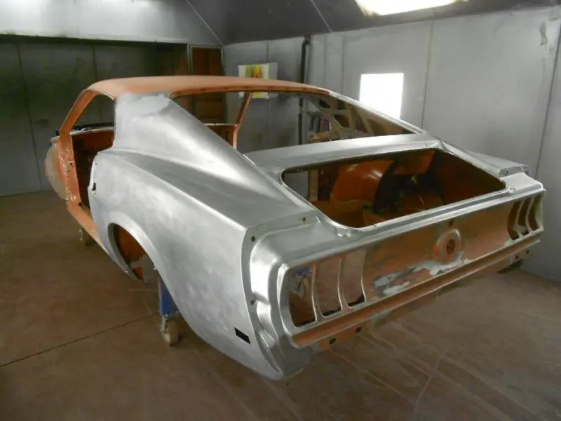

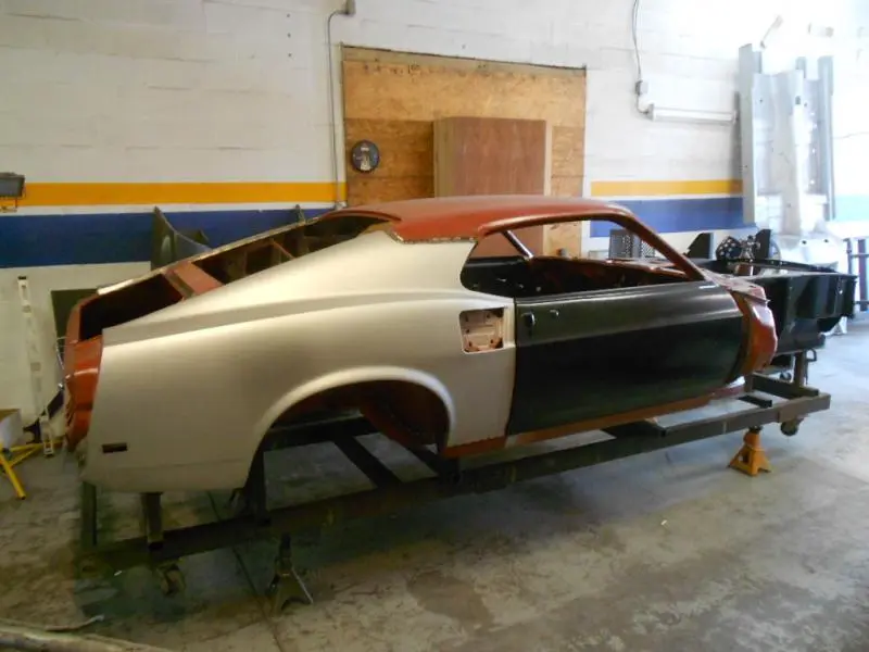

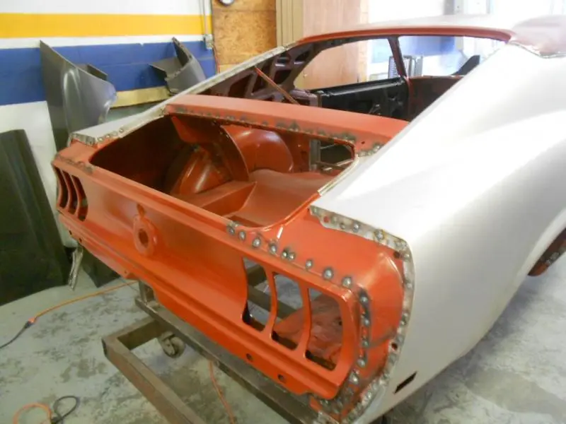

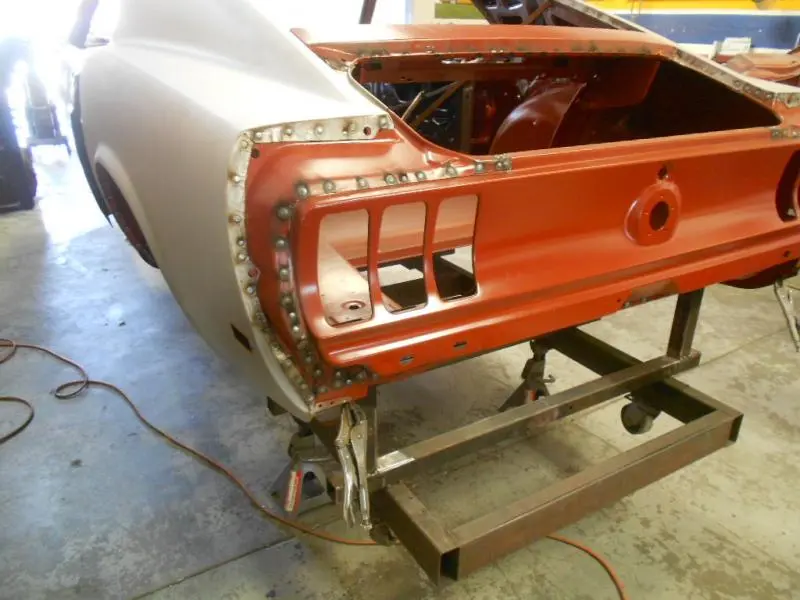

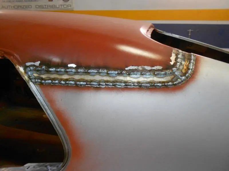

rusty428cj 10 Year Member Sep 29, 2007 943 267 104 Port Richey Fl Dec 19, 2014 #21 Dec 19, 2014 #21 Brian is welding the trunk dropoffs to the quarter panels and he should be finished welding on the body. Next week it will be coming off the jig and going on a cart.

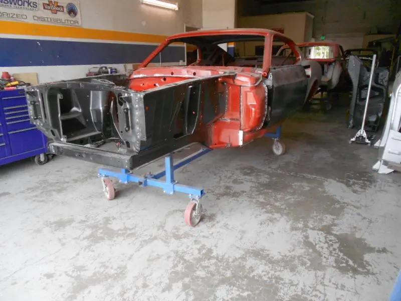

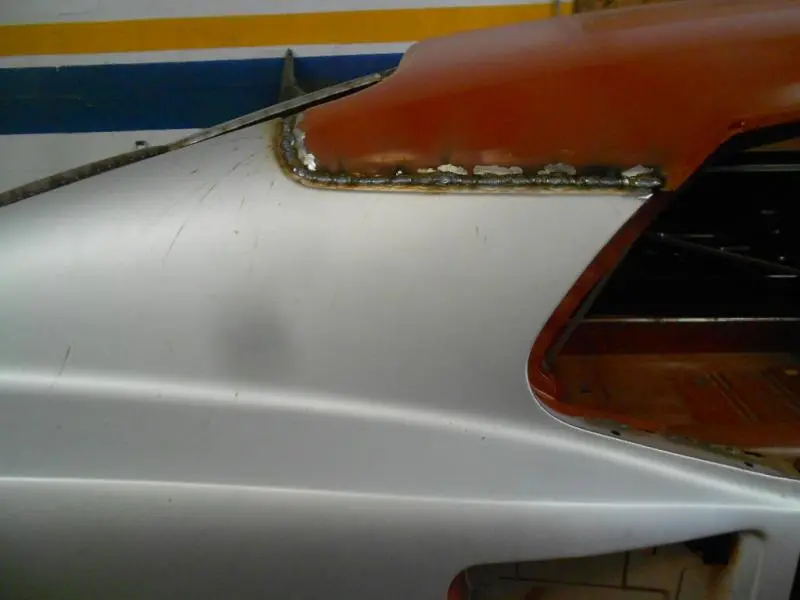

rusty428cj 10 Year Member Sep 29, 2007 943 267 104 Port Richey Fl Dec 24, 2014 #22 Dec 24, 2014 #22 All the major welding is finished time to take it off the jig and back on the cart

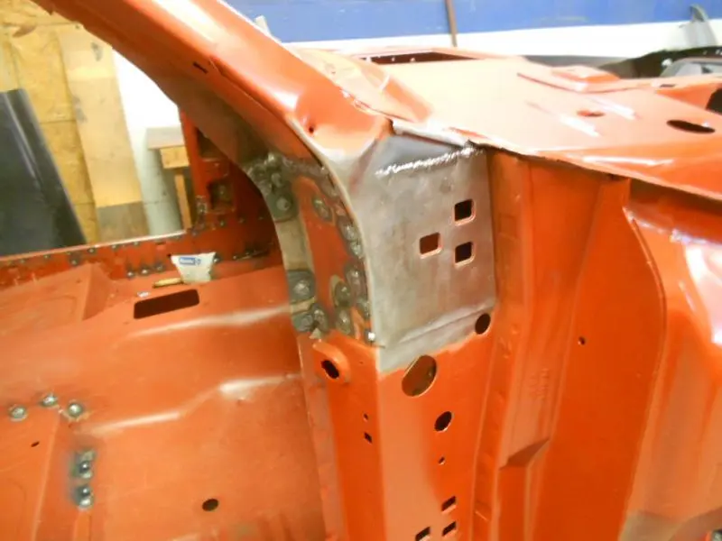

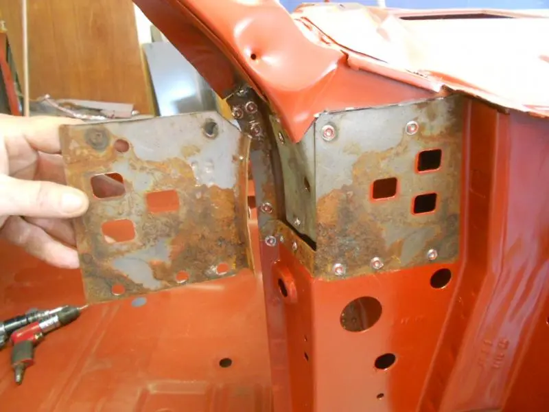

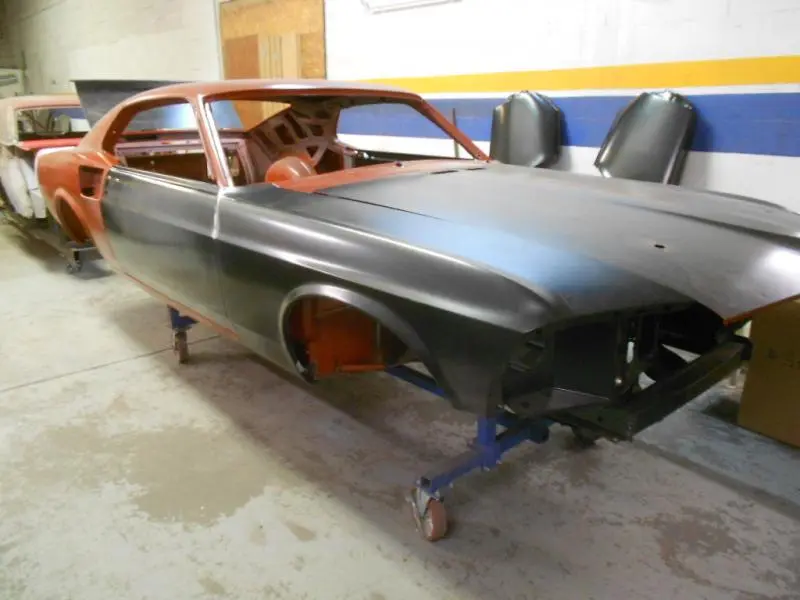

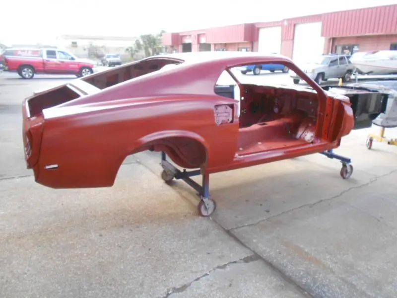

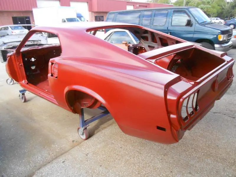

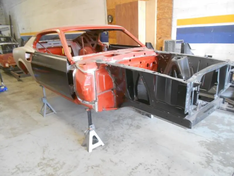

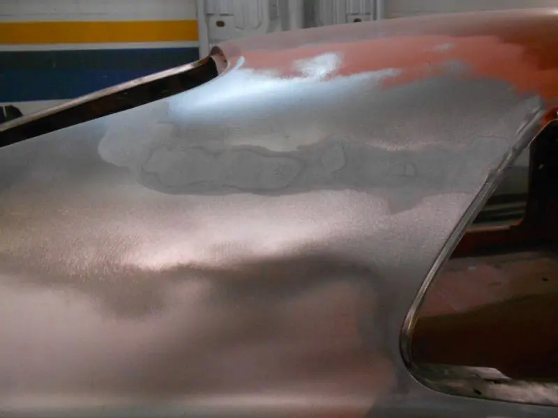

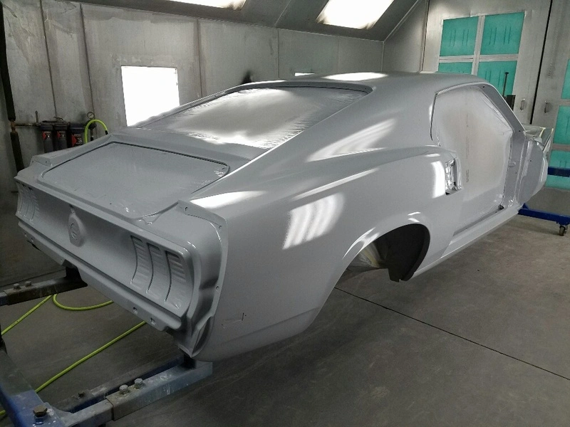

rusty428cj 10 Year Member Sep 29, 2007 943 267 104 Port Richey Fl Jan 1, 2015 #23 Jan 1, 2015 #23 Sprayed primer before the patch is welded in place The welds were ground down and filled with duraglass The new sheetmetal that had not been epoxy primed before was sanded to bare metal Two coats of SPI red oxide epoxy primer. It is darker than the photos
rusty428cj 10 Year Member Sep 29, 2007 943 267 104 Port Richey Fl Jan 3, 2015 #24 Jan 3, 2015 #24 Outside this is the color of the red oxide epoxy not how it looks in the booth with all the lights.

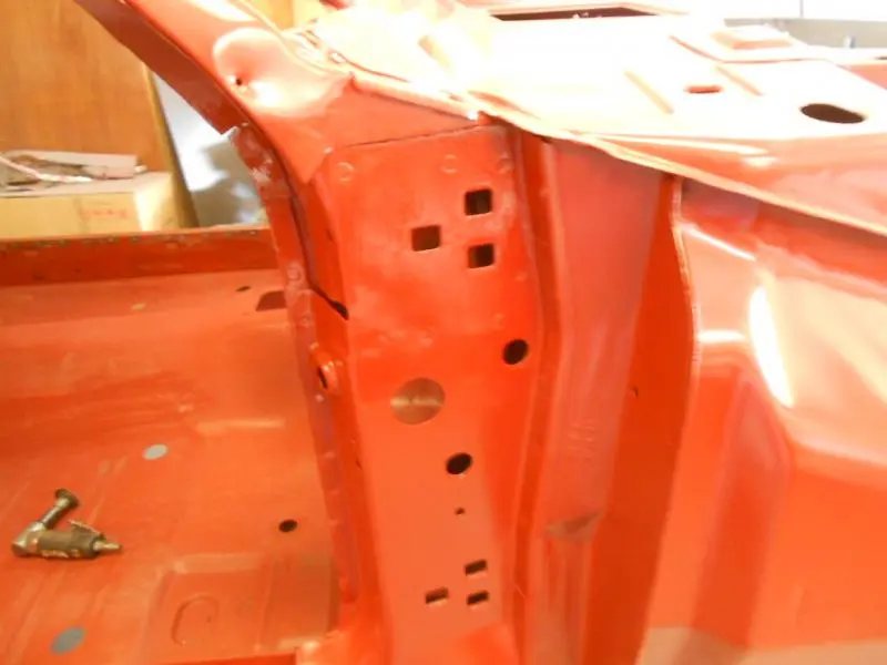

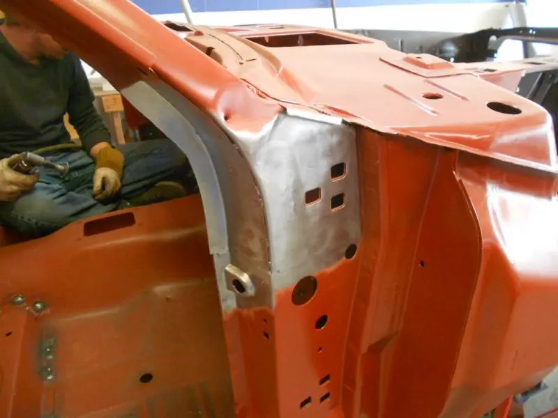

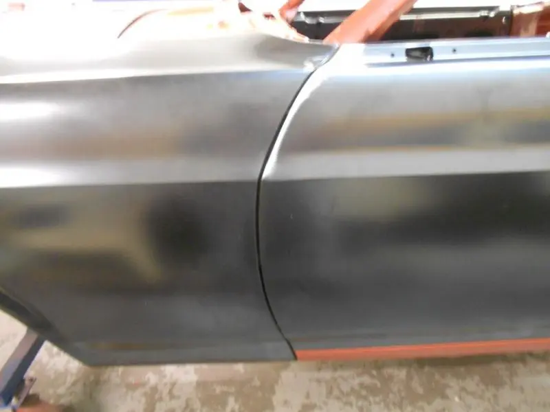

rusty428cj 10 Year Member Sep 29, 2007 943 267 104 Port Richey Fl Jan 7, 2015 #26 Jan 7, 2015 #26 There was a little rust in the right A pillar It was sanded and epoxy primed
rusty428cj 10 Year Member Sep 29, 2007 943 267 104 Port Richey Fl Jan 18, 2015 #27 Jan 18, 2015 #27 It is starting to look like a 1969 Mustang Brian is starting to work on the door gaps

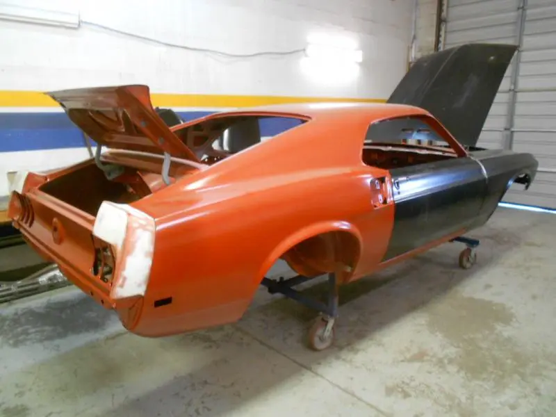

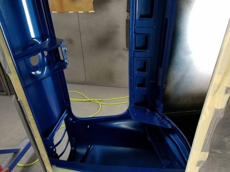

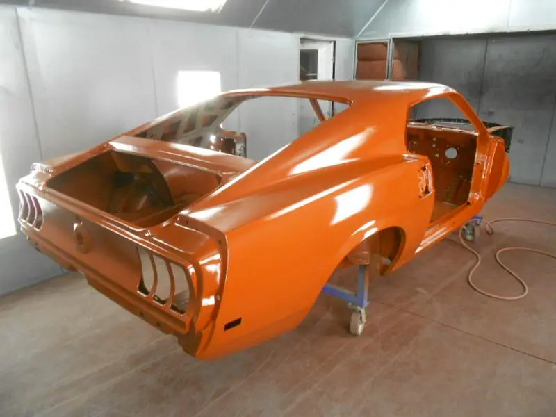

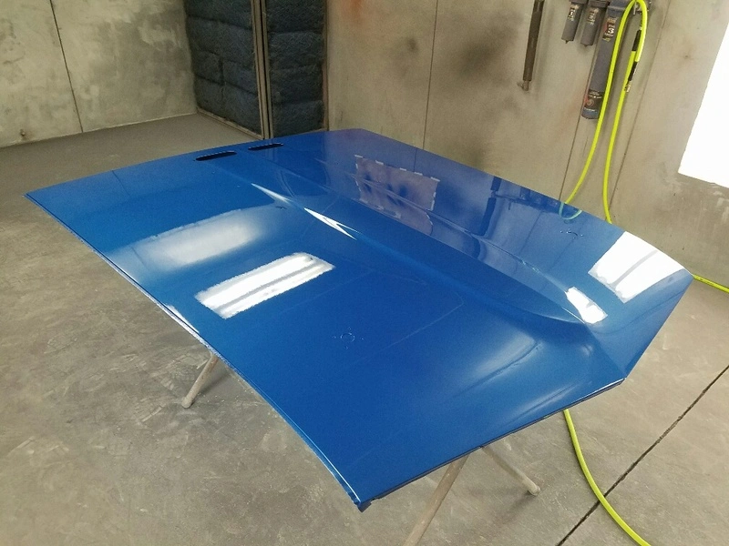

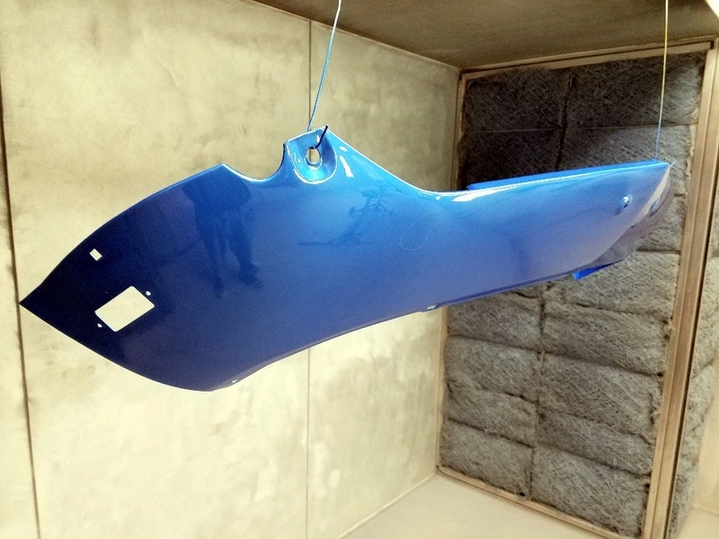

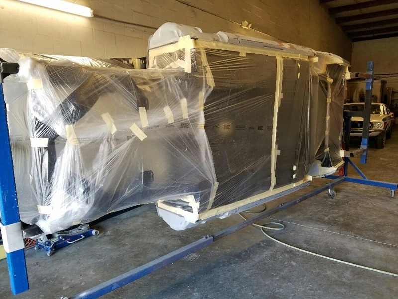

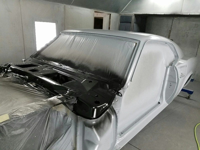

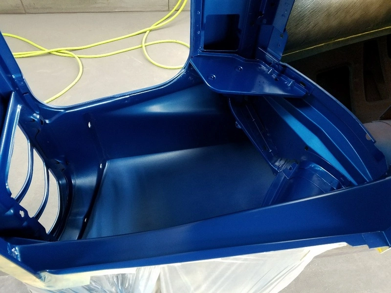

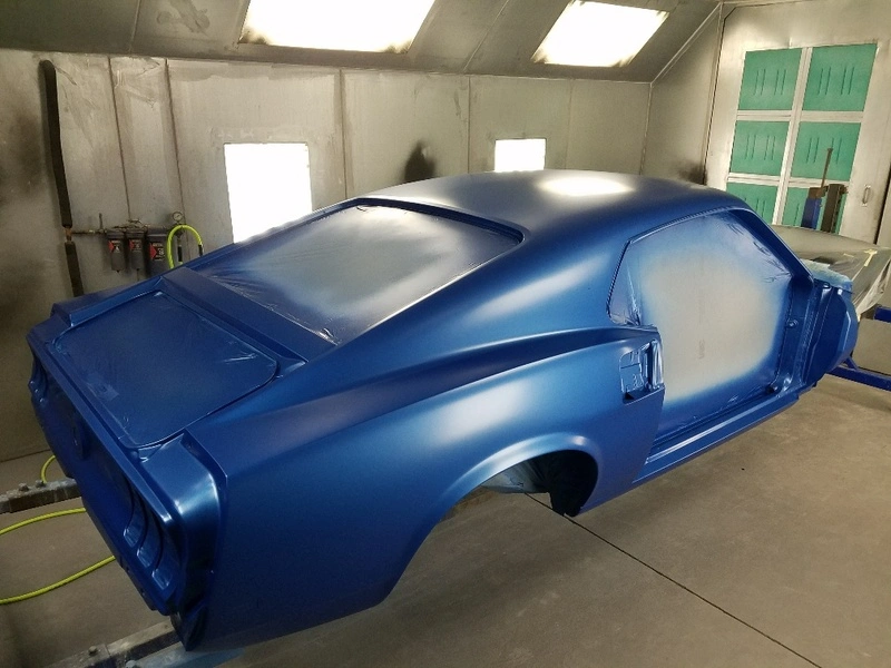

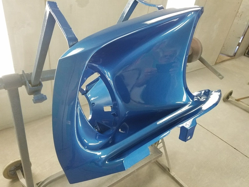

rusty428cj 10 Year Member Sep 29, 2007 943 267 104 Port Richey Fl Apr 3, 2017 #28 Apr 3, 2017 #28 Sorry I have forgotten to update The bottom of the car was tapped off getting ready for primer. Epoxy primed Hood and deck lid are painted with a couple of coats of clear Front valance and head light buckets painted Acapulco blue with 4 coats of SPI Universal Clear Inside the trunk painted Reactions: horse sence

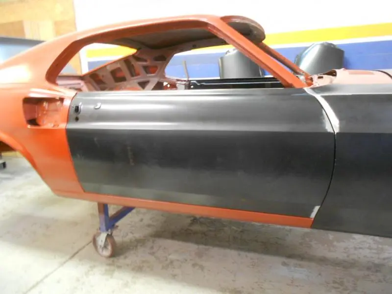

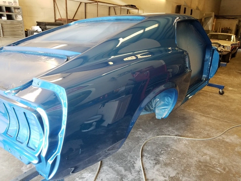

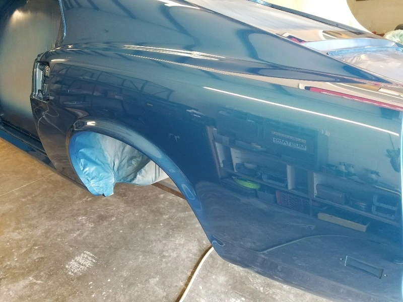

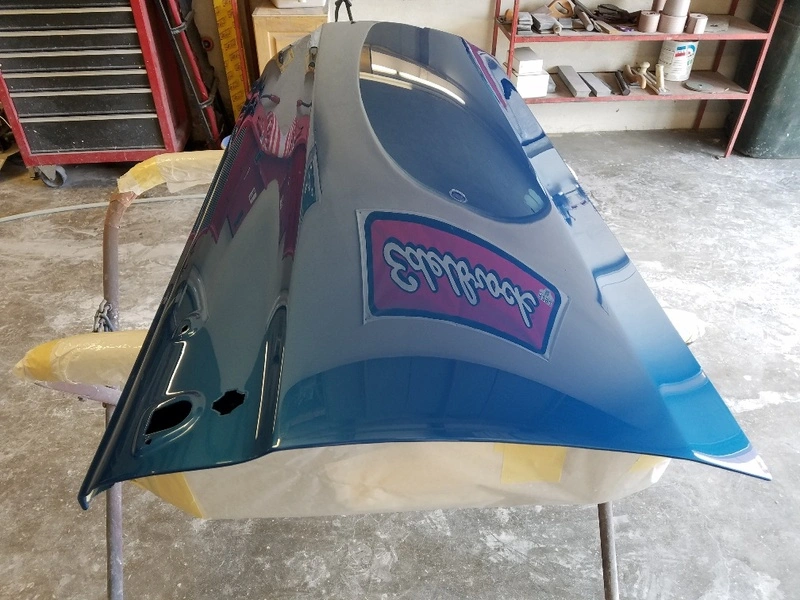

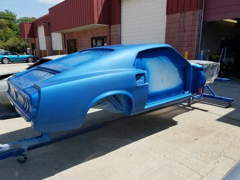

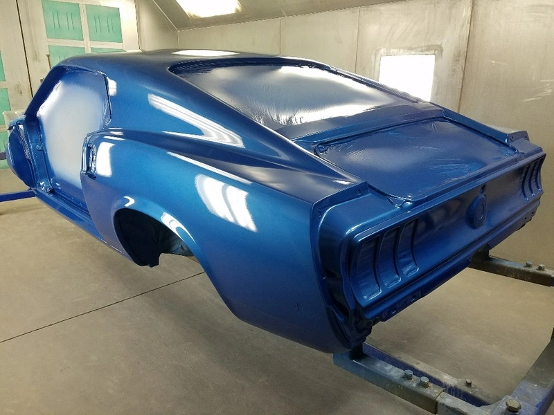

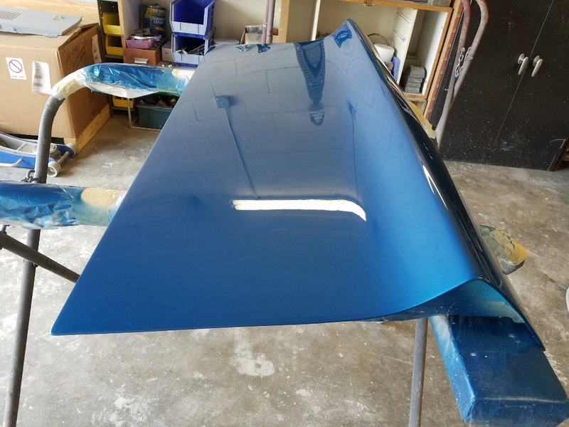

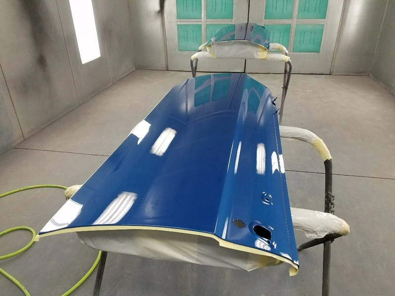

rusty428cj 10 Year Member Sep 29, 2007 943 267 104 Port Richey Fl Apr 8, 2017 #29 Apr 8, 2017 #29 Thursday I sprayed 3 coats of ProSpray Acapulco blue Friday I sprayed 3 coats of SPI Universal clear After wet sanding the doors I sprayed 3 more coats of clear today Reactions: horse sence

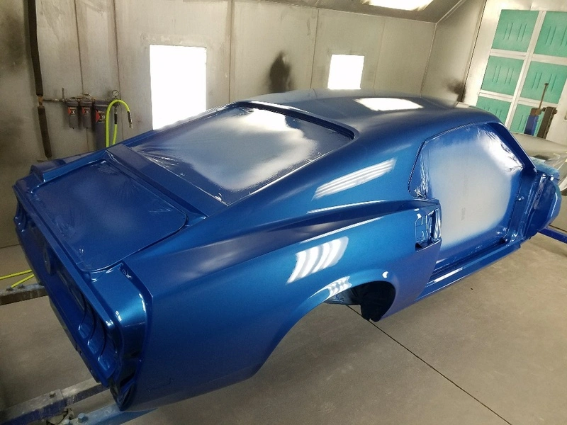

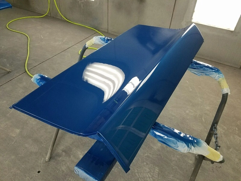

rusty428cj 10 Year Member Sep 29, 2007 943 267 104 Port Richey Fl Apr 13, 2017 #30 Apr 13, 2017 #30 The body was wet sanded and is ready for 3 more coats of clear Brian wet sanded and finished buffing the deck lid

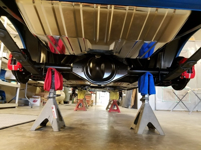

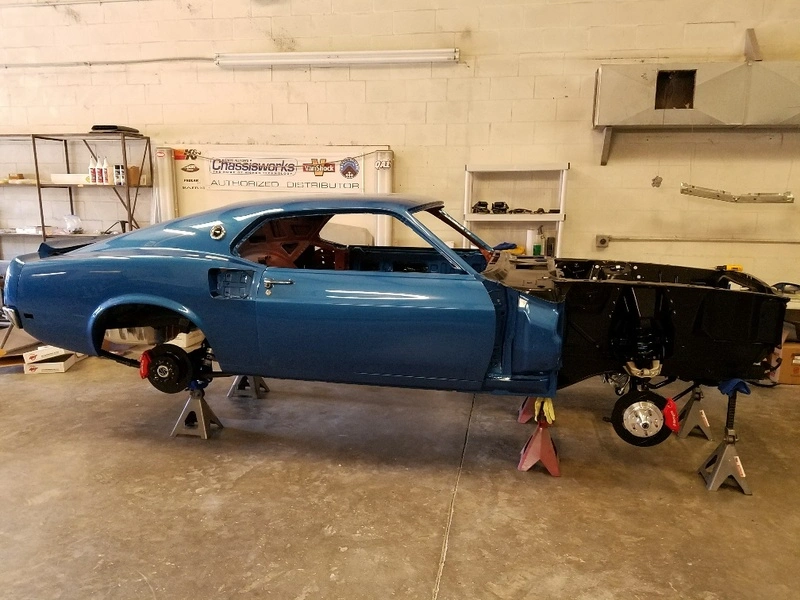

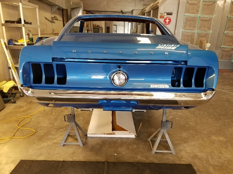

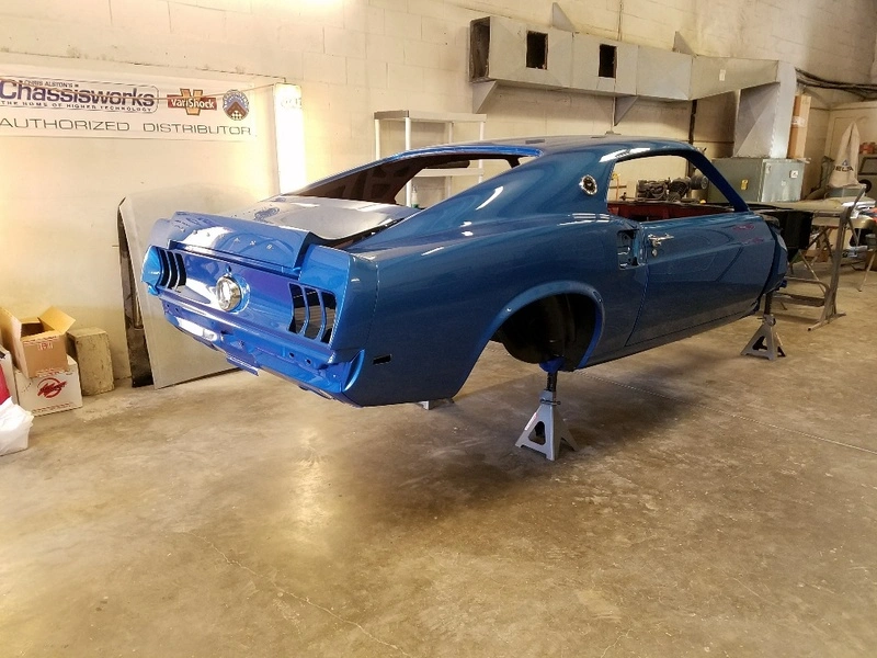

rusty428cj 10 Year Member Sep 29, 2007 943 267 104 Port Richey Fl Jun 10, 2017 #31 Jun 10, 2017 #31 A lot has happened since my last post. The doors have been wet sanded and buffed The body has been wet sanded and buffed Doors and deck lid have been installed Rear bumper, gas tank and cap installed Reactions: horse sence

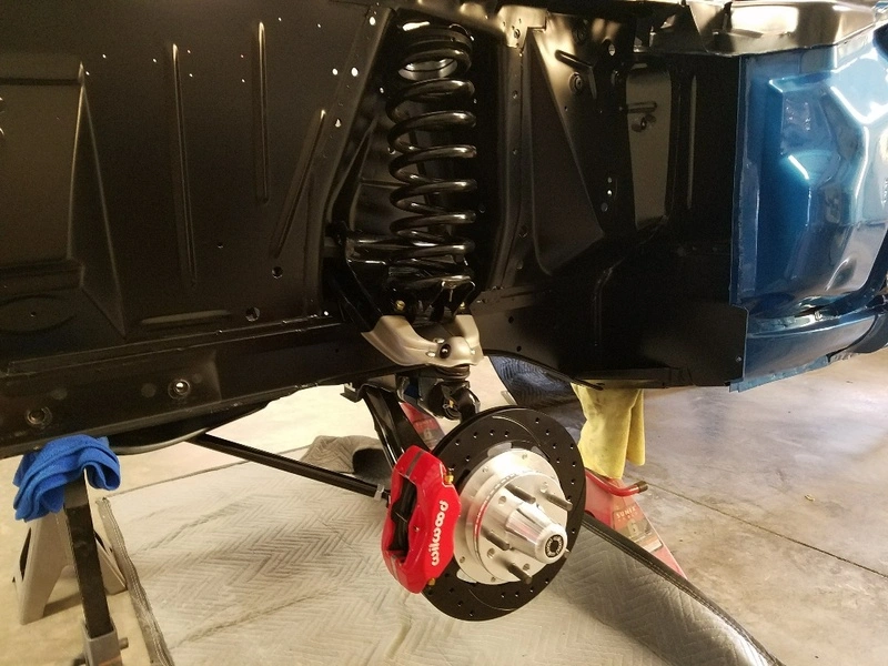

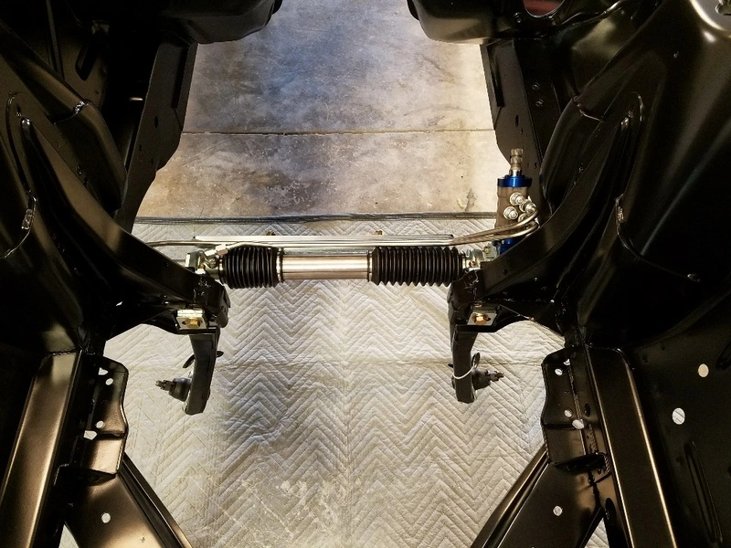

rusty428cj 10 Year Member Sep 29, 2007 943 267 104 Port Richey Fl Jun 10, 2017 #34 Jun 10, 2017 #34 Opentracker roller spring perches and suspension along with Wilwood brakes installed TCP rack and pinon Strange 9" rear Side view Reactions: horse sence
