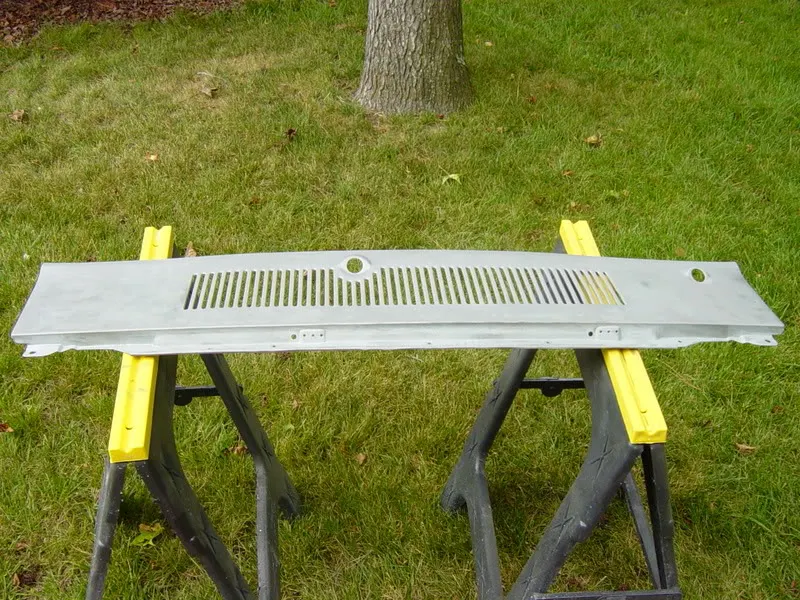

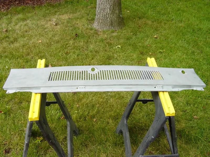

Anyone have pic of the upper cowl panel on a 1969 Mustang? The cowl, hood and front window were off the car when I bought it and I am not sure how it goes on. I bought the body manual, but it does not show how this goes on. I see there are screws in the front, but what holds on the rear by the windshield?
The rear of the cowl panel tucks under the lower windshield molding. Dense foam blocks glued to the top of the cowl support the panel. And you already know that the front edge is screwed to the body.
Here's a pic of one stripped of paint:
RacerX described it well. I need the foam blocks - does anyone sell these?
