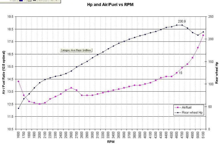

The new dyno numbers are in ! Closure at last.
Here are the results of the dyno second dyno.
I compared the dyno info from 3 weeks ago to this info. The X pipe made a huge difference. Huge. So huge, that we couldn't fully re-dyno the car. That is because the air/fuel ratio became so dangerously high that the tech stop revving the engine. The air/fuel ratio should be at 12.5 the whole time.
As a baseline, when I first had the car baseline tested 3 weeks ago, the air fuel was at 13.0 to 14.0 with a slight umbrella shape to it. Blood enterprises brought the umbrella down to 12.2 to 12.9 by changing the primary jets from 65 to 69. So 4 sizes larger brought the air/fuel down by one step. The car was in good shape air/fuel wise.
Then I found out the exhaust had a huge restriction. It wasn't the h pipe (although it would have been if not for what I am about to tell you). The tail pipe that leaves the muffler and goes over the drive shaft was bent in an elliptical fashion. It was 2.25 originally but when the bastards put it in, they smashed it. So it was seriously oval on both sides. On top of that, my exhaust tips are only 2" diameter. And the h pipe didn't help either. The whole exhaust was f--up.
The x-pipe is beautiful. I had him install flanges so I can take it out when I do the trans. And he used 2.5". It looks huge compared to what was there. And the car is a little louder now.
Anyway, you will notice on "combined" tab of the EXCEL sheet (see JPG attached), that the air fuel starts out fine but then gradually gets leaner from 2100 RPM to 2600 RPM. This should be the primary jets being too small AGAIN ! I probably will make them 2 to 4 sizes larger (71 to 73). Now that the engine can move a proper amount of air, it is! And the fuel cannot keep up.
Next, the secondaries kick in and initially richen up the air/fuel from 2700 to 3000 RPM but then the air starts flowing so fast that the jets cannot keep up and the engine goes lean. By 4300 the car is dangerously lean. By 4600 engine damage could occur and the car is struggling to make power due to lack of fuel. By 4900 the car is simply giving up and trying to prevent piston oblivion. The tuner said the #68 jets in the secondary should be 75 (75, that is a huge jump), but if it were his car he would make them 80 (not sure why). He said richer is better than leaner due to piston damage vs fuel economy. I have to agree, but I don't want the car so rich that it looses power.
So I need to change primary jets up 2 to 4 or secondaries up 6 to 8 sizes. I thought that if I make the primaries up 3, then I would only have to raise the secondaries up by 5.
What do all you think? Alot of info, but that is what is fun about it.
Ryno...
Oh, the car made 235 hp. vs 202 previously and there should be another 25hp according to the tech when the jets are proper.
