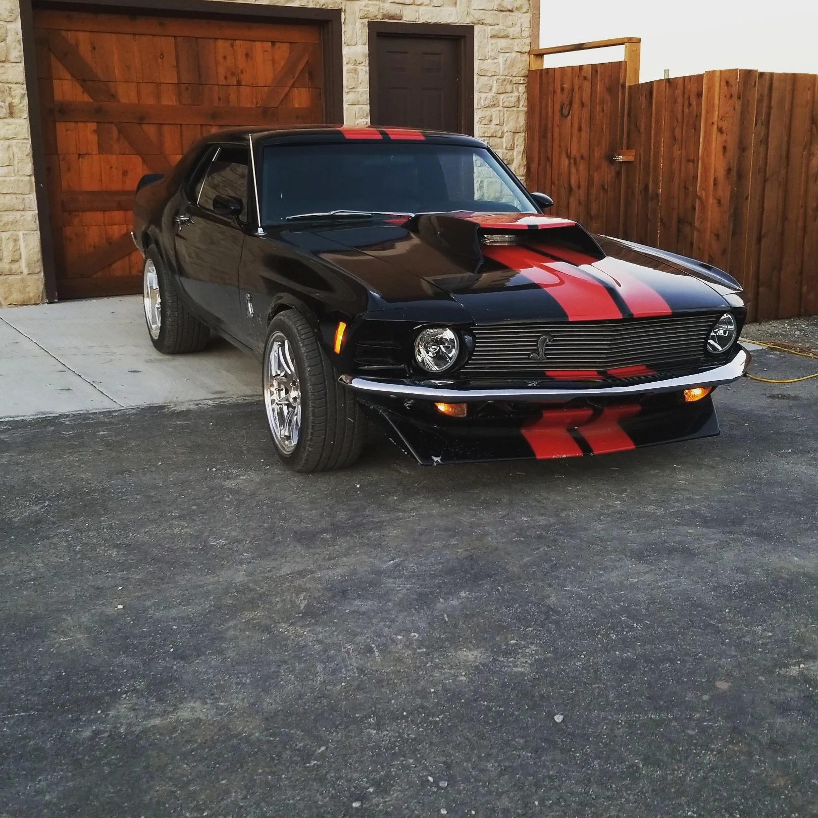

Having trouble with steering column wiring, thinking of changing column out for more modern one or a flaming river one. What do u guy recommend aftermarket wise??
I got a 429 thunderjet, c6 auto, electric fans disc brakes all around, rack and pinion all new painless wiring
