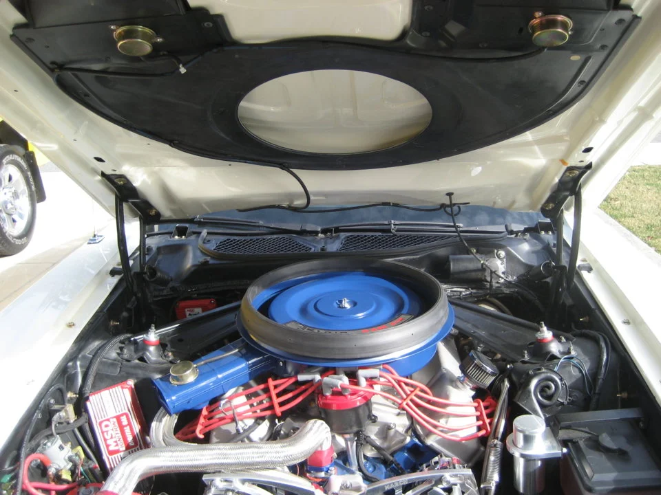

I also just got done converting the motor to a functional Ram Air system. It's more of a cool factor and really doesn't do anything for performance.
