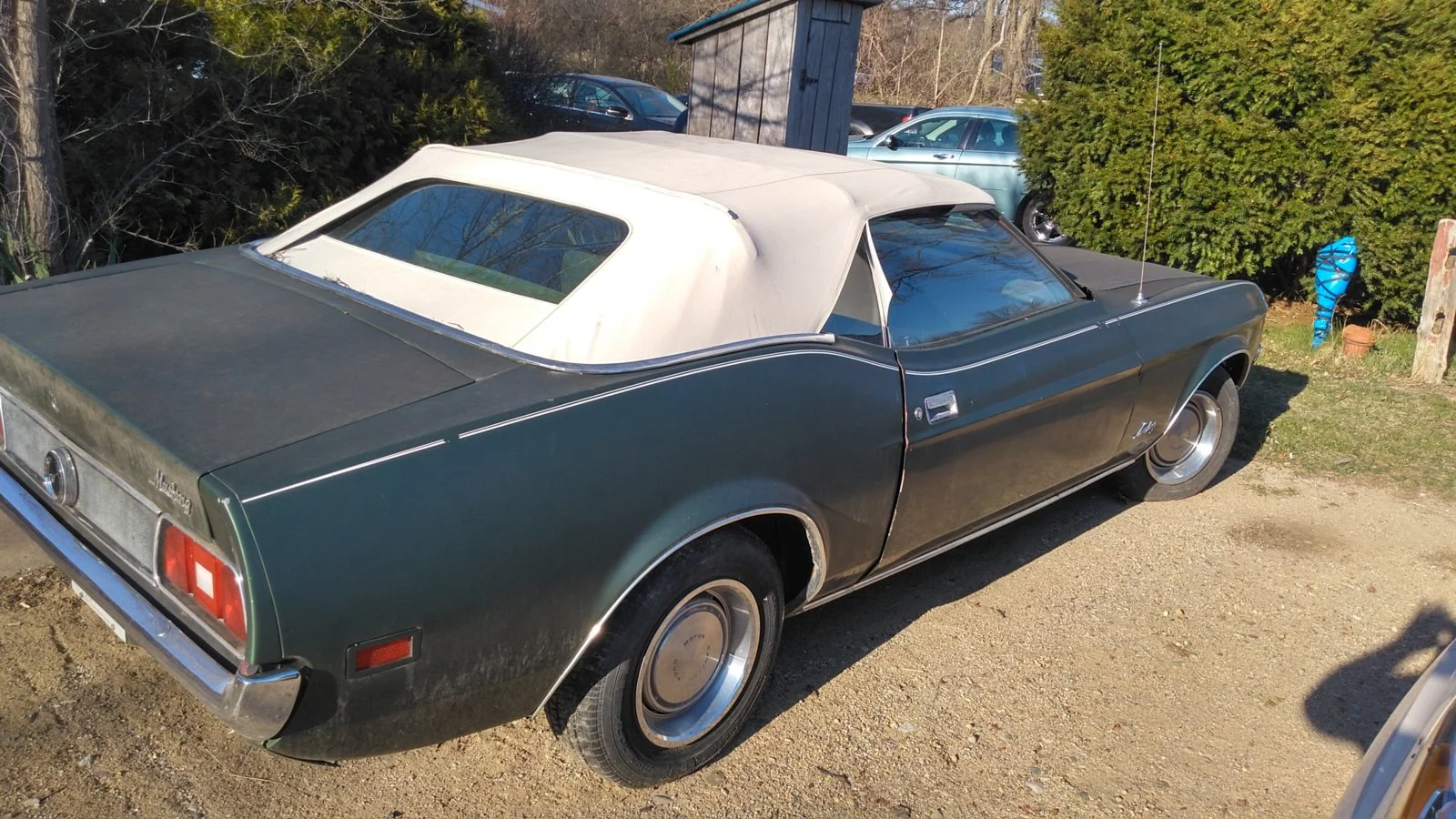

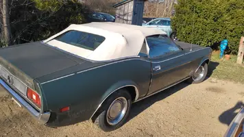

Hi all. I've owned a few mustangs over the years, all Fox bodies. I have the opportunity to purchase a '72 convertible (302, automatic) that is essentially rust-free in the body with badly faded paint, but the floor pans are rusted quite badly. The car runs well, appears to be stock. I am an RN and travel all over, currently in NJ, home state of Mi, so don't have time or ability/knowledge to do rust repair work myself. It is a southern car that sat in the dun a long while. Should I consider this car to be made into a weekend driver for my wife, or would i be best to run (from car, not wife....most days)?
Attached picture I took this afternoon. Wife saw this car and really liked it's look, but I don't know much about them. Thanks all. Sorry for the long post.

I did a full floor on a 73 i used a new 69 floor ,a little different but worked fine , they are coming out with new sheetmetal all the time and they do have some for the 71 73 now . I would look it over well ,especially the frame rails . My mom drove a 73 Mach 1 as a daily driver for several years
Reactions: 2Blue2
^^^^get it on a lift and check everything you can touch/scrape with an awl/screwdriver to see the extent of the rust...if in the frame rails, etc...skip it.
((Personally, after dealing with a '76 Ranchero with rusted out floor pans (Nebraska car), I walk away if the floors are gone...too many other lurking issues)).

Rust is gunna be the biggest issue as with any classic. water gets it and sits in the floor boards. i replaced my floor boards years back and its alot of work. mine was my moms daily driver from the mid 80s to mid 90's, after i got it it was mine through HS and college. i can tell you the biggest improvements from me as a daily were the suspension, power disc brakes and the A/C if its hot where you live. as for power if you dont need alot, dont bother with the motor if you dont have to cause once you get the power bug, its hard to stop. just keep it reliable.
