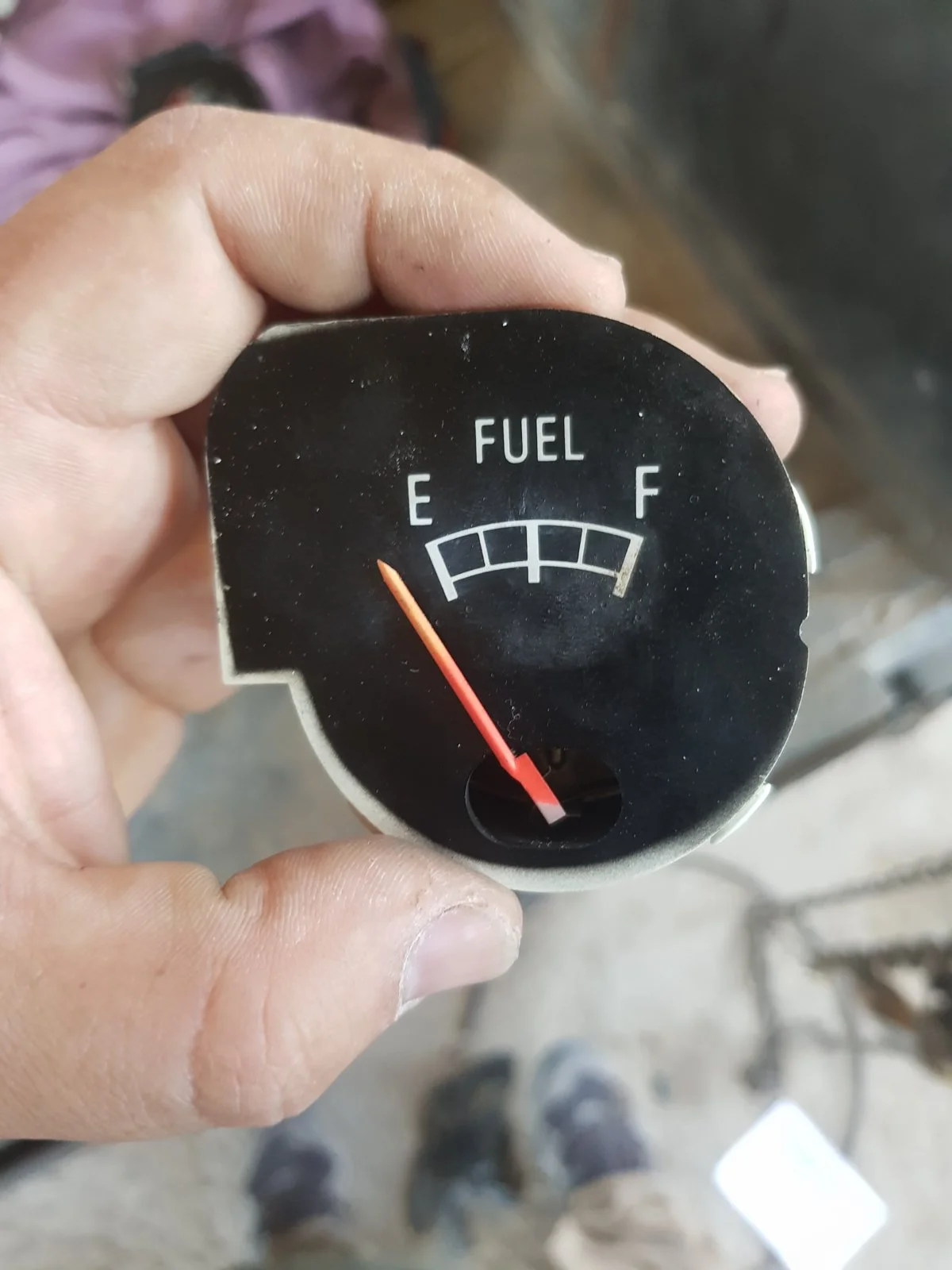

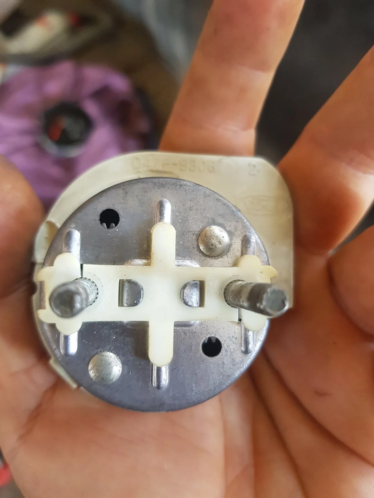

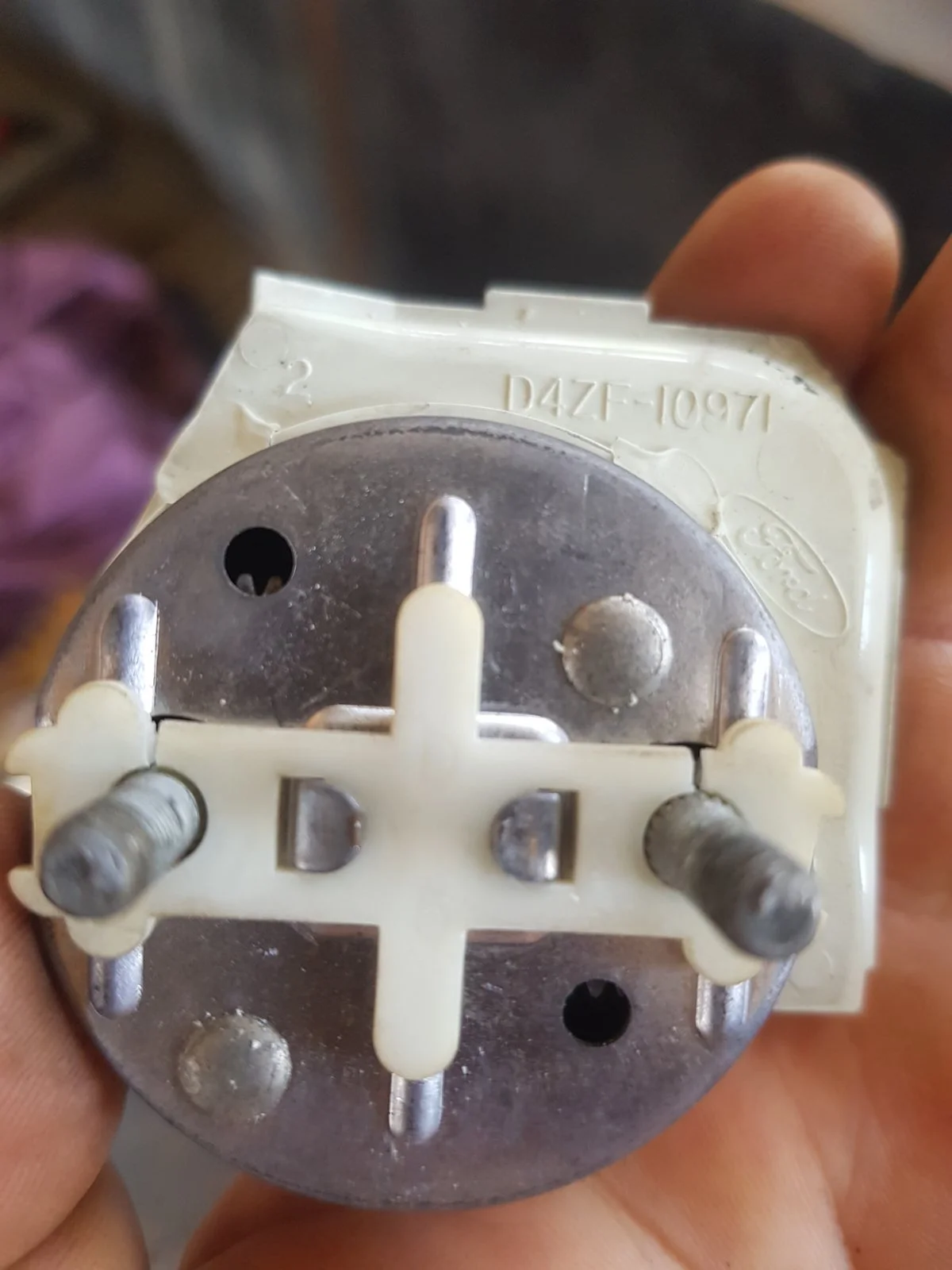

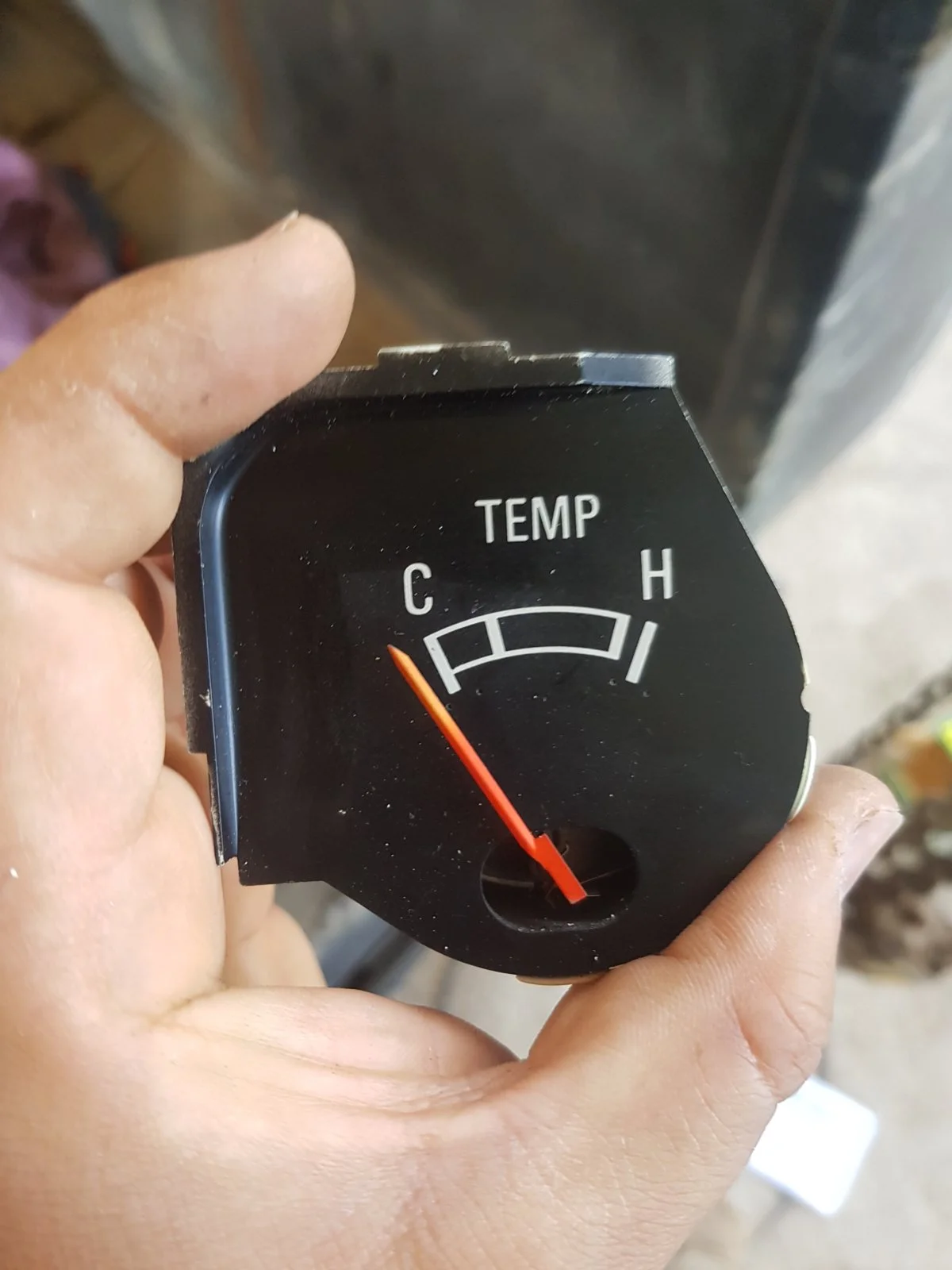

hello there friends, how are you?
its me again with some new problems... i already try to find the information on the internet, but nothing... so here i am, hope you can help me.
Attached the pictures from all the gauges that my ford uses, the question its.... HOW ITS THE WIRING !! how i conect this?? they dont have any pin or any cable conector...
Thanks for your help!

The studs coming out of the back of the gauges are actually the electrical connections. In the stock gauge cluster housing, nuts go on those which make contact with the flexible printed circuit when they're attached. You'll notice that white plastic insulator piece keeps the studs from shorting to the housing.
Hello there! thanks for your answer, but im trying to conect them direct with wire... im not from the USA, so find the flexible printed circuit its gonna be hard... that why im looking any way to wire it.
