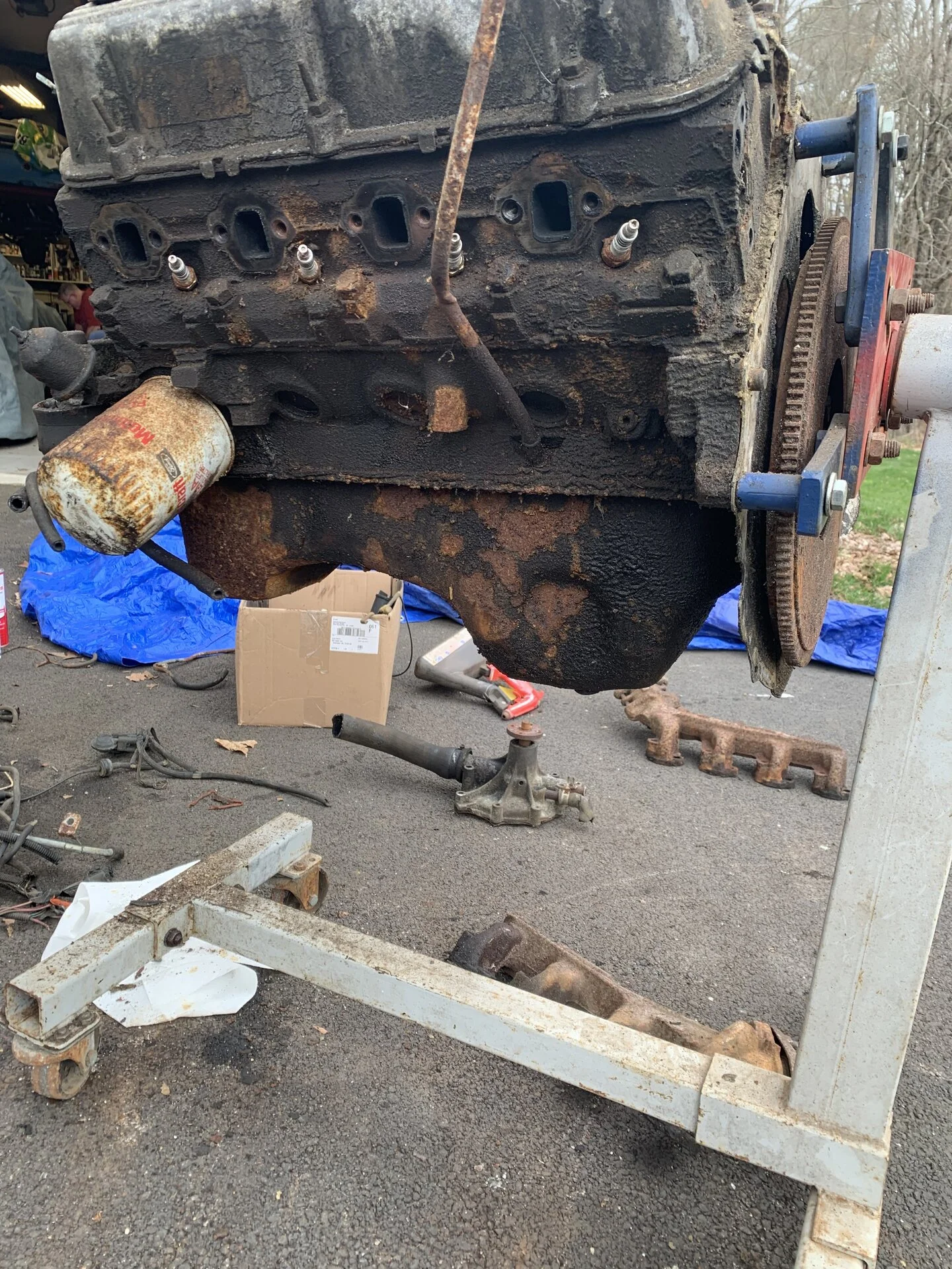

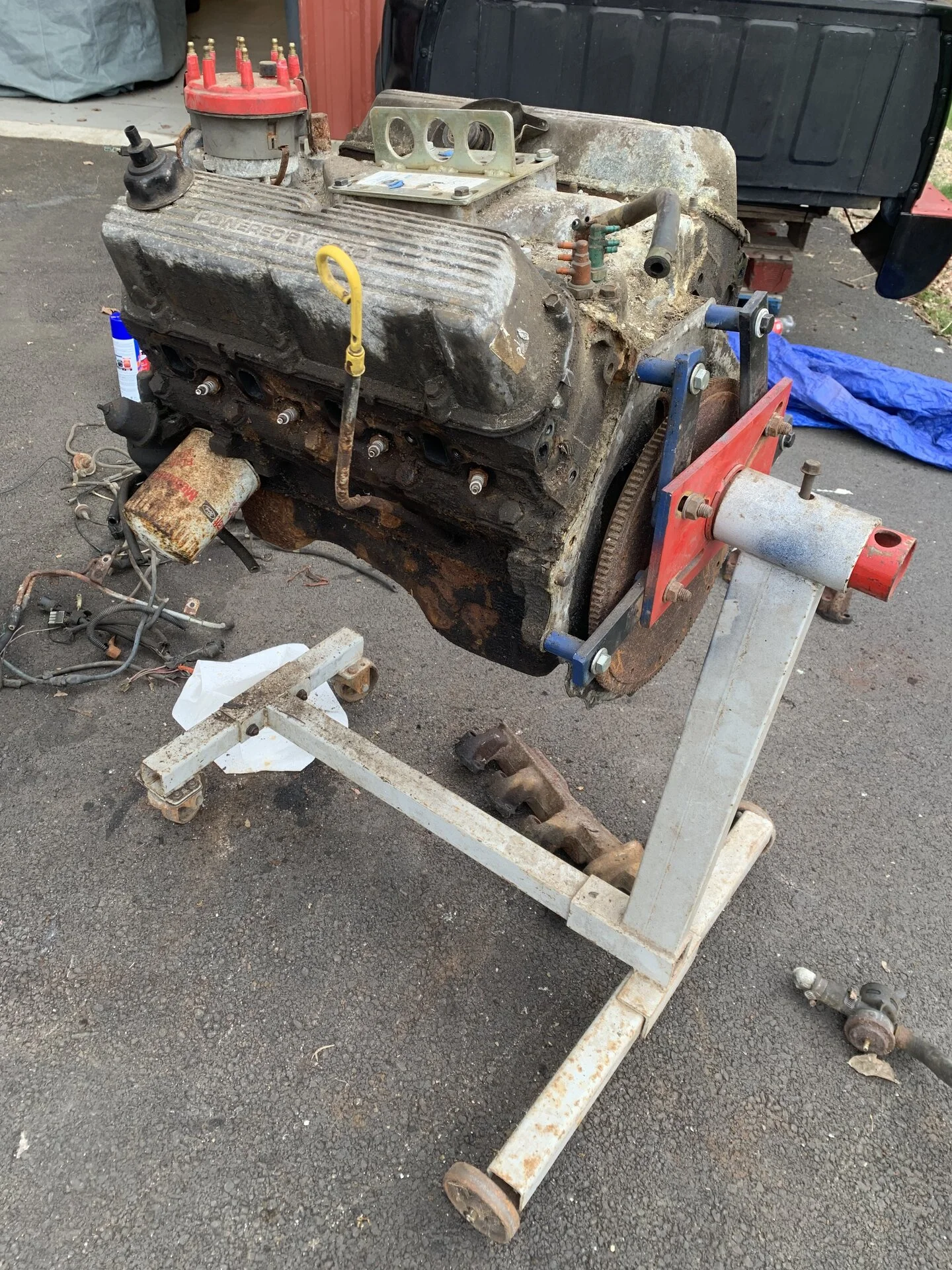

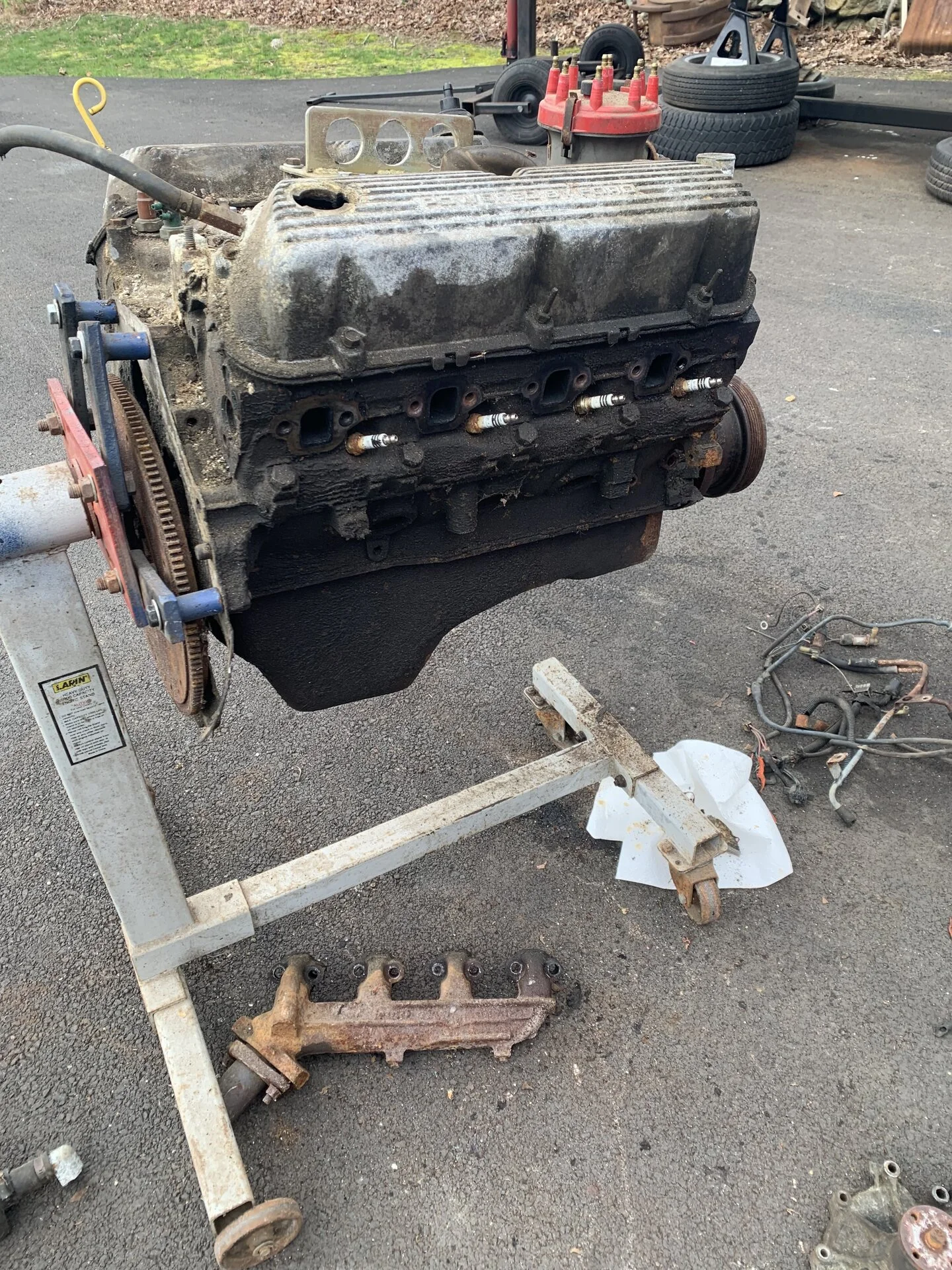

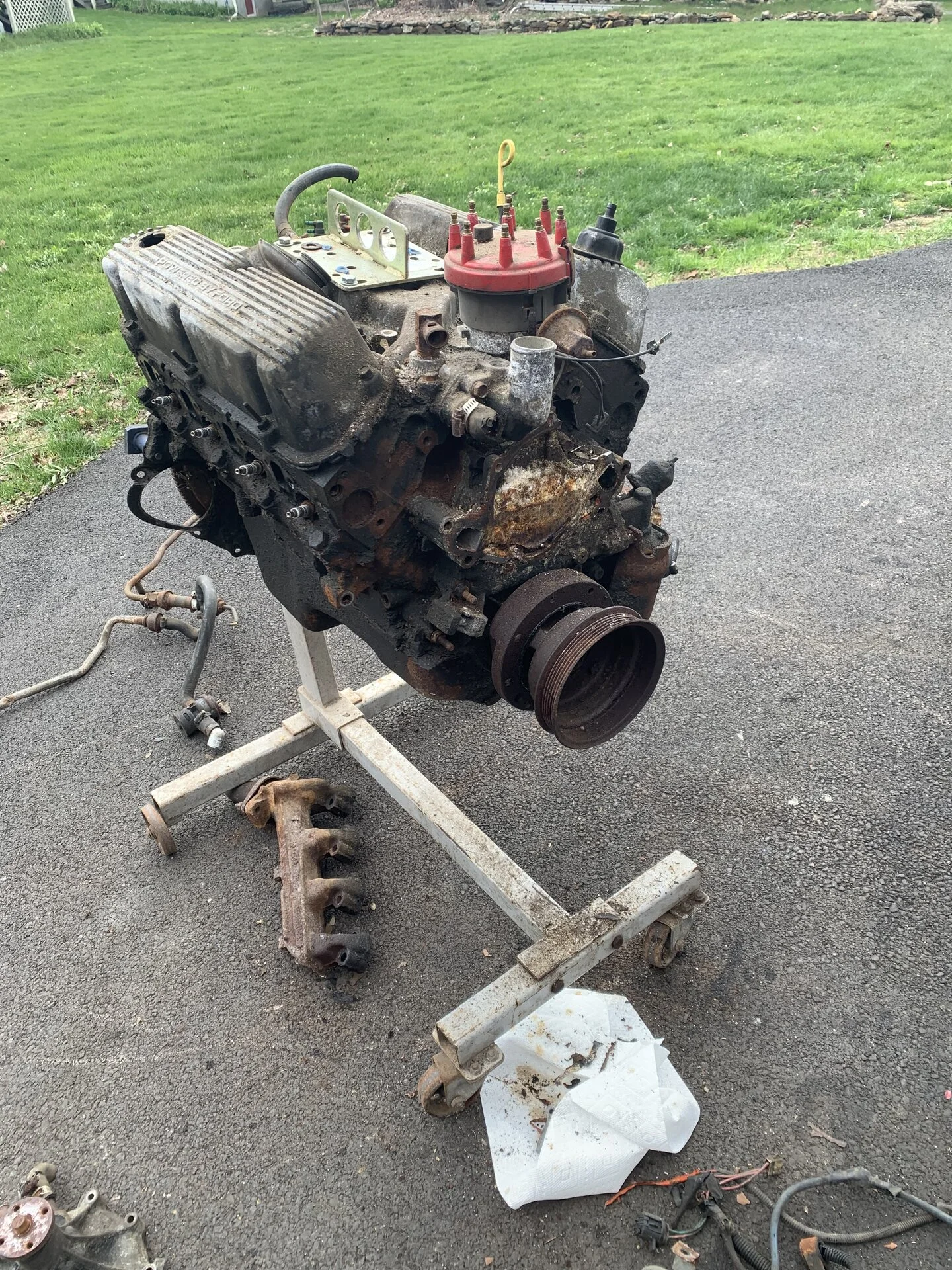

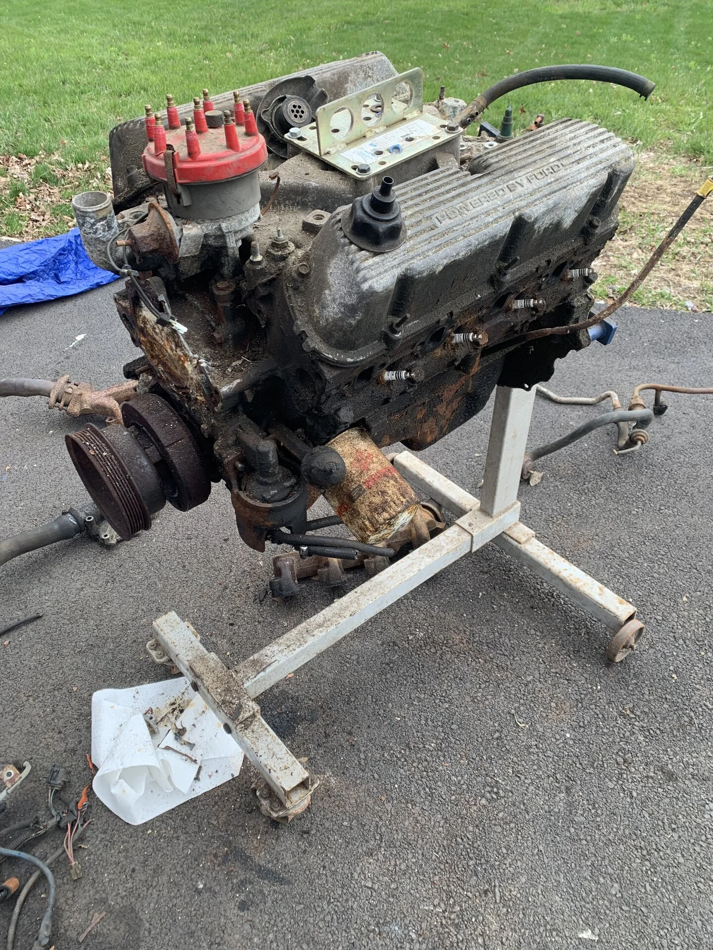

Still waiting for AFR motor. I decided to just throw in a 302 I pulled out of an 83 in 2019. Here are some pics.

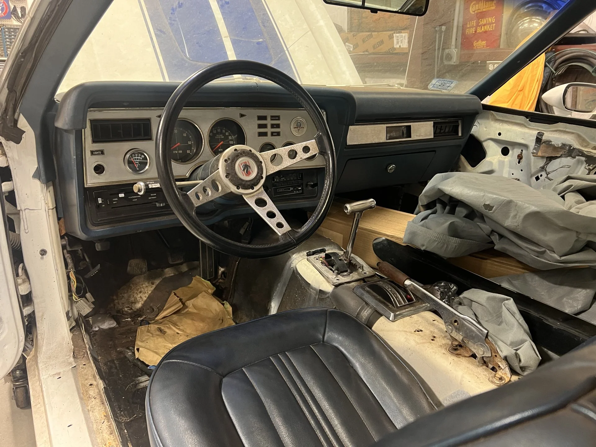

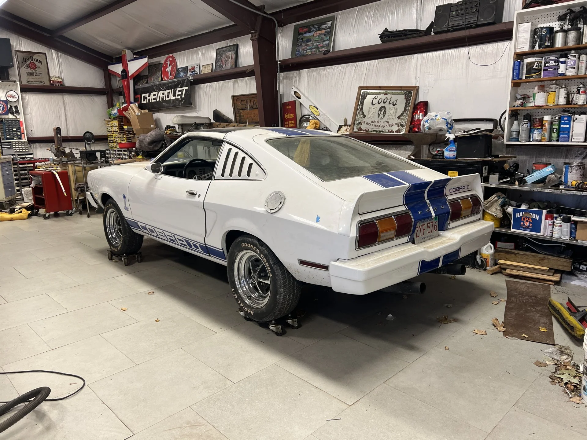

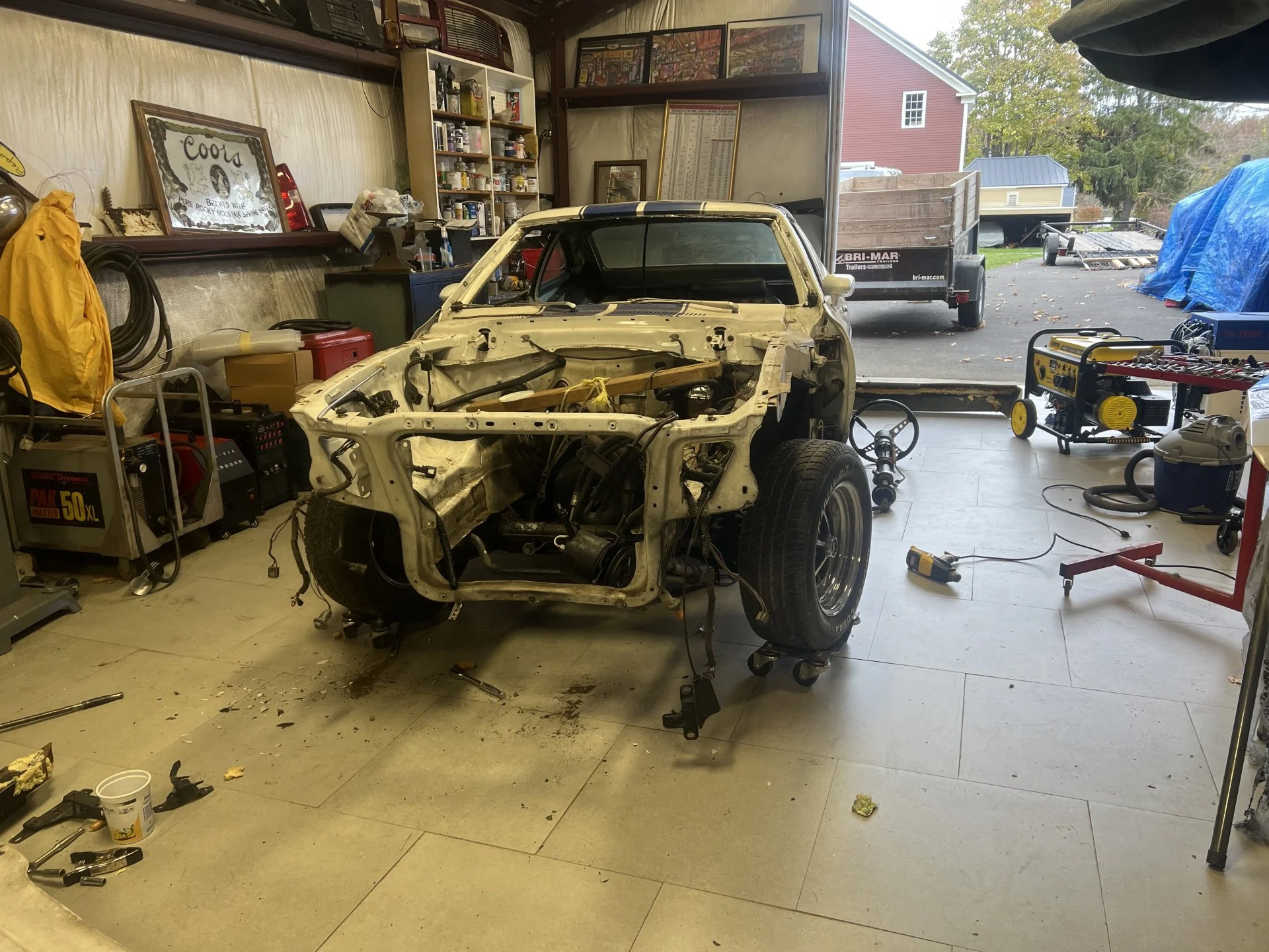

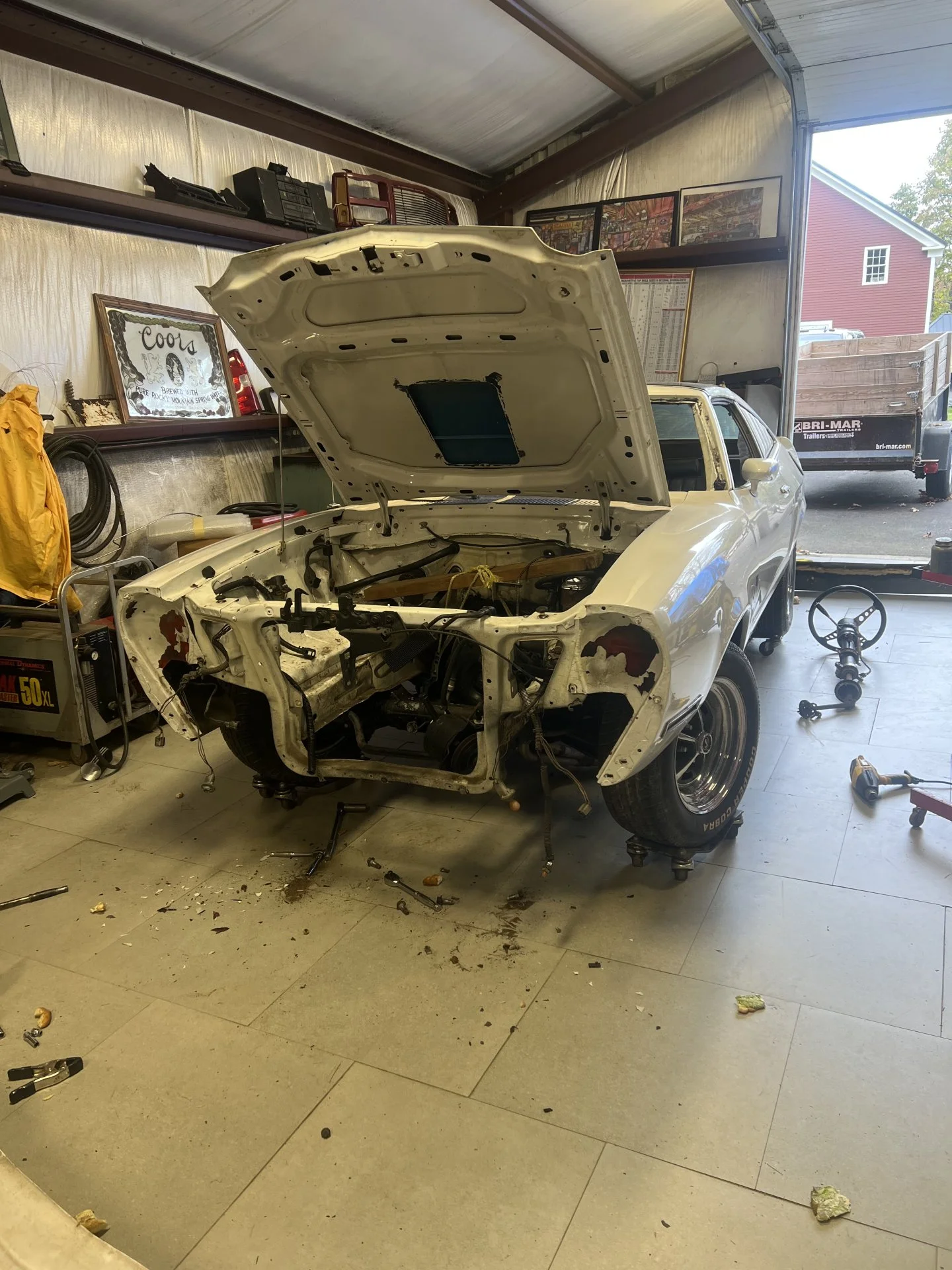

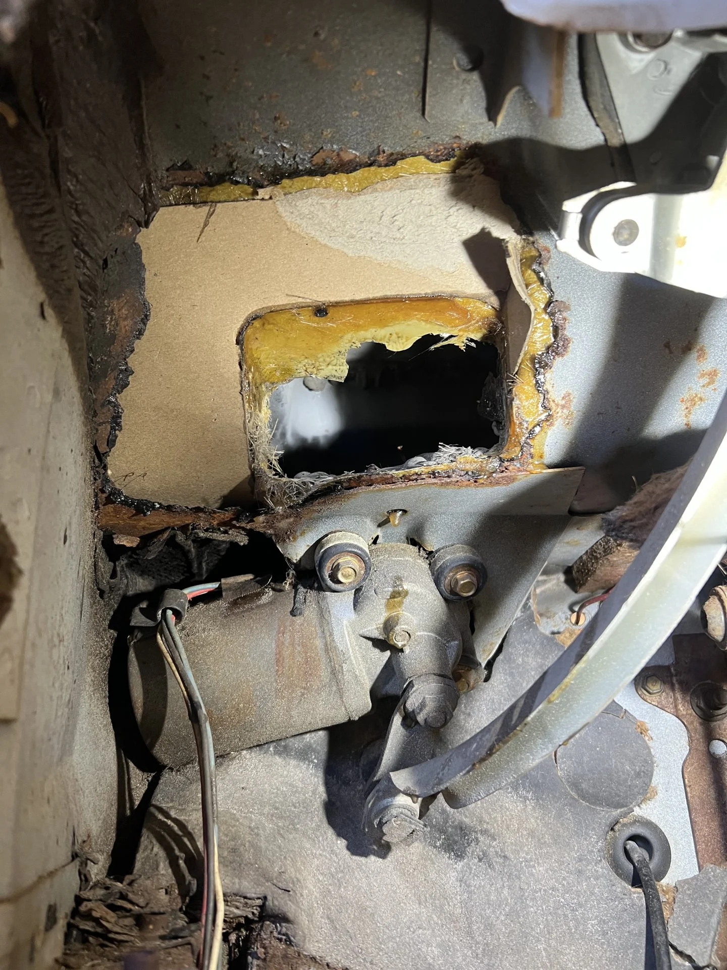

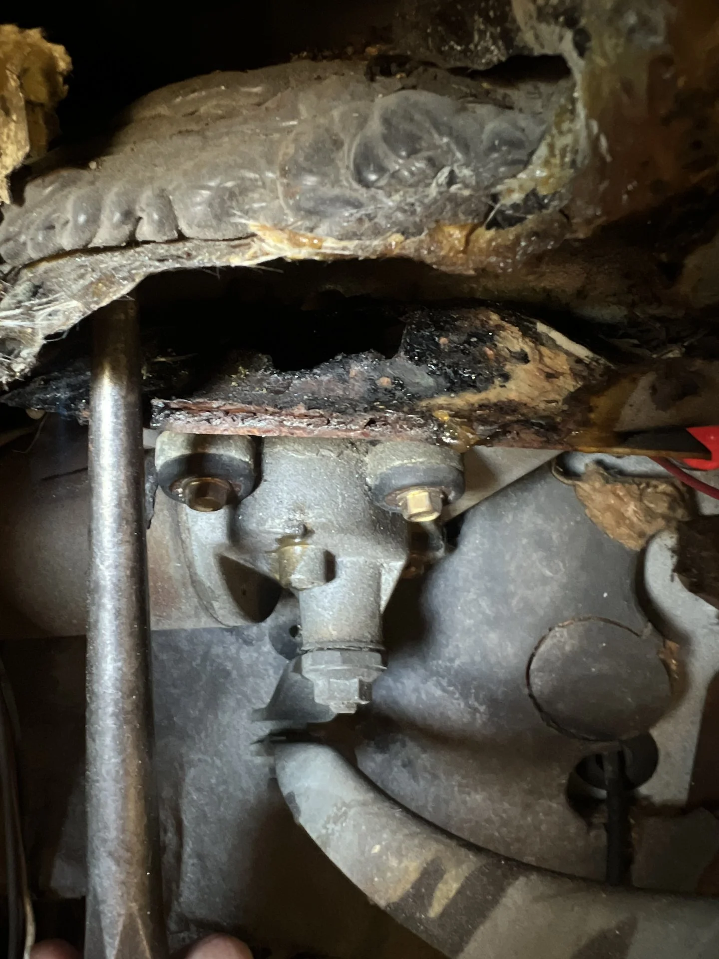

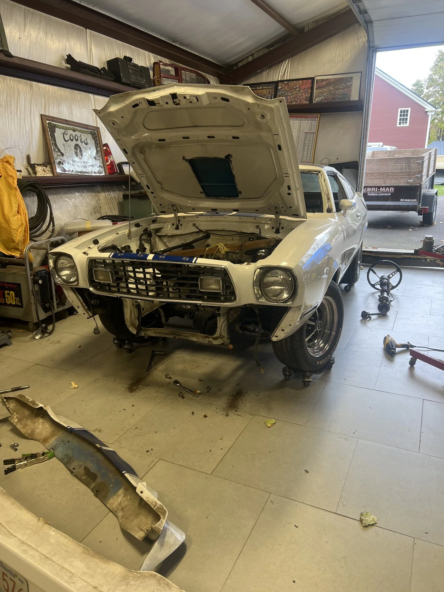

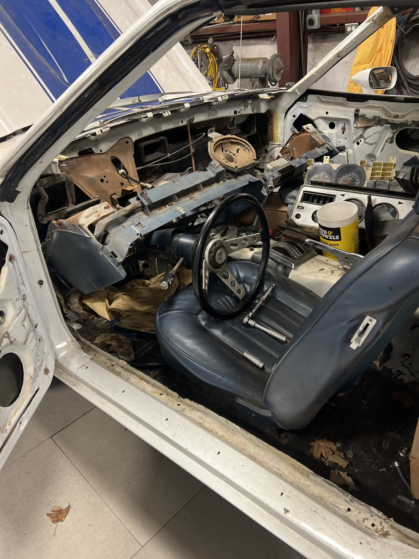

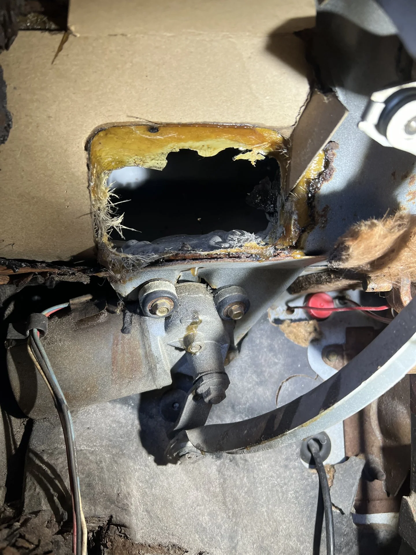

So this is the update. This car was hacked. Both bumper were held on with spray foam. I peeled them off. I dropped the dash to get a better look at the cowl. The vent was glued in. Once I pulled it out this is what I found. A crap repair from the 80's with fiberglass. The fiberglasss rotted the entire area it was covering making the cowl worse. After looking under I found a large crooked seam where they cut the top plate of the cowl off and bondoed it back on. The top plate of the cowl is just now and the bottom is much worse than I expected. When Pulling the front end I went to drop the C-6. Come to find out the crossmember under it was welded in. So I had to jack it up and cut the crossmember out from the bottom of the car hoping the C-6 would rattle or roll off the jack. The firewall was bashed with a sledge to fit the C-6 and headers. This must have been done with the dash in the car as when I took it out it was cracked to pieces. Then looking at my taillpipes I found another surprise. The entire exhaust was run completely under the car and welded solid to the car at 4 points. I could push a tailpipe and the car would move with it. After cutting those out I took a look at the rear end. When they installed the 9 inch they didn't change the leaf spring mounts on whatever rear they used. Installed they cranked all the bolts which torqued the leaf springs sideways blowing out all the bushings. I then spent about 6 hours round trip driving to the closest Junkyard that had a Mustang II near me to find out they never looked at the cowl and it was junk.
