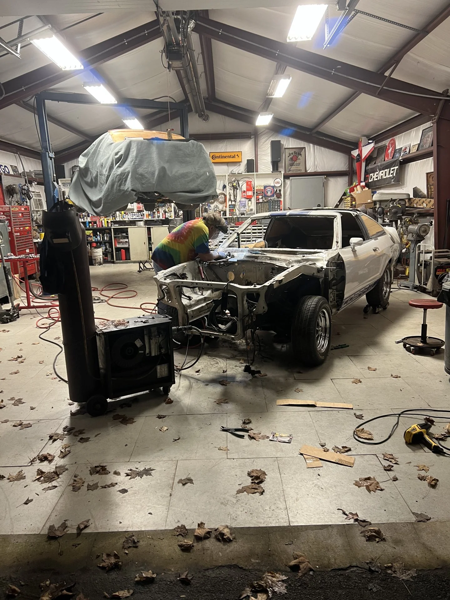

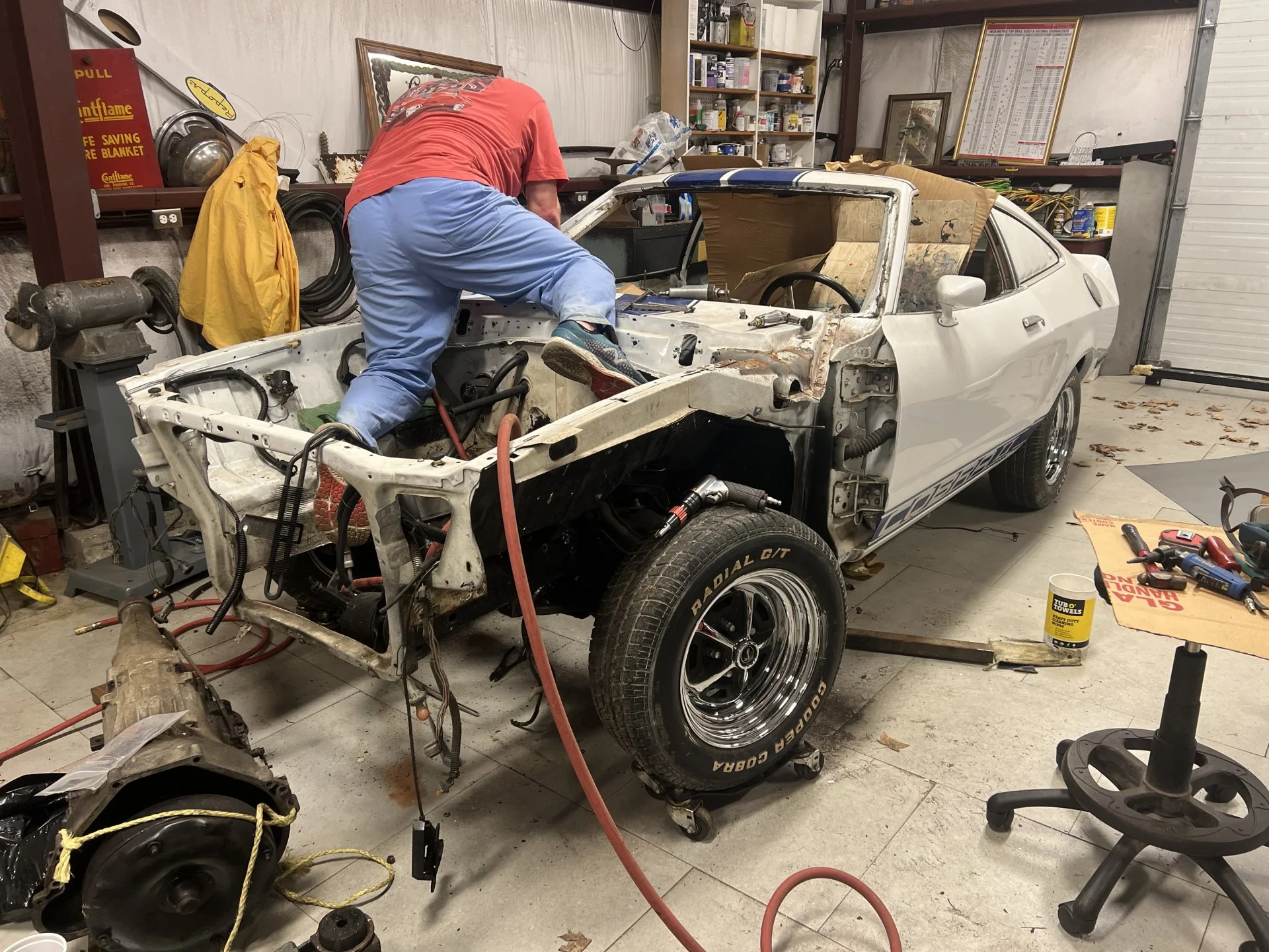

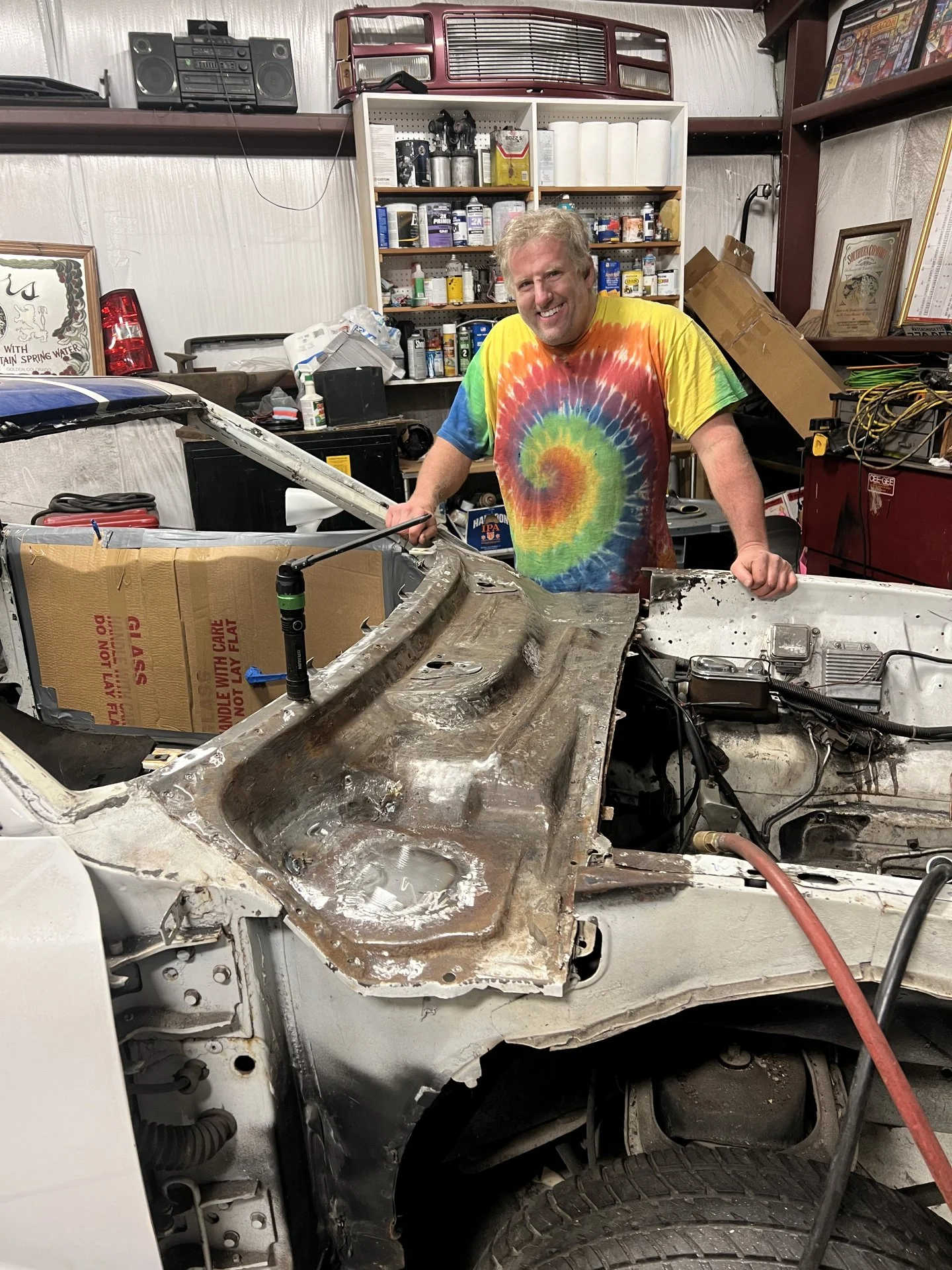

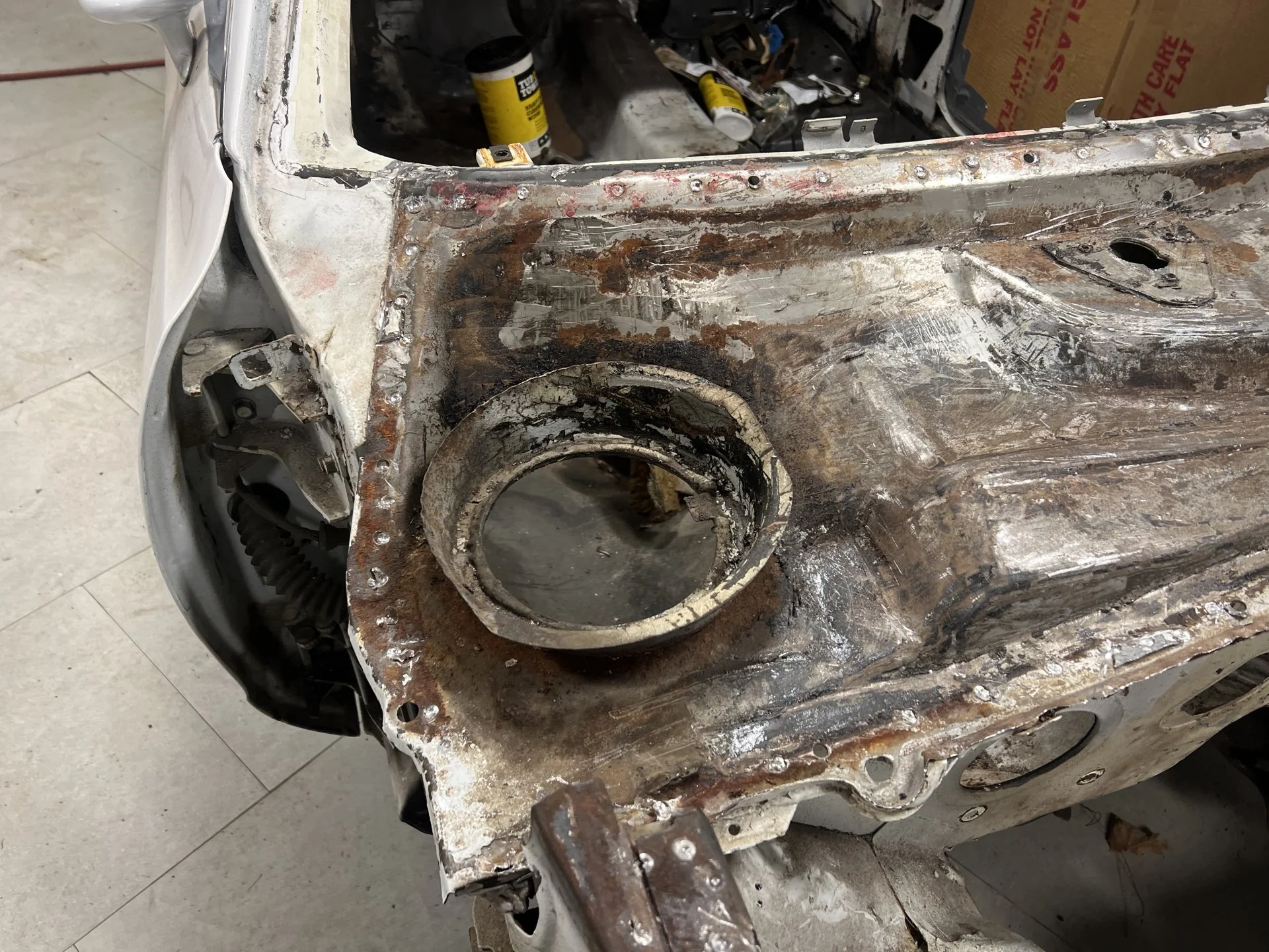

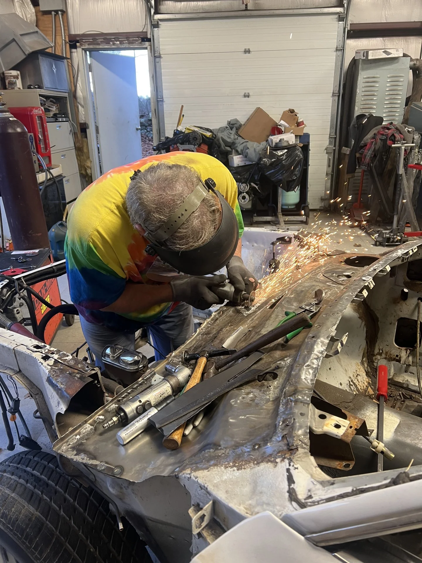

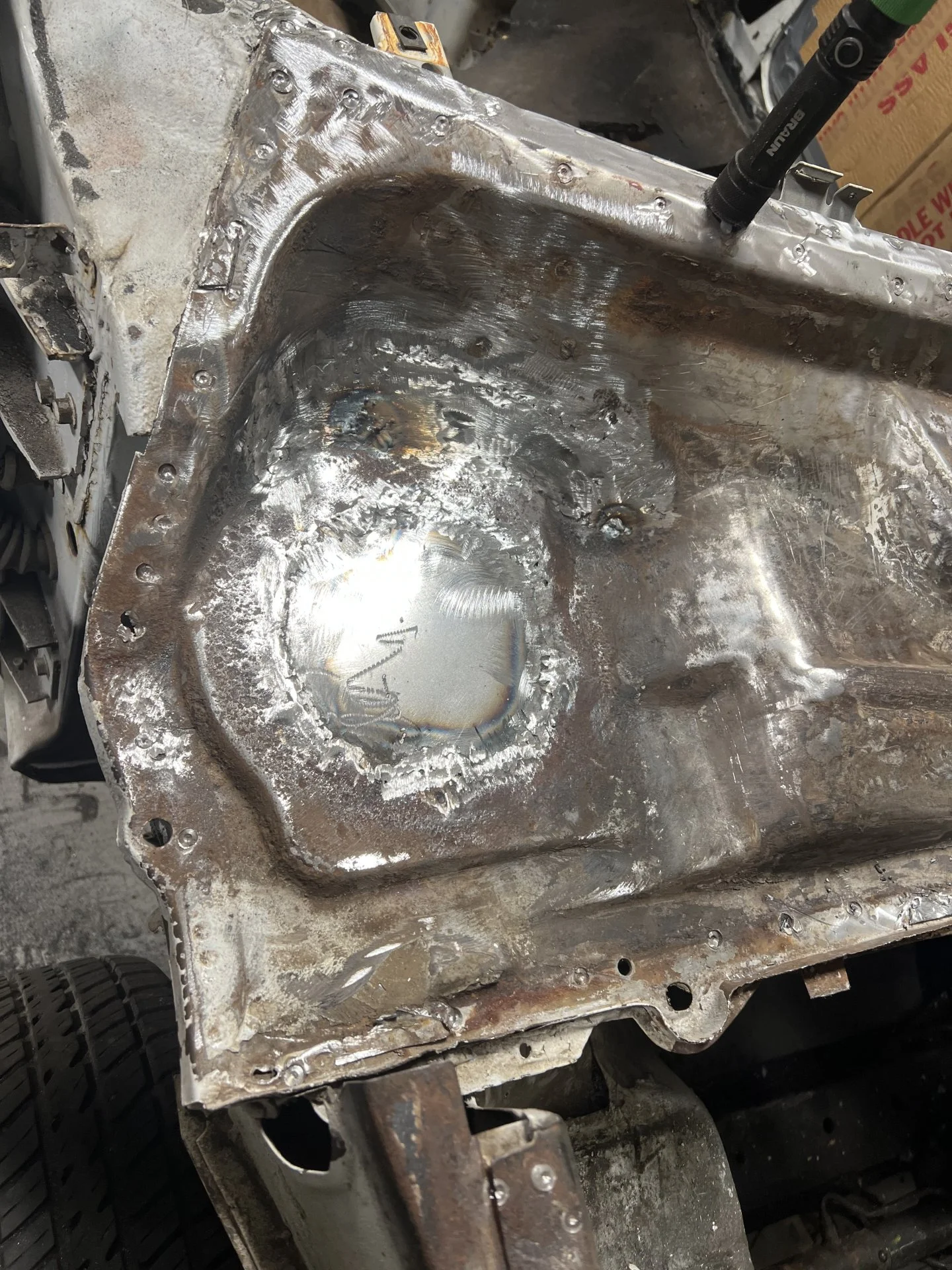

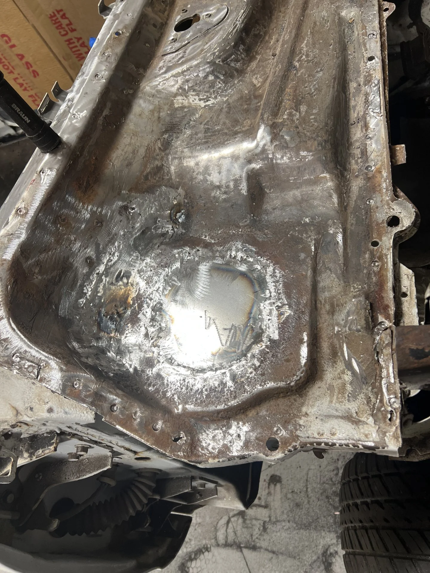

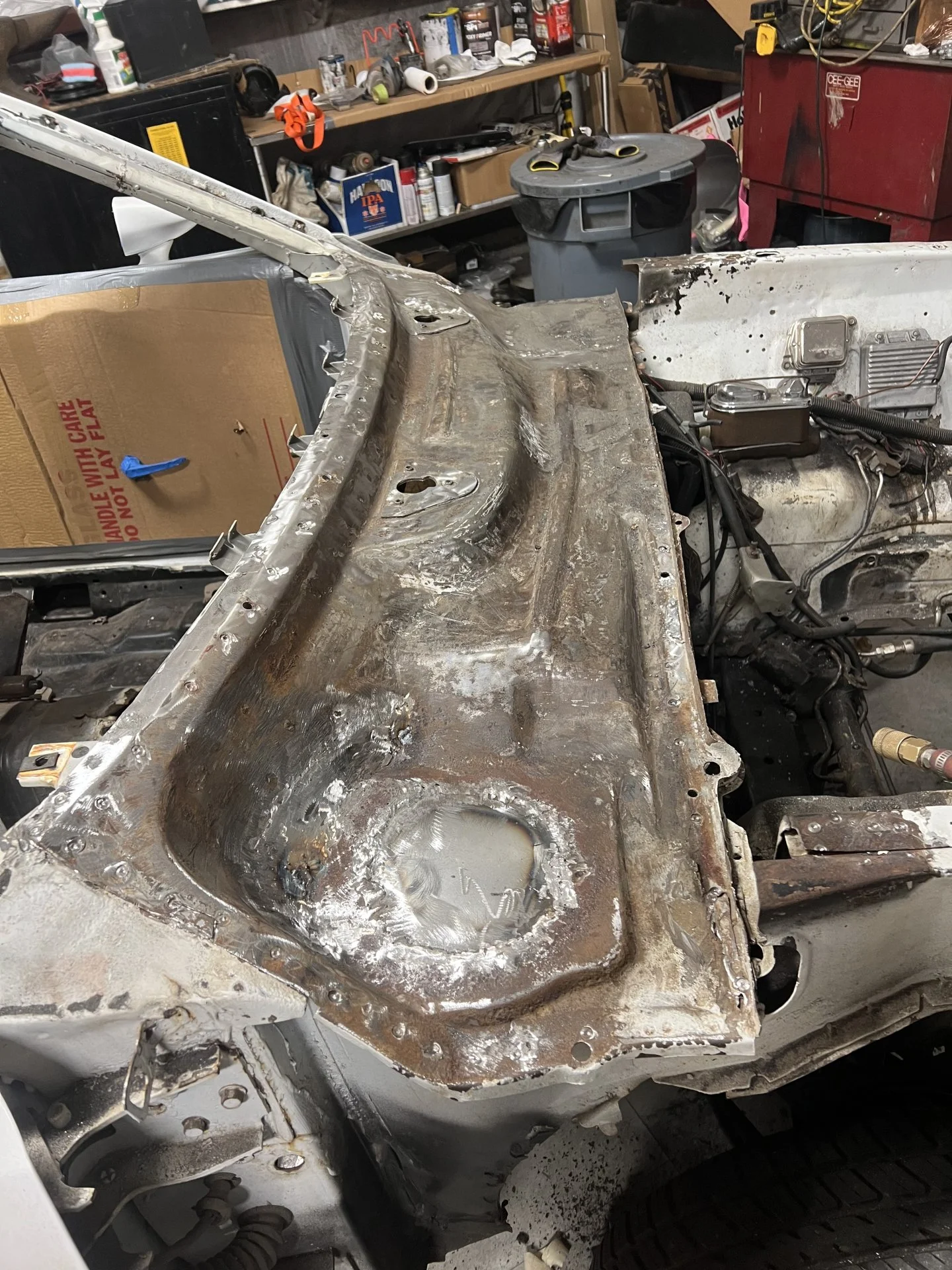

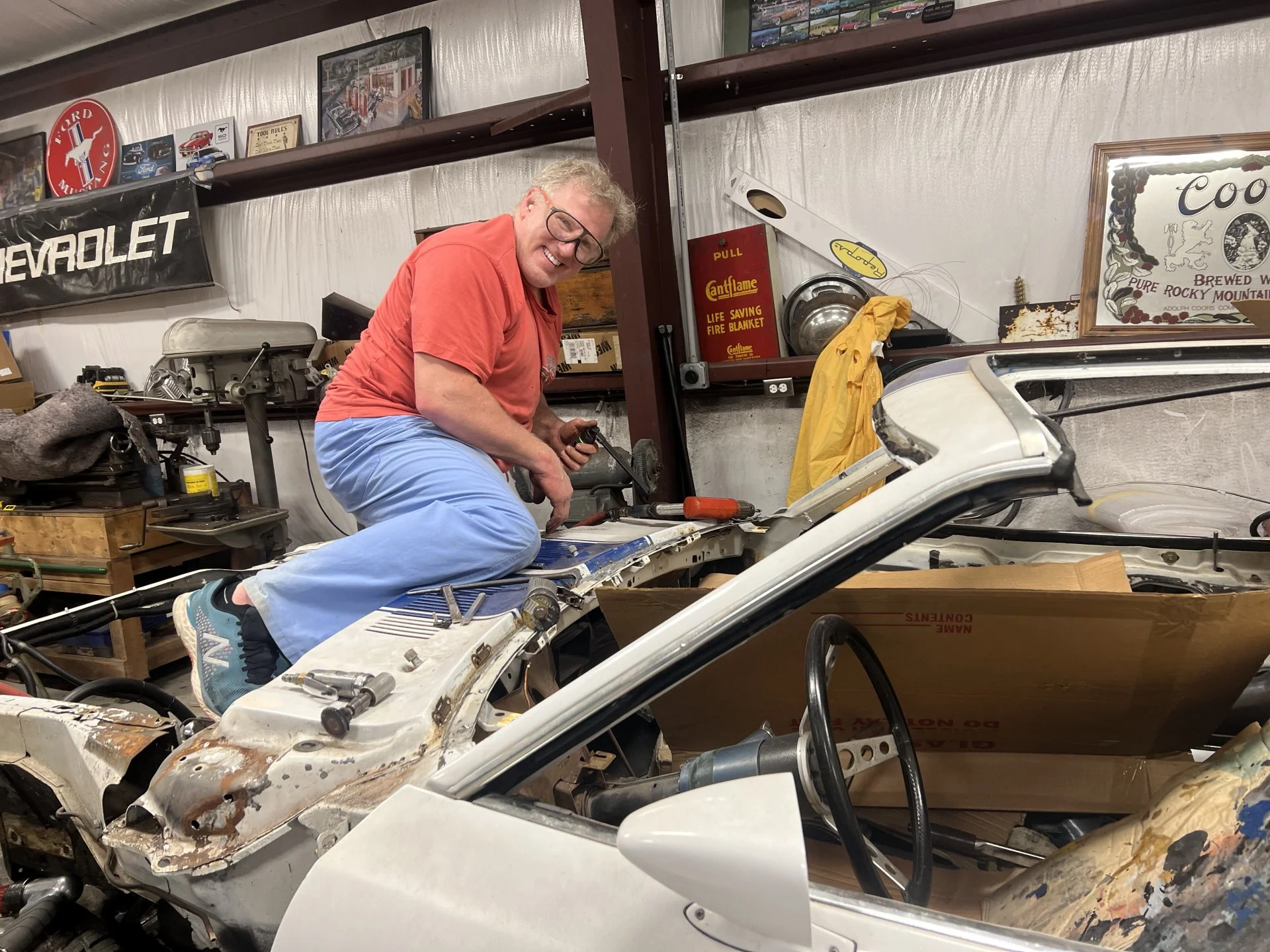

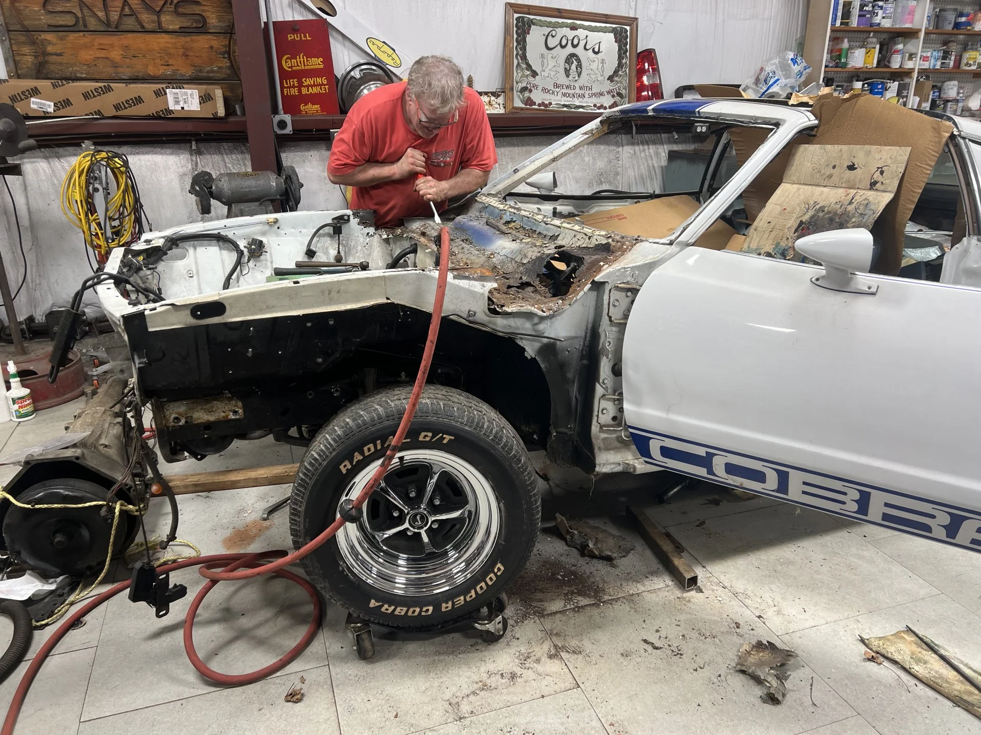

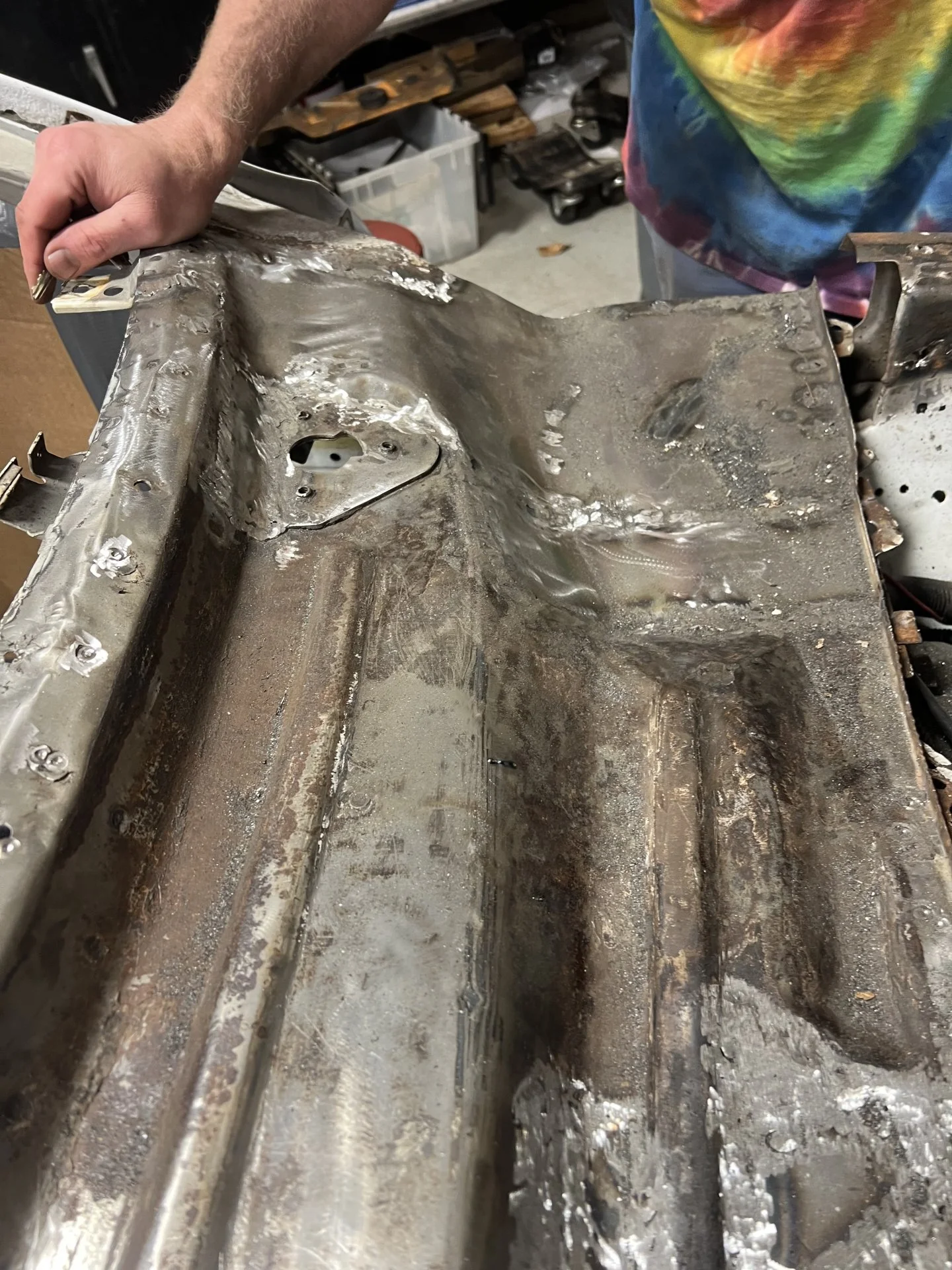

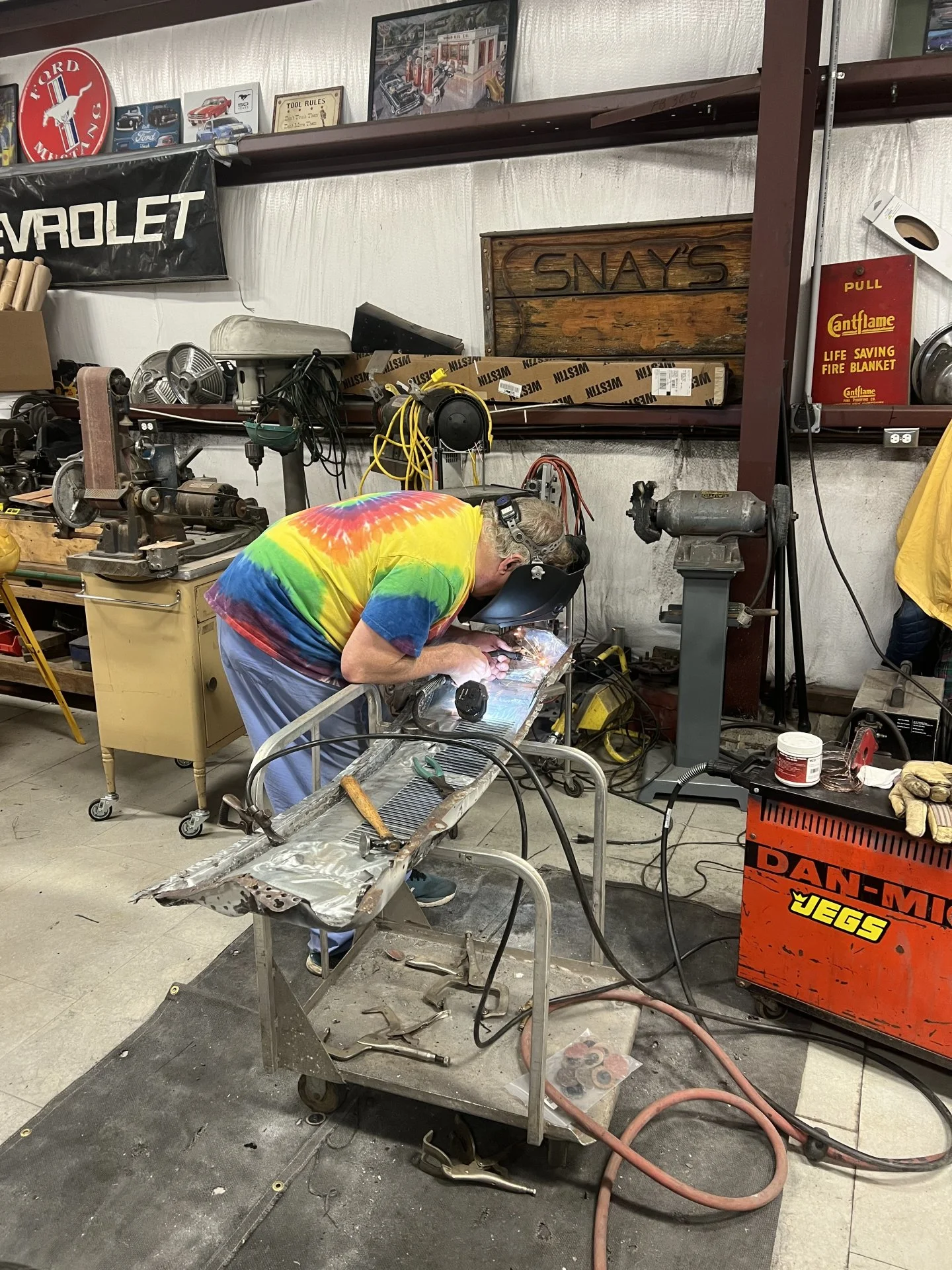

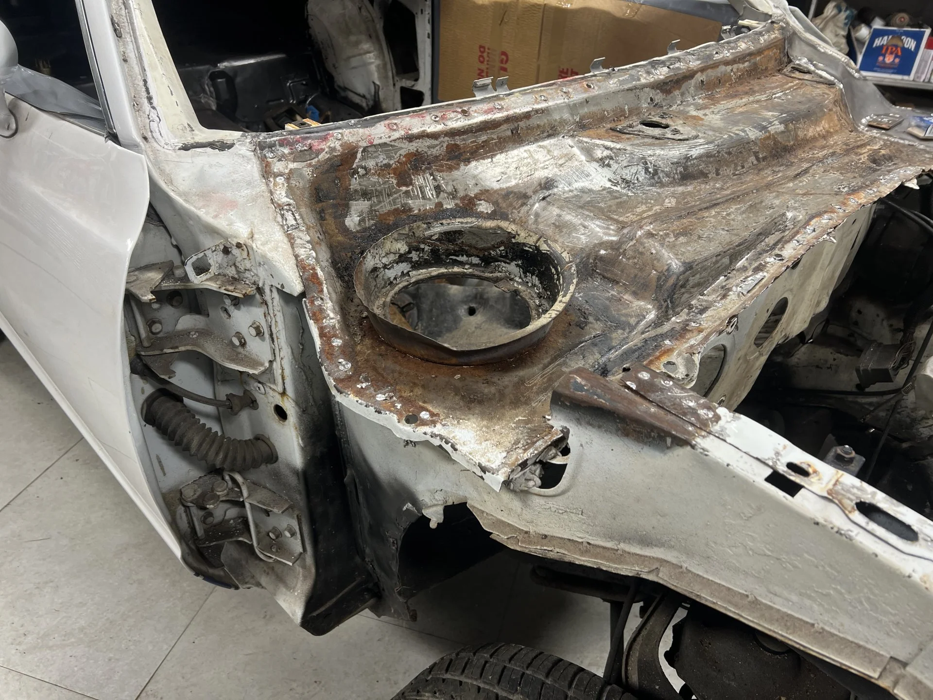

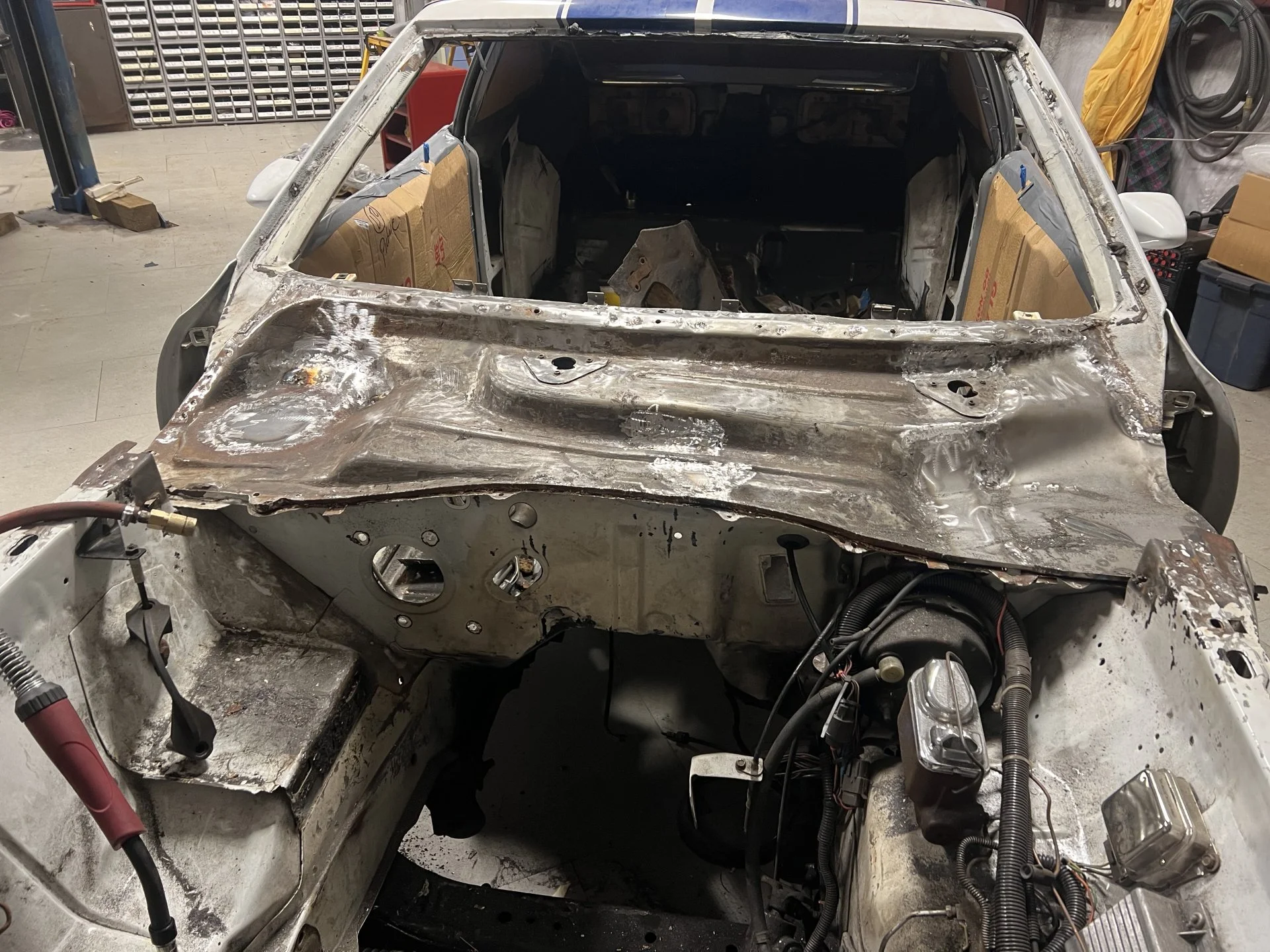

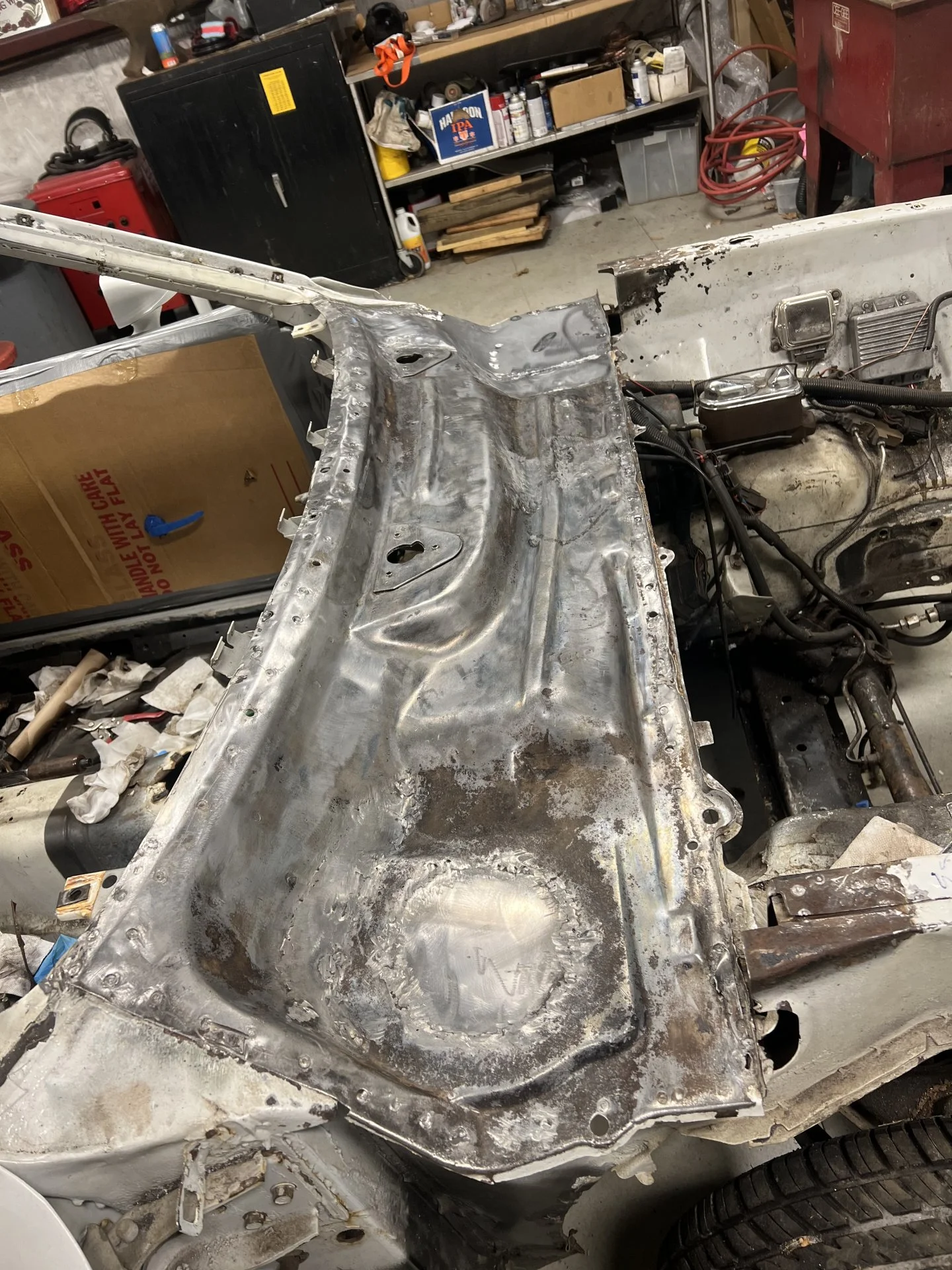

Cowl is apart. Patch is made. Will be welding patch in tomorrow. This was me and my dad working on it today.

Wow look at that cowl getting peeled open!
Getting after it for sure!
Were you able to save the windshield?
Is the spot welded flange intack or does it need patching too?
Will you be able to seal up the back side?
Doesn’t attach to A .pillers right?
Can we have more pictures? including back sides of both upper and lower cowl?
Dads the Man! helping out on this! Old Guys Rule!
I’m gonna get to do this. but hard to do with engine in I bet.
Step Right Up.
Guess the number of drilled spot welds and win a prize;
I Guess 108.
Reactions: IICrew

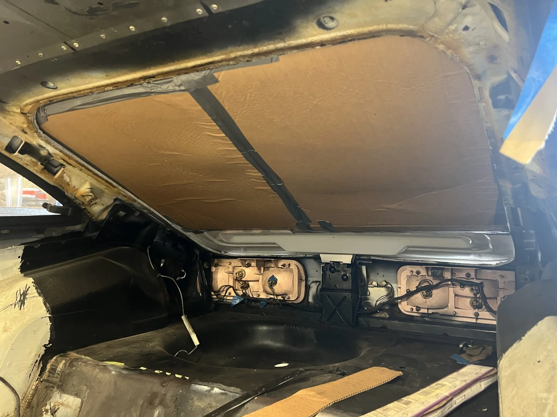

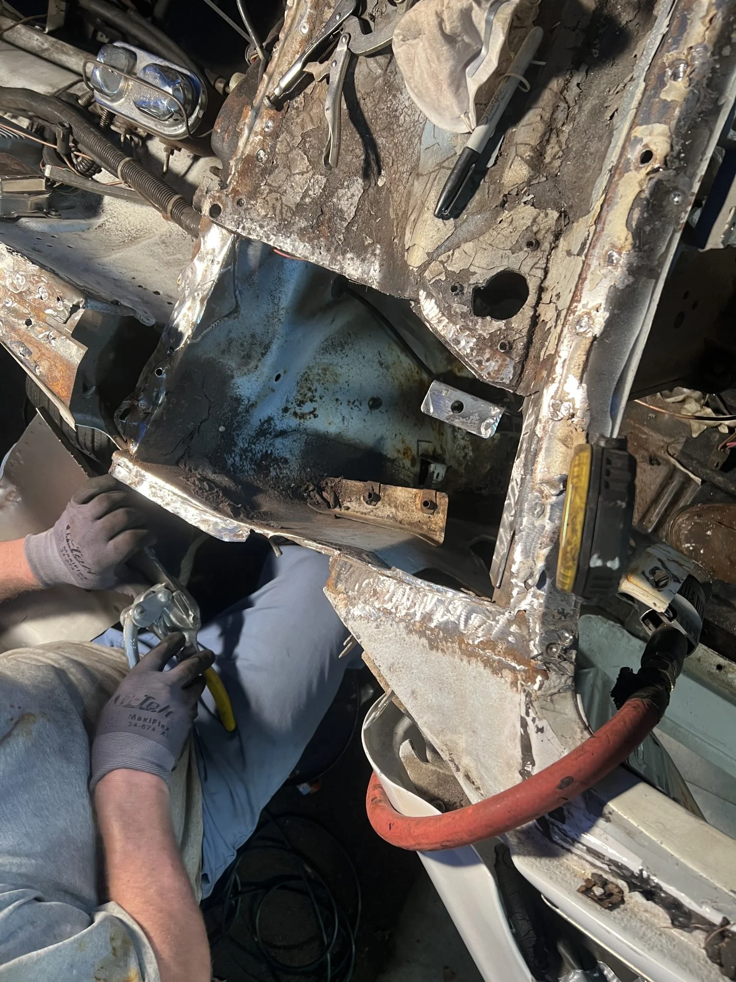

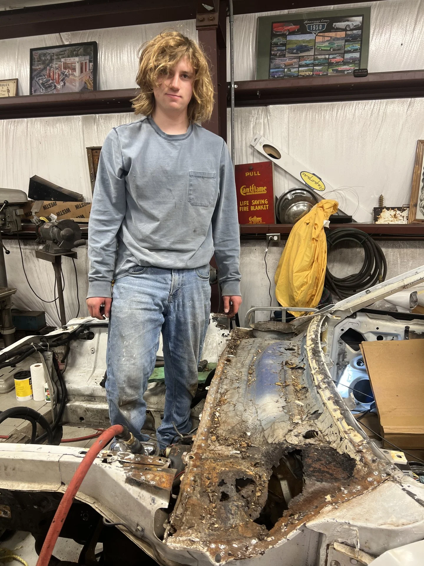

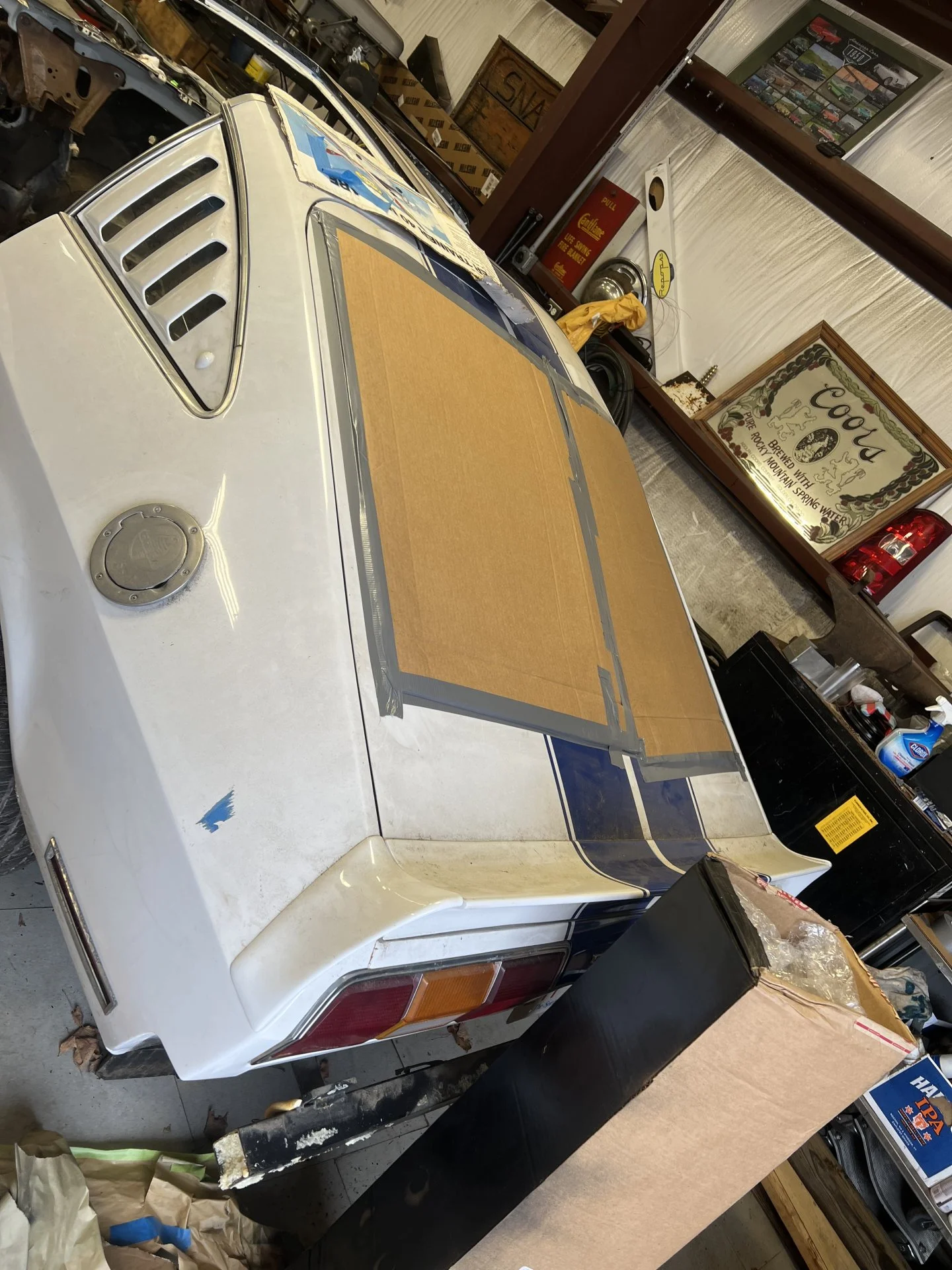

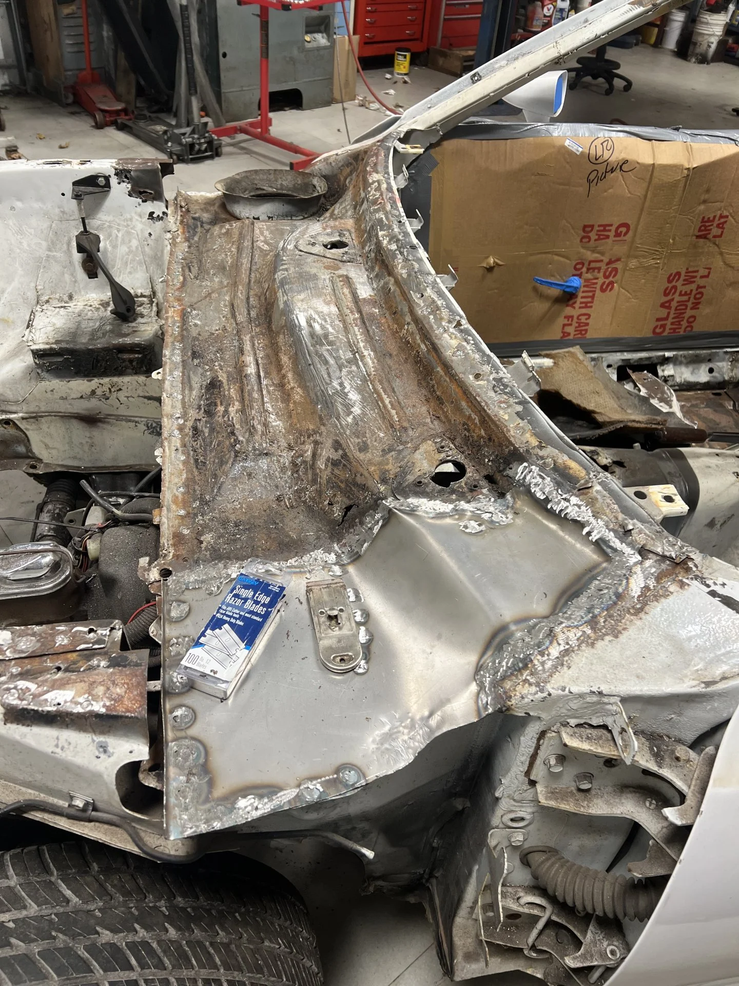

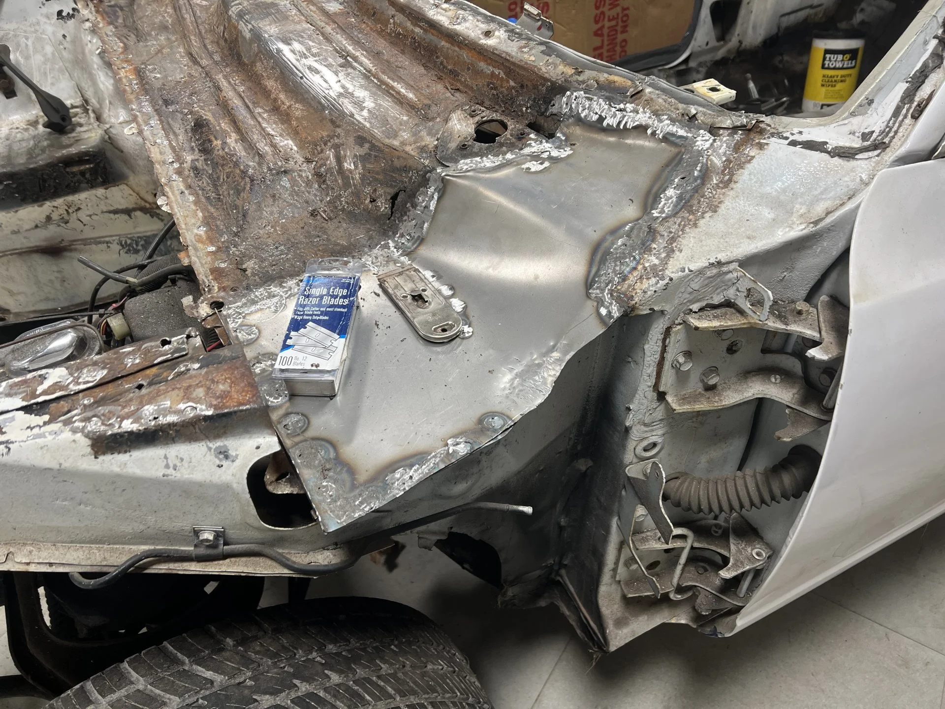

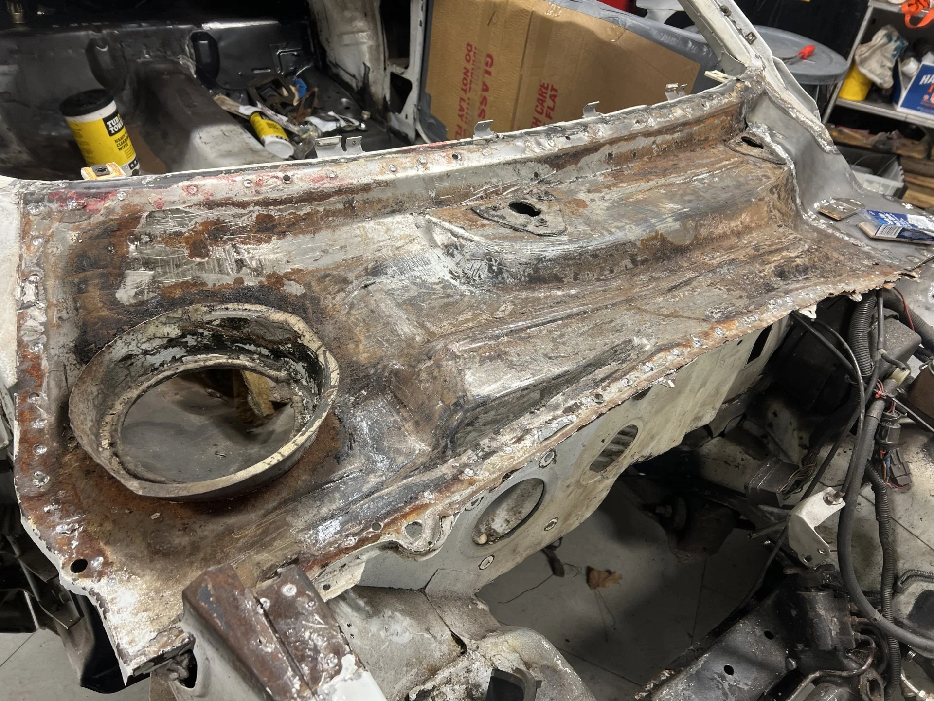

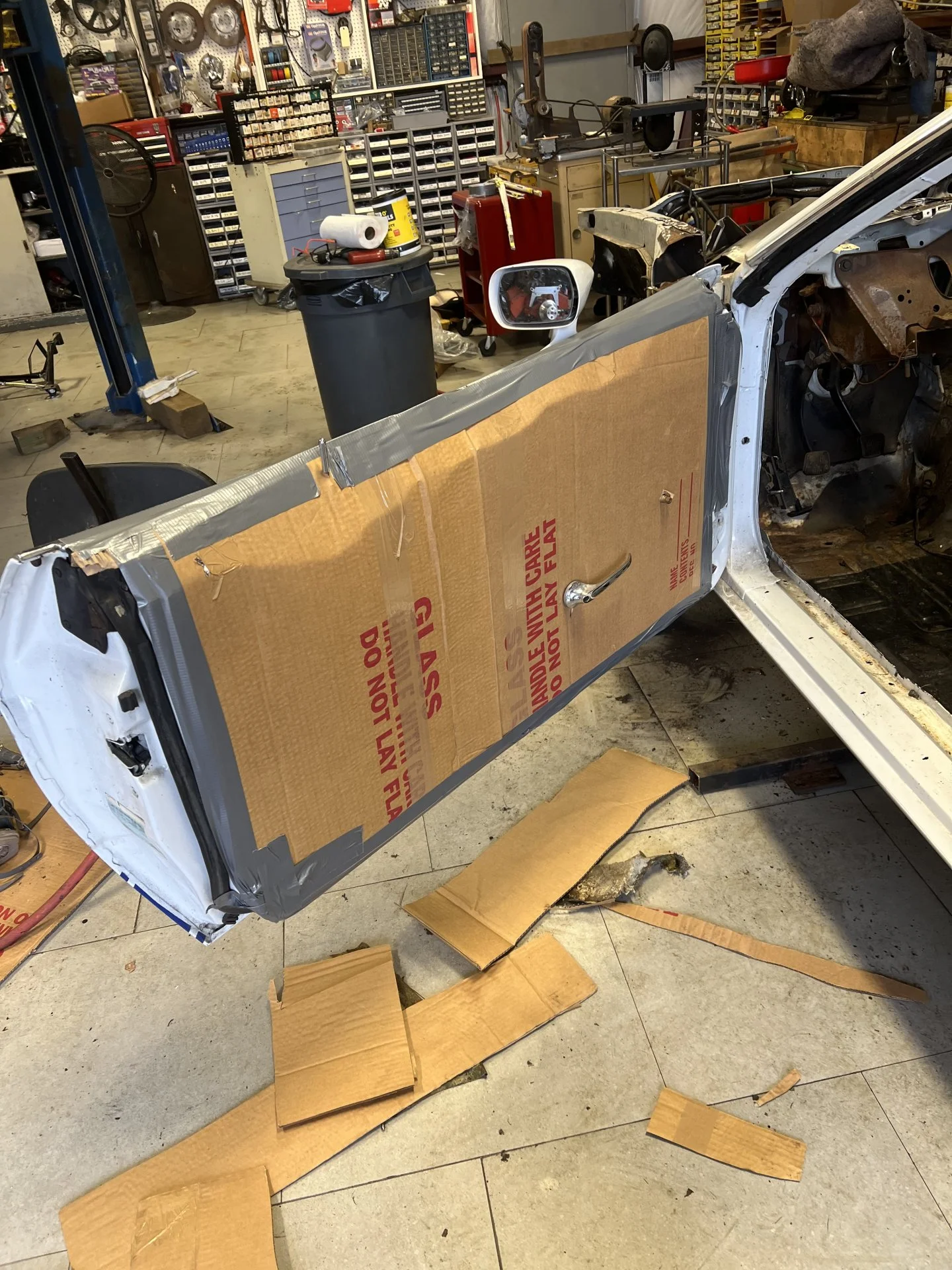

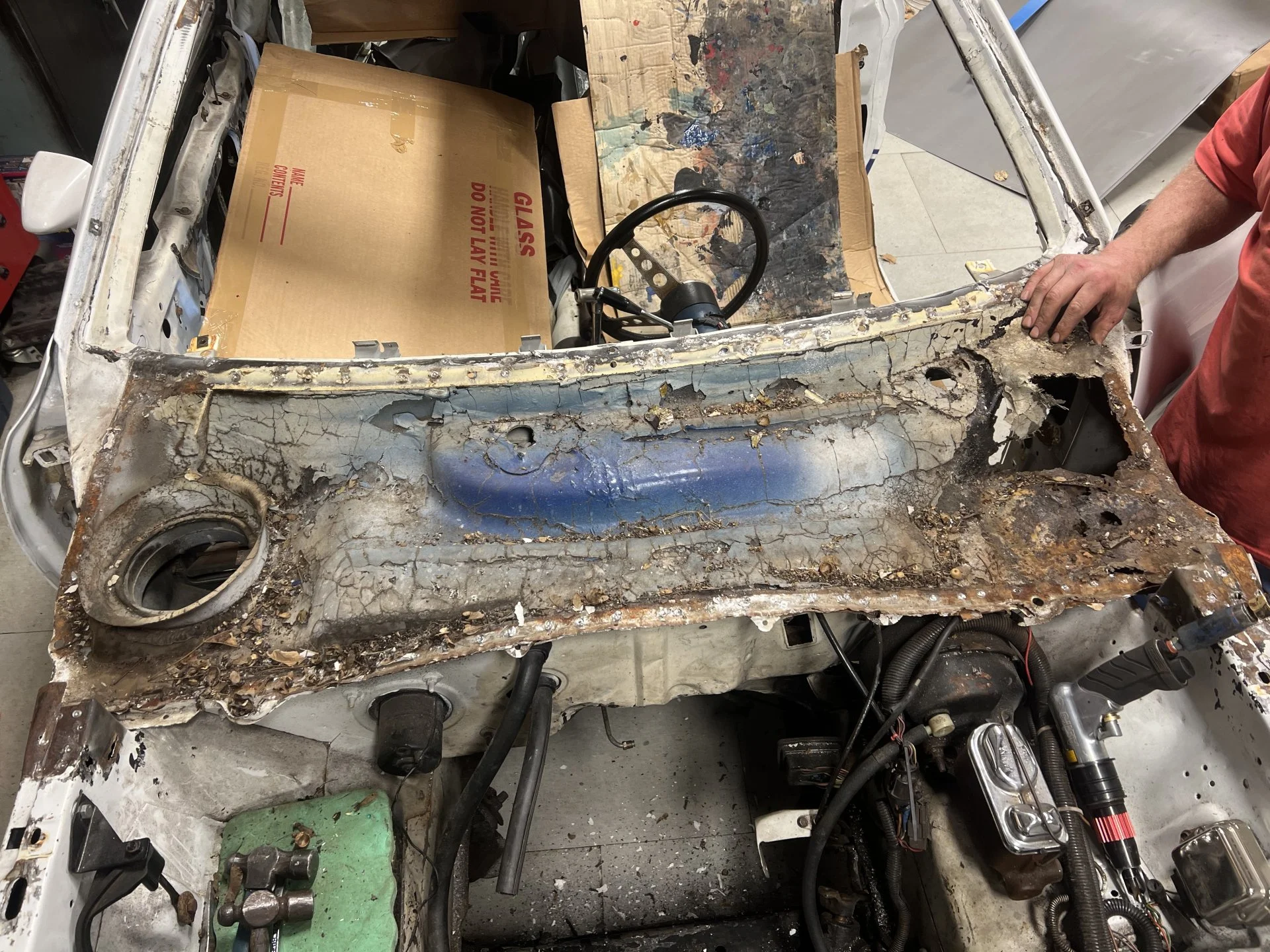

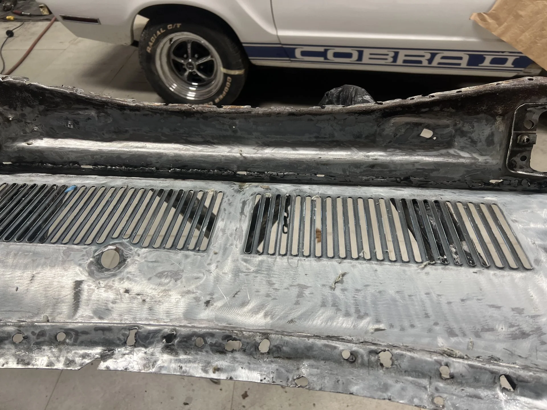

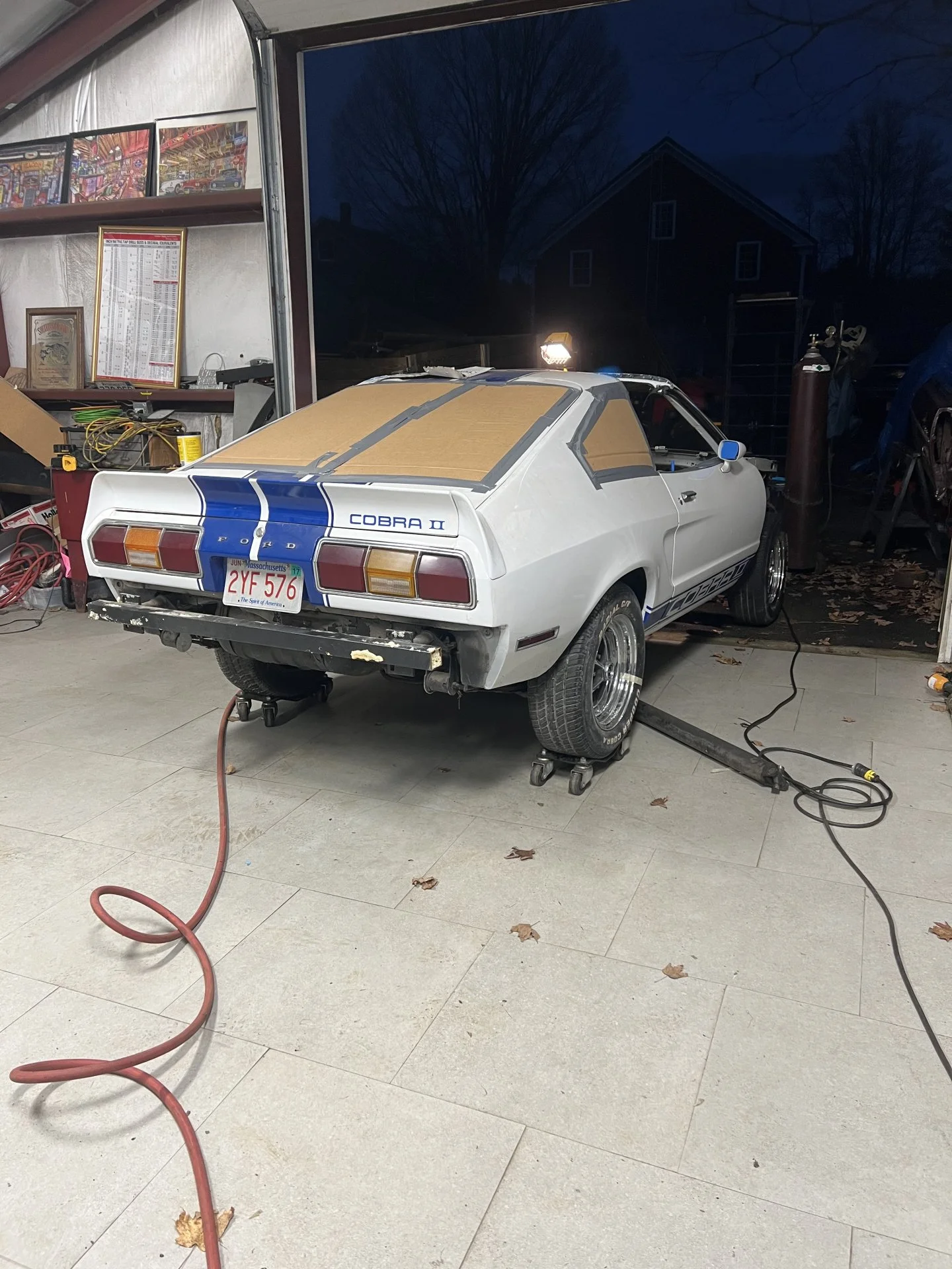

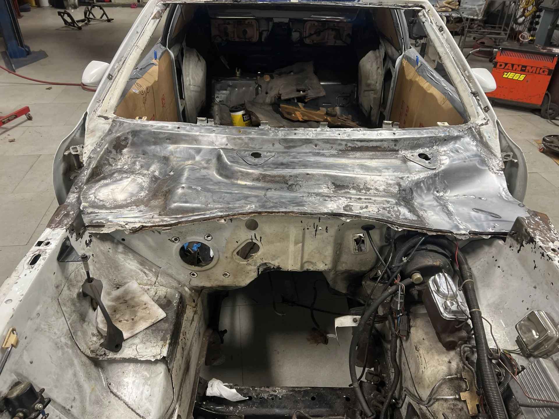

Taping off all the glass. The windshield I didn’t bother saving as it had a big crack up the middle already. I will have to count the spot welds and get more pics of the cowl.
Step Right Up.
I Guess 108.
The windsheild had a big crack already so I didn’t save it. The flanges were really clean so I won’t have to repair them. It attaches to the a pillars more towards the bottom. Ill be able to seal the bottom but not the bottom of the top piece once its welded on.
Ill get more pics
With engine with be really difficult I think. If you have an interior in your car it would be even tougher.
Reactions: 2Blue2

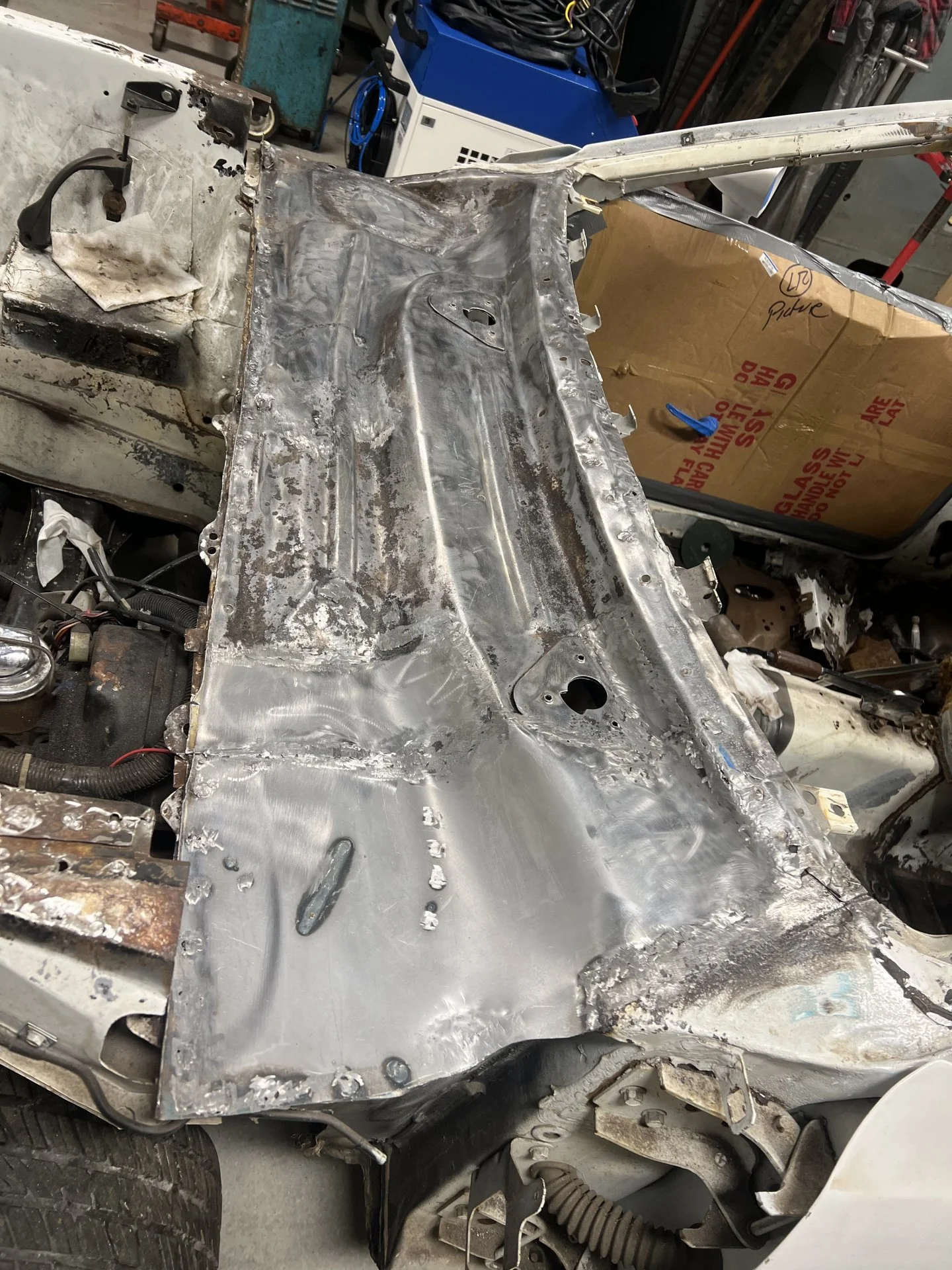

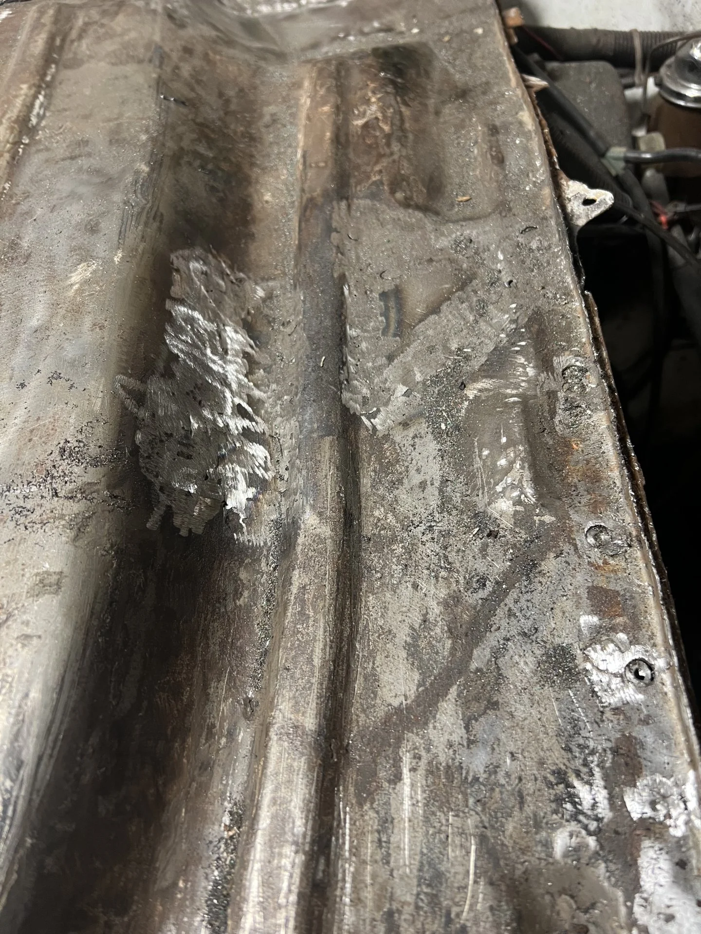

My dad gpt the patch all welded in. Tomorrow we have a few more patches to do. Then I go back to school. Will have to wait until next weekend to paint it.

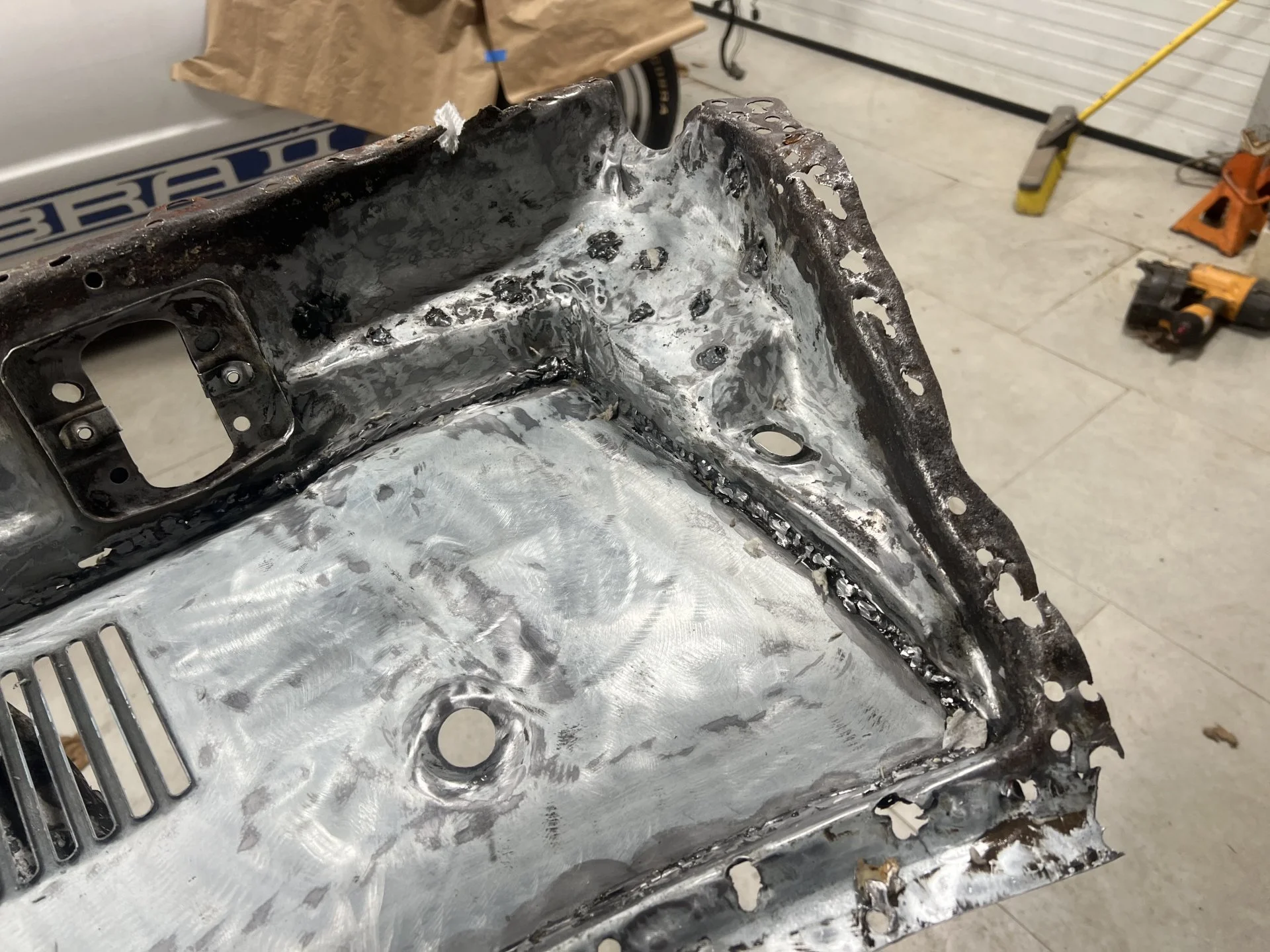

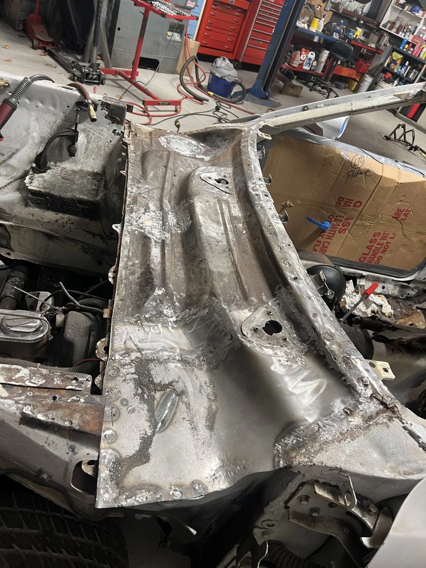

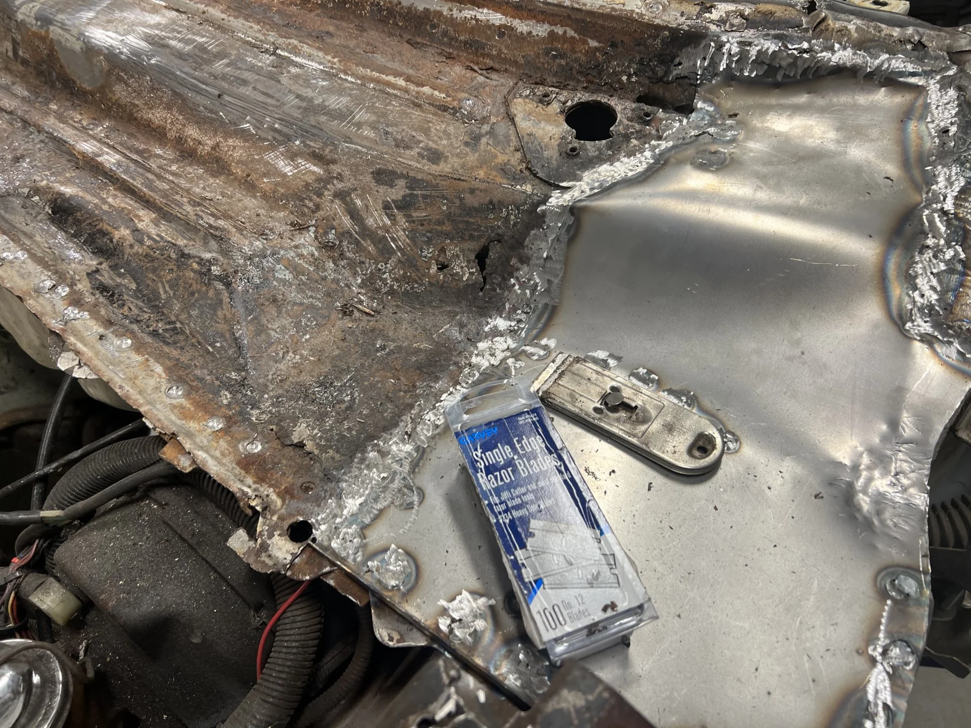

My dad got the rest of the patches in today. He did an amazing job. Not many people would bother with a Mustang II. He convinced me to fix it.

Nice work! Because you closed the openings for heater/air, are you thinking about closing the "grille" in the cowl vent, too?
No I was thinking of using a modern box. My dad has a 67 cougar and we used a box from old auto air. With those boxes they close up the vents. I was going to use the factory stuff and even bought a factory A/C system which was a fortune but I decided I would want to stick with the new box as it is more efficient and about 1/3 of the size. The holes at that point were just where water would collect so I closed them. I will be keeping the grille though! I don't really think they ever look right without them.

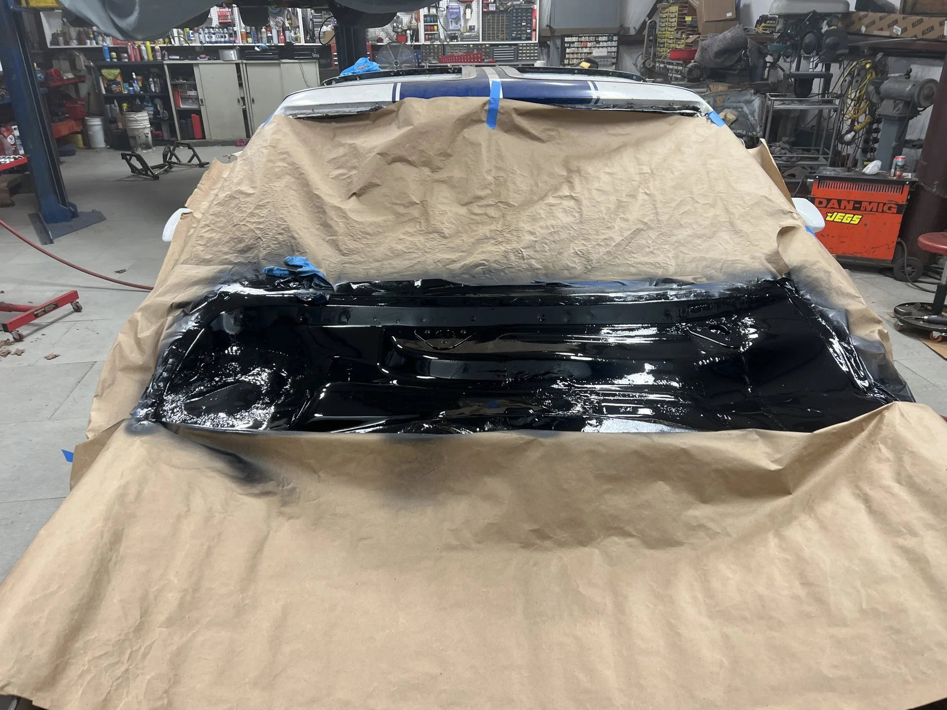

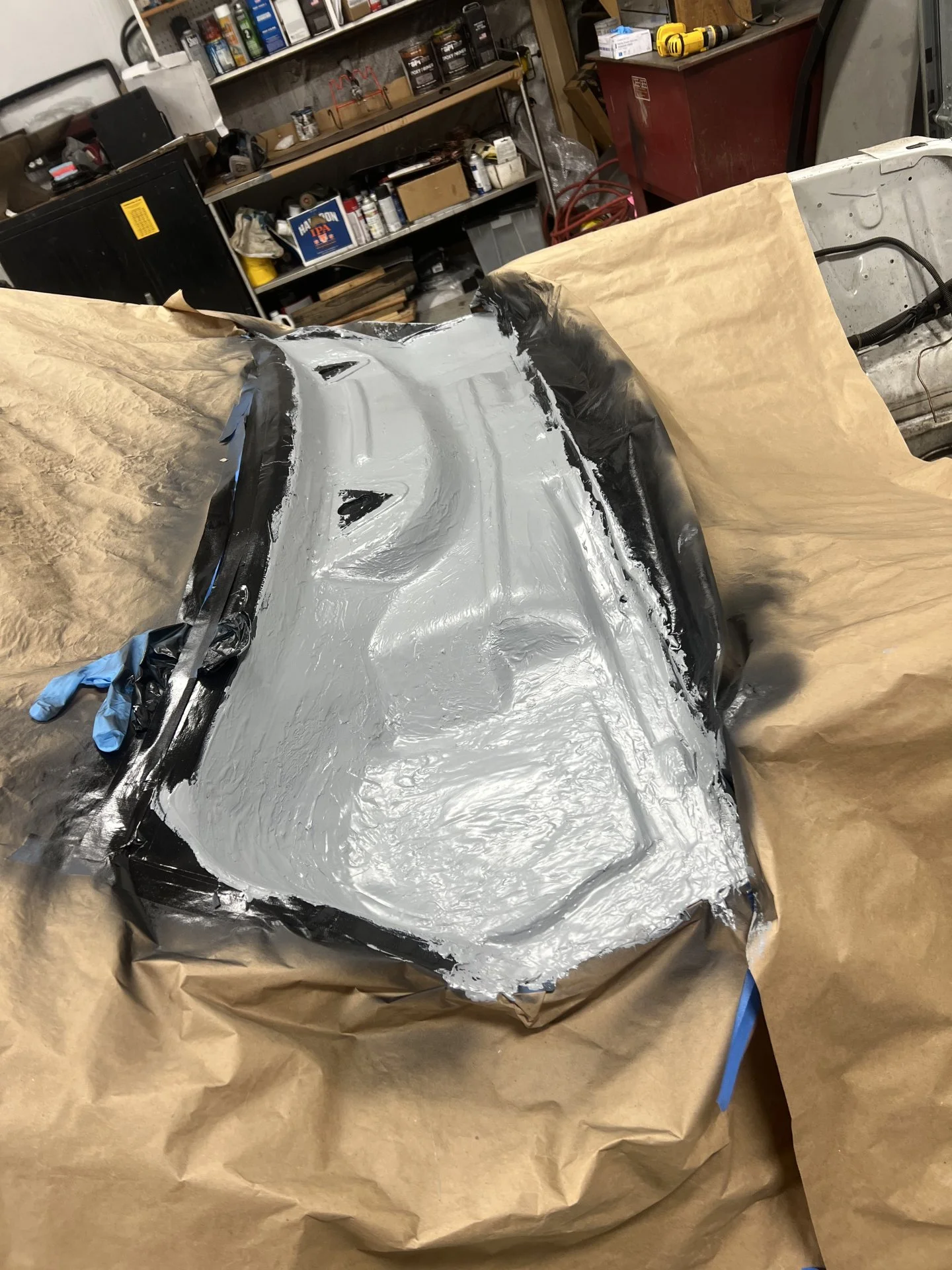

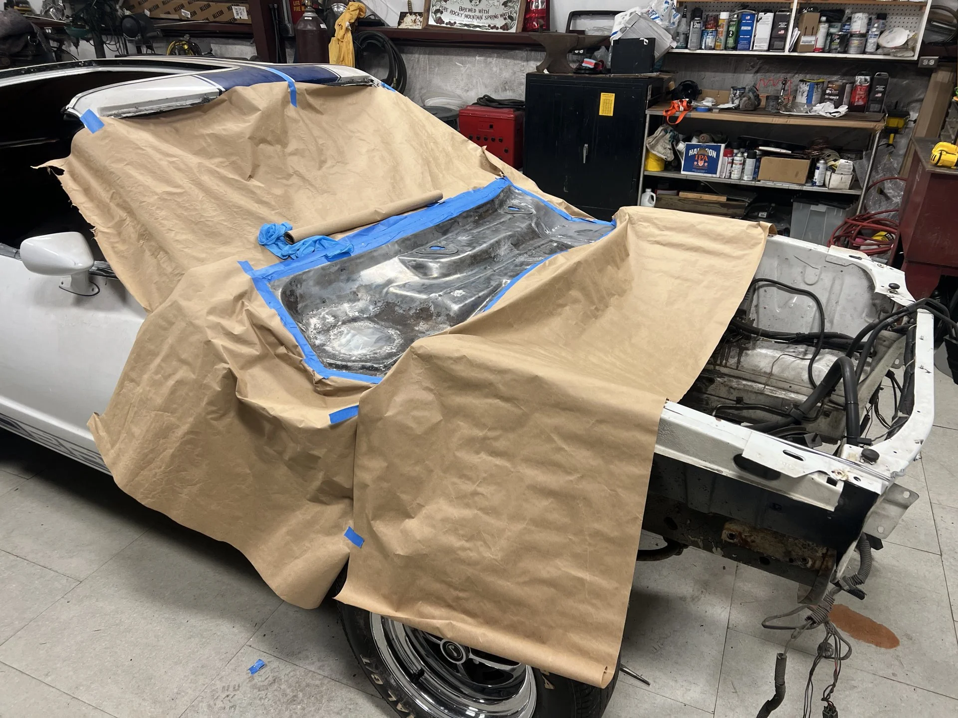

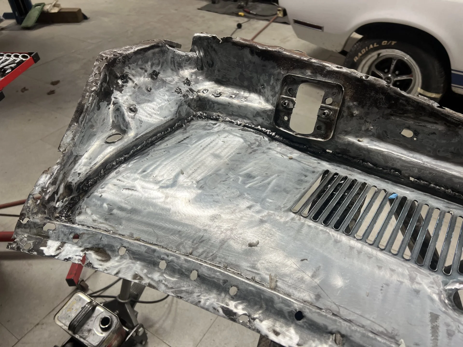

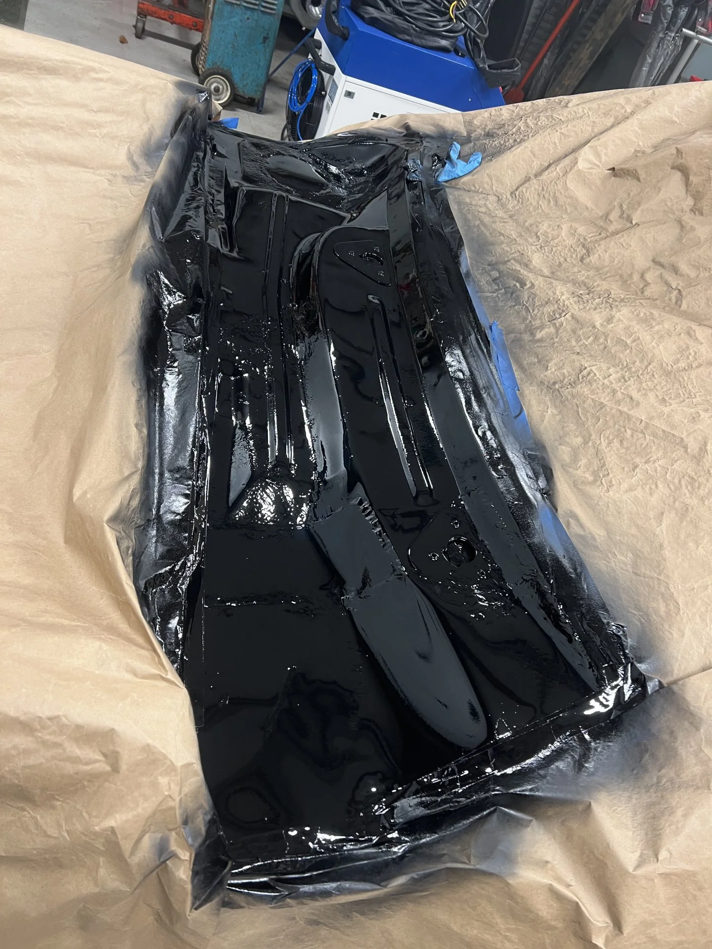

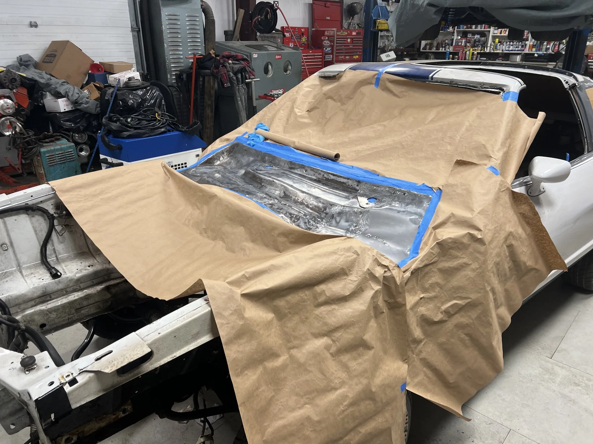

All painted. Tomorrow I will seam seal it and then put a final coat.

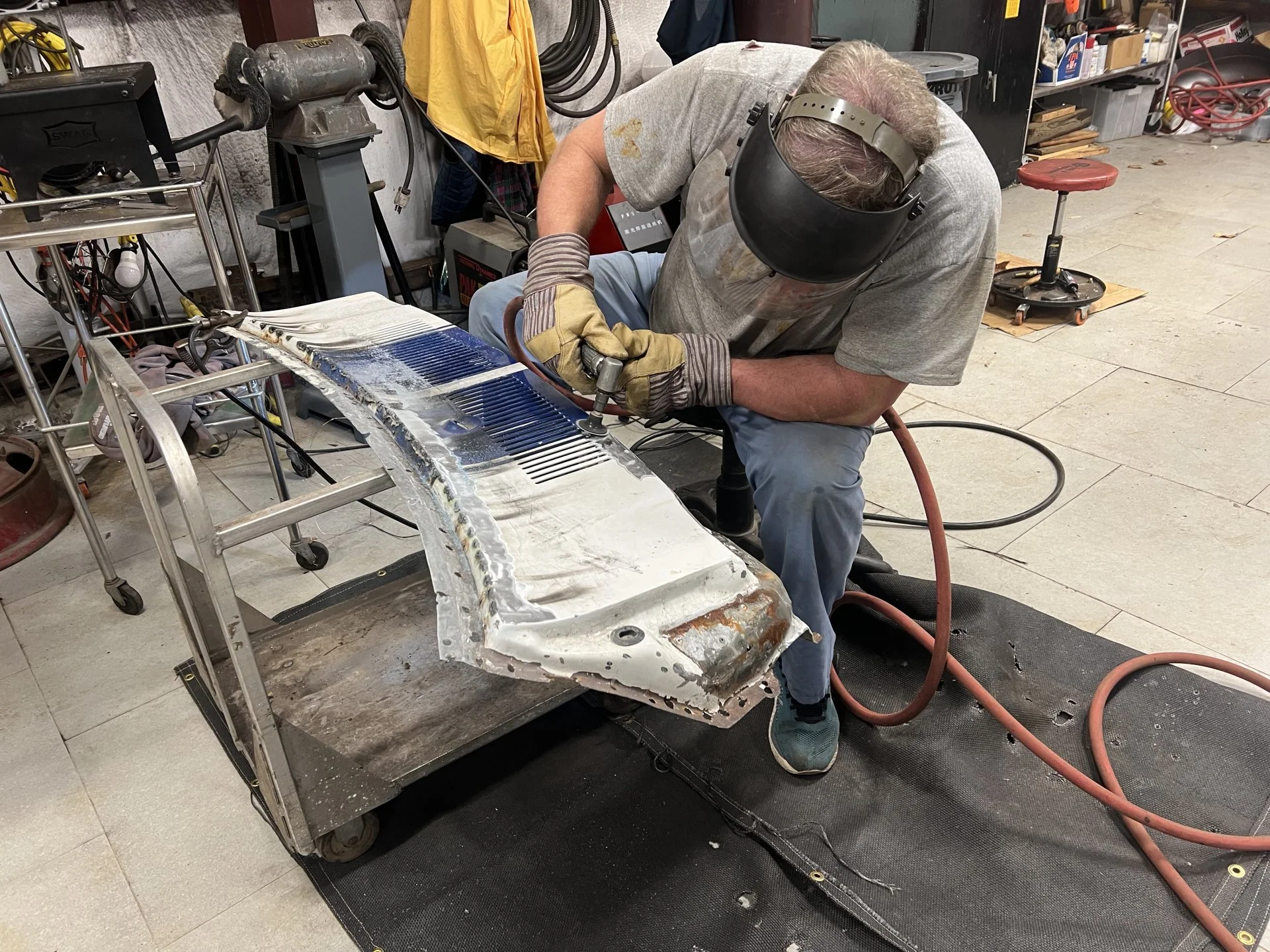

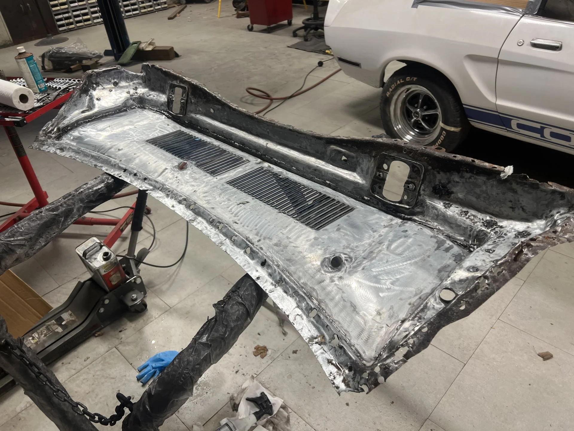

Also my dad worked on repairing the top plate.

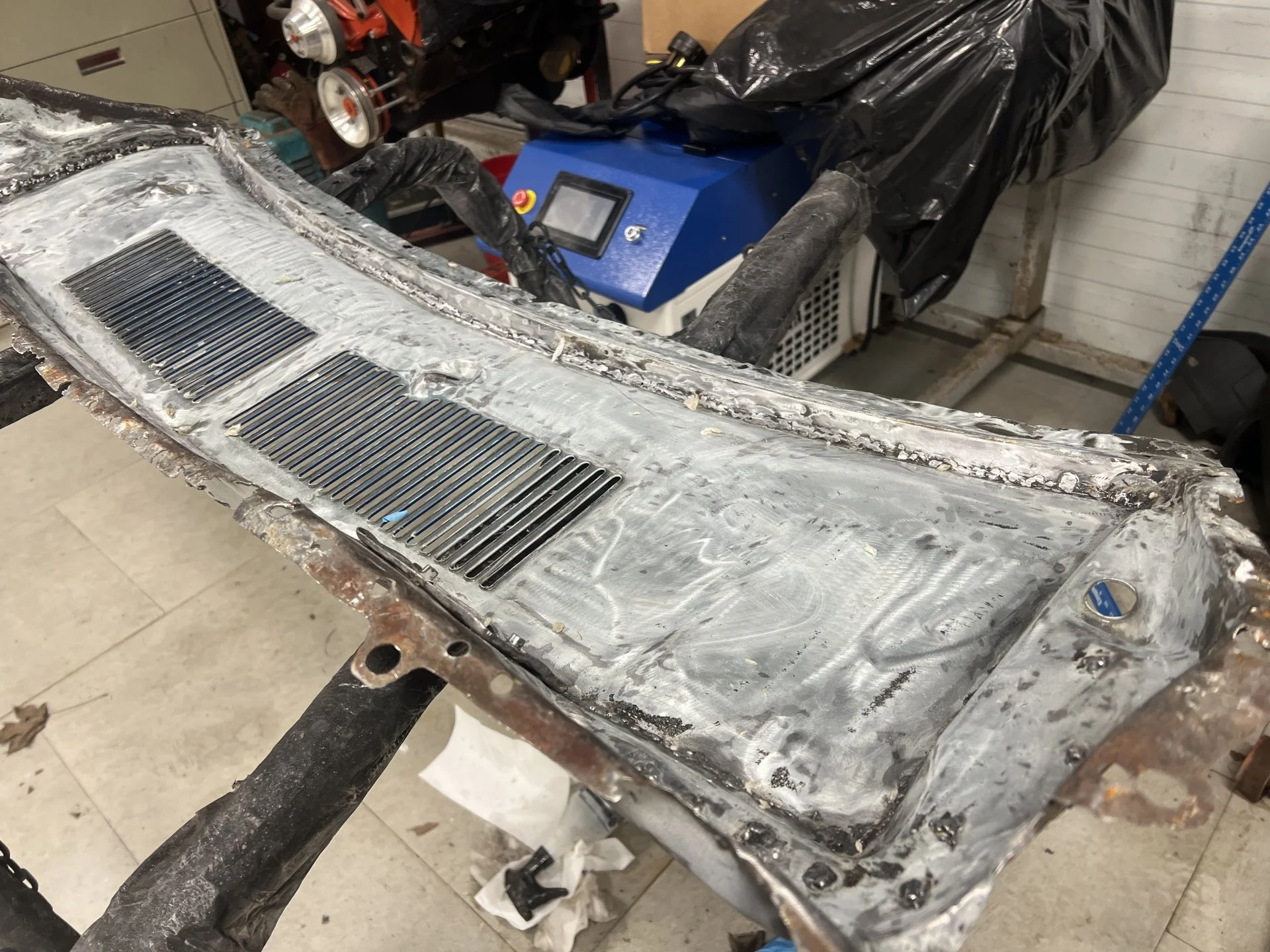

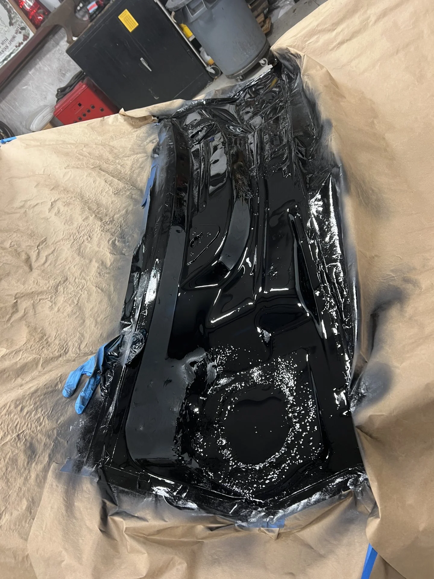

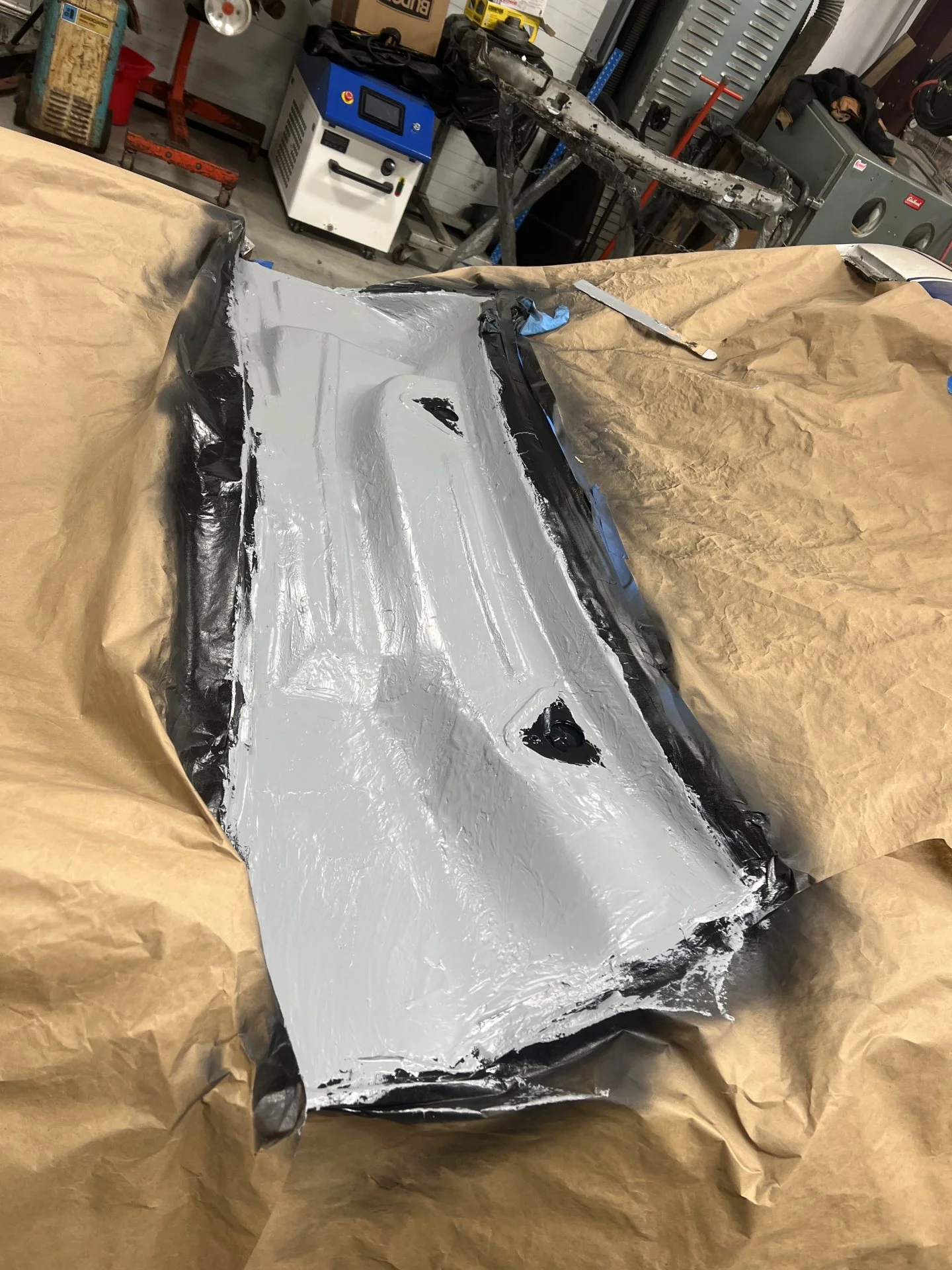

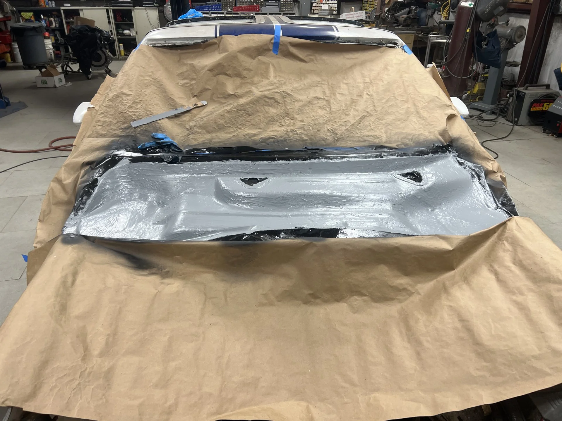

Today I did the seam sealer. Then I did another two coats of epoxy primer on top of the sealer. My dad finished the repairs on the top plate. I painted that in epoxy as well.
