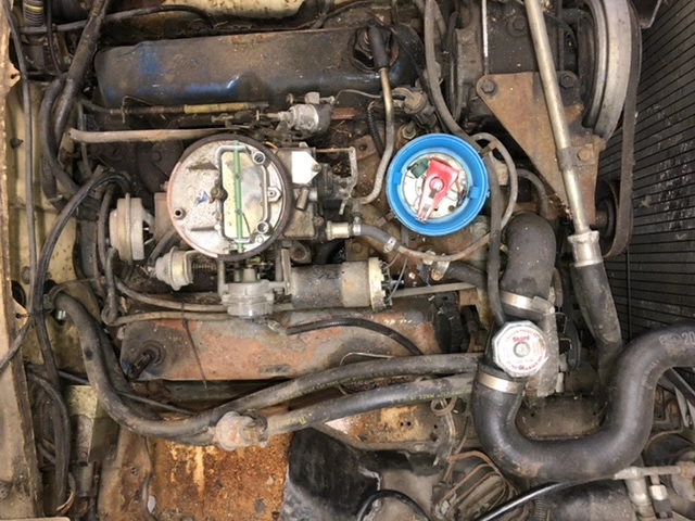

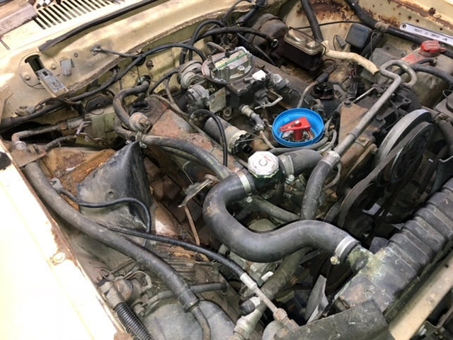

Were the plugs on the back of the head painted blue to match the heads? If so I bet yours did not have the AIR pump. If they are metal in color they were most likely added later.

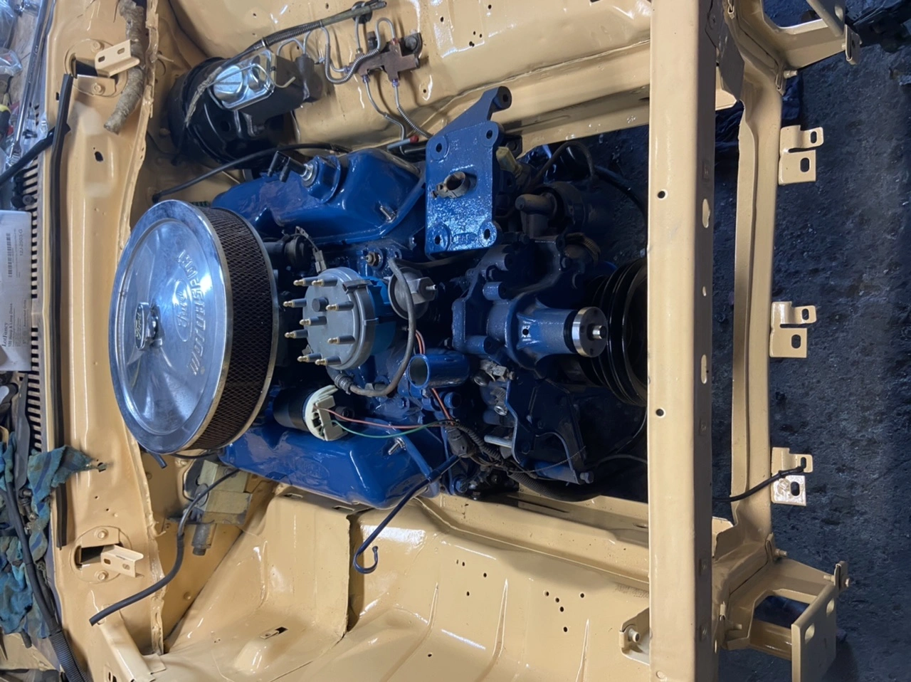

Yeah, Illinois is strict. 1968 and newer are subject to emissions. Older cars like the II’s have c a basic test and visual inspection to make sure the have original equipment. I can register it as a classic, but I can’t drive it November through March if licensed as a classic.
BTW treat that battery tray. Get some rust converter and get paint on it. They rust out. My current car is mostly rust free. No holes at all but I had to cut what was left of the battery tray out.
Yes, that’s info I would share with anyone else as well. My engine bay is treated and painted.

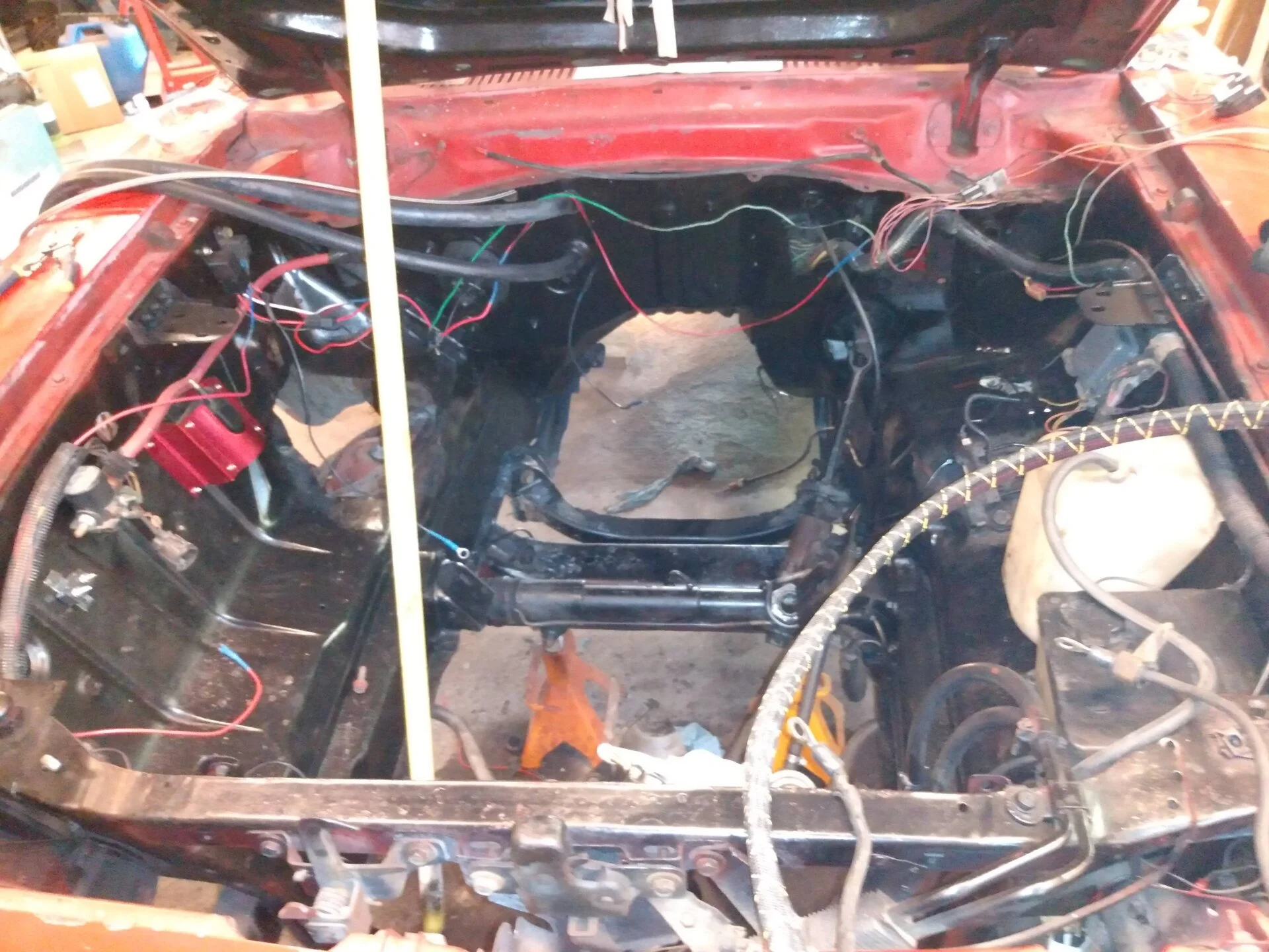

lol. Here I am giving you advice. Yours is nicely done. Mine was cut out, treated for rust and hit with a rattle can. I relocated the battery to avoid rebuilding it. The bonus was weight and heat benefits.

Yours looks good. I thought about going black, but figured the engine bay was already stripped and I had the paint, so just spray body color. My rust in the battery tray was minimal, I did have to replace the entire drivers side apron because it rusted out towards the top. That was the only rust repair on this car though.
