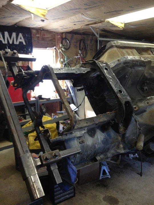

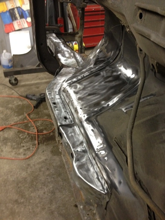

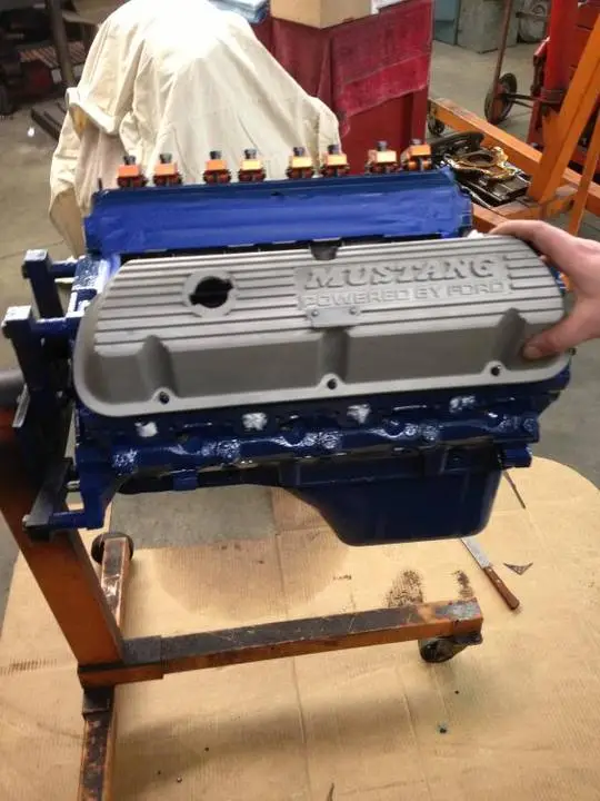

As for mine, I did a complete tear down and reassembly. It was a chore for sure, but I know every inch of the car. If you are looking into starting a job like that, be prepared to spend some coin. Engine work and paint/body will be the 2 money pits. I don't even remember what I have in my engine, but 12-13 years ago, I picked up 2 replacement quarter panels for something like $90 each. Paint and supplies cost somewhere in the neighborhood of $1000, maybe a tad more. I had a friend replace the quarters, do minor body work and paint it. I think I paid him about $2000 for his time (he was charging me $12/hr iirc). Labor on striping was free as he had a buddy who owed him a favor. I did all the reassembly myself with family members helping me with the things that are just too big to handle alone, ie replacing the hatch, doors, etc. That might give you a ballpark figure if you have friends that can do the work that you can't....

If you are just looking for a full restore I might be able to help you. Just depends. I have a 78 Mach 1 on the rotisserie now. and my king is next.
