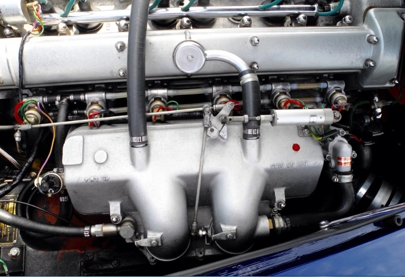

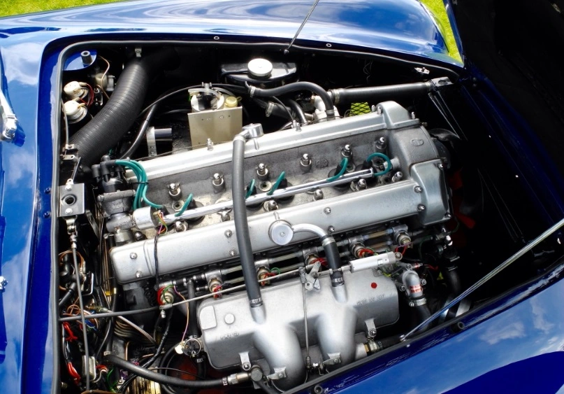

This all is the Italian Dell'Orto and Weber ITB method verses the Ak Miller/Bill Gay method. Ak had done 12 throttles per 8 cylinder induction systems, and a raft of Autolite experimentals. The Boss 302 twin Dominator 4500 was ITB. In the end, for Ak Miller, and most likely Bill Gay, it was big throttle bodies, single CFi and turbo's and propane that got latched on to. And Ak used as much danged compression as he could without blowing the crud out of his turbocharged Cleveland cast iron 250, 300, 351C or Dearborn FE 390 engines.
Who cares how you do it, thats up to the individual. You either
Wake up and smell the coffee
Or just say no to individuality
For me,
You gotta keep em separated.
But you can also twin throttle body it, which is my suggestion.

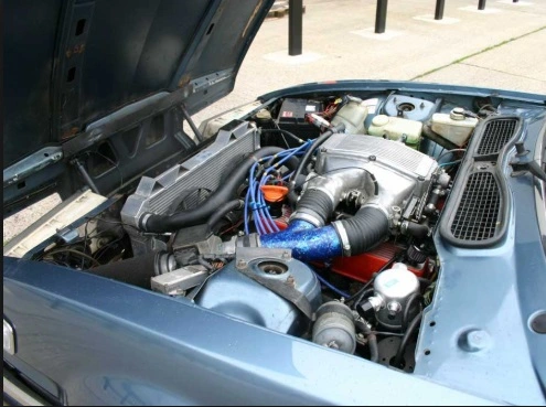

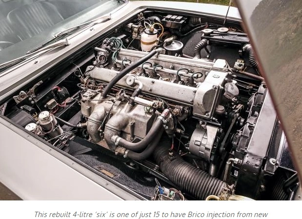

AE Brico,
TWR Rover 3500 with twin throttle bodies.
Walkinshaw Commodore.
Whatever you do, the MS3X will pull every horsepower kickin and screeming out of its "x-orst".
