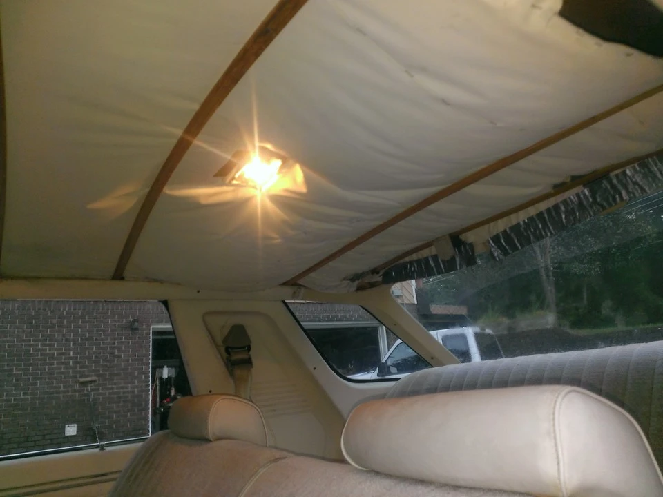

check out my bad assed headliner.:lol:

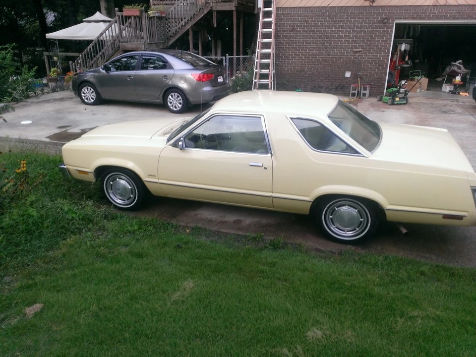

So you're looking,..and thinking another faded yellow car???, ...And to that I'm saying "I know,..Right?"
It seems that every one of these things I get are either this color,..or baby blue,....I'm just glad the thing is as straight as it is,..and is 99% rust free. The only deviations are the hood hinge areas,...but not even the Arizona desert could stop that from happening.

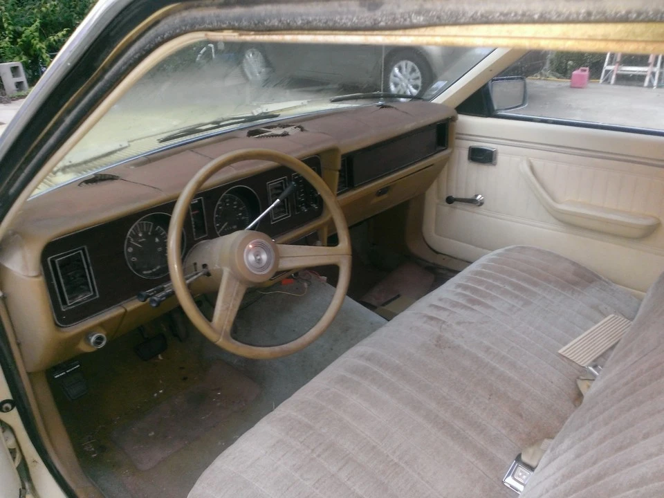

The interior is obviously trash,...the dash is atrocious,...I know all of that that can be easily replaced.
(And of course, it will be) The bench seats are short lived as well,.. but they'll do for now,..I got suspension to deal with first.

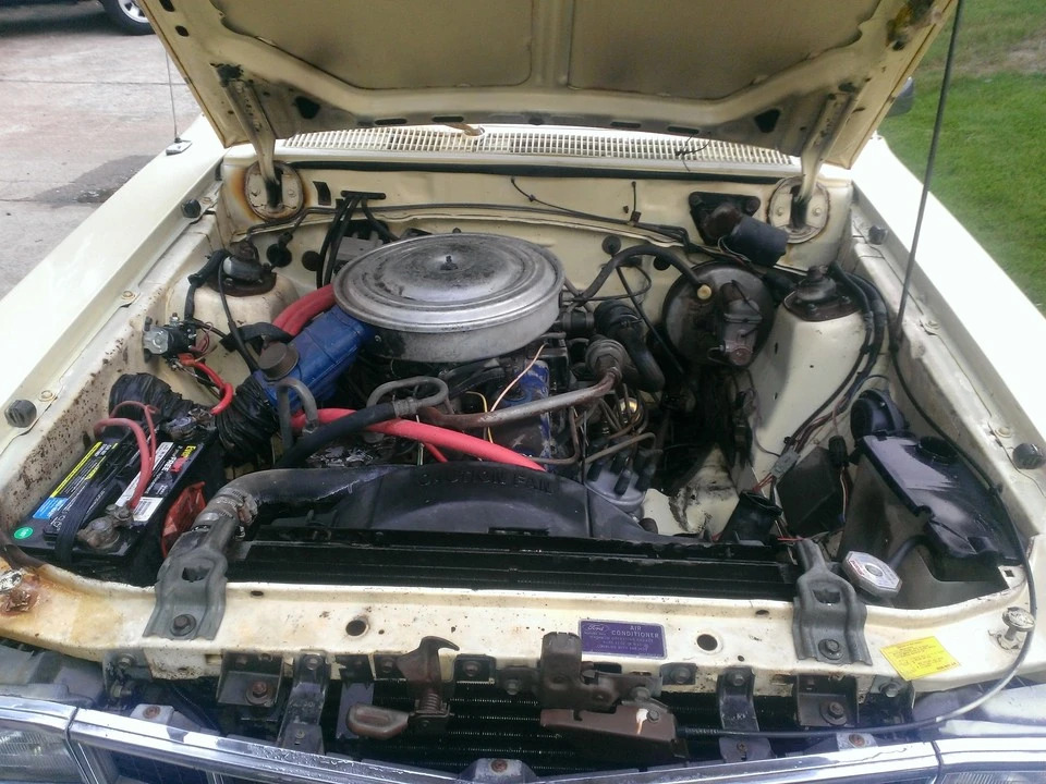

This has been a point of contention for me for some time,...as I want it to be different while trying to keep it Ford. After considering about 4 different paths (one of which was an LS option):eek:,...
I think I've decided to do all the work required to make a 4.2L inline six fit the car ( Something that it currently will not do) I have acquired a rare Australian Crossflow head that will allow me to individually port inject each cylinder. Build custom intake and exhaust manifolds and turbocharge the combo. Back it up w/ a manually shifted 4R70w, and complete the drivetraing w/ a disc brake 8.8 sporting a 3.73 reargear.

That interior looks primed to have an 85/86 dash and center console swapped into it.
Crutchfield has the kick panels with the speaker enclosures built into them.
I would keep those door panels and dye them the desired color.

You think the diaphragm inside of this relic is larger than the one for the Mustang? If so, it might be worth hanging onto if compatible with the MC you want to use.
I don't no nothing about a diaphragm if it isn't intended to stop an unwanted pregnancy.
Just look at my big assed booster:
On a side note: I just noticed the upper rad hose,....whadya spose is going on there?
