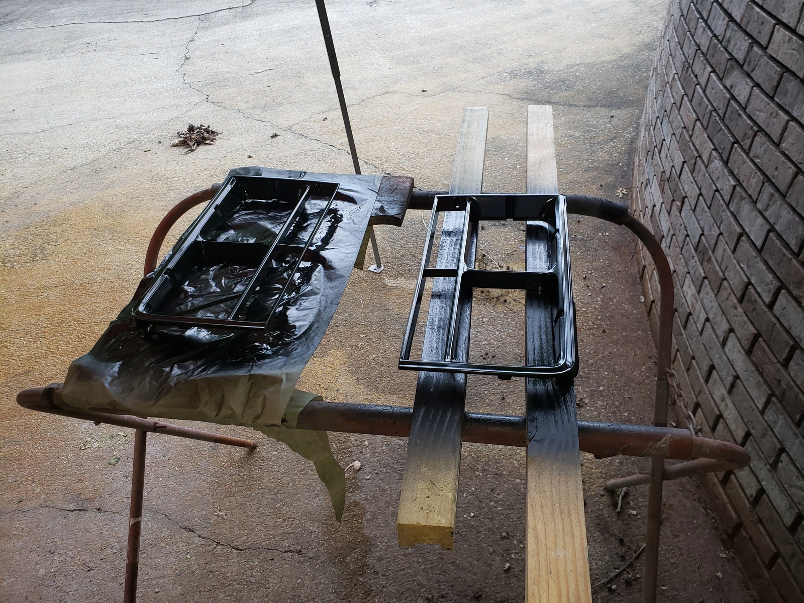

Of the few remaining projects that could be considered small, and involved paint. The only one that fit that criteria was the grille and headlight bezels. The new overall paint scheme requires that I black those pieces out ( presently orange).
So,.i get the scotch brite pad, and spend the next hour scuffing. Once satisfied that I had uniformly roughed up every nook and cranny, I washed everything down in grease and wax remover, dried that off, hung them bitches up, tacked them off, and rattle canned their asses.

I dash down stairs shake the can for a minute, and lightly coat the two headlight bezels....And no sooner than I did..to my horror...they both wrinkle like that wrinkle finish paint you can buy.
GOD DAMN IT!!! (I'm almost positive everybody in the neighborhood heard that.)
Now what? This sht was gonna dry and getting it off would be disasterous to the substrate finish...I had to wash it off before it dried. ( fortunately this is the junk that takes too long to dry)
It took a whole qt of acetone to get that paint washed off. Miraculously not harming the orange paint underneath. Once I got it clean, I was done however, as the phone that was in my pocket had already rang twice...Kate was on her way..
My hands were black, I couldn't touch my phone. I had to wash the paint off my hands now. And again, fortunately, there was enough acetone to get them to a respectable level where soap and a brush could finish up.
This morning I go back out. Lightly scuff the two bezels, wash the off, tack them down, and spray them for a third time..
There was enough paint, I'm not recoating them, and they turned out perfect.

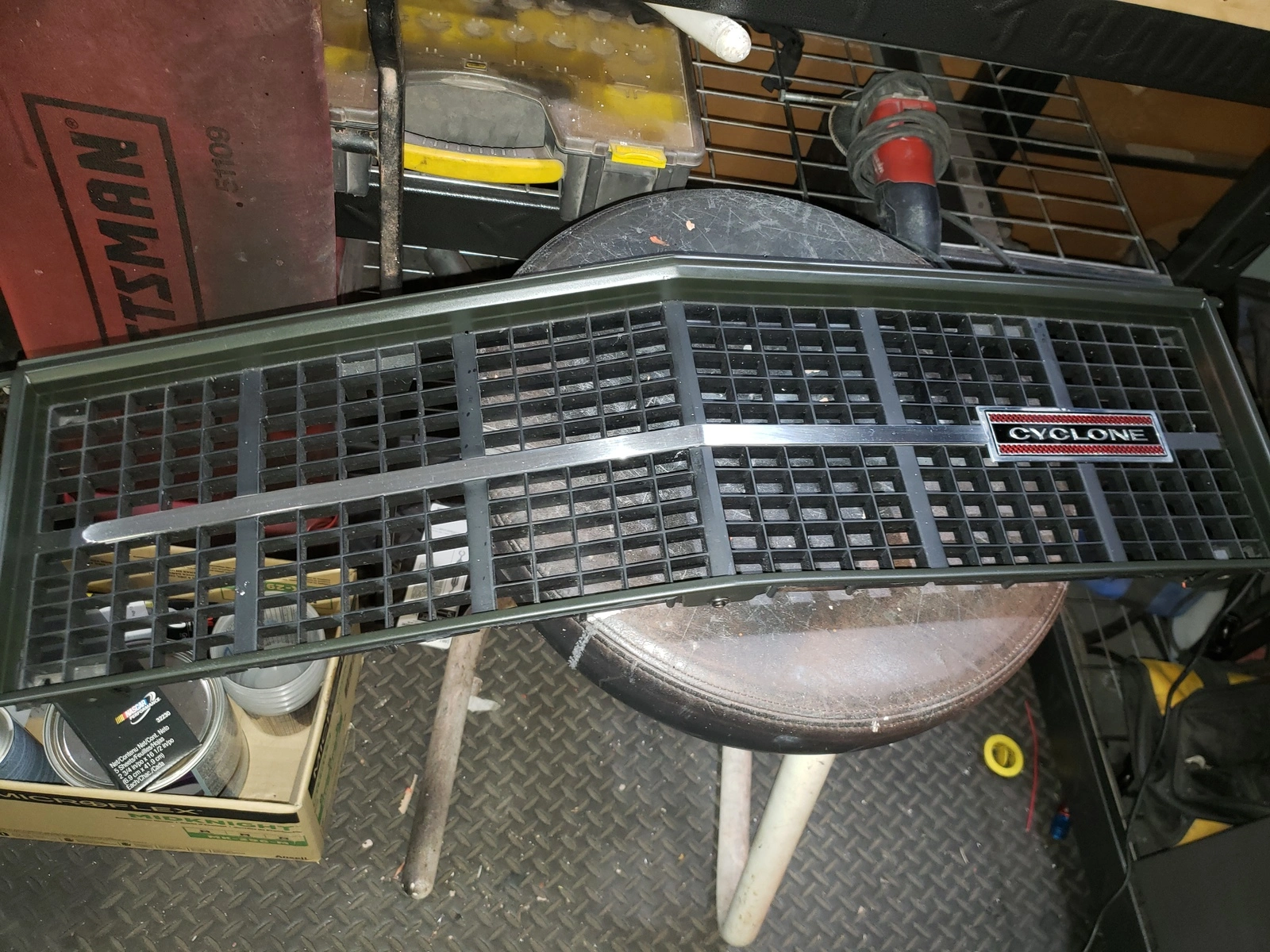

As for the grille,..I didn't attempt a recoat last night, so it didn't need anything other than to be bolted back on the egg crate center section.. ( probably shoulda washed the Mississippi bug guts off before taking the pics),..only the outside frame got paint.
