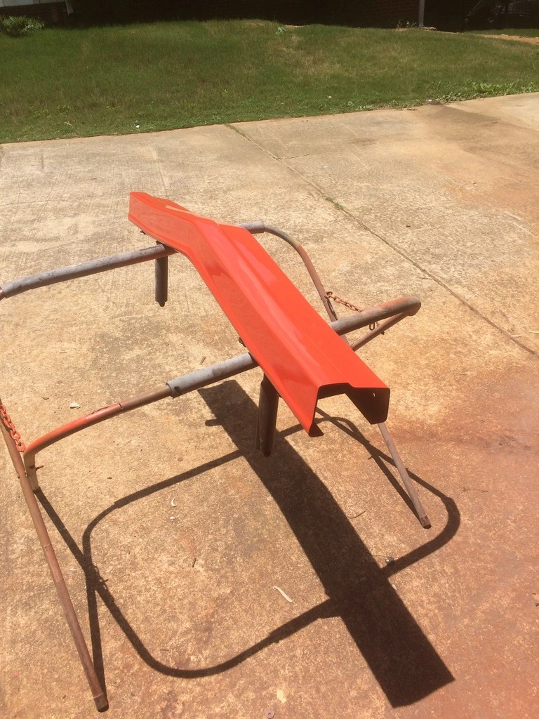

I'll also paint the oil cooler shroud as it was one of the damaged items from the UFO incident, buff the front bumper, and on Wednesday bolt the shroud to the bumper, and mount the oil coolers inside.

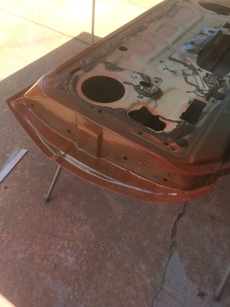

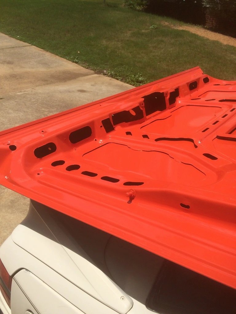

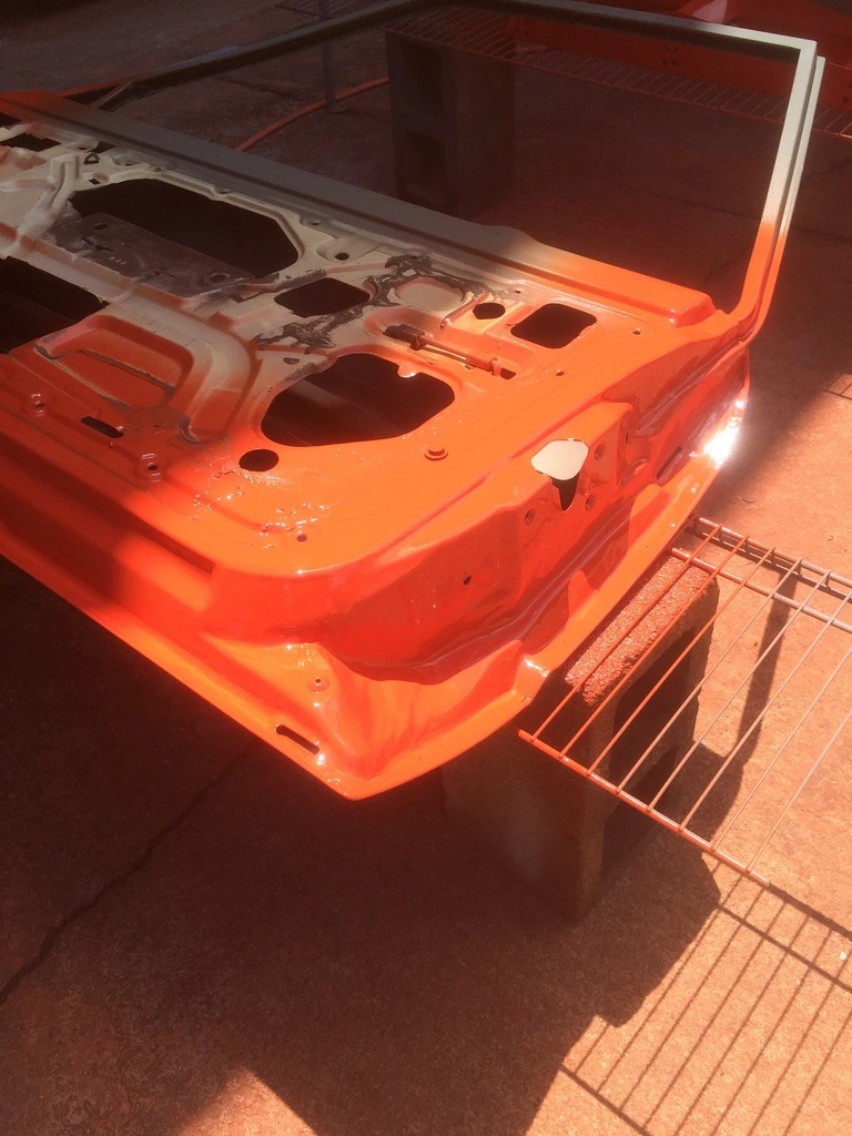

So,...to save that guy time on the non-essential areas I've decided to spray the back side of the trunk, and doors so that they can be installed and painted in place.
Since the last attempt at using this paint failed so miserably, I decided to document the first coat.
See, not "hosed on". Just enough to insure a light, even coat.
Second, and third coats follow,...only this time it ends up looking like this:

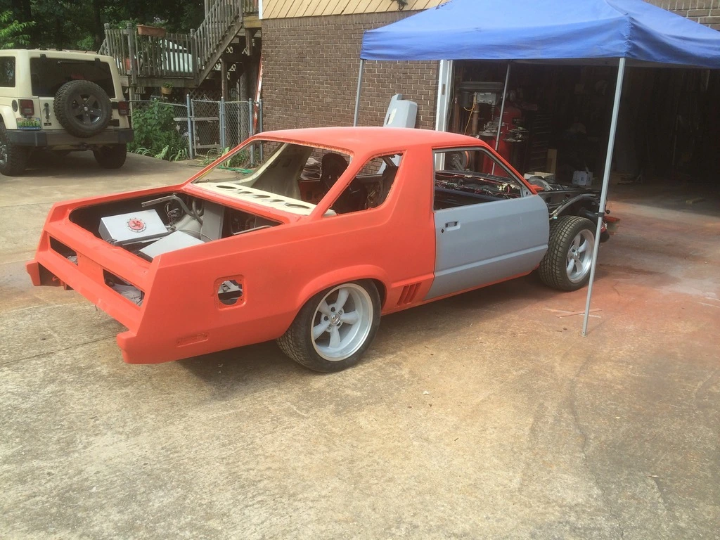

Now admittedly, I'm no painter, but if you ask me,...that door turned out pretty decent.
as did the trunk.

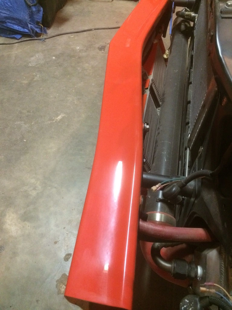

On my other forum, I said I was gonna color sand and buff the front bumper so that I could bolt the oil cooler shroud on, and install the oil coolers.
Of course, pictures never look as good (or bad) as stuff does in person,...but again, I'm pretty happy with how it turned out. Since it wasn't bolted down, I had to be very careful that the buffer wheel didn't get hold of it, and rip it off the stand,..so in the grand scheme of things, it could probably be better. Once it's bolted on,...I'll hand rub it in the ares that still need a little work.

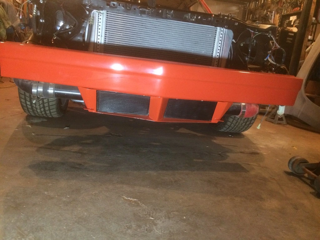

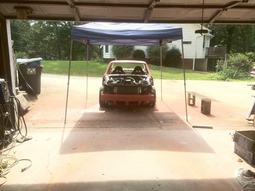

But,..when you put dude on the bumper, bolt the bumper on, mount the coolers, and put the monsters' shoes on and set him on his feet,....this is what that looks like.
There is a "splitter" that hangs beneath the shroud that spans the width of the front bumper. I'm gonna wait to install that till after the fenders are in place because it makes it hard to get them on w/ risking hitting it. but that is what will bolt to those tabs that you see hanging off the shroud.
That quarter panel looks like it's about 10' long..

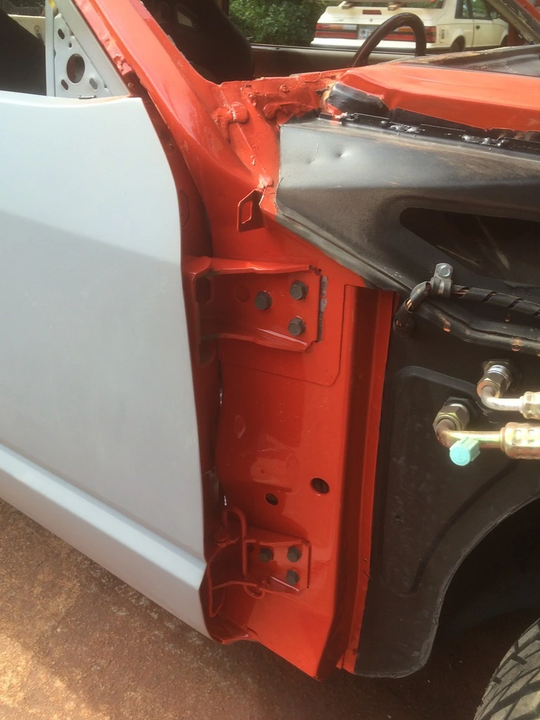

This is why I bolted the doors on. Even though I marked the positions where the doors were the last time I had them on,..they needed adjustment. Adjusting them F'd up the paint on the hinge bulkhead. Fortunately, this area will be exposed, so when we paint it, this area will get scuffed and shot w/ the good stuff.
I about blew a nut pushing the monster back into his pen,...but nonetheless he's back inside, and both of my nuts are still where they're supposed to be. So all in all,.. it's all good. Doors are hung, but I'm holding off on installing the trunk until after I talk with Dave to see if he wants that installed or not.
