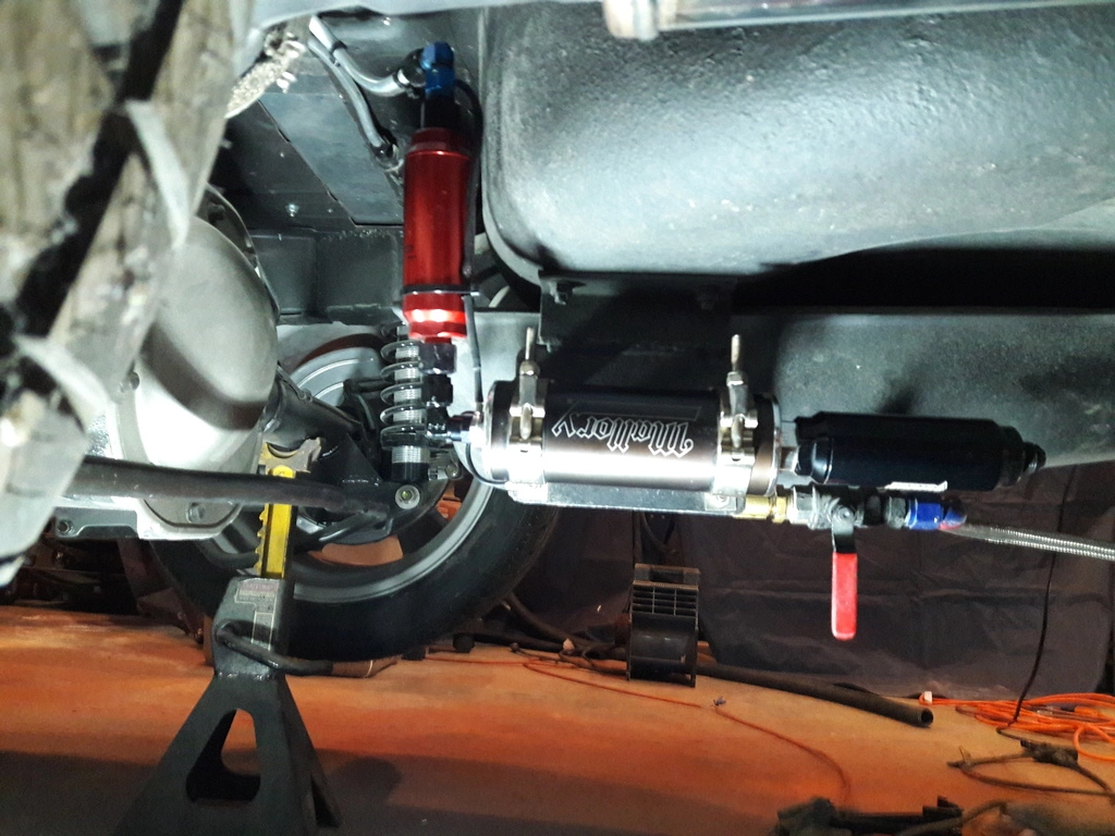

Good afternoon gentlemen,..It's time for your mid day restart update.
Whether or not you are aware, I'm gonna attempt a restart w/ Steve looking over my shoulder at about 5PM today.
I had to get the water pump tied into the cooling fan circuit, and add a restrictor in the heater hose return to try and see if the damn thing will build heat, and stay at temp. Last time, everytime I turned on the WP the temp plummeted. So we'll just have to see today.
I also replumbed the new tank (remember, I decided to get rid of the old tank because the dropped sump seemed like it might be a candidate for scraping in certain steep driveway entrances.
So this is what it looks like now:
