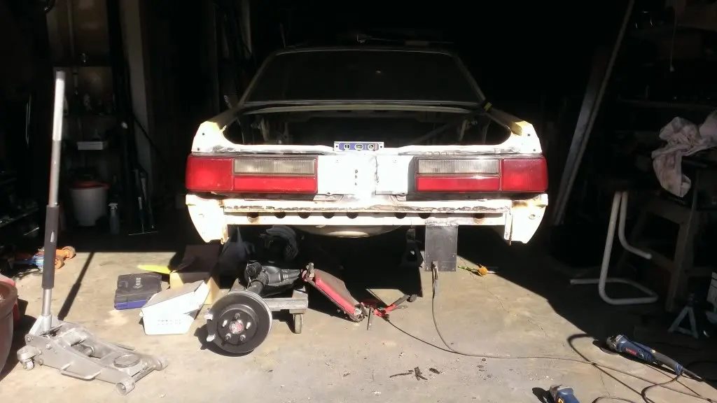

madspeed said:
Tailights gonna be similar to these?
Uhh No,......Tail lights are gonna be similar to these:
I don't plan on having bumpers in a traditional sense. I will fabricate a later model style, and blend the bumper into the existing sheet metal similar to how a mustang bumper cover works/looks.
I don't have the space or additional disposable monies to have another junk car sitting around here, so the red Mont will have to go to crusher town. There is nothing body wise I need for my car. It was an Arizona car, so nothing is rusted, and it's never been wrecked, so there's nothing to replace.

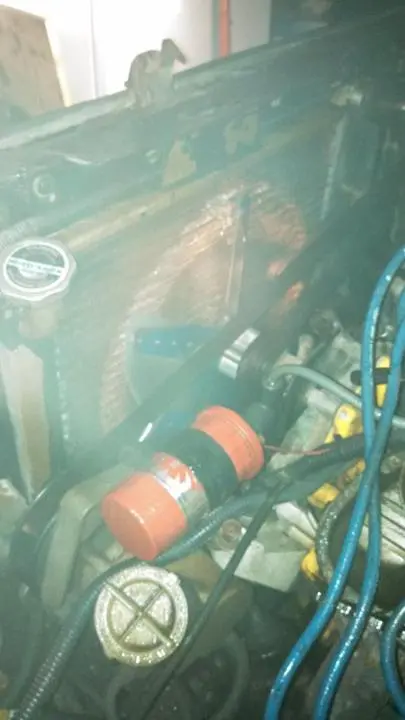

Oh look,...I found this while looking up stuff online:
H
ow to install an old assed aluminum flex fan:
  1. Hold fan against water pump.
  2. With your free hand, start threading one of the 4 bolts that holds the fan on.
  3. Install the other three bolts.
  4. Tighten all four bolts. If you're a real goob, you can torque them to 20ft/lbs.
  5. Start engine, observe fan operation to ensure that IT DOESN'T HIT THE RADIATOR!!
  6. Close hood.
  7. Have a nice day.
  8. Ignore points 1-7. ESPECIALLY point 5.
  9. Buy new radiator.
  10. Blame Mike.

Oh sure, now you give me a manual! Honestly, I have no idea how it met the radiator. I never removed it during the install of the tranny, and it was fine before the trans swap. I must have leaned on it and bent it while I swapped the carb or something. Even so, it idled outside and warmed up before the drive for a good 15 minutes while I cleaned the garage, and was not making contact at that point. Anyway, quit taking me so seriously and give us some more updates on your car.

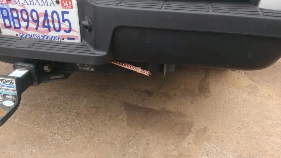

When I decided to buy my TIG back from my friend, I went to my welding supply store and bought two pounds of 3/32 mild steel welding rods. I drove around for about a week with the rods in my truck bed.
When i went to get the rods fully intending to use them, they were gone.
As in POOF!
I had to leave my truck over night at a hospital one night, and I knew I had seen those rods laying back there before having to do that.
Now they were gone. What kind of low life rat bastard would steal only welding rods, and leave every other tool that was in the bed back there I thought.
I resigned myself to buying another two pounds.
This morning, I go out to my truck,..and say to myself.... "What the hell is hangin' down from my back bumper?"
So there the elusive 2 pounder was. Somehow managed to hide in some crack between the bumper, and the body of the truck for two weeks of daily driving,...finally revealing itself to me this morning.
It must be a sign.
NAAAAH.

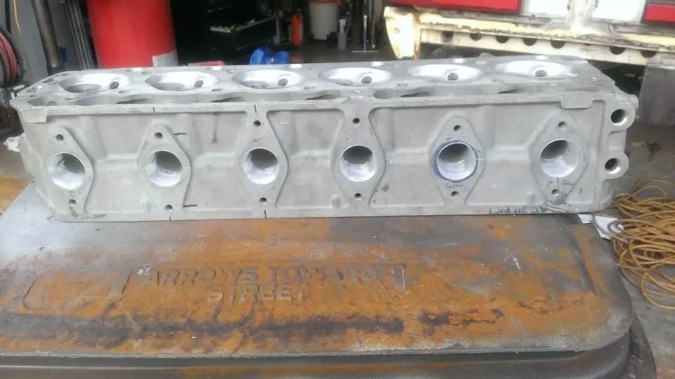

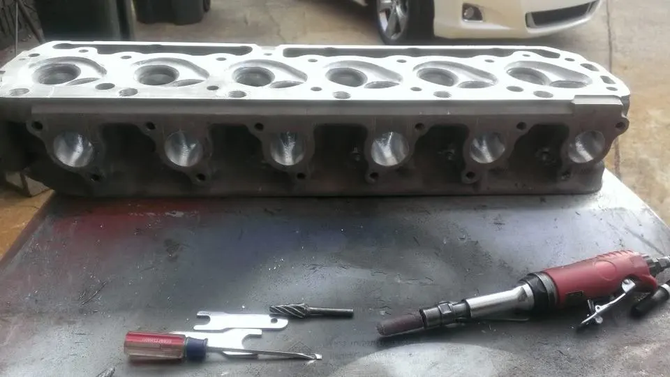

But since it was so nice out, I put the head on my grinding bench, and ported the intake, and exhaust so I can take the head and all the valve train junk to the machine shop tomorrow.
Now the astute eye will see that my "grinding bench" is a trash can. I use what I have.
I only match ported about 1.5" of each port. The intake and exhaust opened up to 1-5/8".
The chambers and pockets are polished and blended as well,........but do you get to see those?
No,.....they're not nice enough to display for the entire WORLD. I'm not one to show off my tattered underwear,...despite the fact that it's clean.
So you'll just have to imagine that the pockets are blended smooth, and the chambers are shiny.
